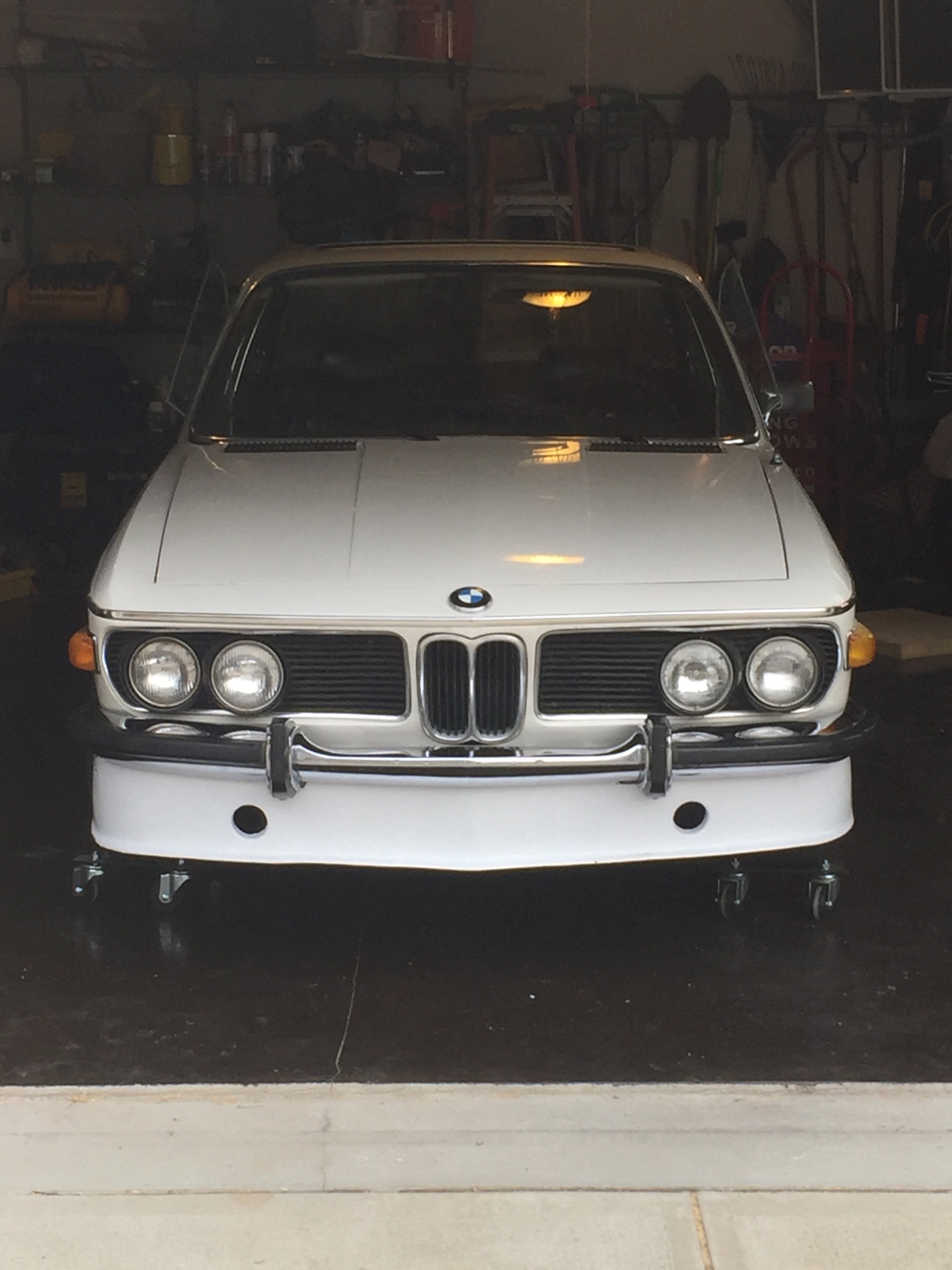

yep, i gotta go thru that at somepoint in the not-to-distant future ... off, fix the rubber around the overrider and then back on. UNLESS, there is a way to take an overrider off without removing the whole bumper. i hope that somebody can tell me this is possible.
It is not possible to replace the overrider rubber without removing the bumper. Best case scenario have 2 friends help remove and replace the bumper with you. One on each side and you in the middle, makes it a much more controlled install than doing it by yourself.
don't need to replace the overrider rubber per se, i need to replace the rubber on the left side and the trim rubber on the left side between the bumper and the overrider. i presume that the answer is the same. so i guess i should have asked, can i remove the left side of the bumper without removing the whole bumper.
out of curiosity, does one remove the front bumper by unbolting the brackets that fastens to the frame rail ... or do you unbolt it at the overrider? i presume that is at the frame rail.
No, the bolts that connect the curved sides to the center section are behind the over rider and are impossible to get to with the bumper on.
Yes, I remove the bumper by unbolting the brackets from the frame rails in the fender wells and then each side from the fenders. Then pull forward while angling the bracket ends around the captured carriage bolts, that's why I recommend assistance. Makes it a more controlled operation.
