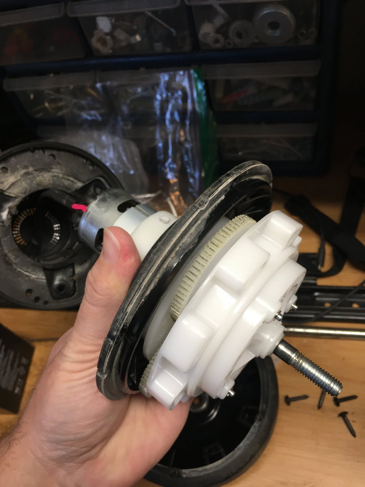

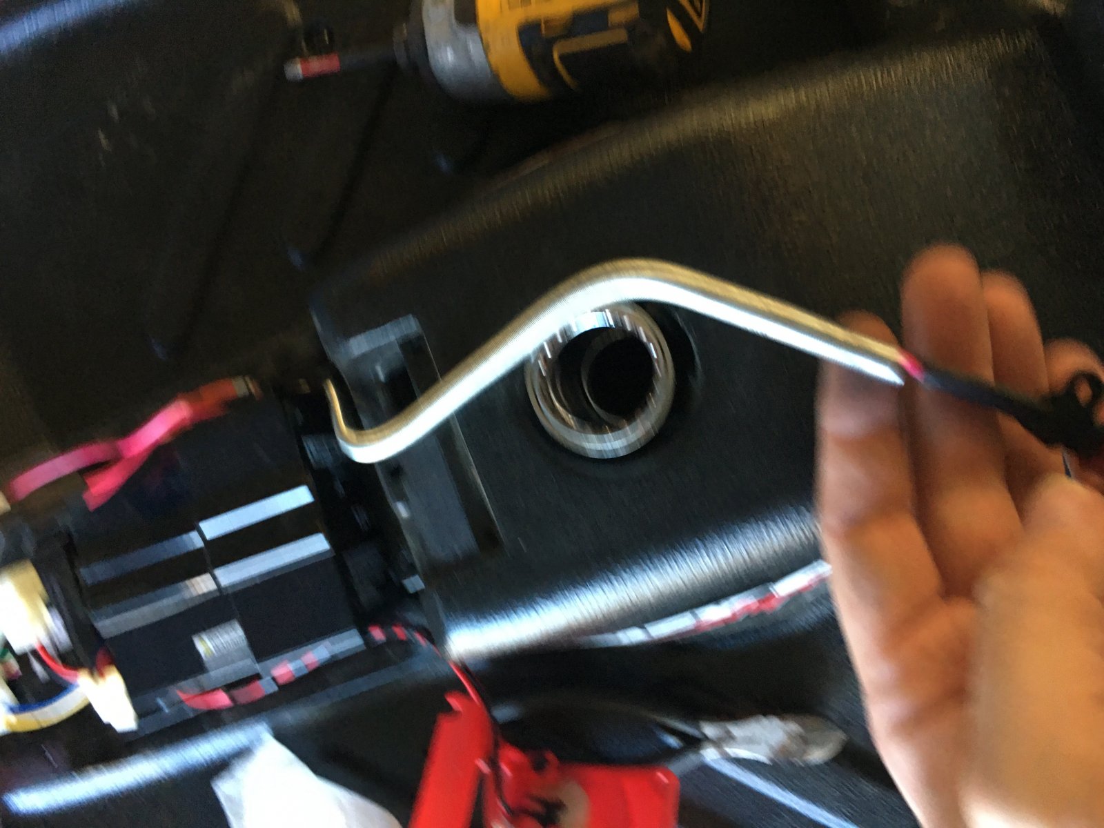

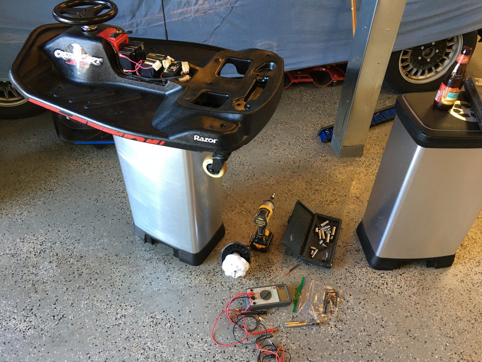

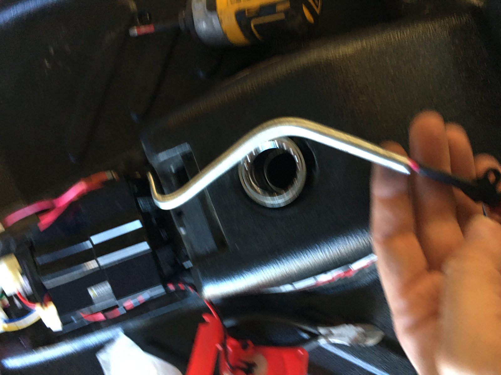

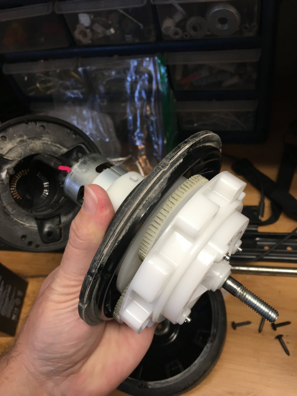

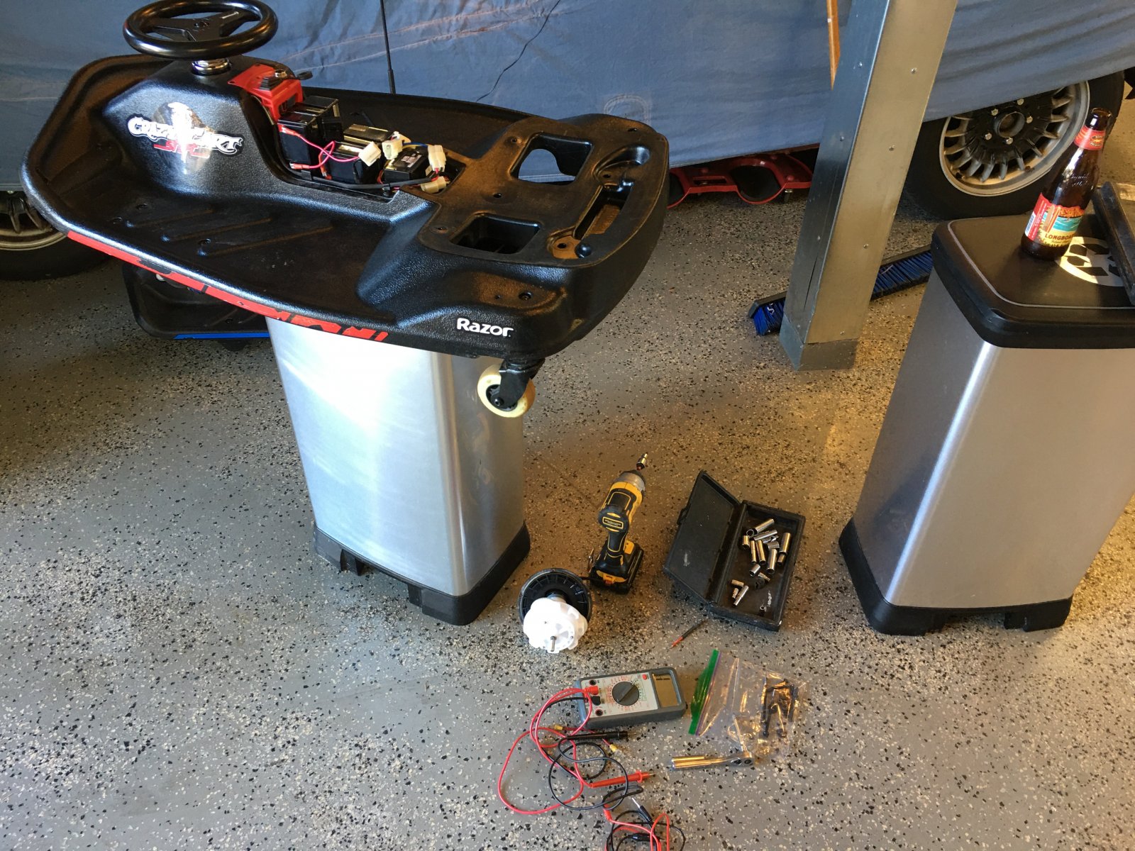

Iteration #2 on my electric go-kart repair. Batteries
didn’t work. I had to put it up on a lift and perform a bare plastic restoration.
The 24v motor responded well to bypassing the drive-by-wire throttle, and the EMS system. The one-speed planetary gearbox was not stripped, but does look like a weak point if I add HP in the future.
Turns out that the throttle wire had started to frey, causing intermittent power. It eventually snapped. The wire needs to flex as the front wheel turns. After time it gives up inside the protective coil spring:

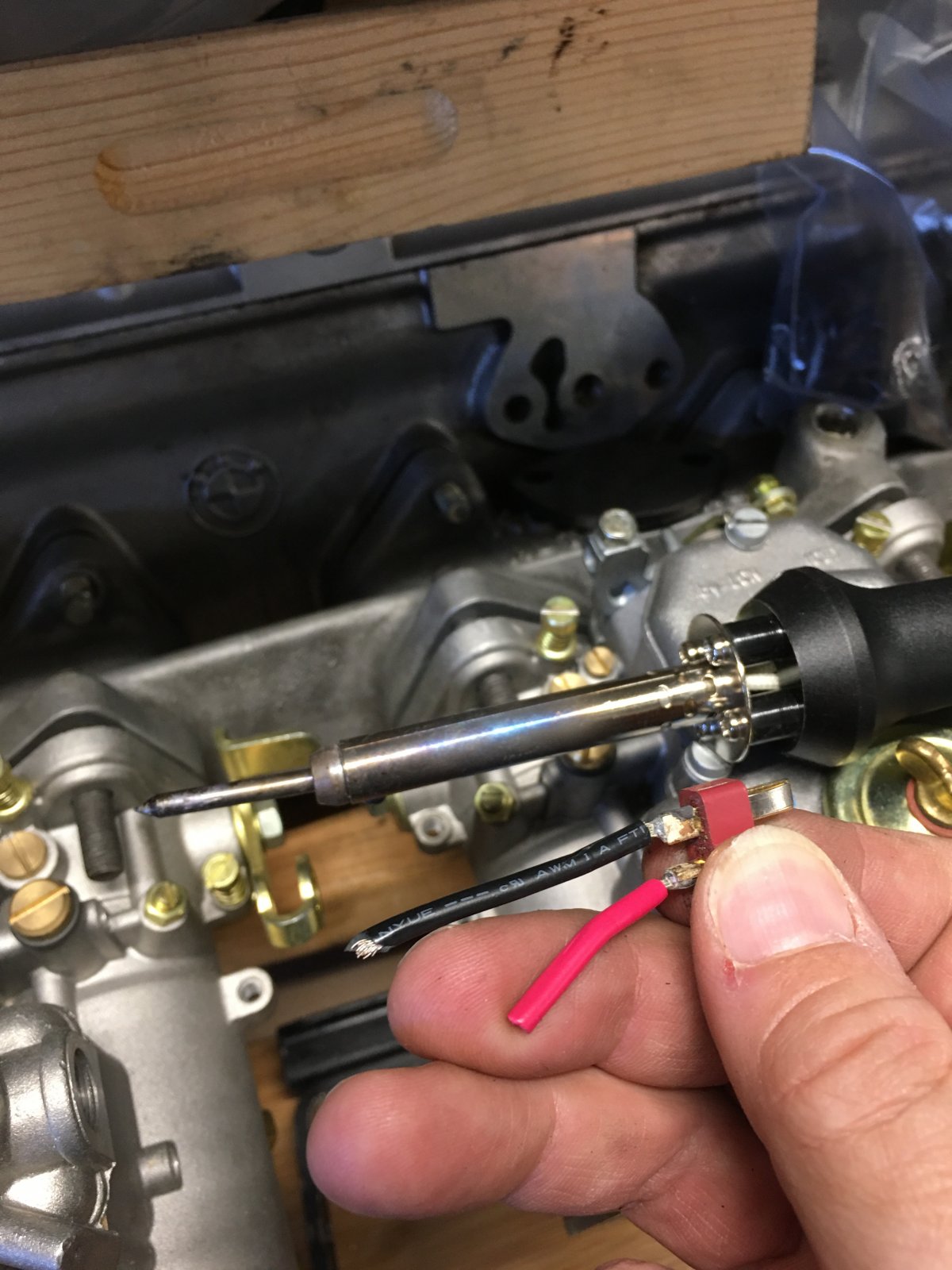

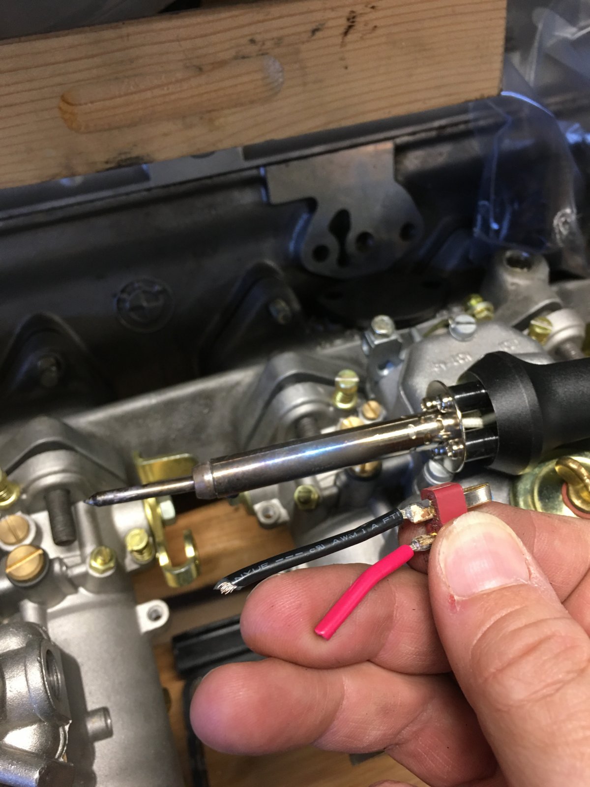

Soldering station. Removing the freyed negative
and the cut positive. Figure it is best to replace
both. This exercise reminded me how god awful my cheap iron is.View attachment 89888
If my wife and kids needed to drive my coupe it would be restored by now! :D
Markos, I recognize that red battery connector. Are you upgrading the go cart with your R/C model parts? o_O :)
Haha no! The red male pin connector came with the cart. The red battery terminals I just used heat shrink on. Harbor Freight sells a multi-pack if heat shrink. Ideally I would like it to cover the terminal but the last bits that I had left were too small.
Your camper is amazing @Fredomatic! Love the curtain job!
Interesting that they provided that style of battery connector. Those are a quality part upgrade for R/C battery systems.
