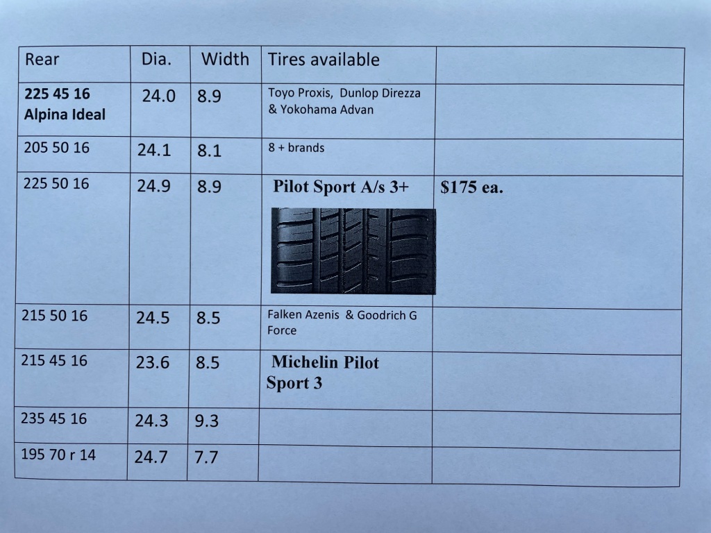

@tferrer - 225/50-15" tires are almost 1" in diameter too small - only 23.9" diameter. here are the recommended sizes in 15" which more closely correlate to the 24.7" diameter of the 195/70-14" original tire
205/60-15 -– dia. 24.7”, width 8.2" / tread width 6.8", circ. 77.6”, rev / mile = 842
215/60-15 -- dia. 25.1", width 8.7" / tread width 7.3", rev / mile = 827
225/55-15 – dia. 24.7”, 77.7” circ, rev / mile = 842 <caution - tire is 9" wide - not many tires available in this size>

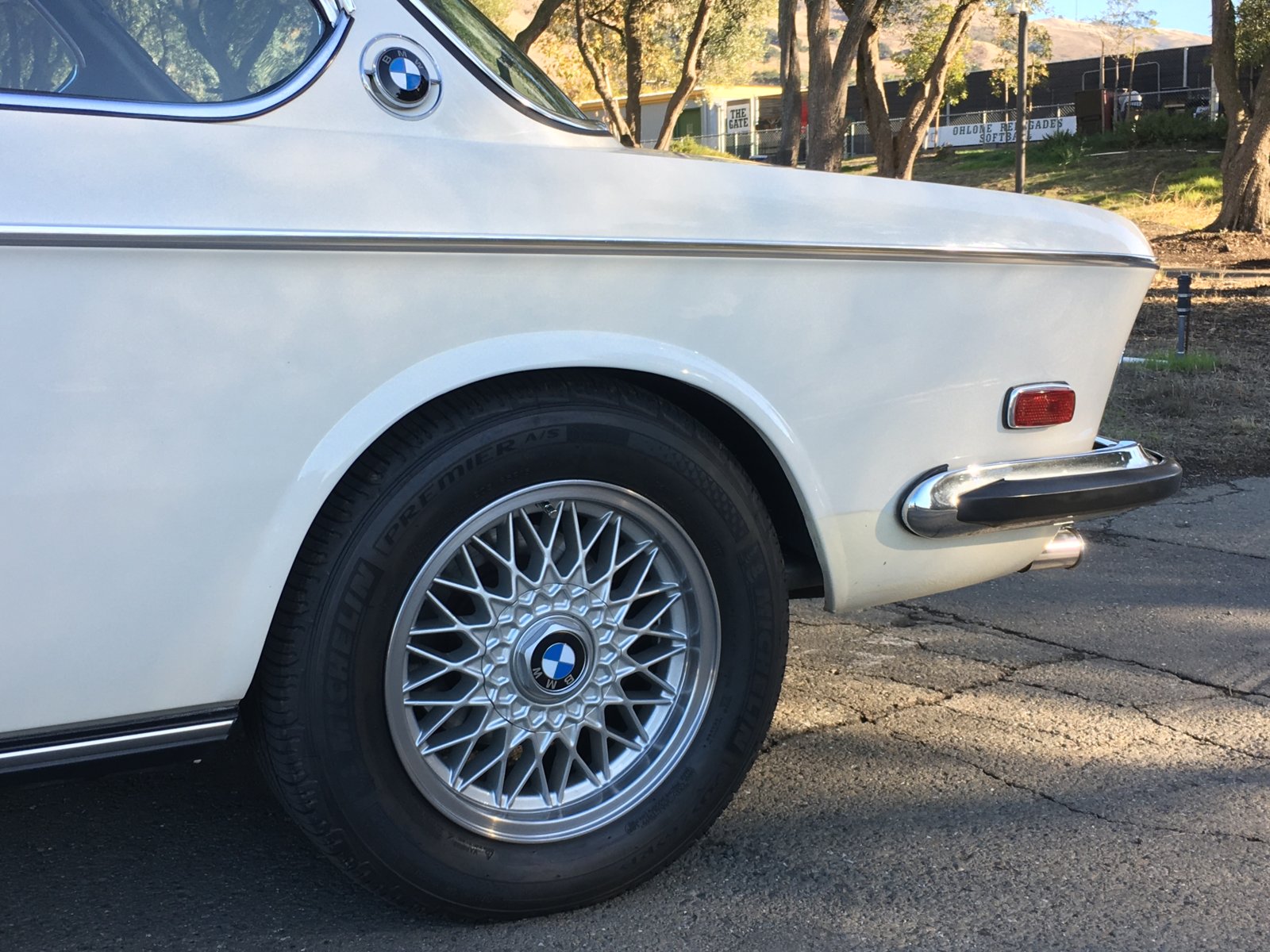

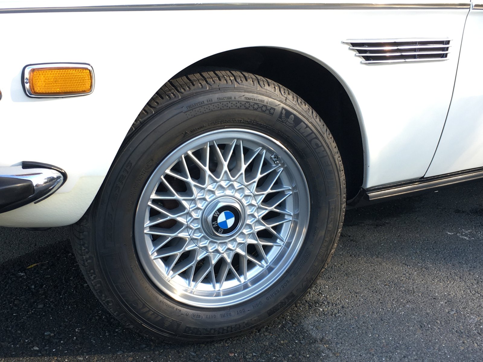

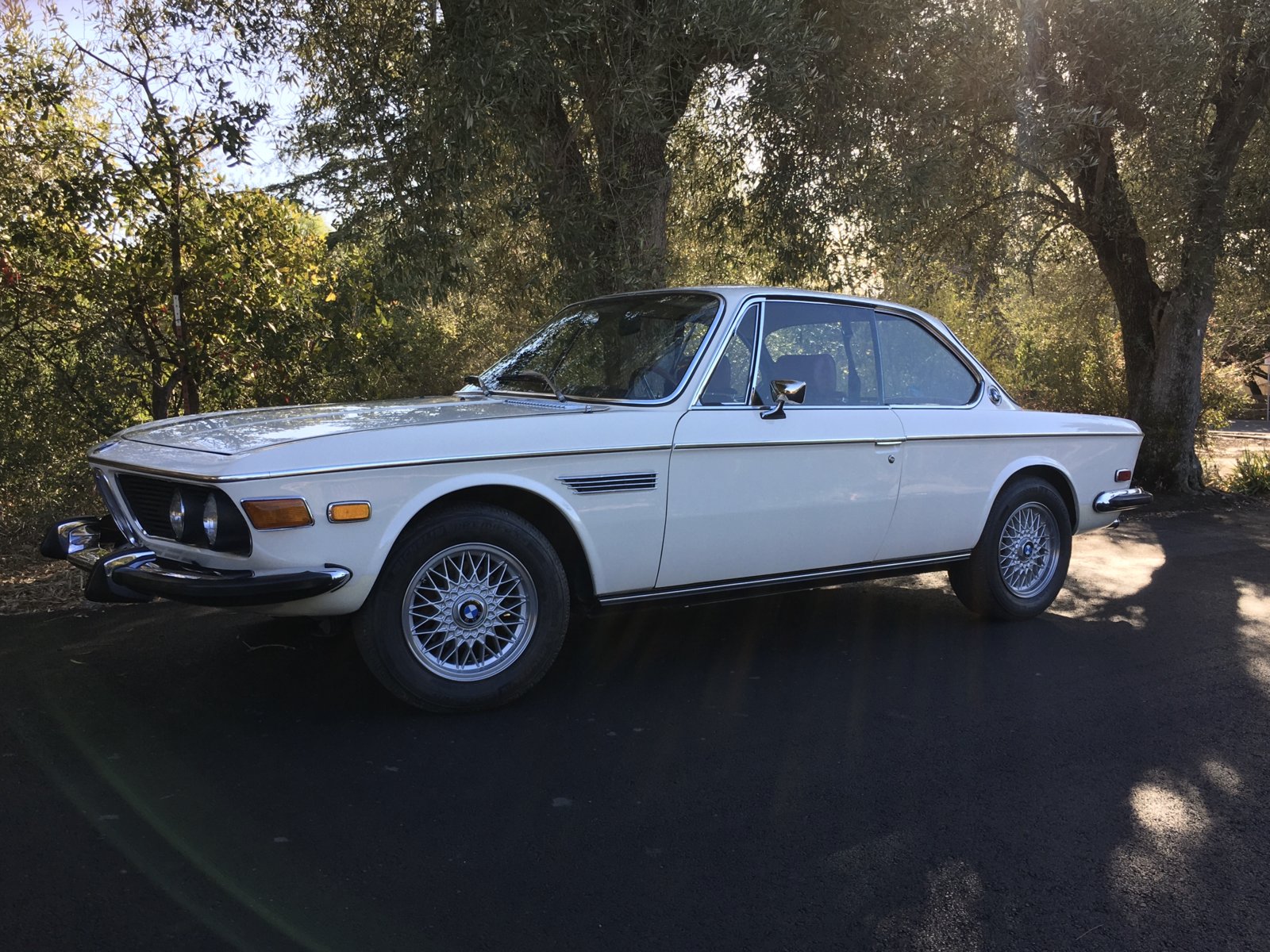

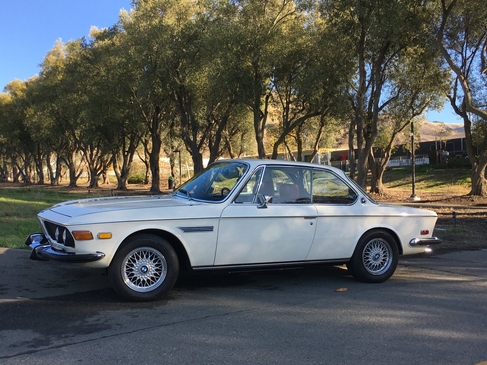

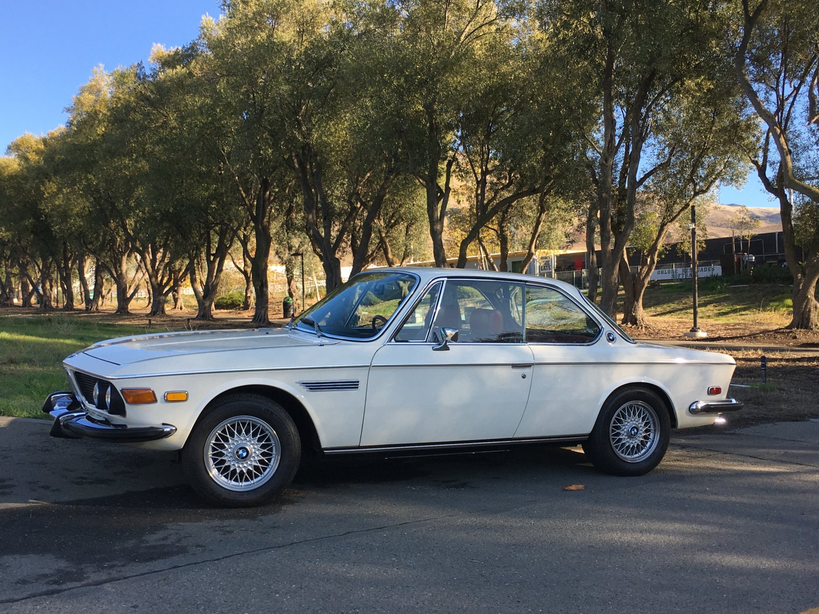

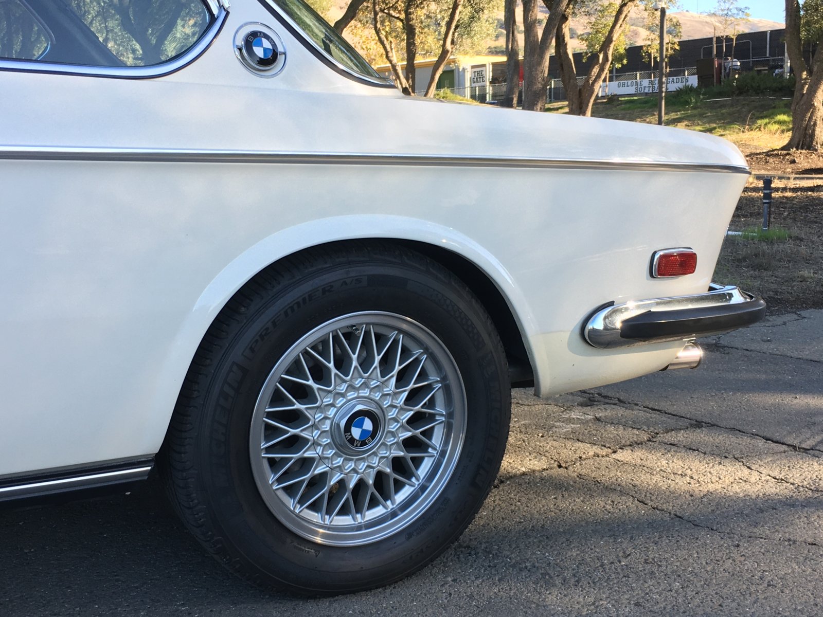

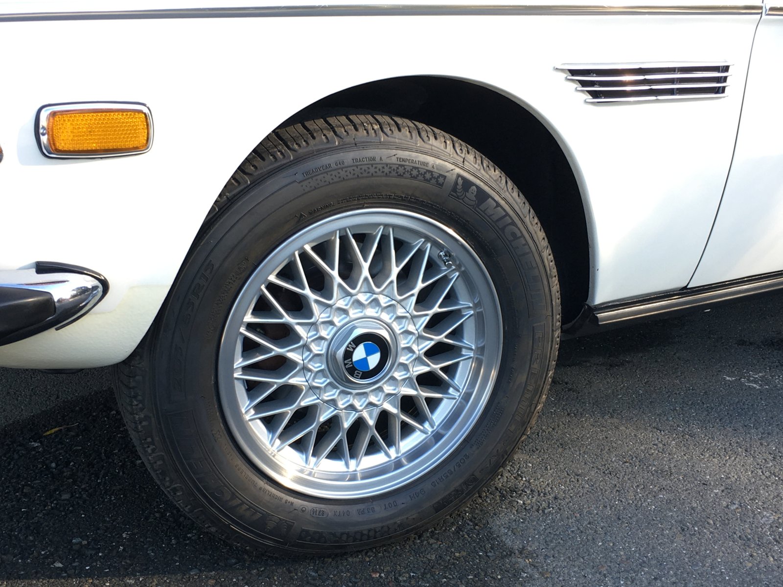

I went with 205/65/15 Michelin Premier A/S on my 15-inch BBS RZ that I refinished from gold. They are 25.47” diameter, 8.2” section width and 7.7 tread width. These are only 0.12” taller than the Michelin XWX 205/70/14 put on the CSL do I figured they would be OK and so far no fit issues. I like the way they fill the wheel wells and provide the ride comfort of a 14” wheel.
I went with 205/65/15 Michelin Premier A/S on my 15-inch BBS RZ that I refinished from gold. They are 25.47” diameter, 8.2” section width and 7.7 tread width. These are only 0.12” taller than the Michelin XWX 205/70/14 put on the CSL do I figured they would be OK and so far no fit issues. I like the way they fill the wheel wells and provide the ride comfort of a 14” wheel. View attachment 107596View attachment 107597View attachment 107598View attachment 107599
Glad to see this post. I looked at the 205 65 r15, but was concerned about the increase in rolling diameter and went with the 205 60s instead. I am running on Carl Nelson lowering springs, so this may be a closer call for my car, but I am a fan of Michelin, and the don't offer anything in the 205 60 r15 size.
And I too like both the look and ride comfort of 15s over anything larger, even though tire selection is not as robust.
I was little unsure about the size also but decided to try them. One reason I took the leap is the unavailability of the Michelin’s in 205/60 series. I talked about it with OCcoupe and he agreed I should be fine because they are so close to the CSL diameter. I am careful at driveways. They only change the speedo two mph at 70 and our US 3.0s are geared lower than Euros. If I ever lower it I would have to add camber plates since the front tires do stick out past the fenders a bit. I wouldn’t want to role the fenders on such an original car.

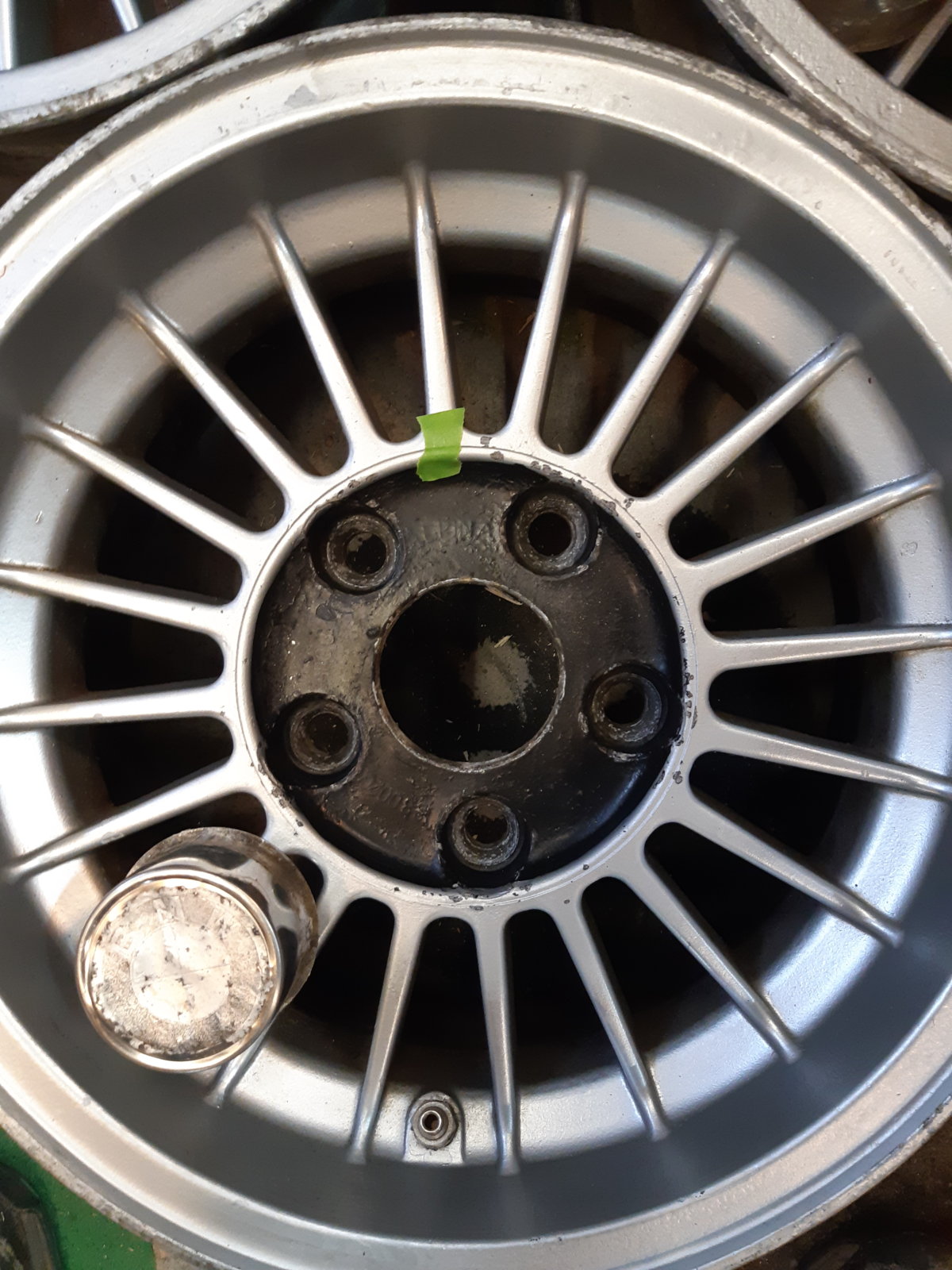

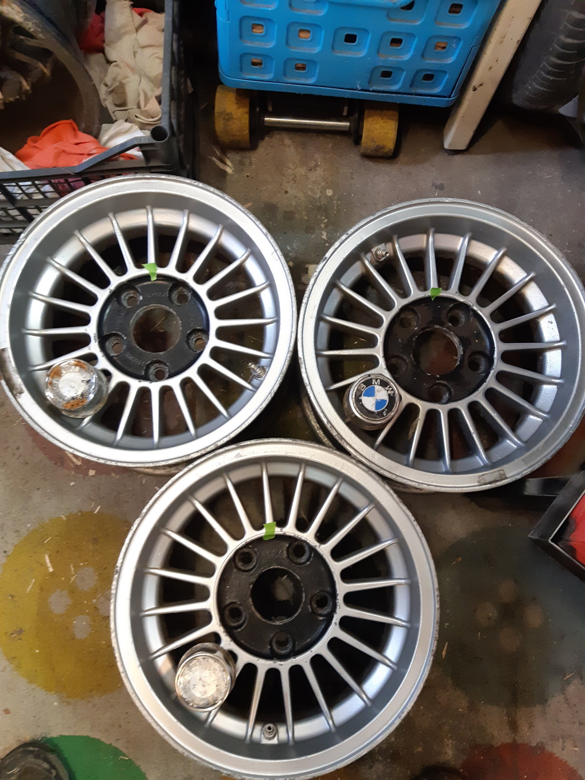

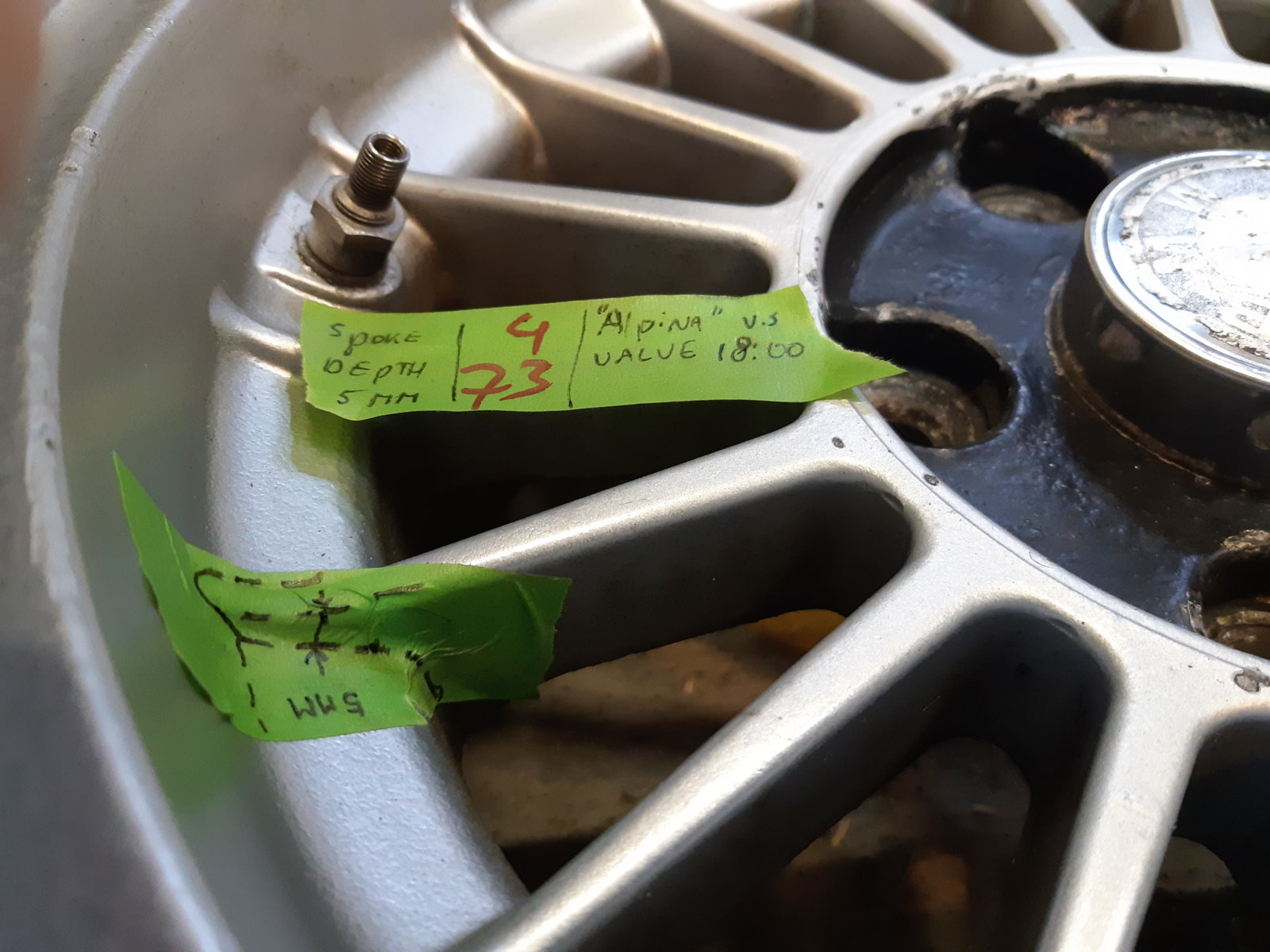

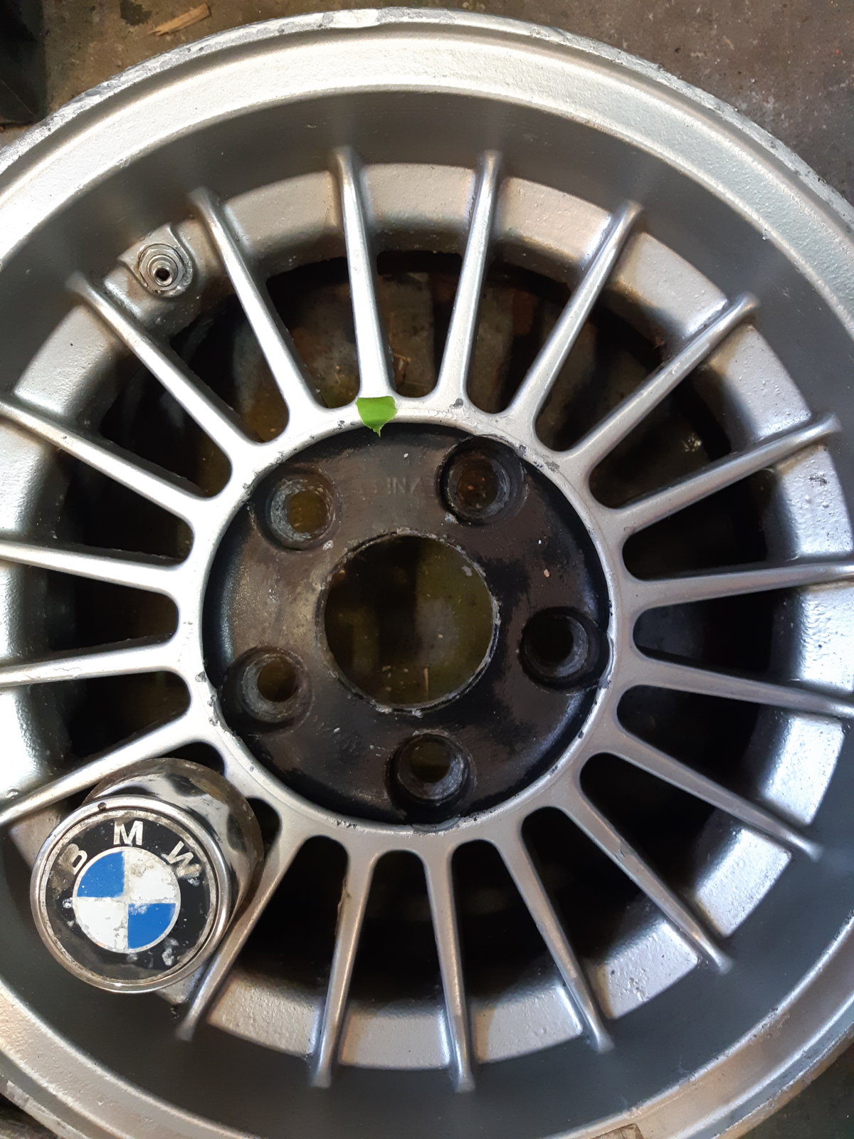

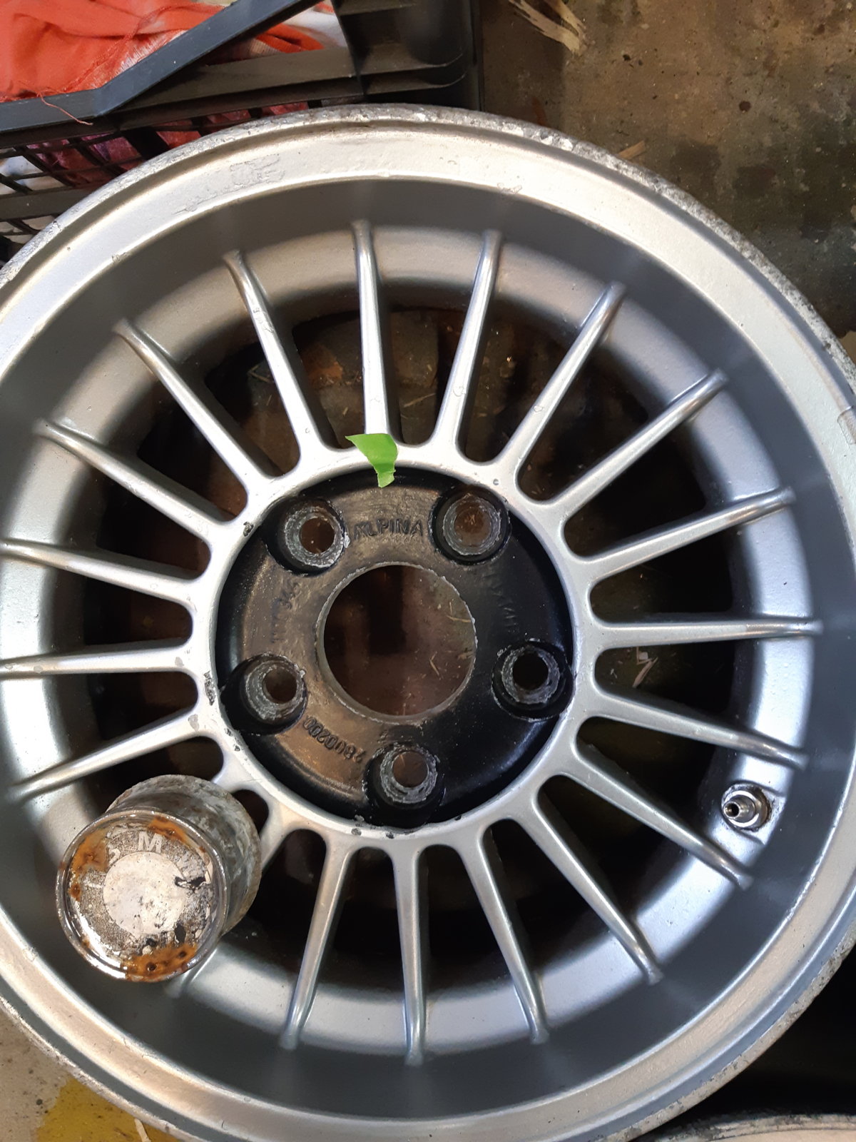

Just something to add wrt original Alpina CSL wheels. I picked up a set, knowing one was an FPS, but the other three classify as 'type 2' following the definition in the initial post.
All three wheels have " Alpina, 110344, 7jx14H2 and 2800200" on them, and all of them have different date codes. In the pictures I've placed a small green piece of tape pointing at the "Alpina" text.
RSPorsche identified in post 1 of this thread already that the valve position changed relative to the "Alpina" text:
3 versions are known (sofar) With the valve set at 06:00, the "Alpina" text appears at 11:30, 14.00 and 19.00.
editted feb 2021: One of my wheels clearly has the valve at 16.00.
(this is a mistake form my side; i reasoned here 'having the Alpina text at 12:00, where does the valve sit?'. whereas RSPorsche defined it as 'with the valve at 06:00; where does the 'Alpina' text sit. Using the right (RSPorsche's) definition, my wheels aren't different. see updated list below. )

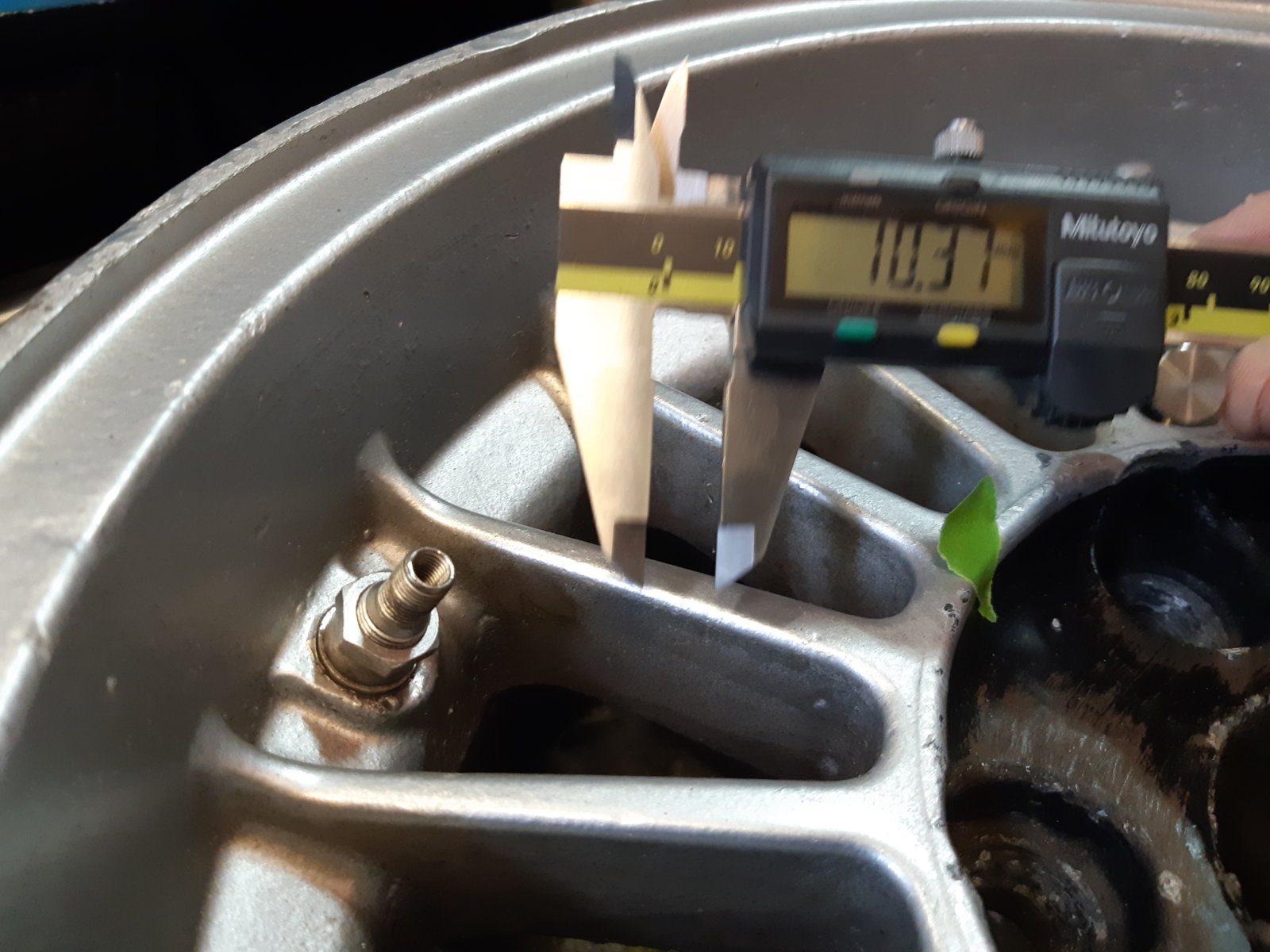

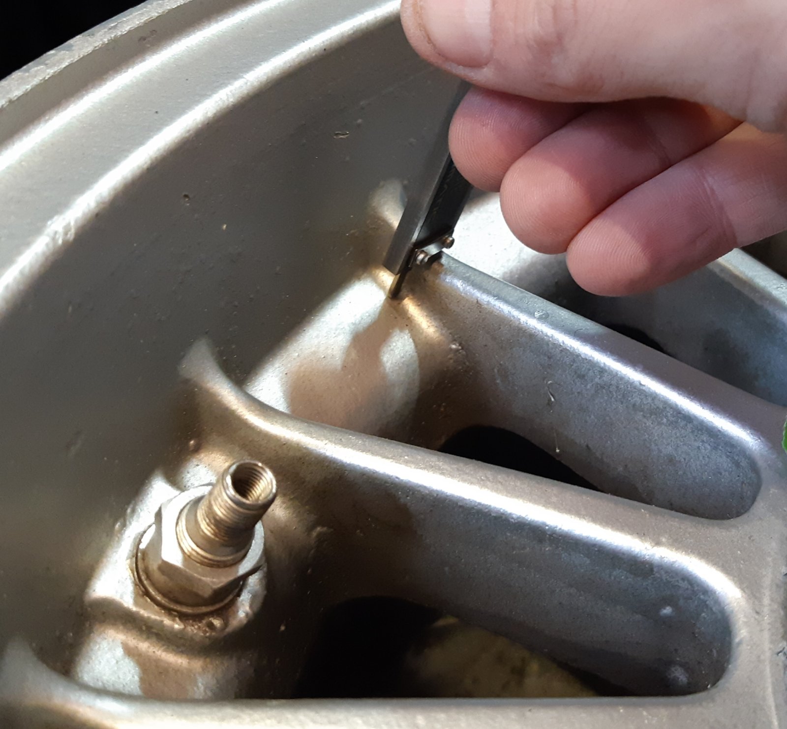

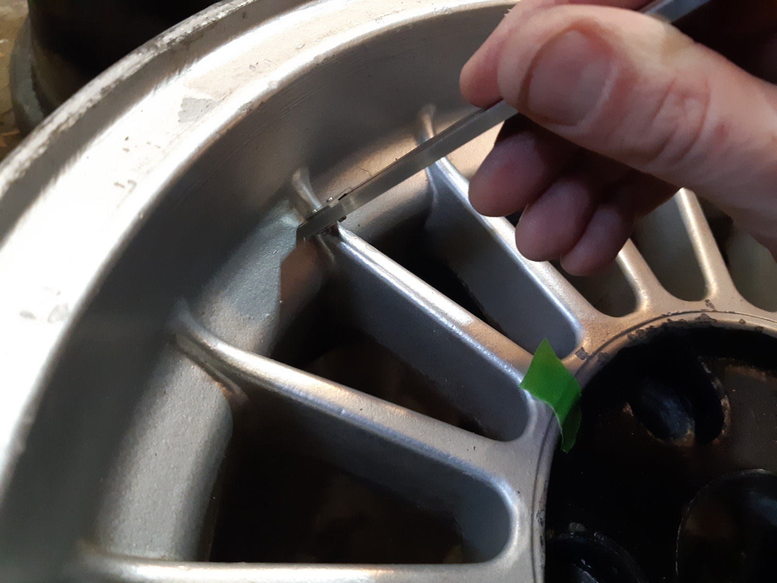

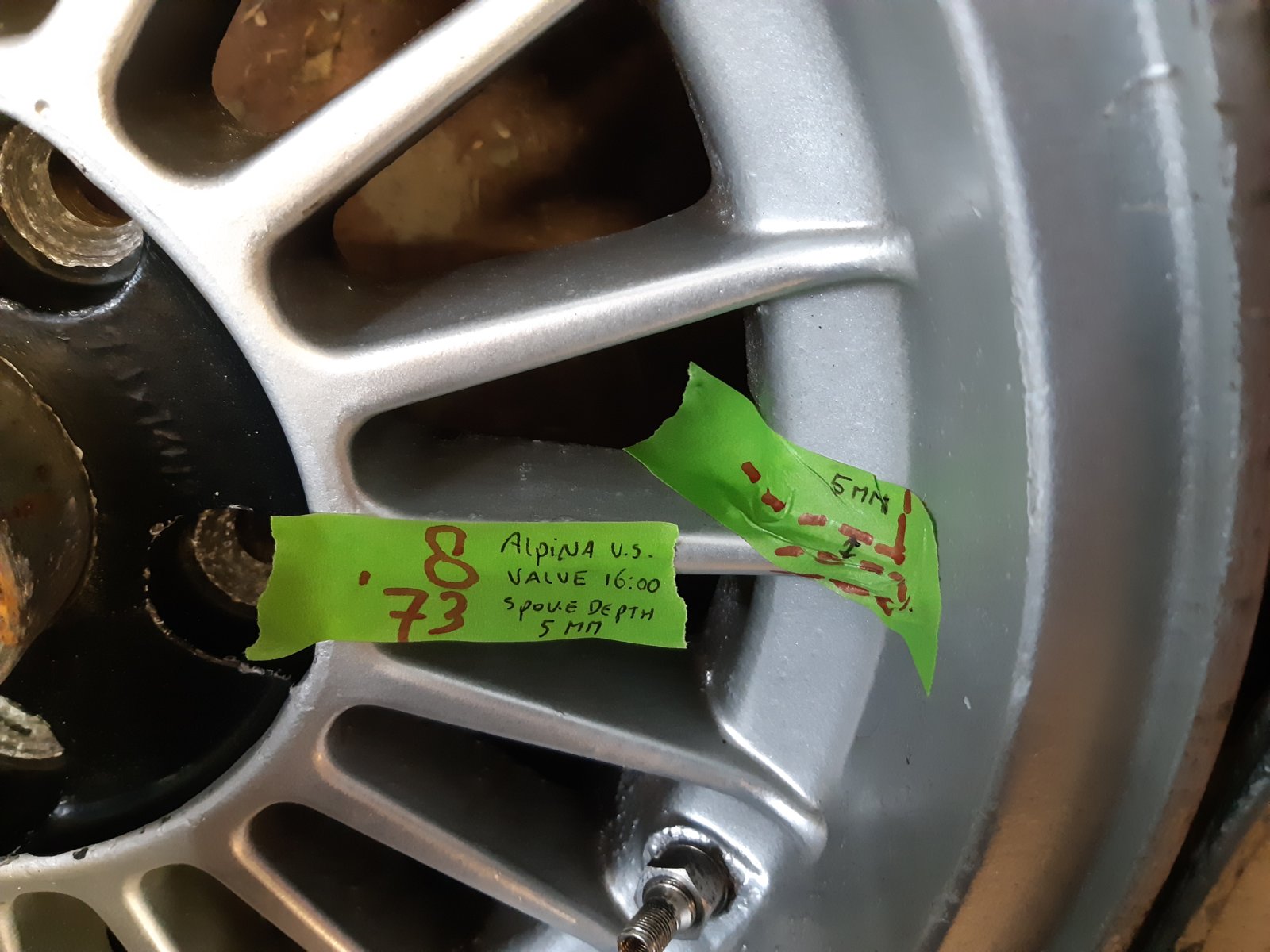

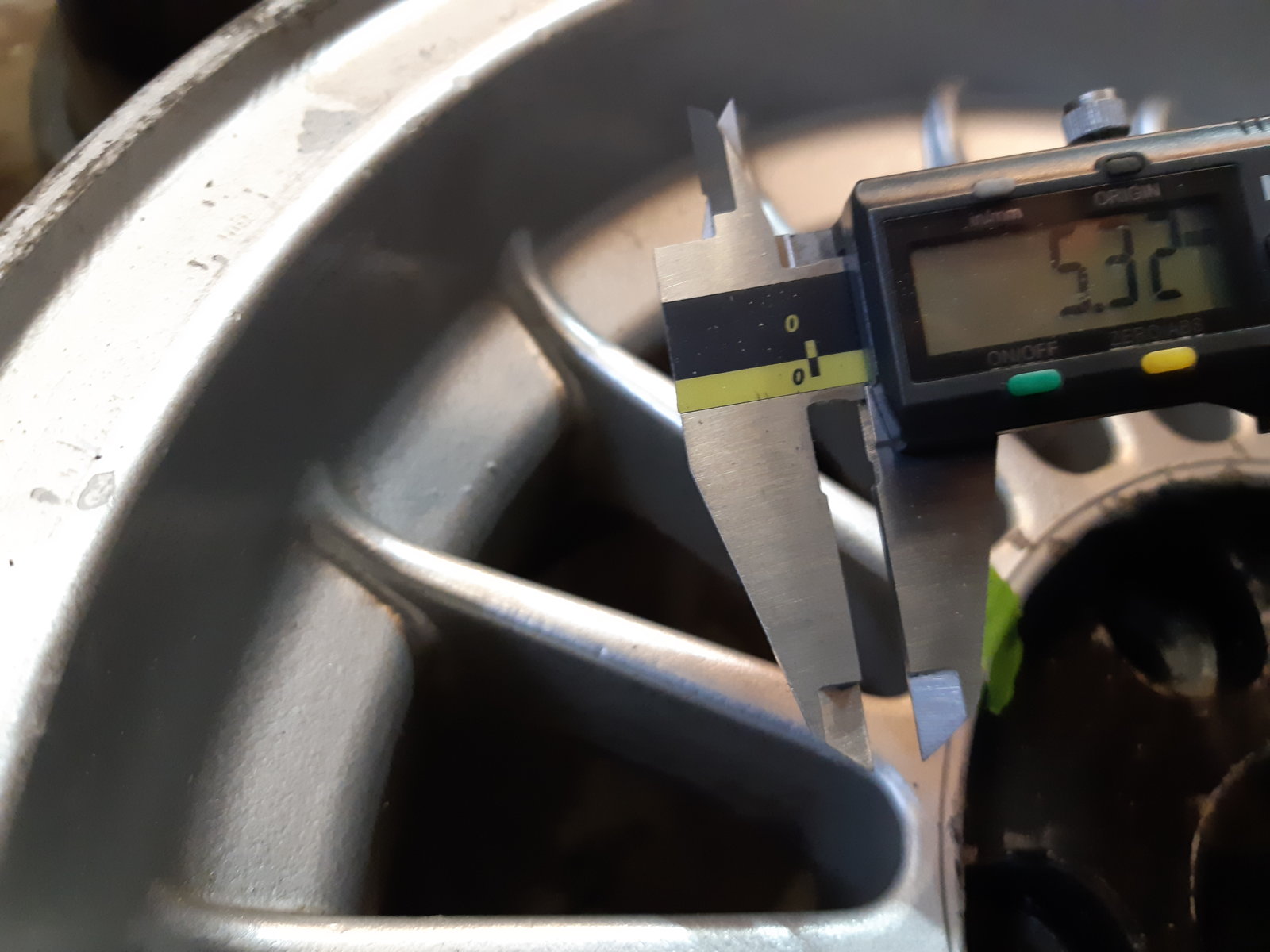

However I noticed there is another difference: the "height" of the spoke relative to the edge. One wheel has 10 mm, where the others have 5 mm spoke height. (See pics)
I have the following three differences in the wheels.
(edited feb 2021)
Wheel 1, valve at 16:00, with valve at 06:00 the "Alpina" text sits at 14:00 , dated 8-73 spoke depth 5mm
Wheel 2 valve at 18.30, with valve at 06:00 the "Alpina" text sits at 18:30, dated 4-73 , spoke depth 5mm
Wheel 3, valve at 11.30, with valve at 06:00 the "Alpina" text sits at 11:30, dated 7-72, spoke depth 10 mm
added feb 2021: Can other members check which date codes they have and measure their spoke height?
So, perhaps to be able to identify a correct set, you need to align many things: date stamp, part number, KBA approval numbers, valve position and spoke height.
