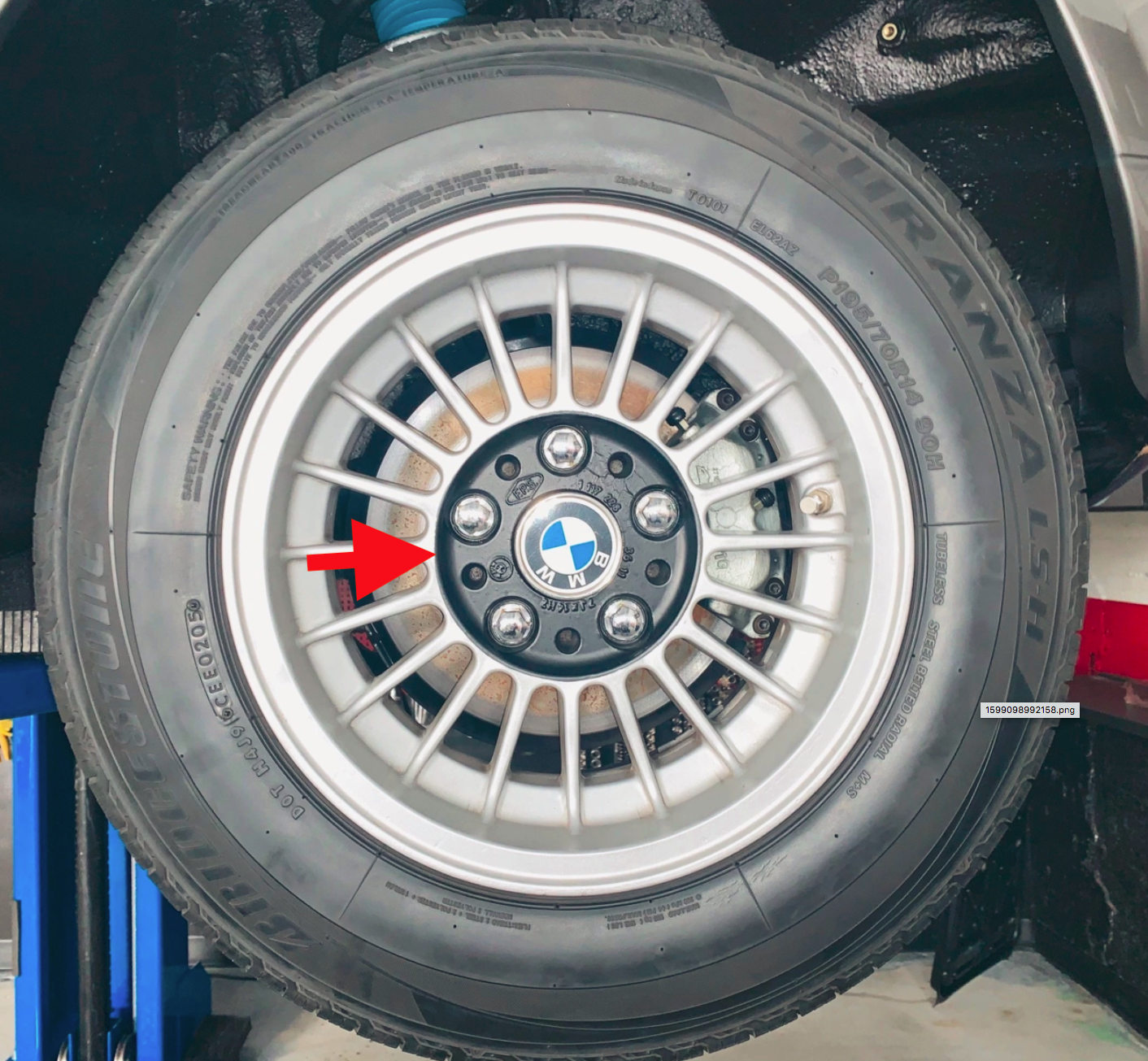

Hi Guys.
Where should the color change on this wheel? Is there any measure? on the round edge?

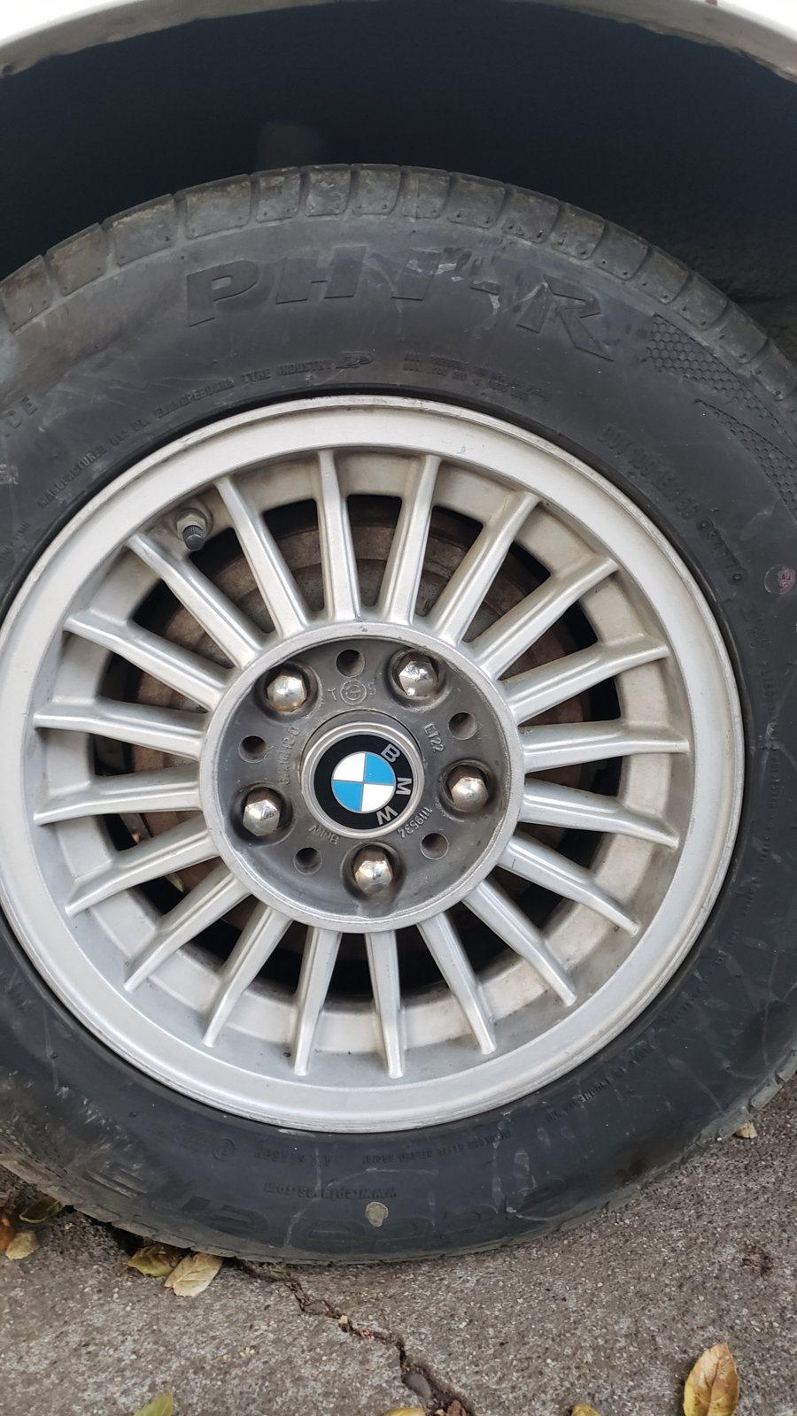

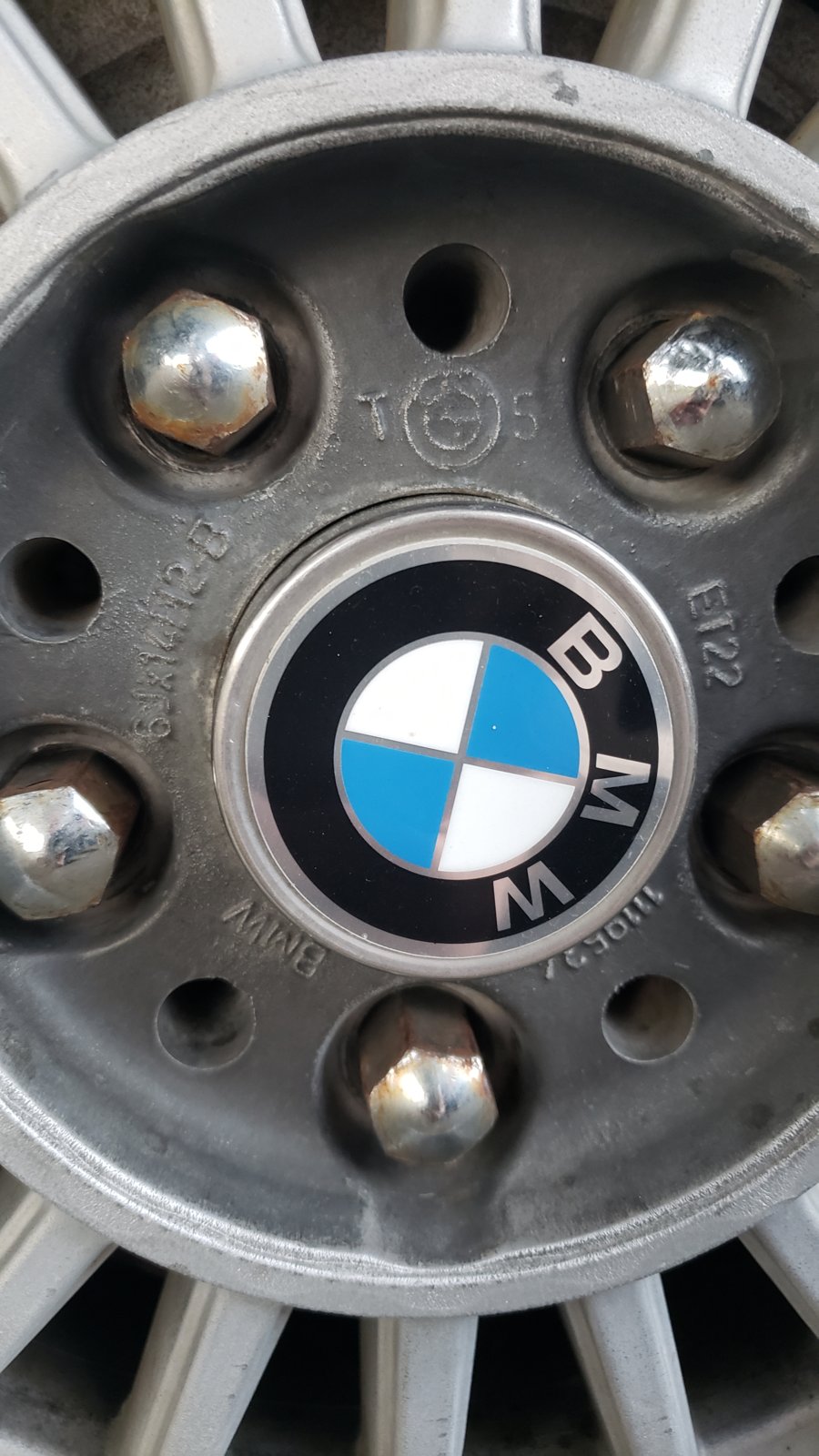

@rsporsche My 2800cs had Alpina looking wheels when I bought them (still does) but I'm not sure if they are real Alpinas. They have BMW stamped near the lugs but no Alpina stamp. Here are some pics - any thoughts?
