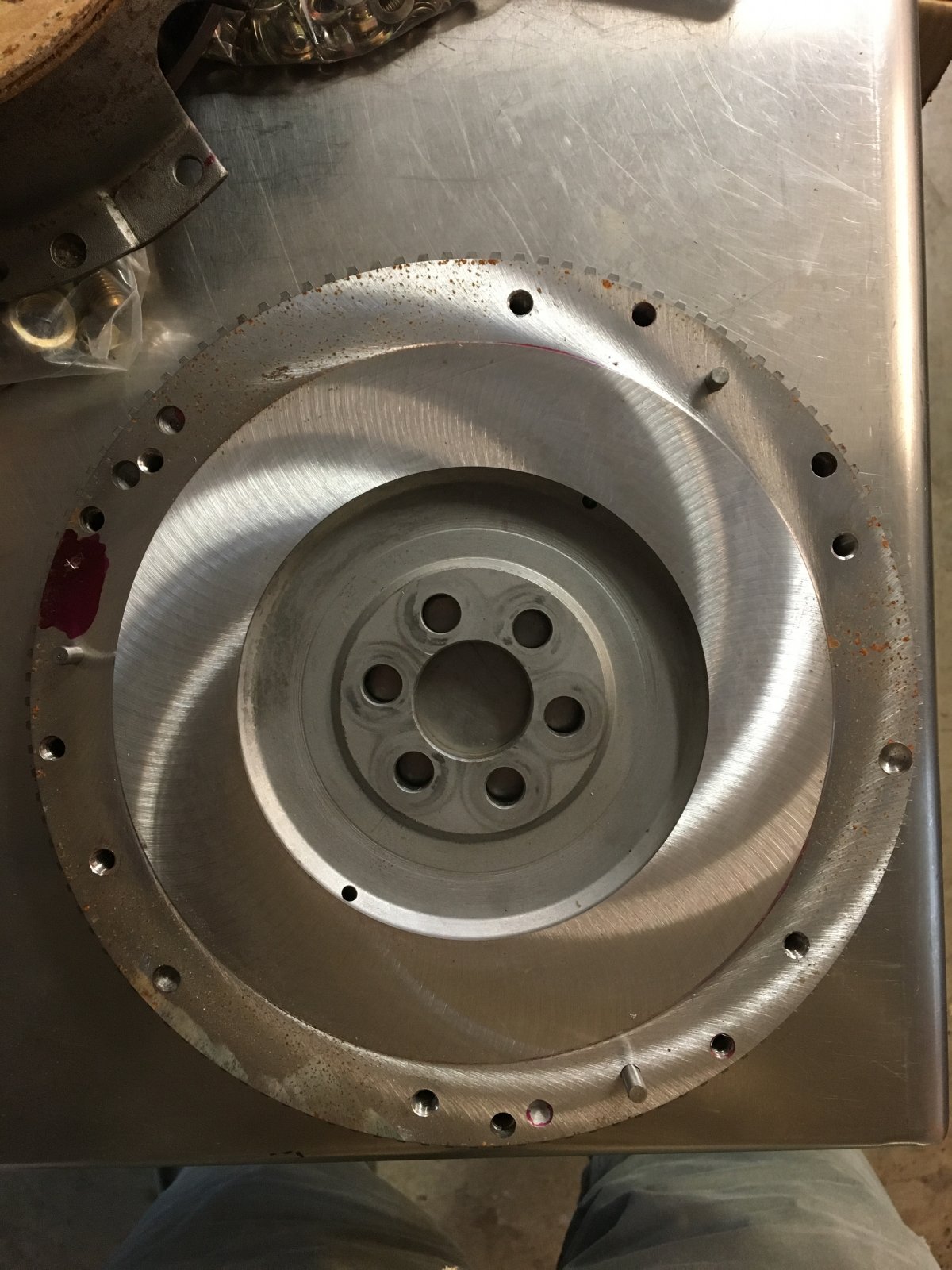

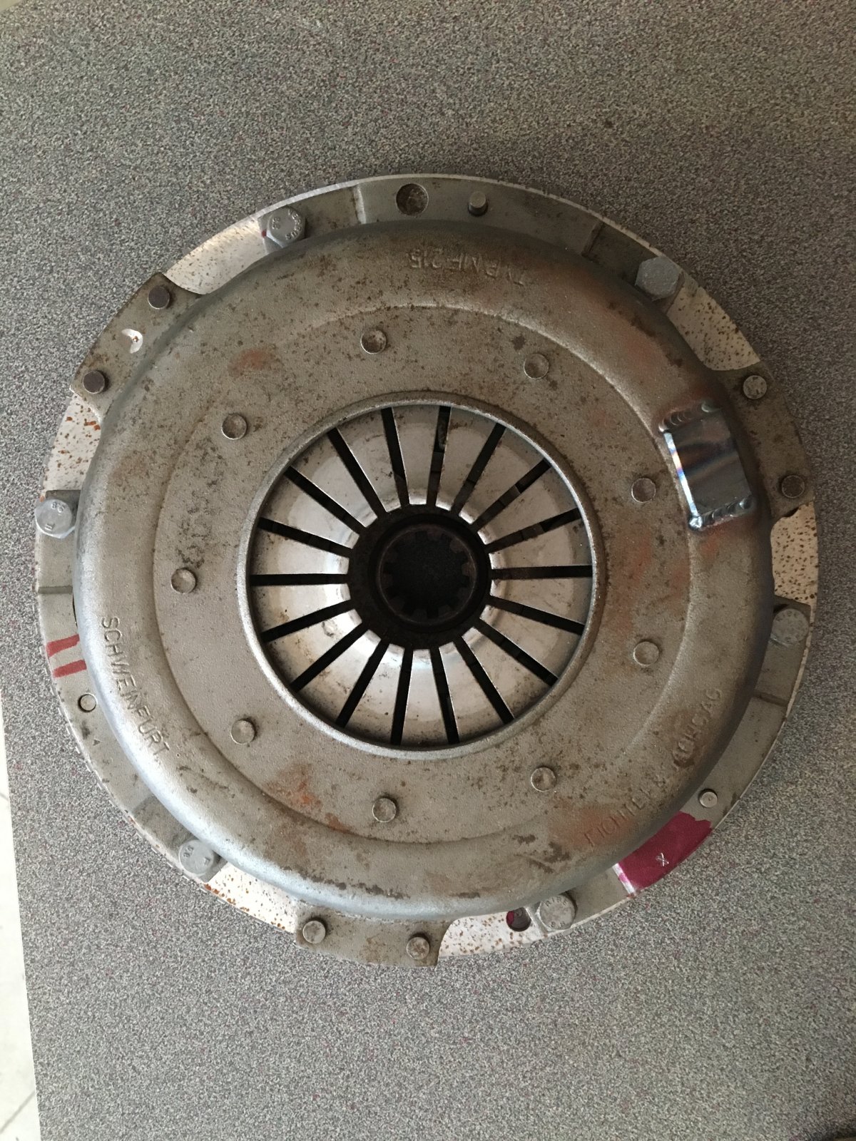

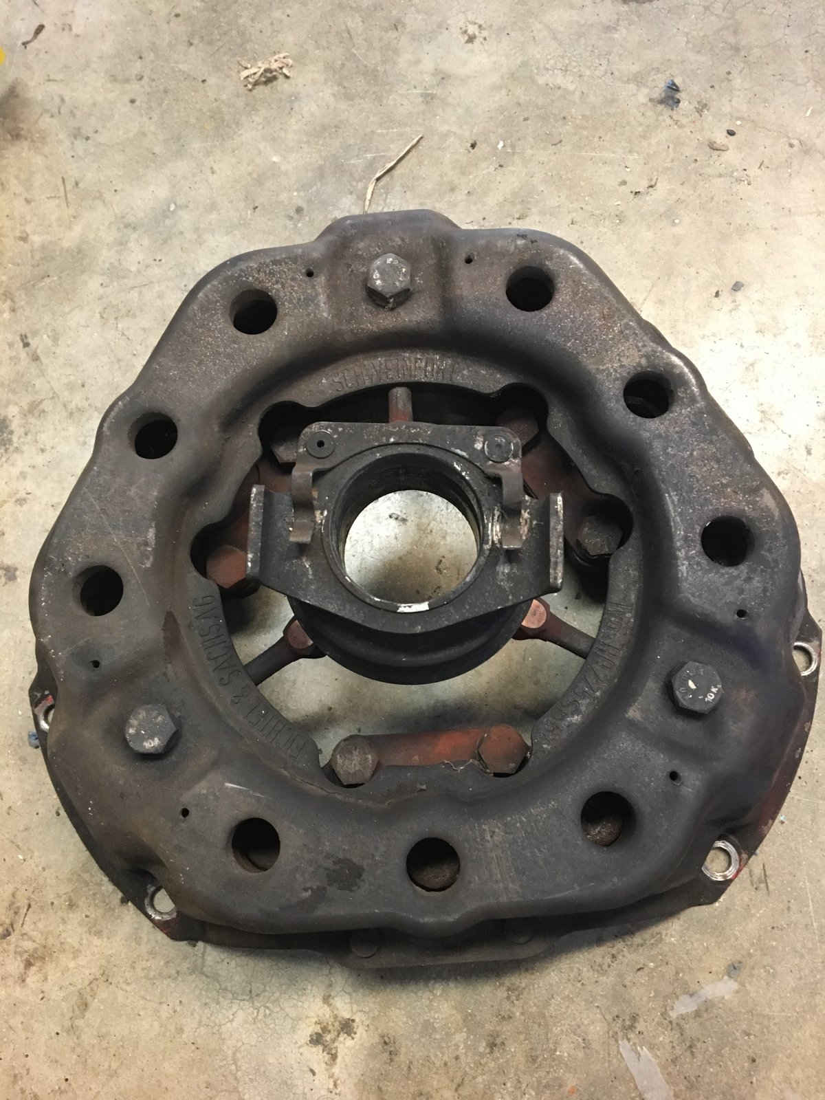

Five speed would be great, but if motor is original it has a six bolt flywheel to the crank, three finger pressure plate with the very early large t/o bearing which is NLA. Solution is drill flywheel for modern pressure plate and t/o bearing or swap crank to an 8 bolt style with flywheel. Someone did this to my Manila 69 three or four owners after me but I don’t know what approach they took. The 2002 was a 3.64 diff BTW.
I had to do that to get a 5 speed into my ‘67 2000CS. Race machine shop made quick work of it.
