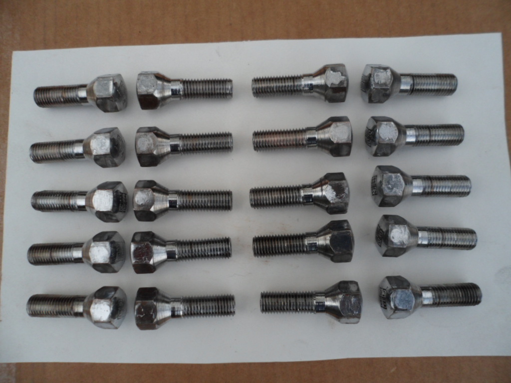

WTB--Lug studs from an E3/Bavaria that are at least 1 3/4" long
Drew Gregg
1,574
1,210
Ft. Lauderdale
Need all 20 of them to replace the short studs in my rotors on a 3.0CS. Bought 16" BBS wheels and need longer studs to mount them.

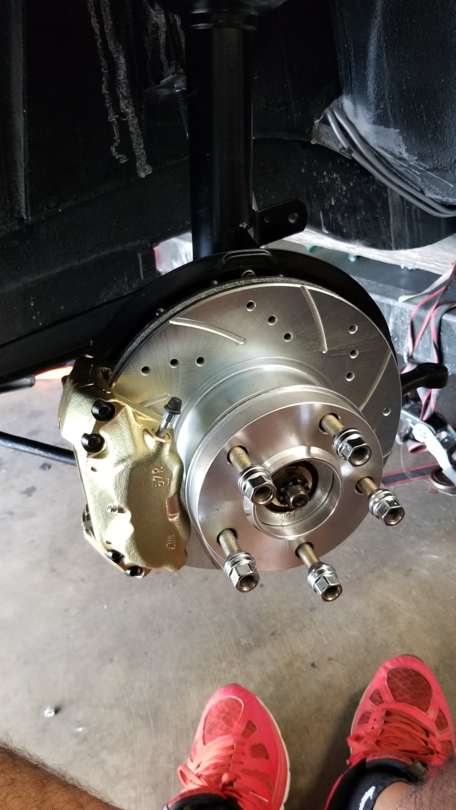

I used the summit racing ones also. Same thread pitch and longer. Running BBS RS also and the studs are fine. 20180826_132817.jpg

Great sources! Note the studs at both sites are the same 265mm (2.60")length. The OEM stud is only 48.5mm long. Where can I buy those drilled & slotted rotors? And where did you get new calipers? I might need them. I also found a company that makes lug studs--Dorman. Don't know yet if they make a 2.60" stud.
Drew, Dorman may be the OE manufacturer on the summit racing ones, not 100% sure. The calipers were rebuilt then re zinc plated by Jim at Mesa (he sends them out...jim is great and a real good resource for us in OC), front rotors were Ireland engineering...just add the drill and slotted option when u buy them. Rears, a buddy with an early e24 had a new set of rotors he gave me (must be 272×19) then I had them drilled and slotted.

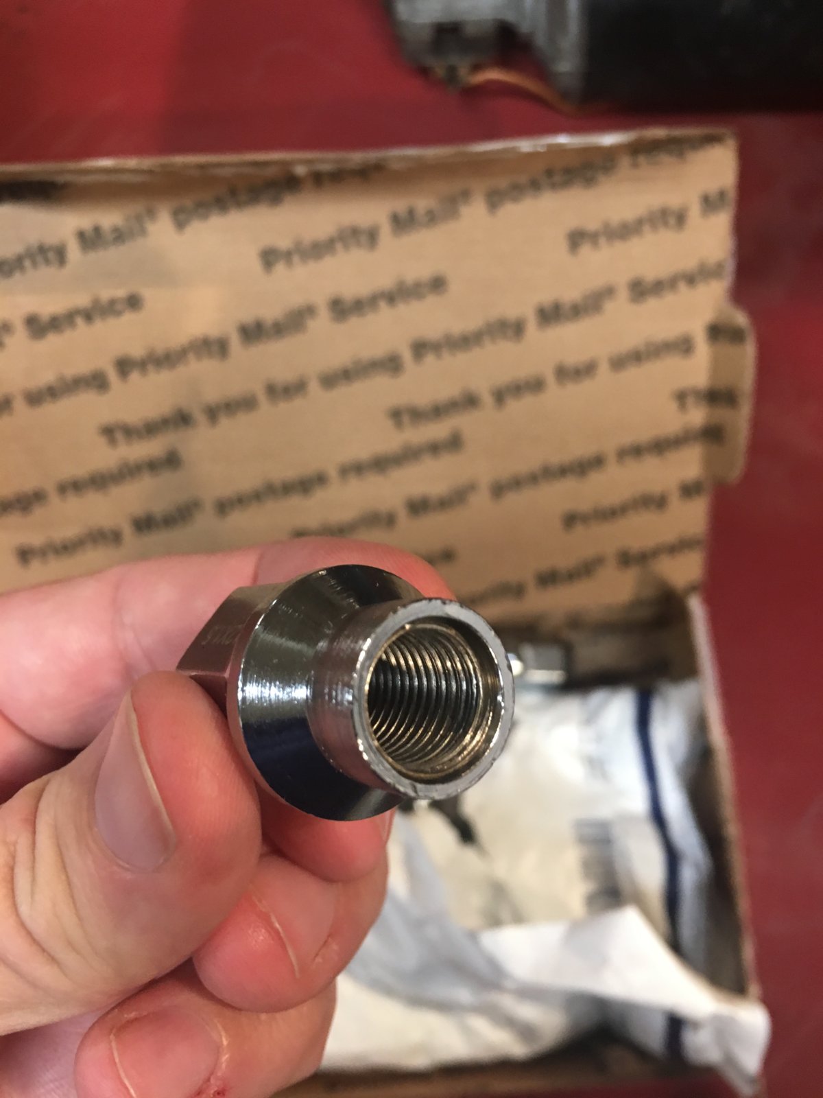

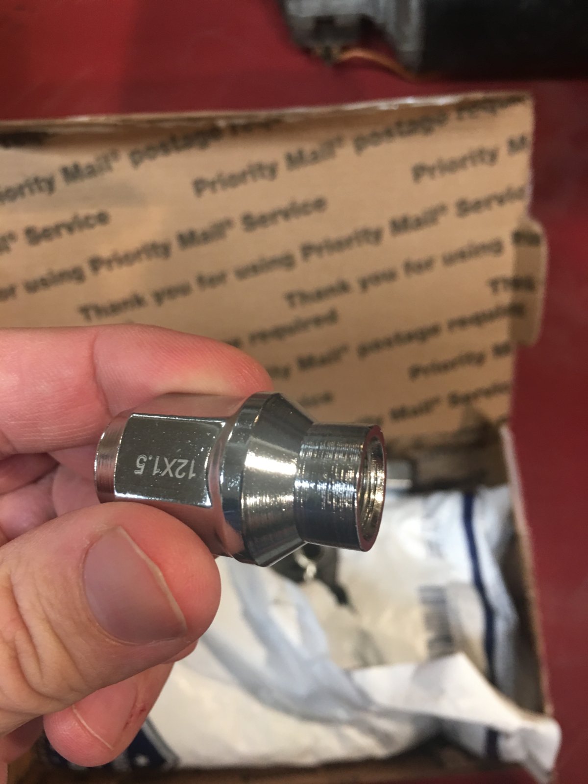

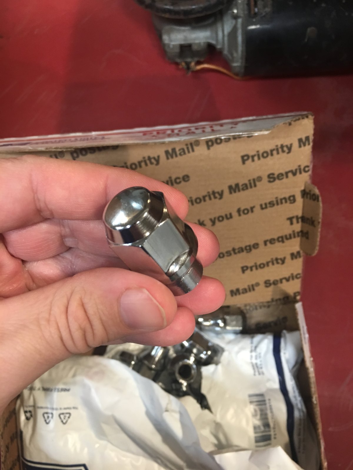

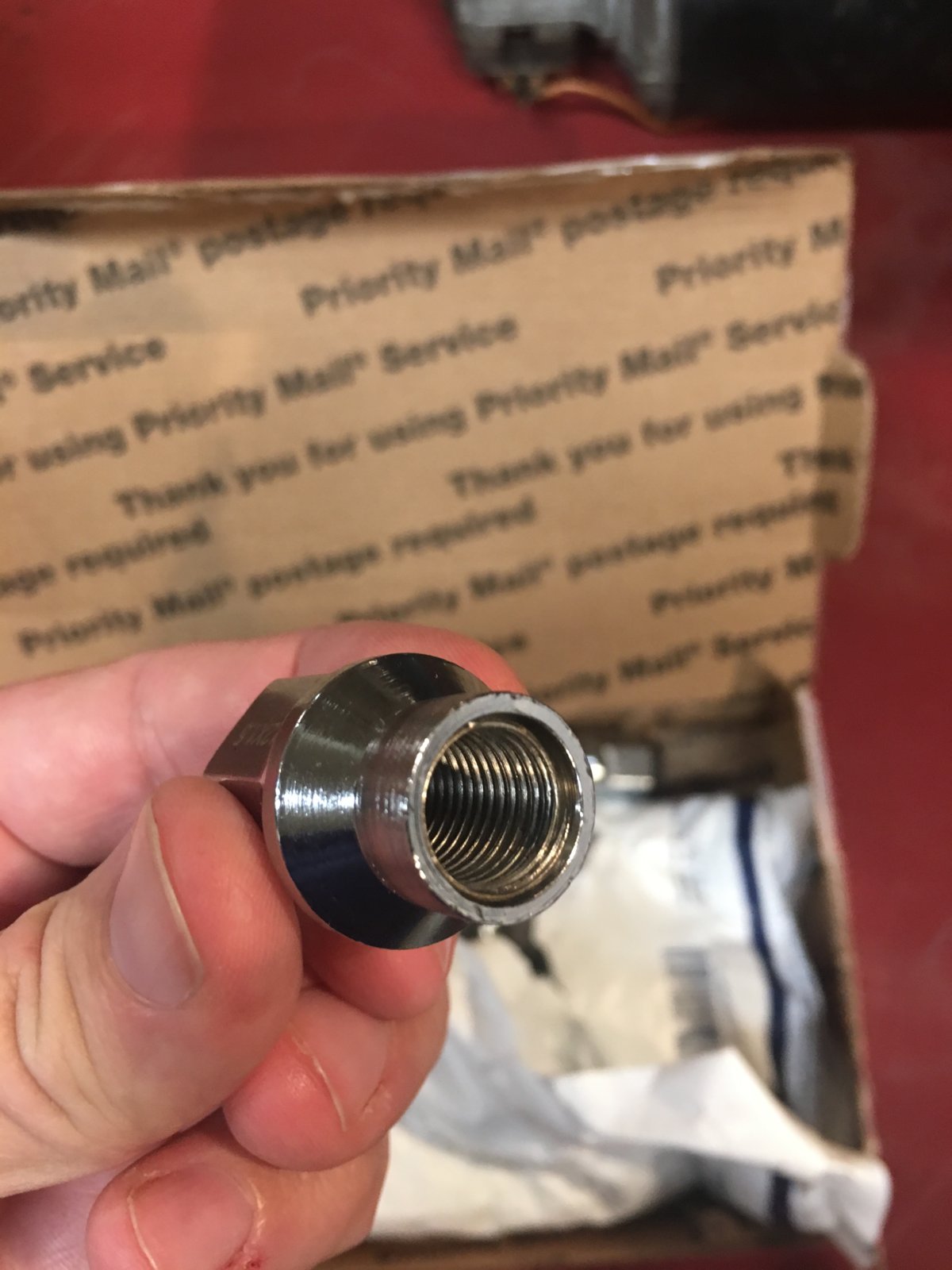

If you just want to fit-test the wheels, you can buy a set of nuts like these:

Markos--I test fitted the BBS on my stock hubs. The studs barely let me screw on the OEM tapered lug nuts. The stud was 16/32" short in the front and 13/32" short in the rear. I measured the depth with a tire tread gage. So I need 1/2" longer studs. Or can I use these extra thread lug nuts you have pictured? Where do I buy them? Could you possibly lend me one nut to see how many turns I can get on my existing studs to make sure this is a safe way to avoid tearing apart the calipers? Thanks--pics here to show you the wheels on the lug studs, and 2 OEM lug nuts screwed down in the tapered holes .
