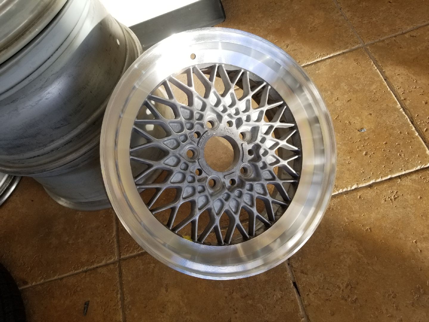

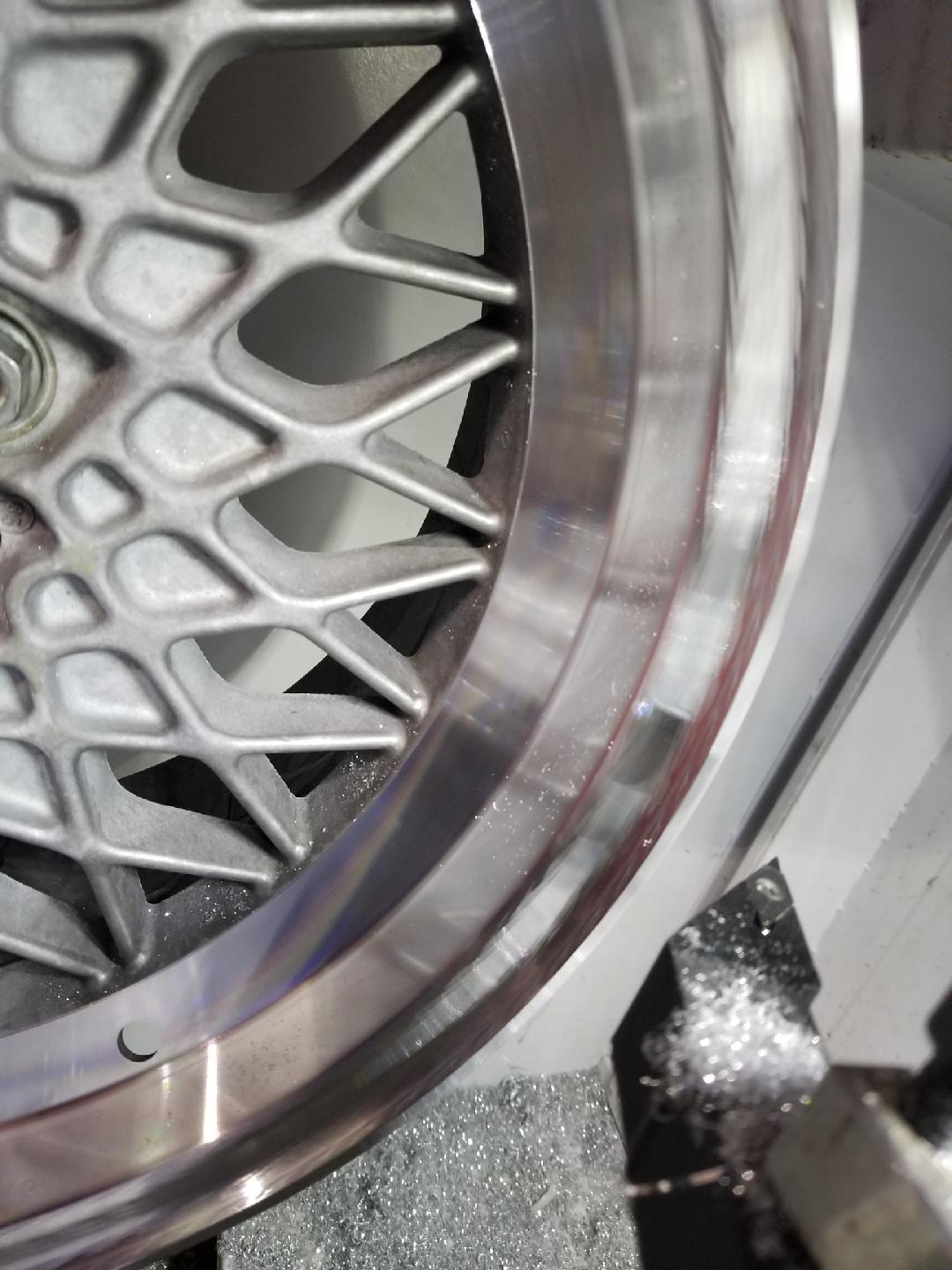

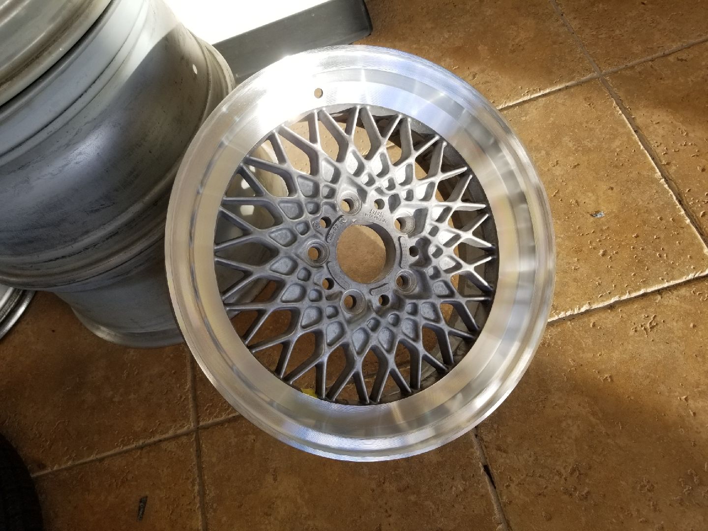

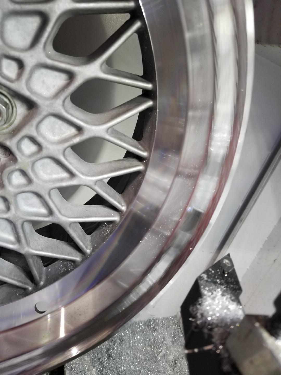

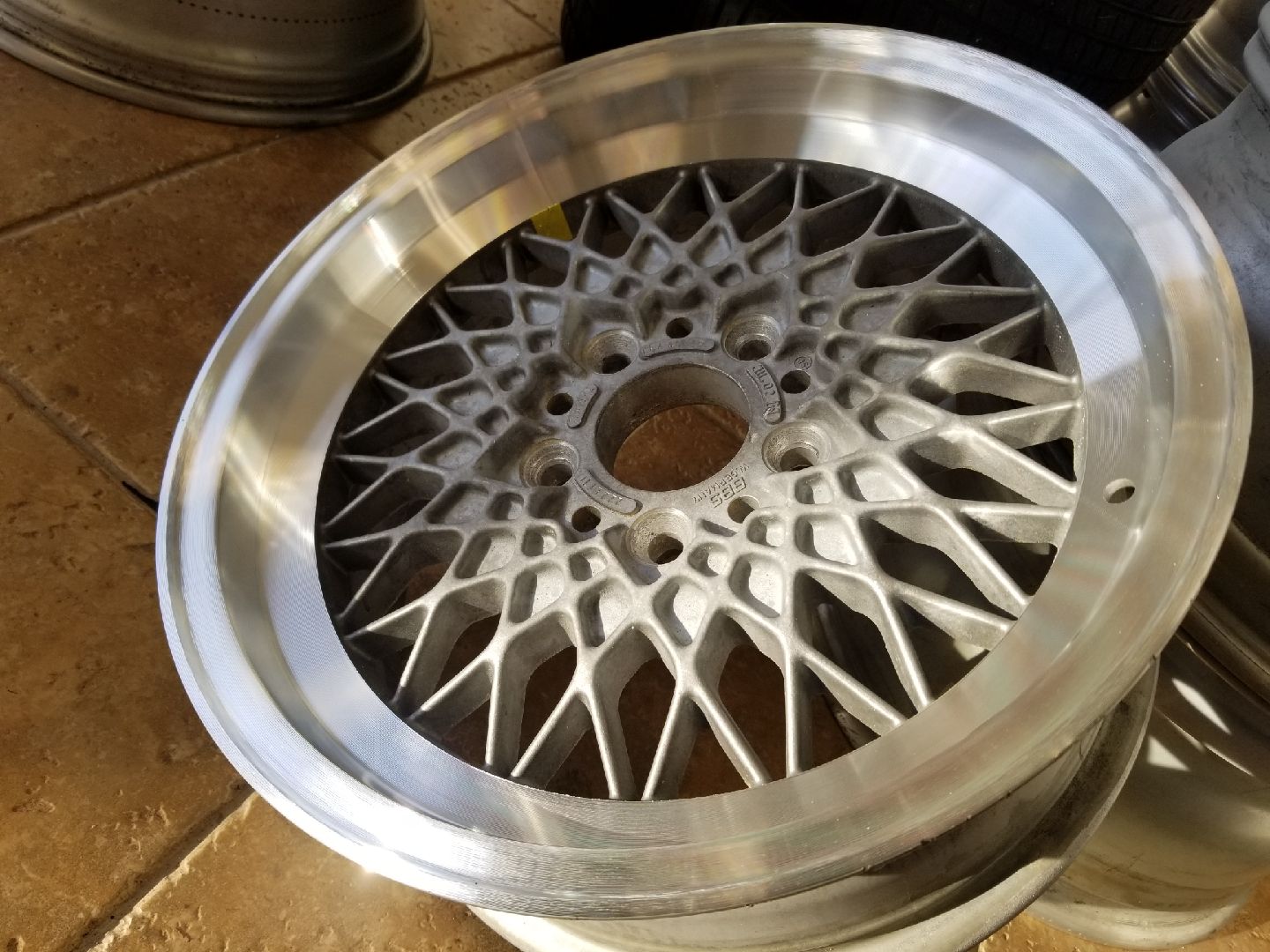

One thing you can do is have the lips machined. You can't do it though if the wheels are out-of-round. These are pics from a buddy in Seattle...
I think the guy in Texas paints the centers after mirror polishing the rims. Then they get a clear coat. Here's the pic of the wheels on the passenger side w/o tires.
Beautiful car and nice color combination.

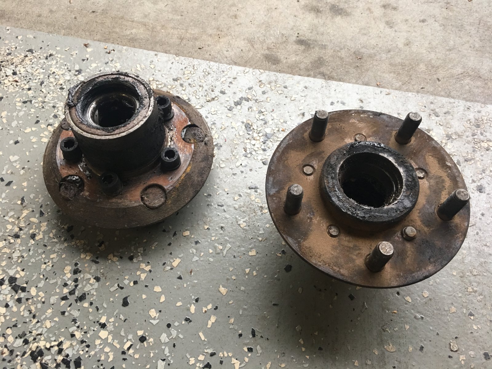

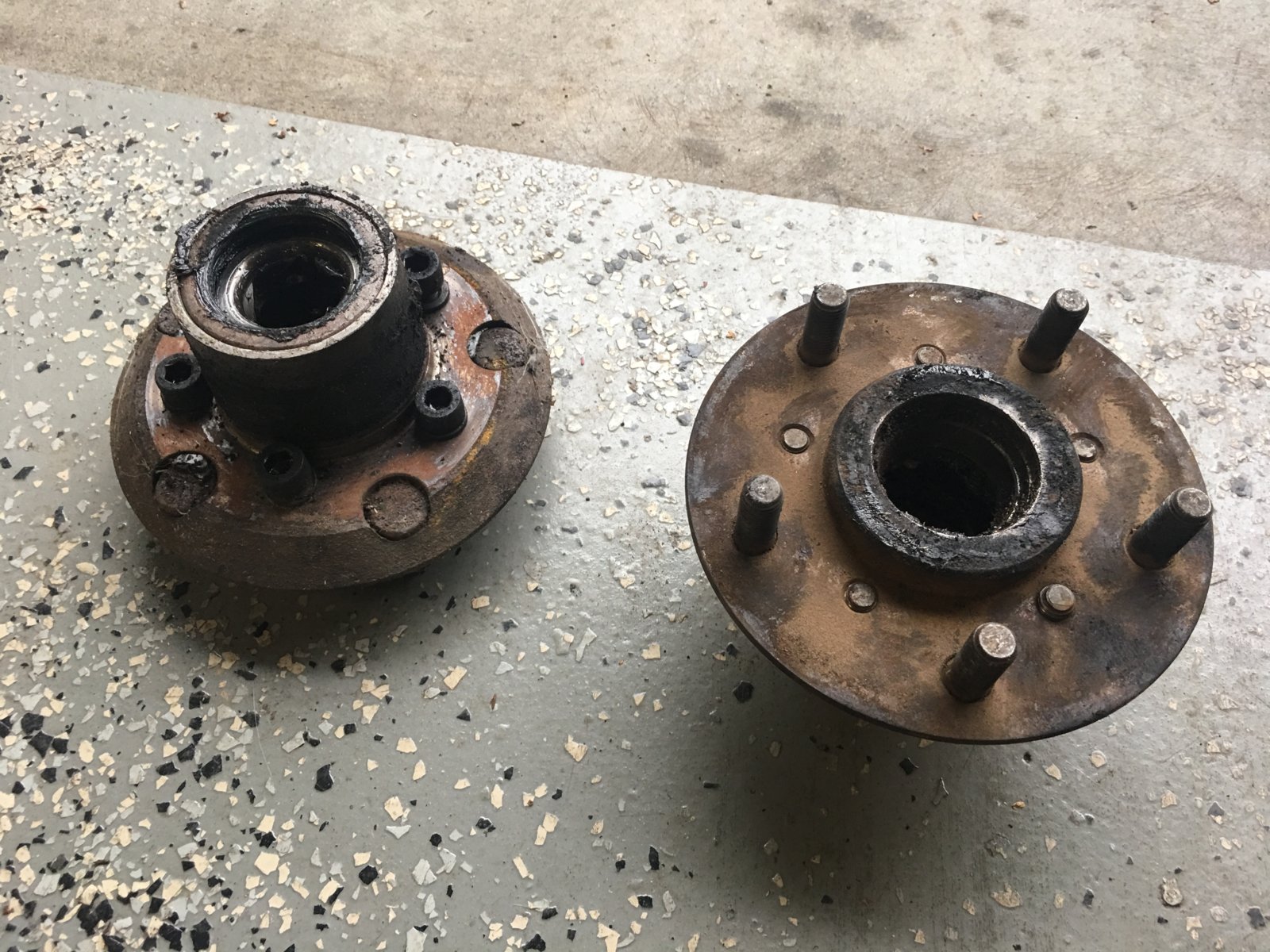

Hi Drew,
You are going to need to press the studs out of the hub/stud flange. Up front you need to remove the caliper. Remove the castle but on the axle stub. Pull the rotor/hub/stud flange. Then remove the hex screws that secure the hub/flange to the rotor. Once done you end up with what is seen below. It is a good opportunity to swap the bearings.
You can drill a stud access hole in your rear backing plate to do the tears if you are feeling lazy...
