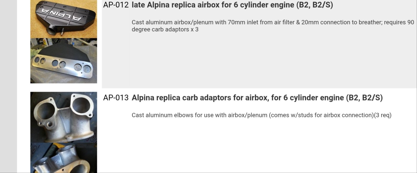

Another possibility I thought about is within the Alpina setup that Daddywad sells. Given where the Alpina airbox sits, I think there is a set of almost 90degree airhorns underneath the airbox (This would make both manufacturing of the airbox and its installation much easier). If those are separate parts, they might be an alternative if they could be bought on a stand-alone basis. @daddywad - comments?

Hi Alberto,
Sorry for causing some confusion here:
I am not in the business of reproducing the Alpina B2/S carburetor kit.
I just took the picture from my collection of parts pics :)

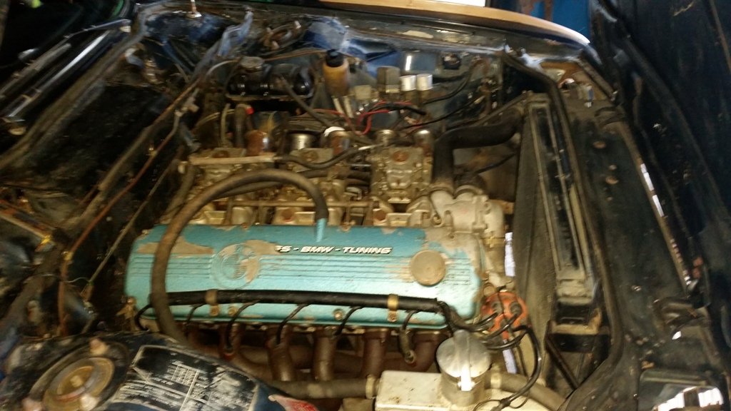

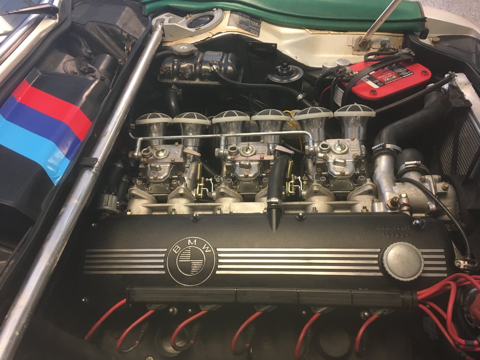

Interesting thread and as an early E9 racer 'dork', I've been collecting early team car info/images for years and I'd liked to pick the knowledgeable E9 hive mind here. ;)

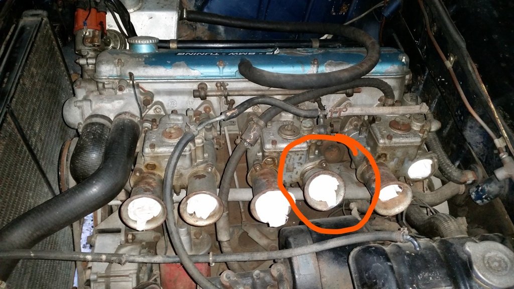

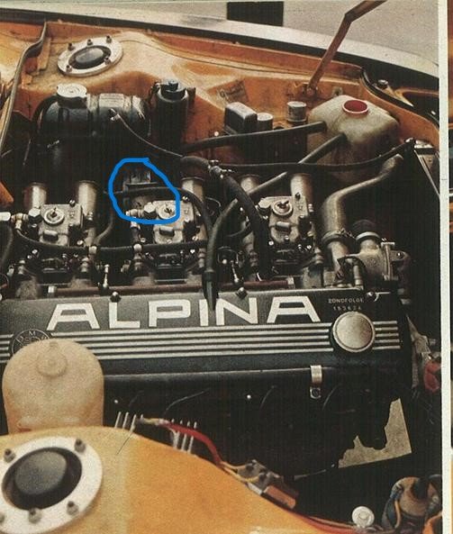

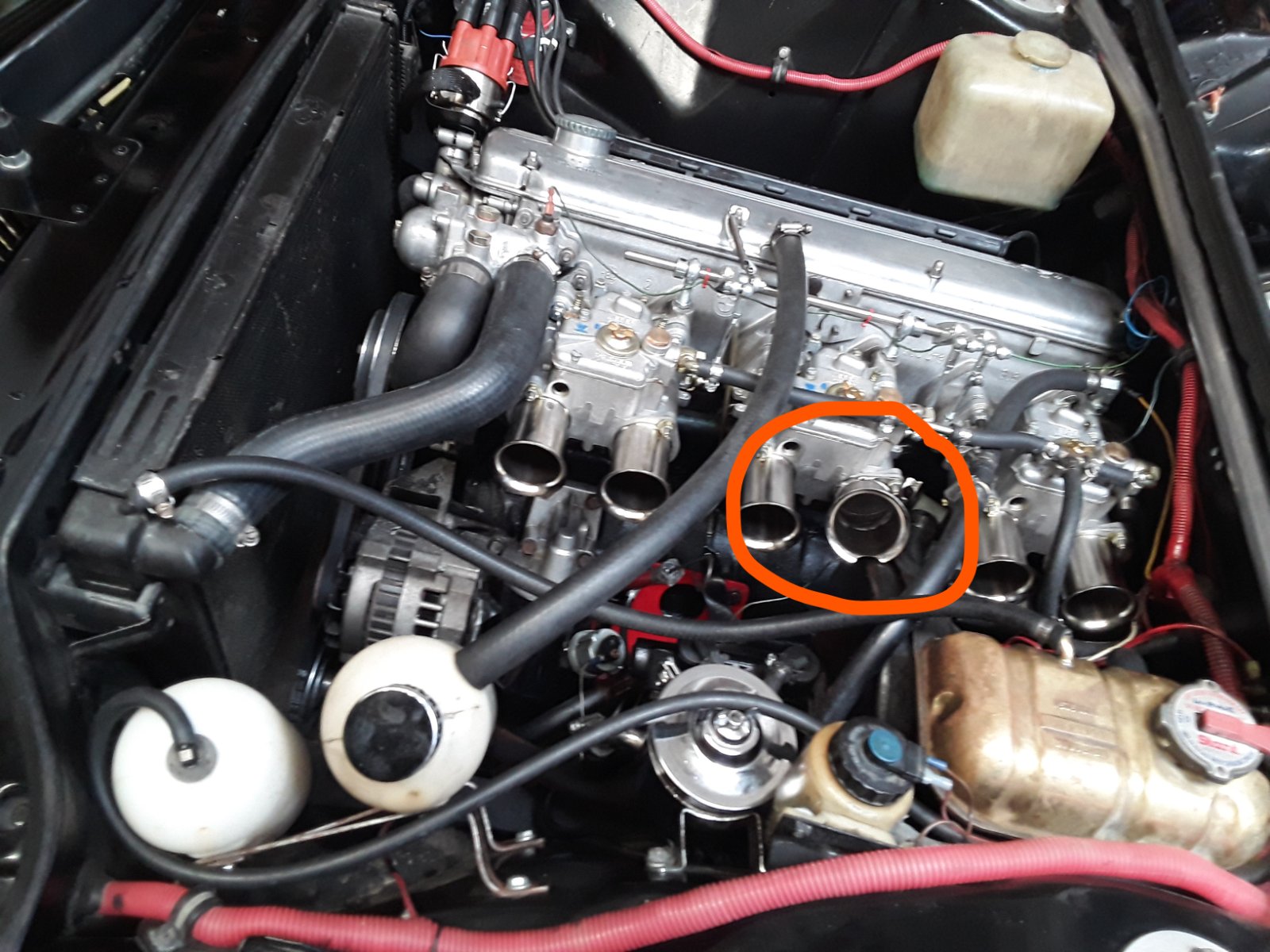

In my hunt for info/pics on the '73 Targa Florio CSL tuned by GS Tuning, I found a couple motor pics of said car in its current state. Similar to the early Alpina team's 2800CS racer (circa 1970), it appears that GS Tuning also implemented the modified trumpet (my son named it the 'stank leg', lol!) addressing the stock booster clearance issue. I used this solution in my '70 SPA tribute's new motor (basically a B2S) and it works well for me. Also appears the early teams relocated the battery, mine's in the trunk now, not sure where the early teams put it.
I'm curious to know when the early tuners started making the new manifolds and airboxes for the 3x Weber set-ups? Guessing starting around '73-74?
I may have asked this before, anyone know what happened to the Targa CSL? I think it reappeared recently hence the found motor pics. I don't recall where I found them, but have a couple interior pics too.
As always, thankful for any and all info/wisdom shared. If I ever make it over the pond, I see a pilgrimage visiting the early tuners. ;)
Keep Coupin!

Actually, we cut a wedge out and rewelded. Then later I notched the trumpet lip to eliminate the slight contact caused by engine vibrations.

While it looks cool, it definitely muffles the intake music, and I found it makes warm starts difficult because vapors get trapped in the box. You'll also need to rig up a CSi style mount for the filter box. I made one out of 1/4" aluminum plate that bolts to the old a/c muffler bolt holes. I usually run foam filters but occasionly put the rig back on for a change because I love having the complete setup.
