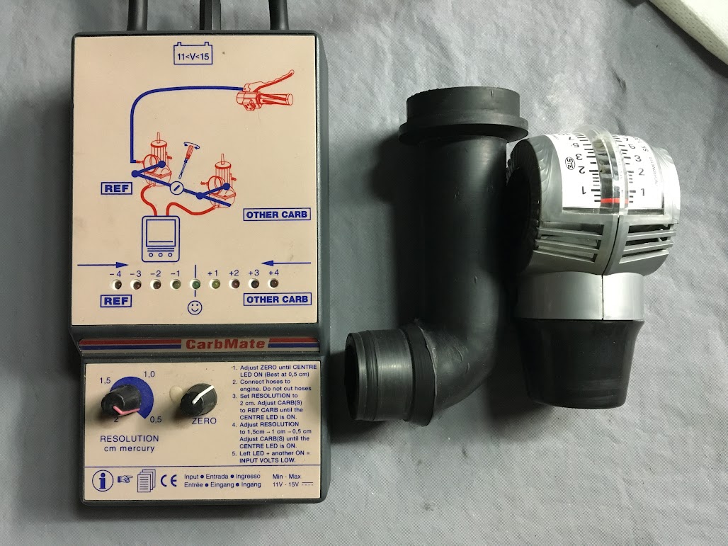

-Use a Carbmate gauge if carbs have vacuum ports (emissions carbs like 151/152, DCOM et al).
-Use an STE SK Synchronmeter gauge (the German one) with the STE-6 90 degree adapter if carbs don’t have vacuum ports.
Tools of the trade:
GR454QrUc6eEhtehDX5JntdVE9_ZHIEdzlEqCxQpgHoIeFPXIBxWIN00IjrBG9RLEkJcqImNvDH-_YOv9IW1iBwkd8dfxEWdLwsJnhWQeSPhEcqAo5DgZ7NUIPypvoMaUS9EkqZlM0ofopchMeKJPlcQJm2uno2ALYWZF6SNnF1UnuCbkKnh6TVJJGrXkhT7ELrFBog5pEUYJNZqMavutVPuceuYFEwn8MZ8IUtbAe7z3RMwPbcgXEZjjawAEjI5LVkuxED5m0czGSlw4mrtz-Y_ecIMw16SoYbpJT8POboG9LrtYvz31okCWftPw_xLQ_JPUFEIuOjAYICToWoXzyvhHGEgsZR8lou6EFzcDmT8bLuNKFqbNju7F7tV3DovhMeTkHWRE9-ZtCEGWGynMcai5D8VUTGetxqWDvyALZ4I6bwfCfC5fBqJEojEN4fIQi_59A5csdVU-tqmI0YN6cfPiVJjoSSiKrAit9ytVk0lK3gLYs9mysxj84Xauhdgag8n3UXc5-rXR1xVfCGss7IYPN93C3fcW-RjmolS88bUn_Q5c54pUEJkUOV-kCsSaZ4ywRvLF9p4bQWQYgC-5DUyxnZcAZVEj79RSwLXsWglLzEb=w1028-h771-no
-Use as much air filter as space will allow. The 1” paper style and foam Ramflo’s tend to run richer than others like socks or taller paper ones and will affect jetting more so than others.

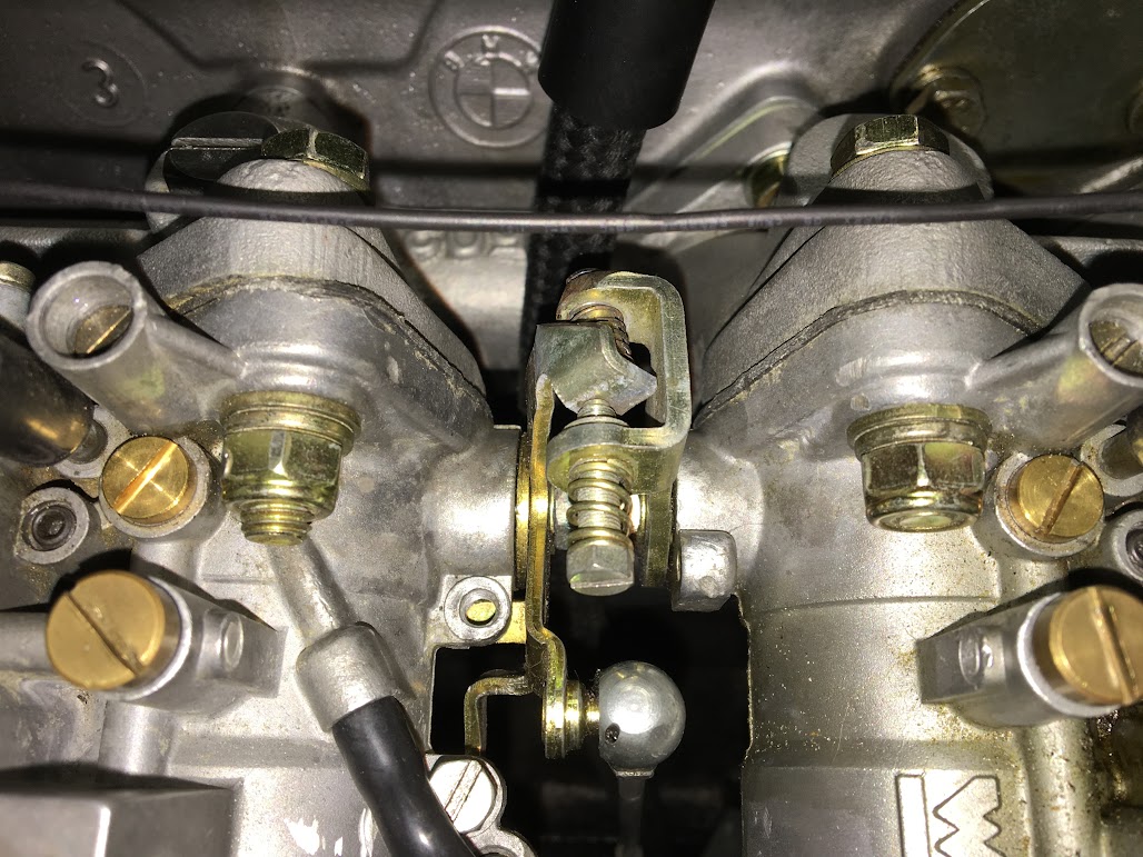

Set throttle plates to cover first progression holes on each carb. A flashlight in the venturi with the inspection covers off will show the position. Or shine the light over the exposed holes from above and locate the throttle plate position. Ideally you want to keep the plate as close as possible to directly under and covering up the first hole (closest to engine) to avoid off-idle flat spots and erratic idle but some deviation is inevitable during the tuning process.
The carb with idle stop screw is the base carb and I use the barrel that is connected to the pedal linkage pull rod as the base barrel for all synching. As a starting point, open the idle mix screws about 2 - 2 1/2 turns. Some model carbs require less open, others more.
My base carb is #1 carb (front of car), shown here is bbl #2 of that carb which also has the idle set screw (under the black silicon tube opposite the pedal linkage ball and socket connection). The left side of pic on #2 bbl top to bottom is the mixture screw, progression hole cover, and accell pump jet cover. Far left shows the idle bypass (covered by hex grub screw) and rubber covered vacuum port above that. Between the carbs is the lever with adjustment screw used to match the airflow of each carb. All my synching is based on #2 barrel on the left:
ryVTEZqfb6D0wLD9EclOdYRLF0nlH71PTEiCTePB1jveRvL0AhNcoQJZ25AnsXyMIWL10ywy4l-9zi93S5LY1o4OWY_LwsS_-GyeWmNj9Hnz2Xv6JGkKSBY0taDaa5W1L-FzEsq2C--97AtJXchuTc_dt174SnOxeGIldWpCTR-tglYN4rOTDFkVkqHqbldq3LOldmFlyRjURoqBzNAbW59K_N18YbLg79OJbPrAJgxuMsdbkhKSIJCrzgmyZoSZy8OQbwp6o8bkS0uaPPeItuOJnRvtGoINW4RSWylSc3OzAFzF_ymehOJMtejeQDjxYYiXo1w_BlddQIbp9M309EaAWBTHpJ6Nk0tpl6pySicgDzs6Esk7GXaN2Gq9-mn5PfBs1slxUFNsp6y9OVqnqHkWFFuiKLDhgFeSQuDNcQbUTjazcylUhlIx5O40FhXanA1cgZJtrf54O2LHQNqwFLOpjDMac6kUShfOe1v3hFOhNFylDfCy-DDsDoA22wkUKRp_MRLXtXwQRDaY5brjd-b-9MEFGUX1sVbTTKal_N4Vka6DASYyludO3DYYQMklpPy0_rRwptr3mVs2P31ZoZ4kMSwAkFlzyxtkbKMqIrNEu4j3=w1028-h771-no

I've never seen that CarbMate tool, interesting, though. I need to find one of those 90 degree adapters for the squirrel cage... that's VERY handy to have. I use a 4-port, CarbTune on my Solex DDHs. There are only two carbs on the M10, but the CarbTune allows me to see all the vacuum signals at once and balance accordingly. I have seen Ferrari manometers with a dizzying array of gauges to balance all the Webers at once... yikes.
Ed Z
That Carbtune is a very good device, I wish they made a 6 cyl model but the 4 version would work well. Being electronic, the Carbmate is very sensitive and adjustable. I made this manometer but haven't used it much as the Carbmate can be used while driving. Do you have a pic of the Ferrari rig?
