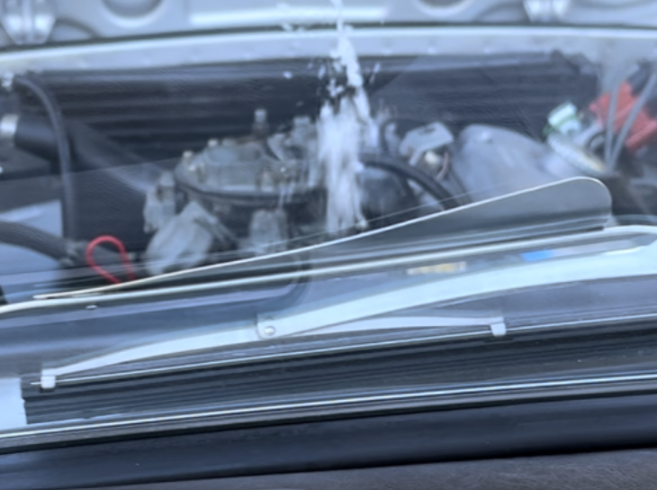

found it:
look at the dangerous fuel fountain:
check this, if all ok, move onto the floats and so on

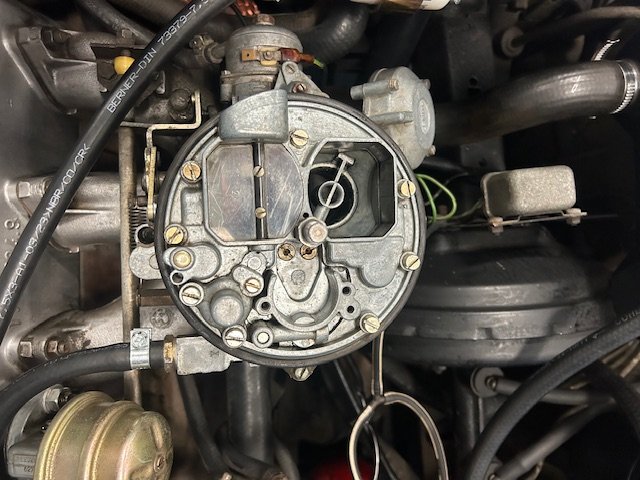

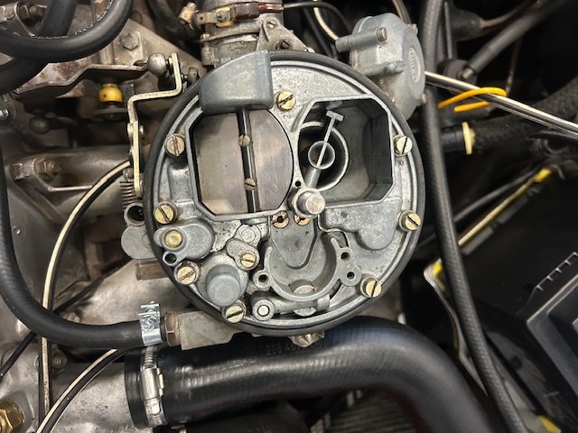

Here are the carbs AFTER I just spent 3 hours cleaning them. I don't think anything is missing. There was plenty of dirt at the top and in the throat of the carbs. I took all 4 jets out one at a time and soaked them and cleaned them as best I could before putting them back in place.

looking at the pics it seems that apparently all is there,
so could be the floats;
mallet tapping might make it pop and release
the solving is a little bit more messy
