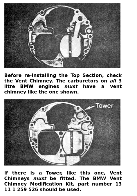

About halfway through the Zeniths manual on this site: https://e9coupe.com/tech/zeniths/bmw1/bmw1.html in the 'overhaul' section, there's a warning about replacing the tower with a vent chimney which discharges excess/flooded fuel directly into one of the carburettor chokes - see below
The chimney shows up clearly on this parts image: http://bmwfans.info/parts-catalog/E...aration_system/carburetor_cap_piston_float_2/
When E3s were plentiful, I picked some up to make the change - I read it as a safety matter.
I guess that if there's a serious fuel flood and it's directed down the choke, the effect will be to stop the engine.
It looks like that change was from October 1973 onwards so since my July 1970 carbs still had the original leather accelerator pump cups, which were also recommended for replacement, I'm pretty sure my carbs don't have the new improved vent chimney. I'll have to pull out the photos I took while I had them apart. I bought some spare carbs a while back that I'll check to see which version they have. I did have a carb flooding issue with one of my carbs a while back so this is more than an academic issue for me.

Agree the tower isn't the cause, but if there is flooding, the vent reduces the consequences.
