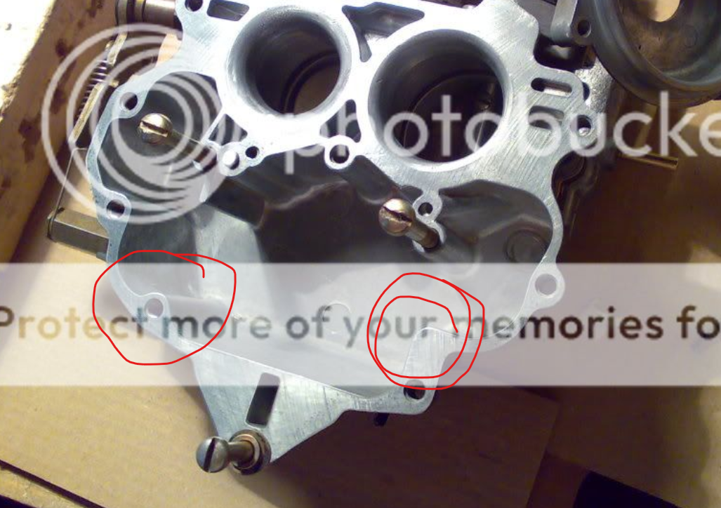

i would like to insist in the fact that more than the debris inside the reservoir of the float, it is more relevant the gasket that protrudes on both sides of the float.
you have to check the gaskets and trim them so they can rest flat to the walls of the reservoir avoiding the chance of the float get stuck on them
here you are the two critical points of the gasket, make sure that you trim the excess...

Thank you @deQuincey for the advice and the photos! Photos always help. I will do this next.
