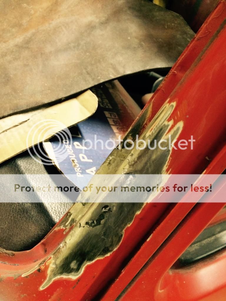

Some rust on the scuttle and pillars cut, welded and painted up.

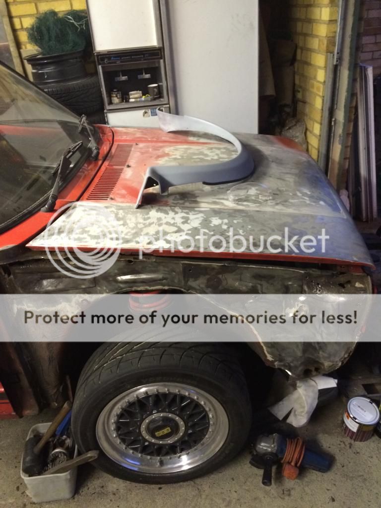

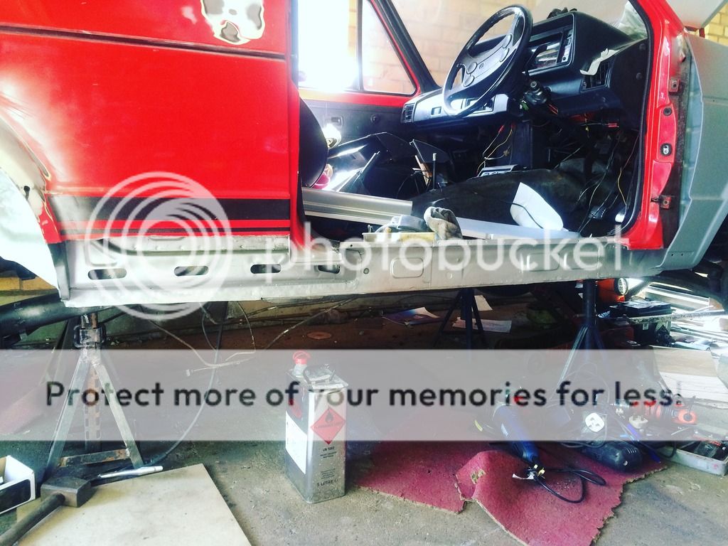

Out sill tacked on, then spot welded top and bottom as per factory, seam welded across the quarter.

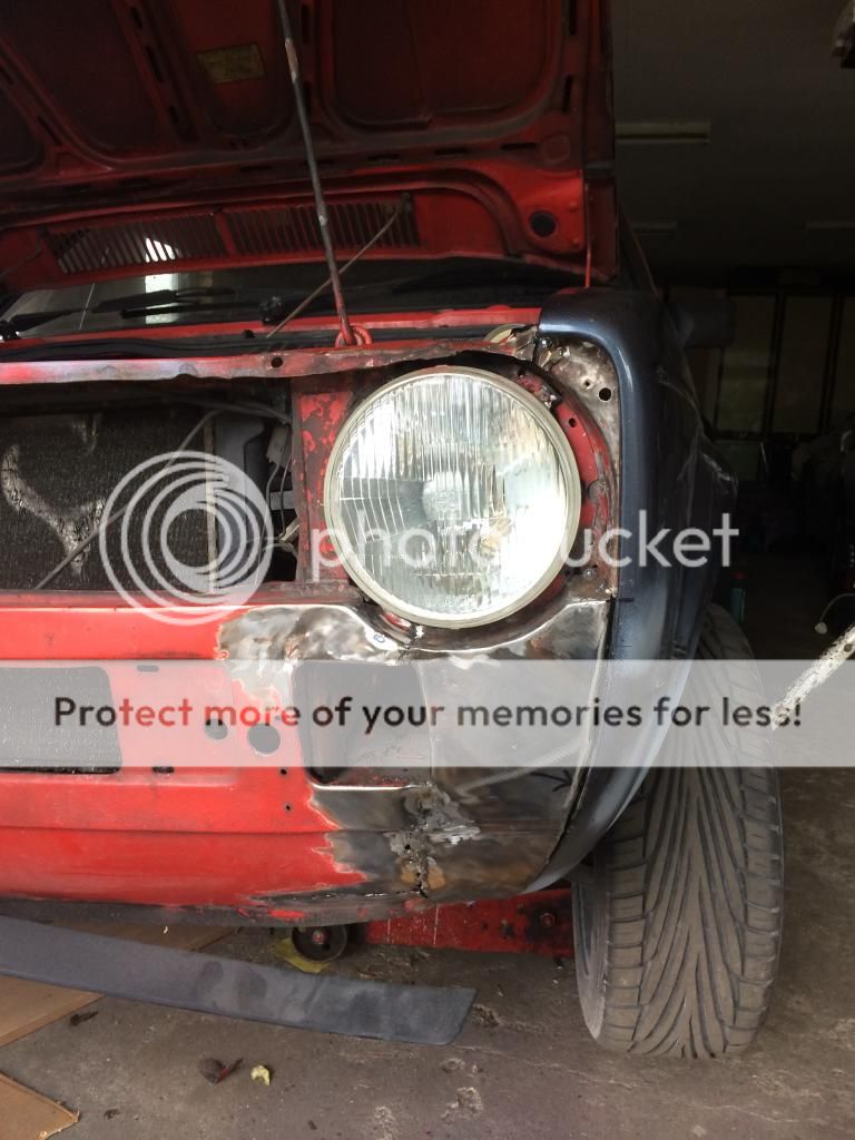

Front panel just wasn't lining up properly and I didnt want to cover it in filler.

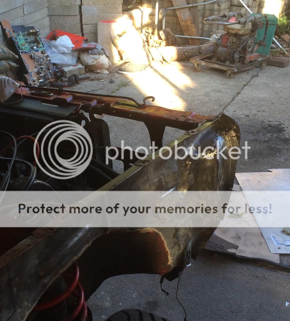

Engine and box out.
Panel removed, crossmember welded up where the metal was a bit thin with some fresh sheet metal, then primed with Bilt Hamber products.
Battery tray removed, spot welds cleaned up.
Front panel on
