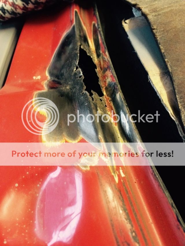

Quick tug of the osr seatbelt revealed this...
Subframe mounts reinforced and new panel in place

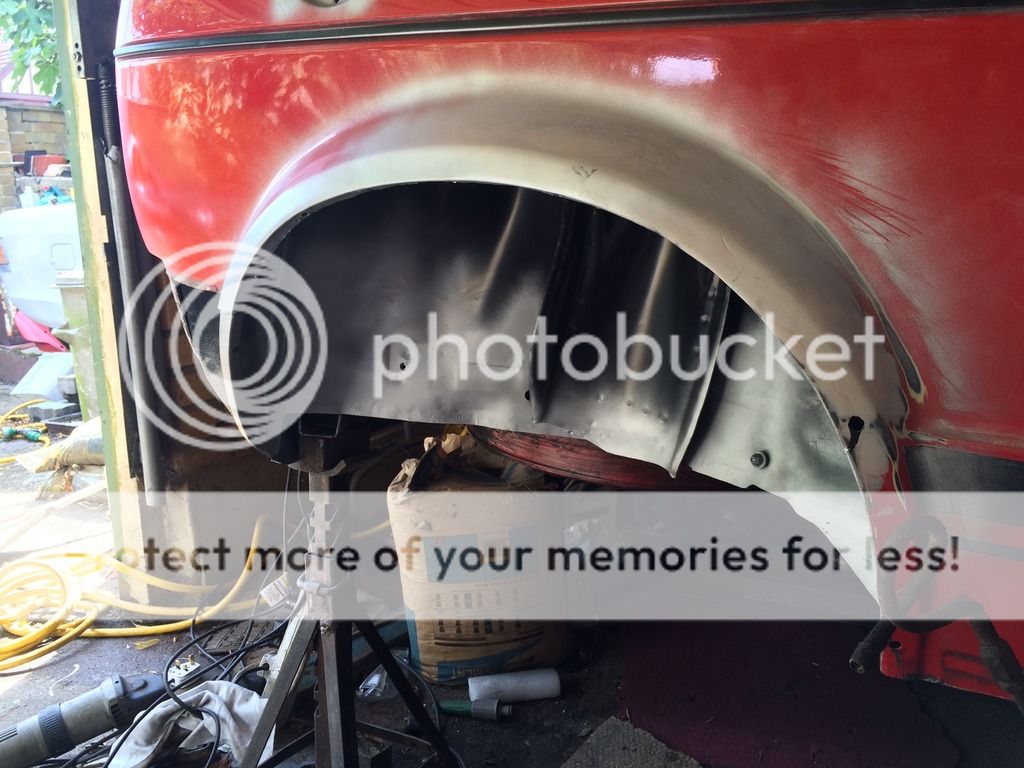

Inner arch removed
and after much swearing, replaced. Primed then painted with anti stone chip
