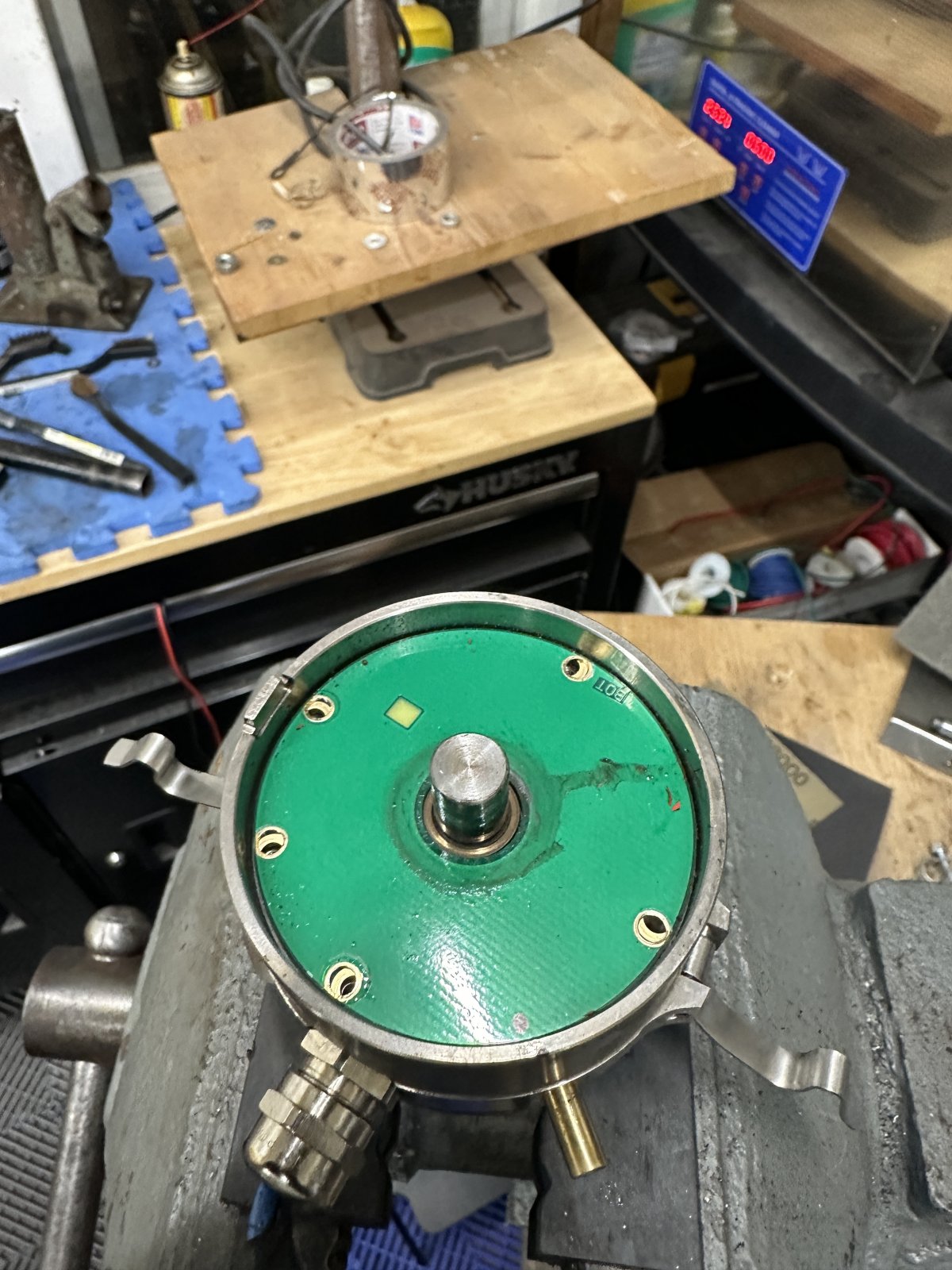

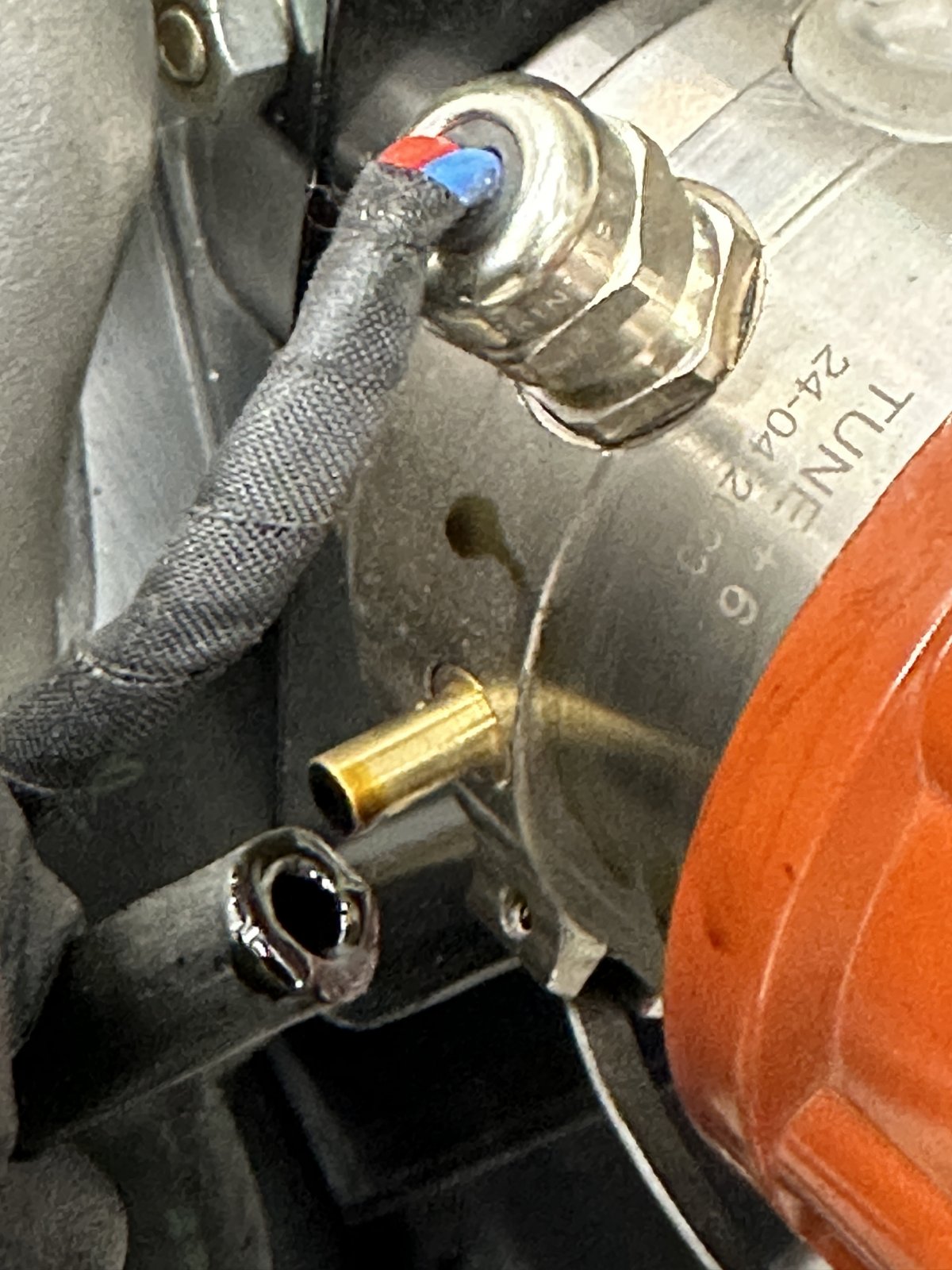

I re-torqued the head bolts today to stay busy and keep my project moving while I wait for parts (again), and noticed that the vacuum line on my 123 distributor had oil on it. I pulled the distributor and dis-assembled it to see how much of an issue there was.
Just a light film on a few parts so far, but the presence of oil in the vacuum fitting has me wondering if the presence of vacuum is pulling oil up the shaft.
I am thinking that I may not re-connect the vacuum advance. Prior to the rebuild I did not have vacuum connected and had not noticed any oil, but I admit that I wasn't looking for oil until you started this thread.

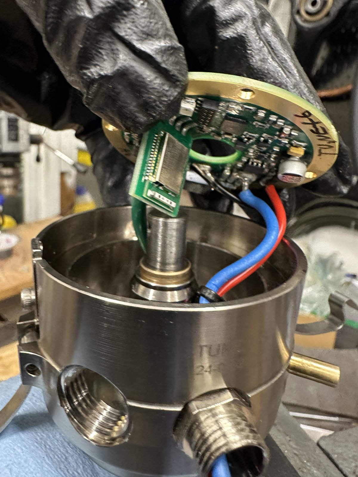

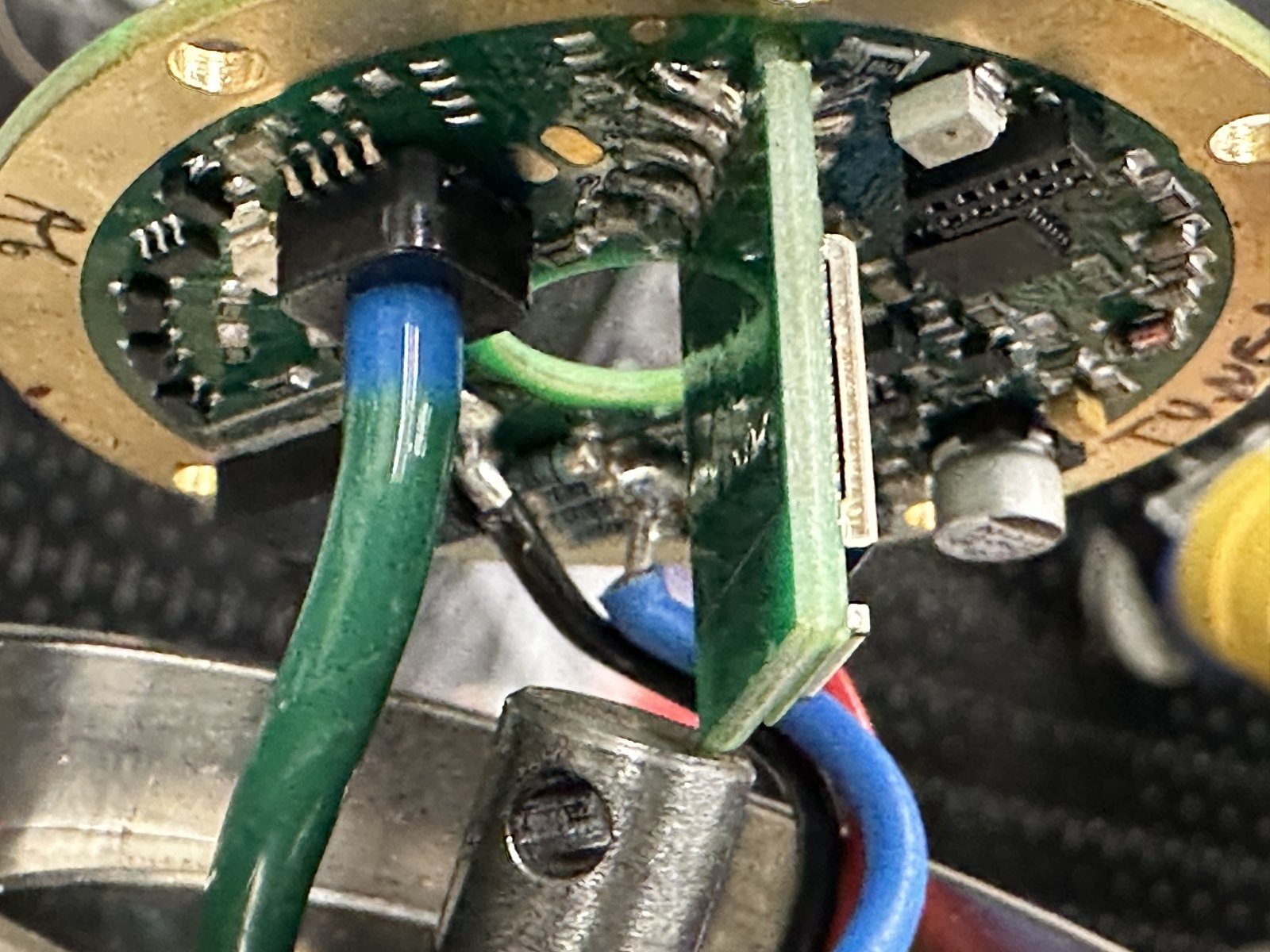

That’s strange to see it at the vacuum port. Did you check the little blue tube inside that it is still connected to the circuit board?
Well, that was a miss for me. I did not, but may pull it apart again and take a look. There is a clear cap on the side of the distributor, I wonder if that is removable to use the endoscope...
I must admit that the issues with the 123 are frustrating for what is presented as a high-end product.
The clear cap is the bluetooth light so I would avoid that

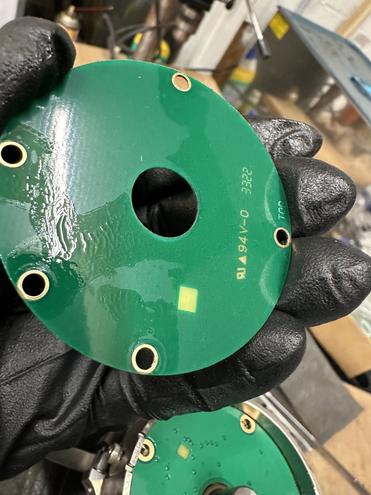

Saw your not too late, I pulled it, but needed more access for a good look so I disassembled the unit again. All seems to be connected as it should be and no oil seen on electronics. That would seem to indicate that the oil is migrating up the shaft despite the machined shaft.
