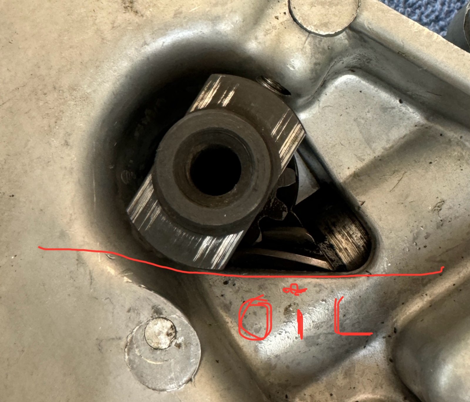

I removed the breather baffle cover in the rocker cover and cleaned the passages during the build so no restriction there, the catch can may have an effect, ( think I added it befor I noticed leak) but is essentially using the same diameters as each end of the factory elbow. It seems to flow ok as it pulls a heap of condensation from the system (local climate to blame, all our cars have it) and a small amount of oil. I had thought either excessive blow by or worn distributor shaft bushing the likely cause, it’s not passing the flat o ring on the body so must be climbing the shaft. The other possible contender is the drive gear from camshaft allowing excessive oil past but only a guess
Stevehose
13,167
5,891
Sarasota, FL
I believe any excess oil from the drive gear spills over the "wall" of the upper cover down into the crankcase. The red line indicates where the oil level is in the timing case cover - covering about half of the distributor gear and very little if any of the dive gear. So any excess spills over that red line. Also, the point of entry is not the bottom of the gear but well above this level where the gear piece meets the distributor body.

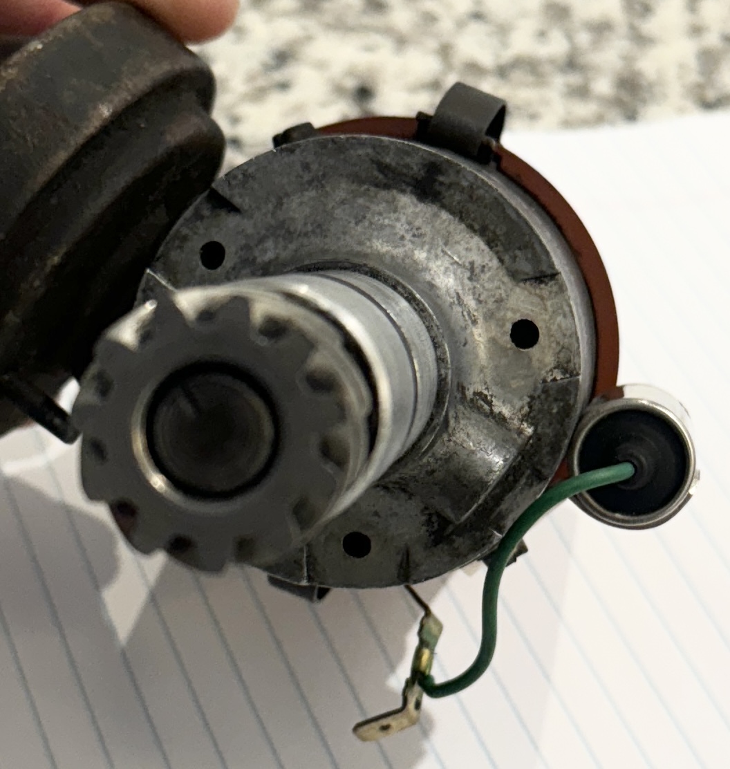

Update: the Bosch has 3 drain holes:
The difference being that the 123 leak capillaries in between the 2 PCB’s and out the distributor cap more than dripping down the sides to the 1 drain hole it has.
