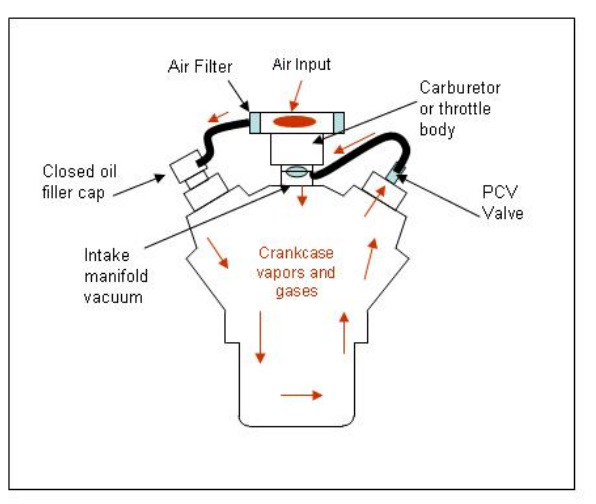

I was surprised when I first started working on the car that there is no Positive Crankcase Ventilation system...only the hose from the valve cover to the air cleaner. A typical PCV system looks like this...
A good source of vacuum from the crankcase to the intake manifold and a filtered source of make up air. Would a true PCV system solve this problem?

My tube is bone dry too, so oily residue not necessary for this to happen. I agree it's the blowby (agree with your idea regarding old/unseated rings, higher compression exascerbating this) which BMW and other manufacturers have accounted for (like the vent to air cleaner tube you have). I suppose if the stock setup is not used and/or the engine has more blowby than spec'd, we have a problem. In the old days before the crankcase draft tube, followed by the PVC system, engines routinely blew oil past the seals as part of the design, and was considered normal.
