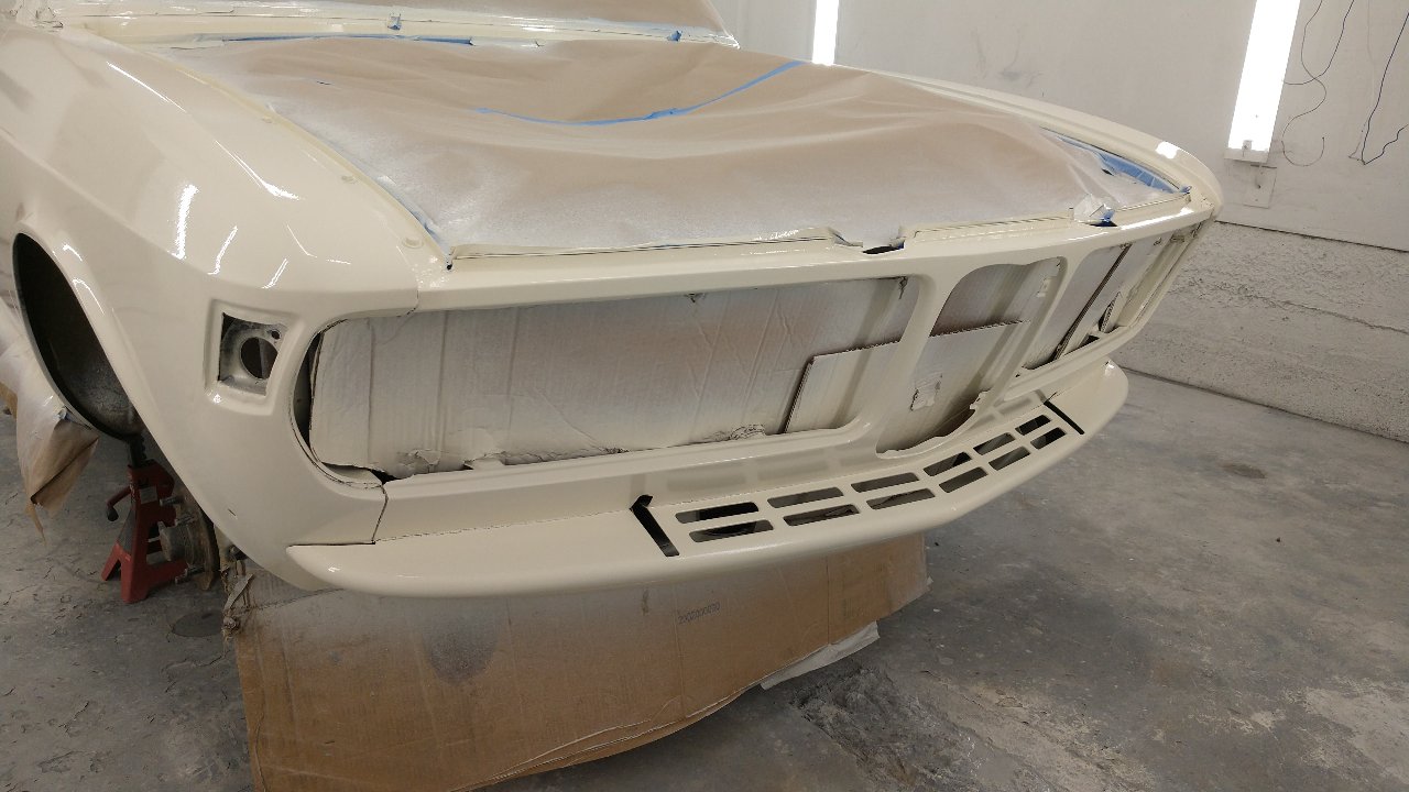

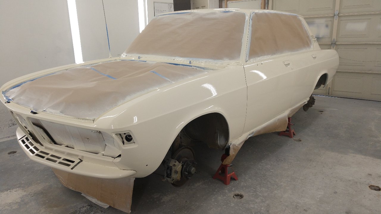

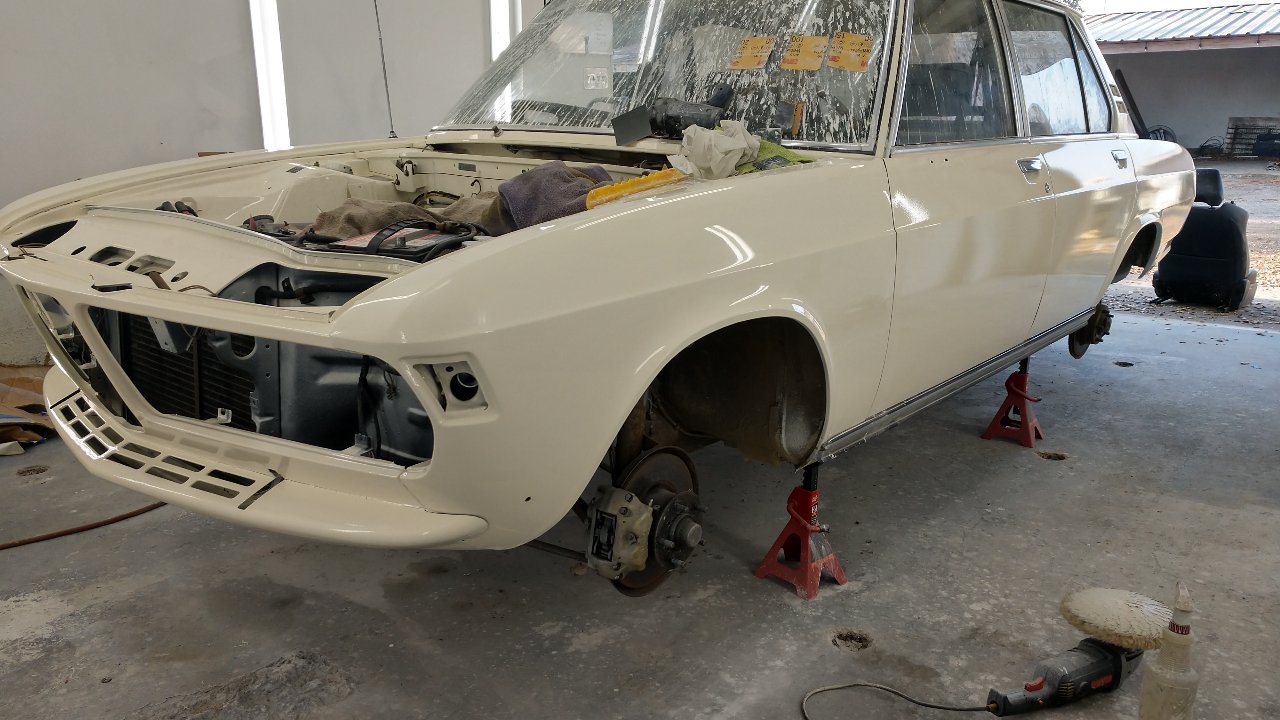

It's painted! But I'm not that thrilled with how it went on. The first coat went on great, very smooth, but when I started the second coat something was wrong with the gun and the material wasn't coming out right. I had a full cup of paint with hardner in the gun so I kept going and tried to adjust the way I painted to make it work but it ended up very "rough". I've never had a problem between coats so I'm not sure what happened otherthan a blockage somewhere in the nozzle. I did a quick cleaning of the gun before the next coat and it went on great again. The damage was done though and that translates into a LOT more clean up sanding.
The last image shows the front fender sanded and one pass with cutting compound. You can see how rough the rest of the side panels are.

Well bummer but looks like enough paint is on to make it work. Just more sanding. I love the color tho. My gun goofed up some too but I made out ok. Just ok. Not real happy with it. I’ll do it again another day.
