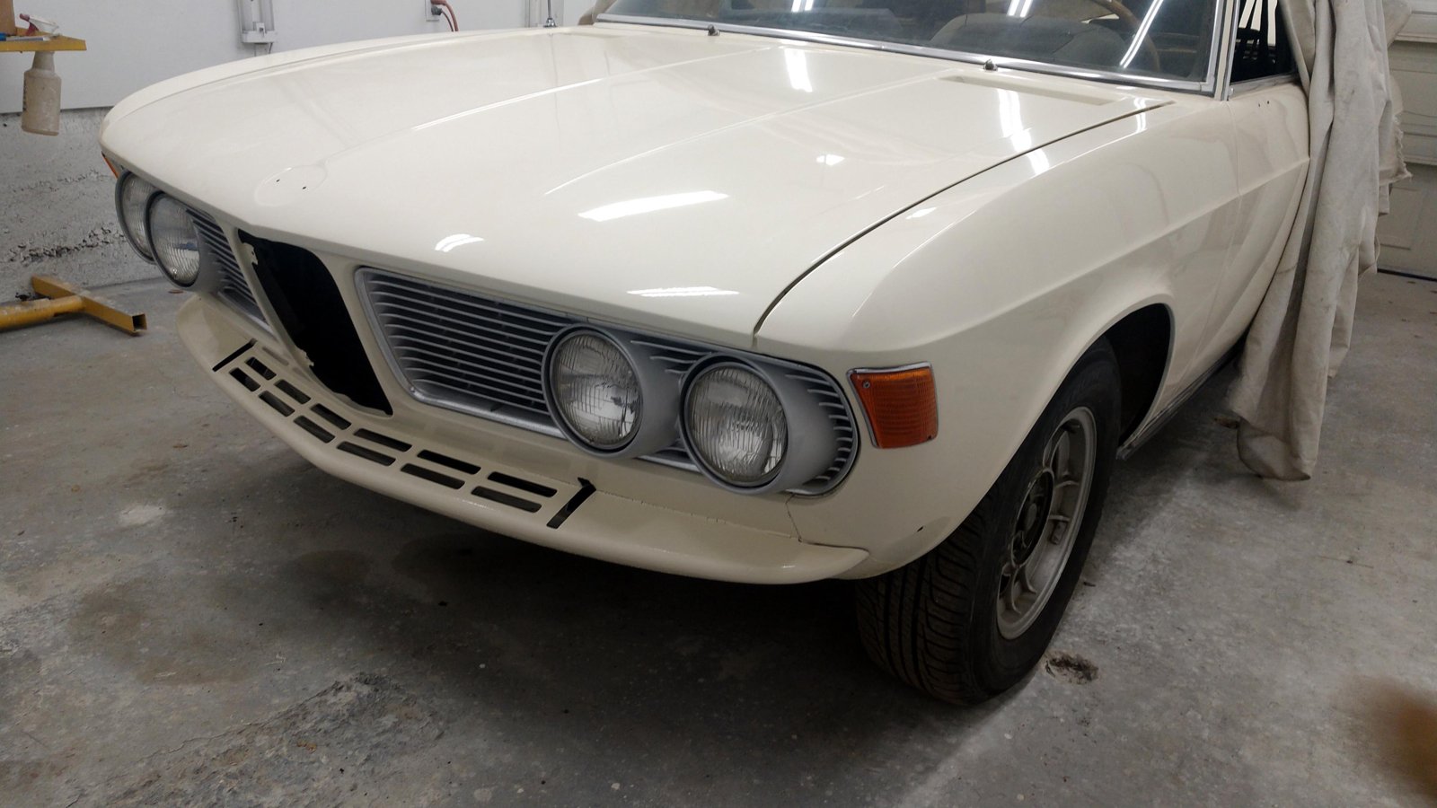

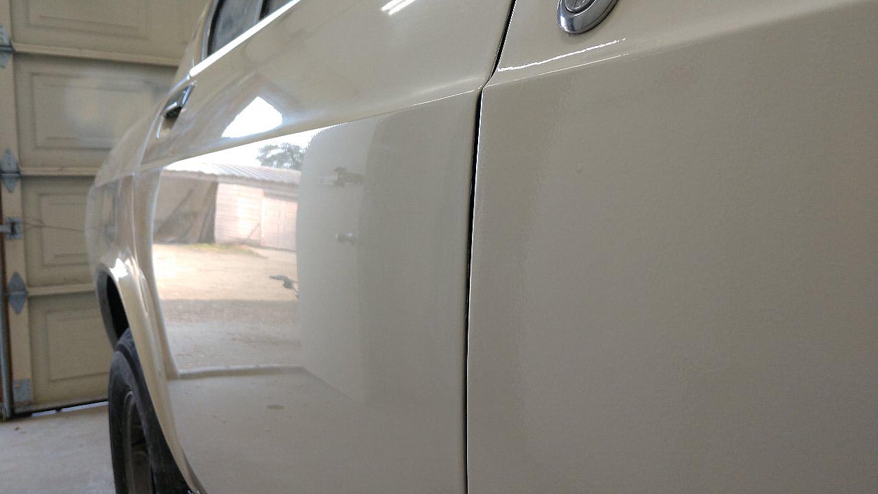

I'd say it's "okay". There are some areas that need to be fixed, a few low spots I couldn't see without it shiny, and the body line crease that goes from the taillight to the wheel opening has a small dip in one spot. On the bright side, with single stage paint it's a lot easier to fix body work. I expected to fix some areas after painting.
It's painted! But I'm not that thrilled with how it went on. The first coat went on great, very smooth, but when I started the second coat something was wrong with the gun and the material wasn't coming out right. I had a full cup of paint with hardner in the gun so I kept going and tried to adjust the way I painted to make it work but it ended up very "rough". I've never had a problem between coats so I'm not sure what happened otherthan a blockage somewhere in the nozzle. I did a quick cleaning of the gun before the next coat and it went on great again. The damage was done though and that translates into a LOT more clean up sanding.
The last image shows the front fender sanded and one pass with cutting compound. You can see how rough the rest of the side panels are.

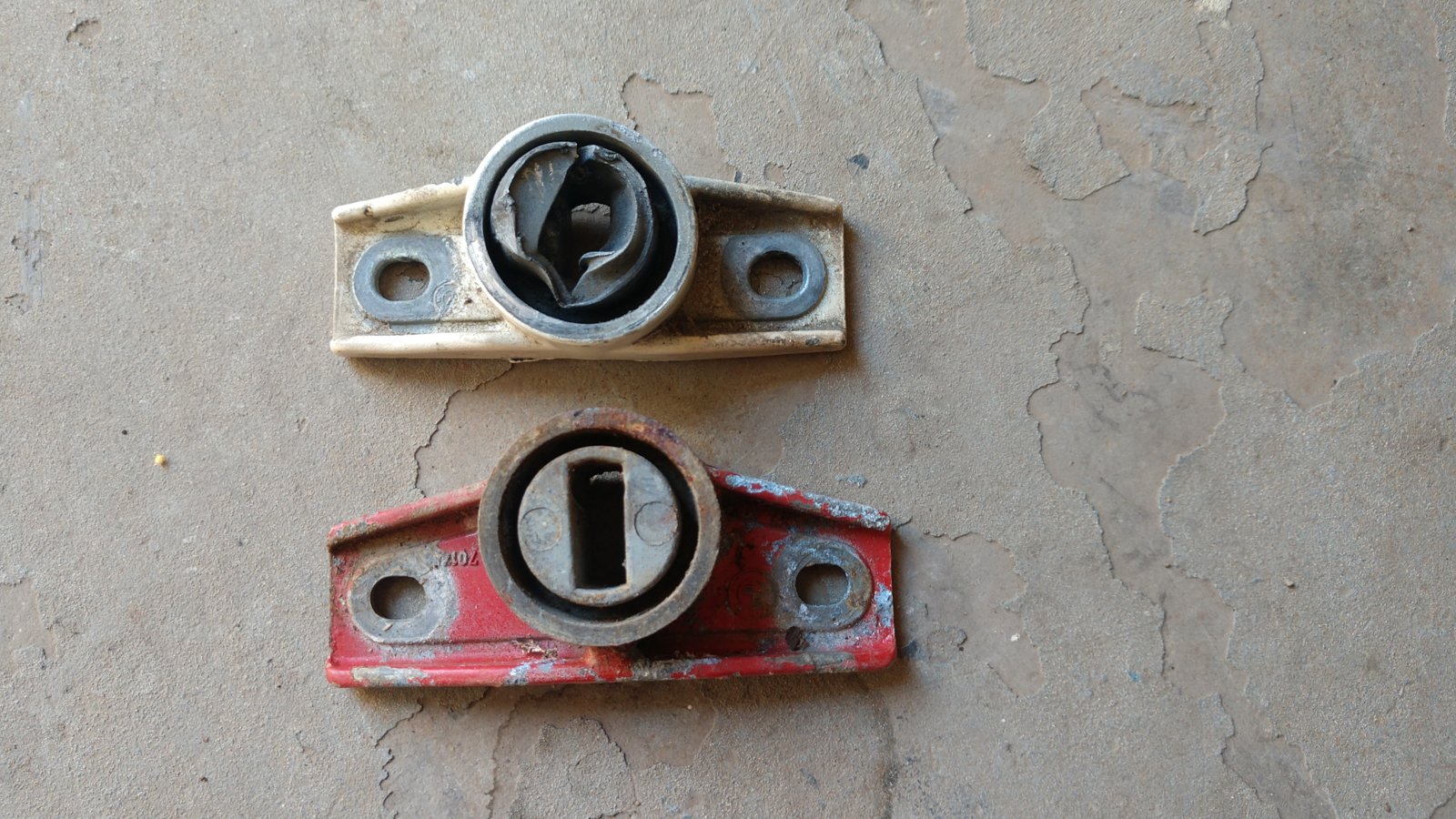

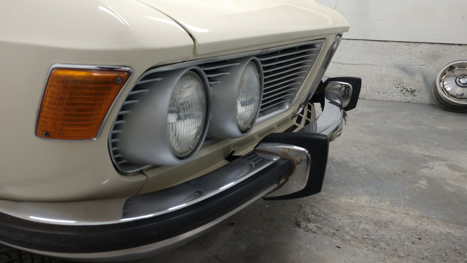

I've been doing a little work on the car but nothing to show yet. I got the hood prop out to see if I could figure what's wrong with it and found one of end caps had deformed where it holds the torsion rod. As luck would have it, I had a 2002 prop rod sitting in storage and the end caps are the same. Easy fix! Still need to paint and install though.
You need some Cibies, Marchals or even flat Hellas if you will be driving at night!
I'm pretty sure I have some somewhere. Right now I'm trying to get it roadworthy and checking that everything works. Not much time spent on it lately.
