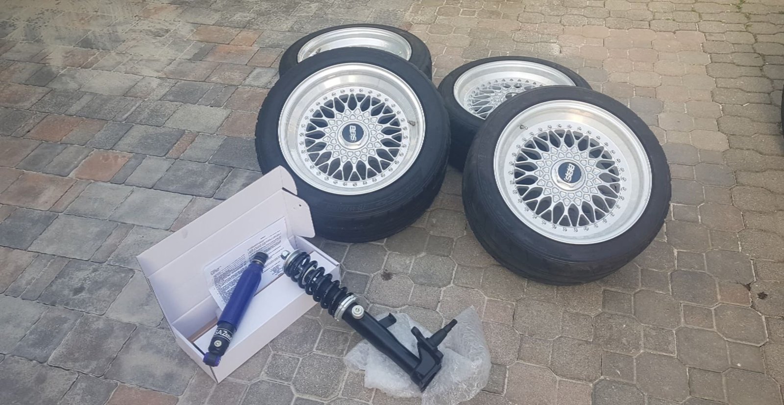

Small update... i got ordered GAZ coilovers and BBS RS 17".
Hopefully I will start assembling car soon.
I also have Gaz coilovers and would be interested in how you get on with these. Originally, I had their solid adjustable camber plates (from a 2002 racer) but they were too harsh for the road. I am also experimenting with the spring rate and length at the front. We should compare notes as it might save each other some time.
I will made camber plates on my own for only 1 position not adjustable just to get a little bit of camber. But first I must install coilovers to see how I will have to rebuilt wheels to make them fit in front.
For front GAZ made me shorter springs to bring the spring seat higher to get more clearance for wider wheel. I will be running 8 or 8.5J in front I will see what fits with no rubbing.
Thanks for the replay.
I have tried different lengths of spring and might now have the one I want to run with. There is not much clearance
I researched the front tyre width as I had a set of Alpina 17" x 8.5" These were slightly too large and the offset was wrong. I had to run with 8" which sit well and provide the proper clearance but only just.
