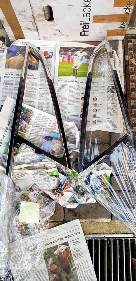

Also had windshield trim polished and ceramic coated.

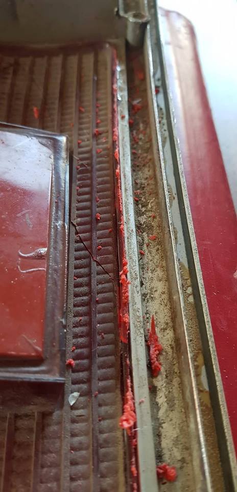

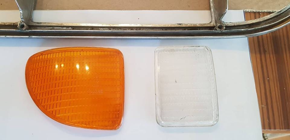

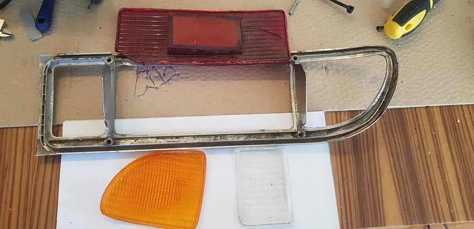

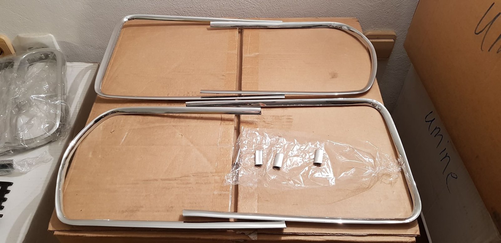

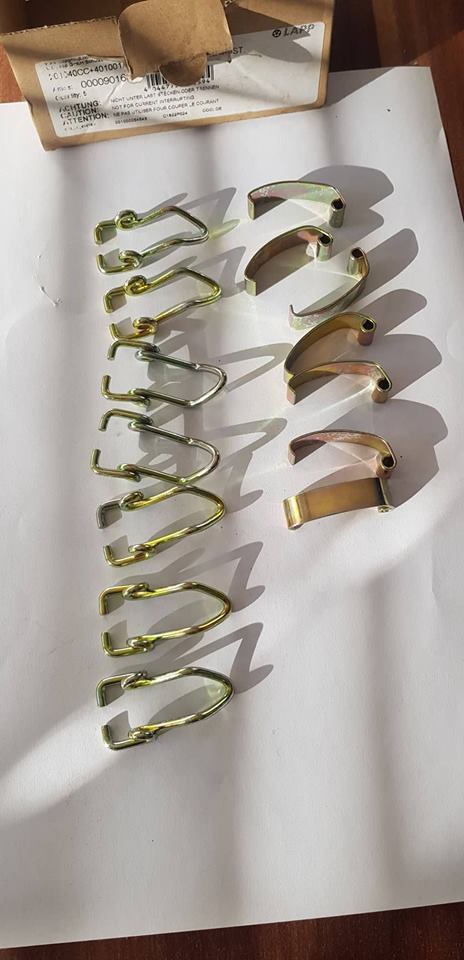

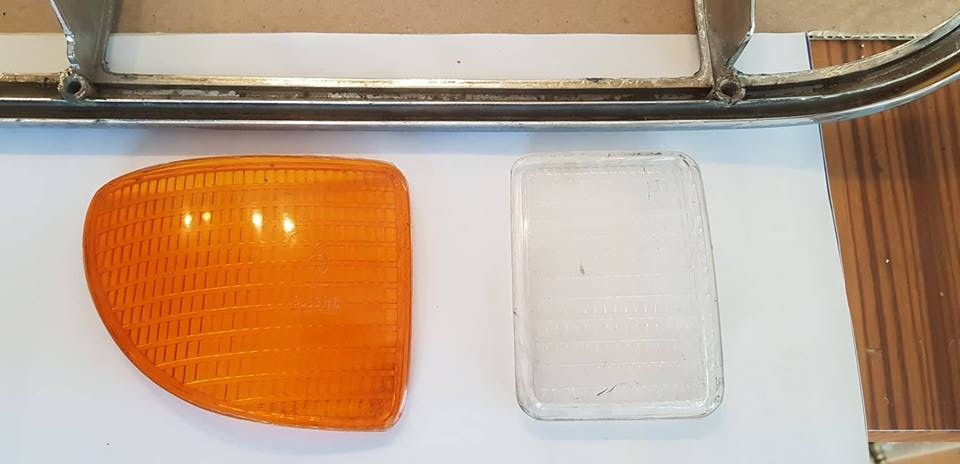

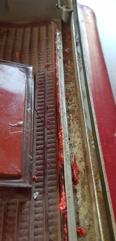

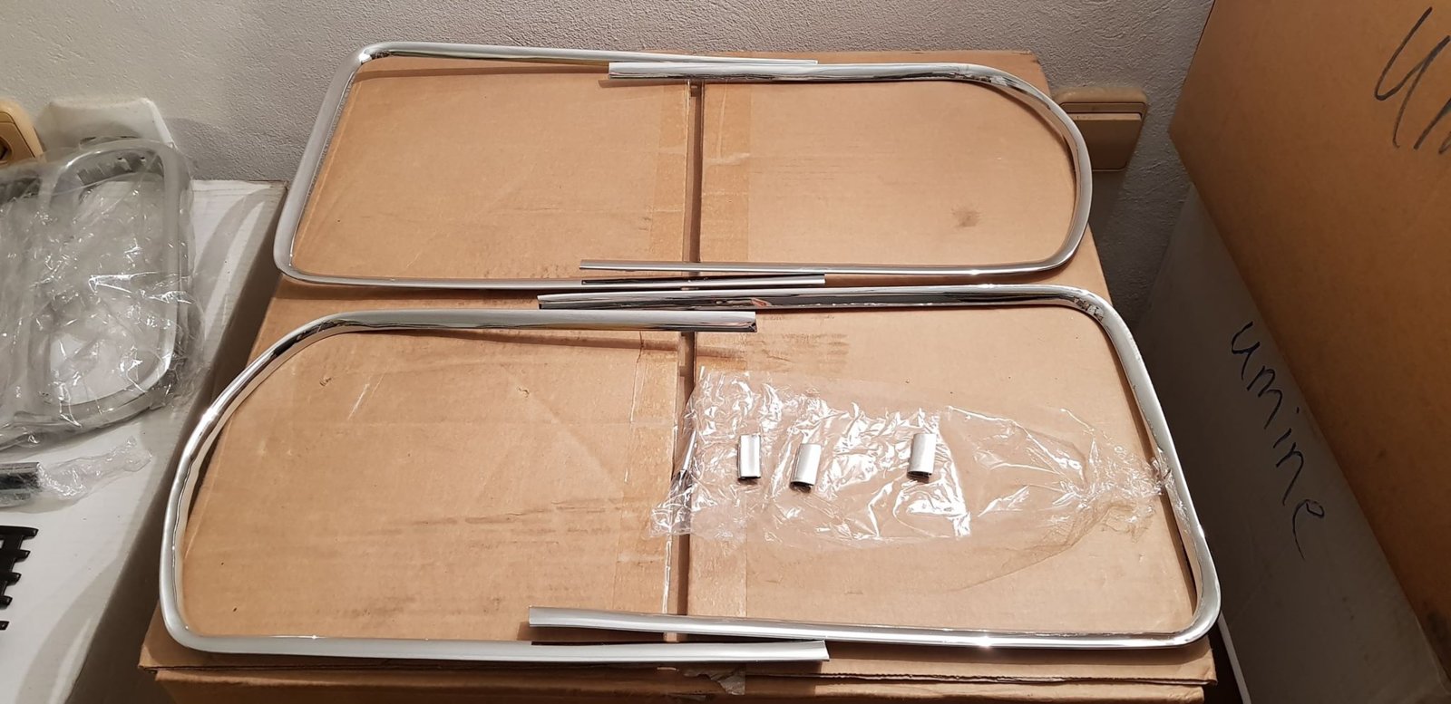

Update on my tail light re-chroming. I finally got test frame back from chroming. Lenses I removed fit back very good and very firm and with some glue job will be done.
57284370_1140211329485244_8604545727143608320_n.jpg 57194551_601162553685968_1163815478699753472_n.jpg 57623813_418356012058529_7195967294969741312_n.jpg 57407328_374478303155075_817200786005032960_n.jpg
57272276_1262267690603500_2416798008927584256_n.jpg 57486014_1997748687003198_4679430378673405952_n.jpg
I am happy with result so I will proceed with restoring a pair of lights. Hopefully I won’t destroy any lenses now.

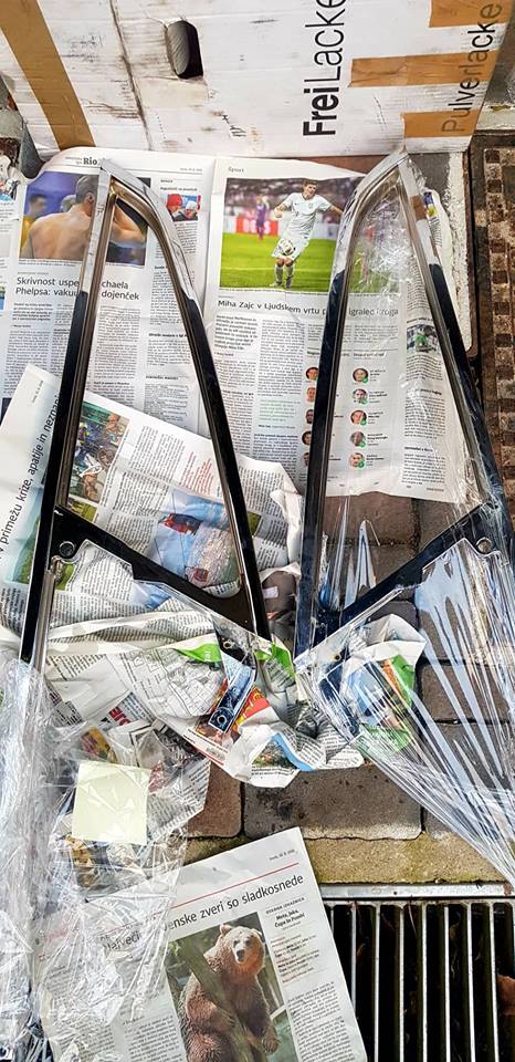

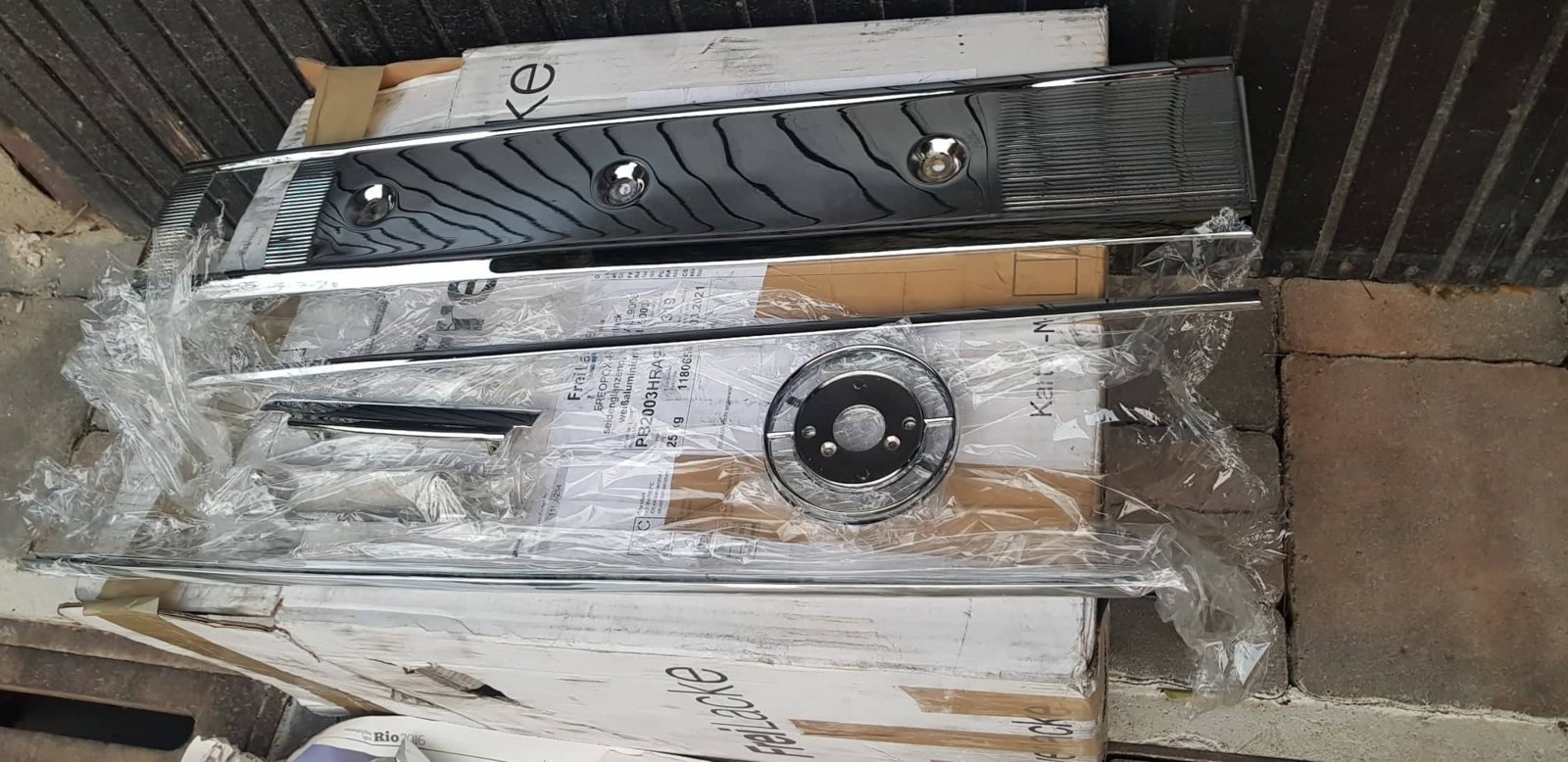

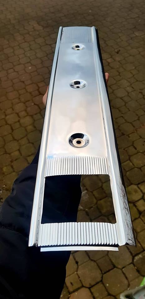

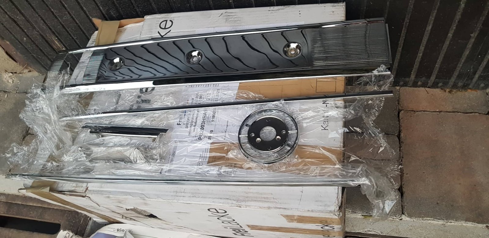

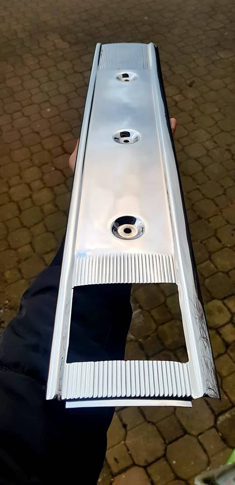

Meanwhile that car is in body shop I am re-chroming last exterior parts.
View attachment 58468 View attachment 58469 View attachment 58470 View attachment 58471 View attachment 58472

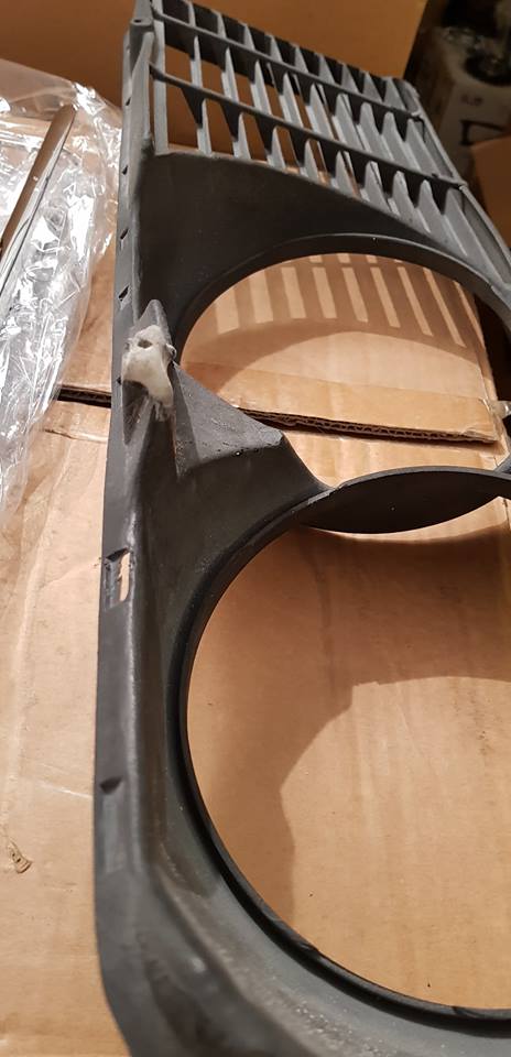

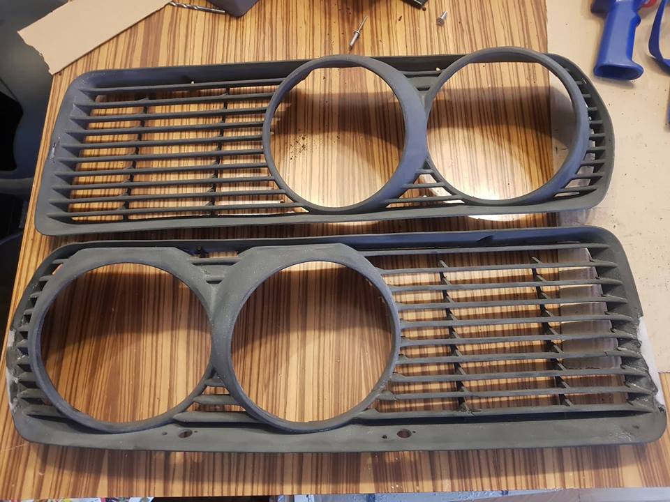

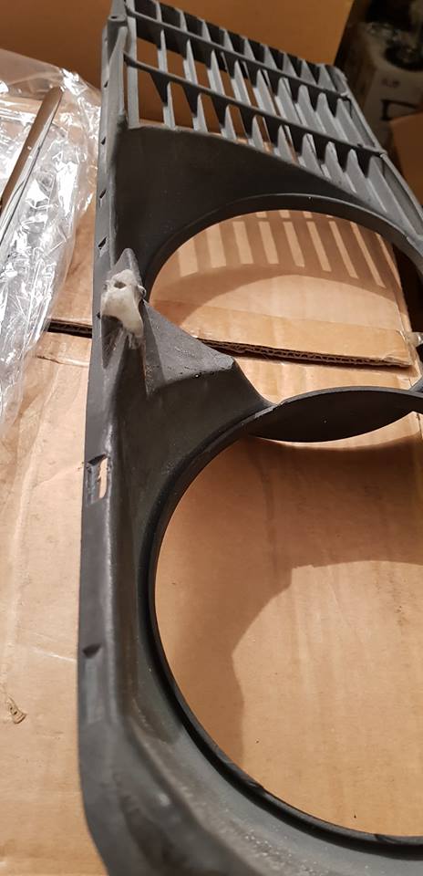

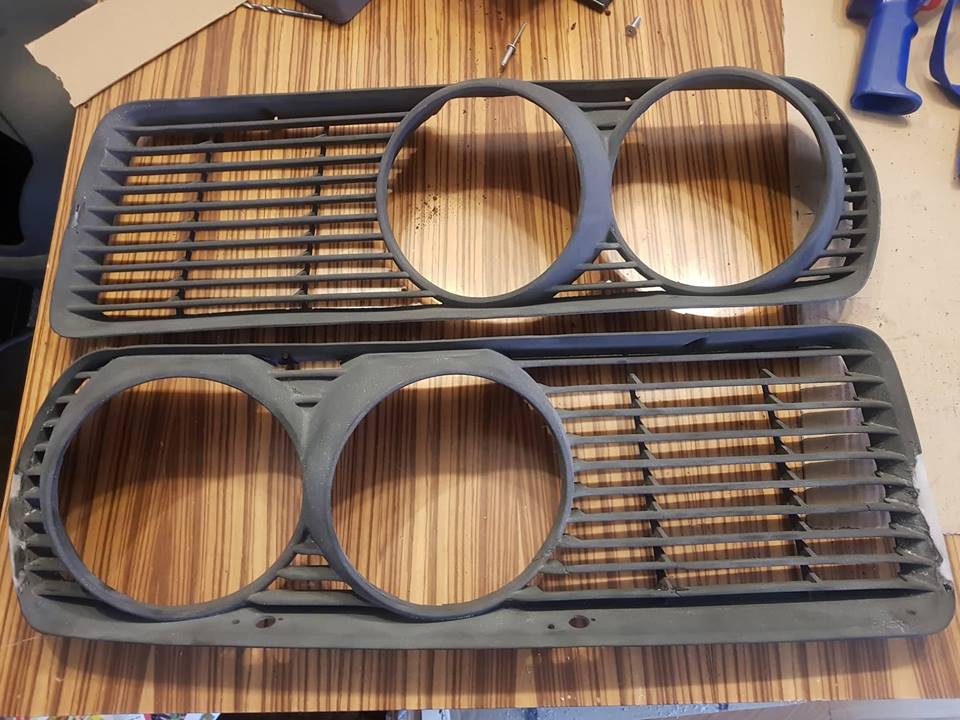

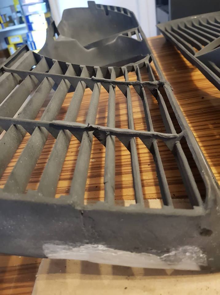

Price for new grills is crazy so I sandblasted both plastic mask grills to see all the cracks. All cracks were welded and missing parts were added. Plastic will be repainted in black. If they will look bad I will buy new ones.
View attachment 58473 View attachment 58474 View attachment 58475

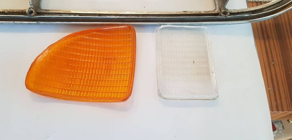

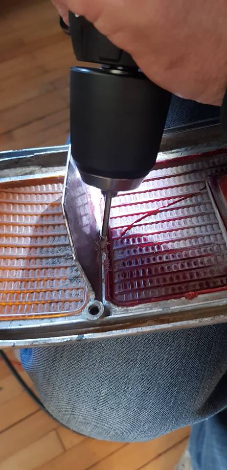

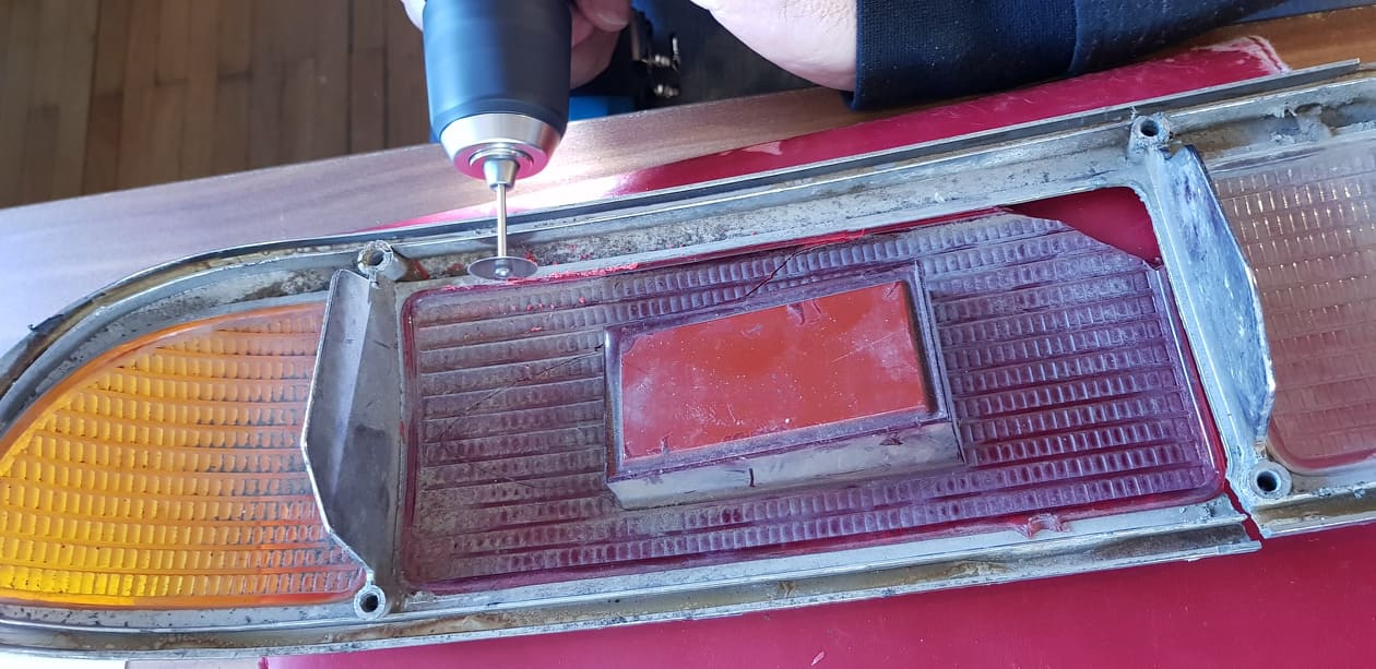

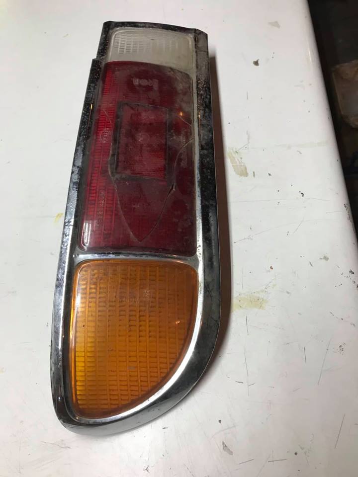

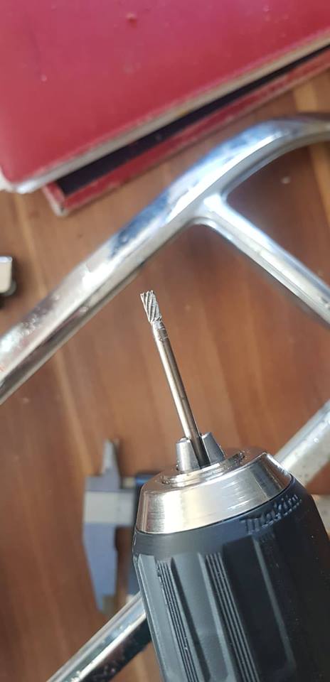

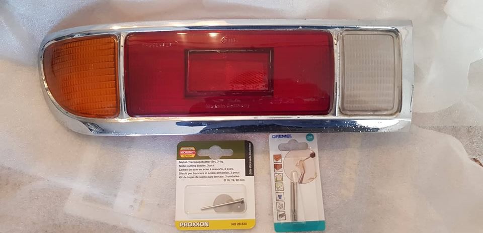

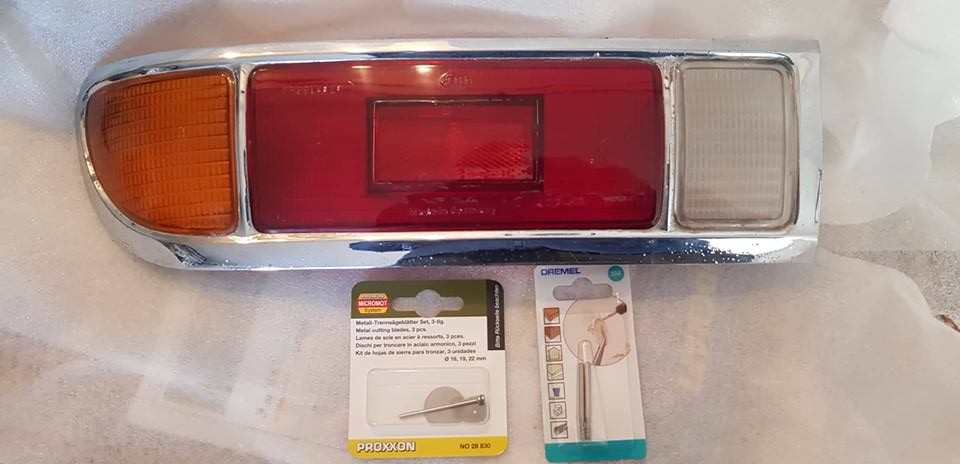

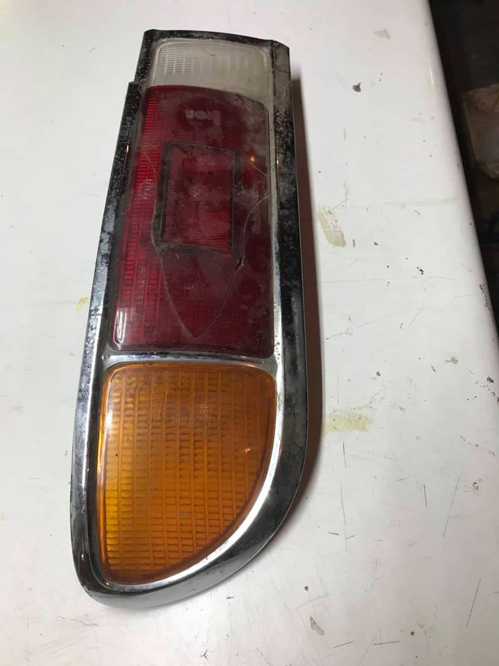

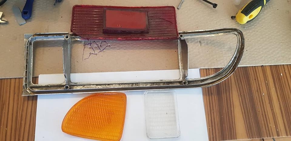

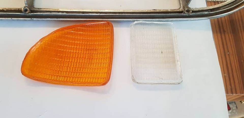

Plastic on my taillights is nice but chrome is not so nice. I decided to get taillight in bad condition (thanks to @Stan ) to learn the process of removing plastic lenses before trying on my taillights. They went out OK clean with no damages. I will have now frame re-chromed to see how lenses fit back in. If I will be happy I will do same work on my taillights.
View attachment 58476 View attachment 58477View attachment 58479 View attachment 58478

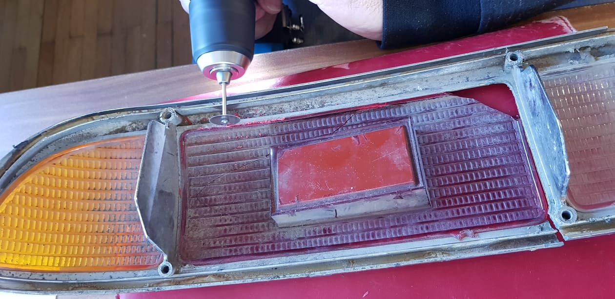

Lenses that weren’t already broken came out with no damage.
View attachment 58484 View attachment 58485 View attachment 58486

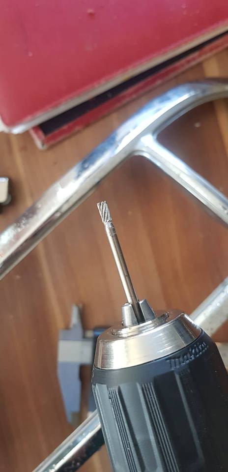

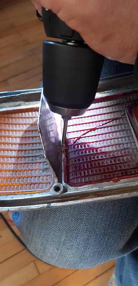

We used grinder since it has small rpm and plastic doesn’t melt when cutting.
View attachment 58483 View attachment 58482
When I get back frame from re-chroming I will see how lenses fit back and find best way to glue them back in.
