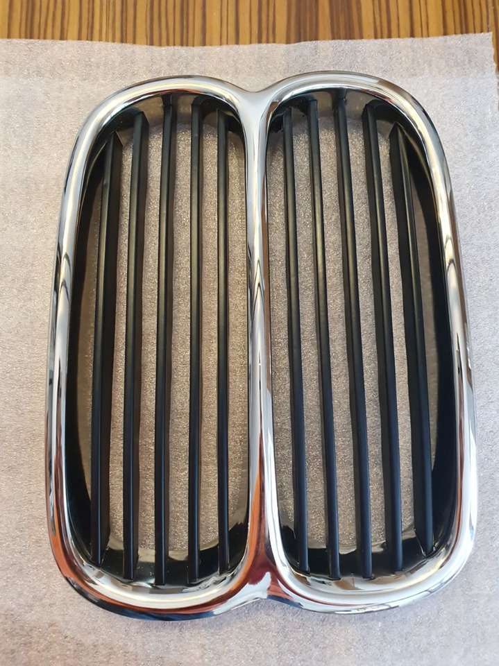

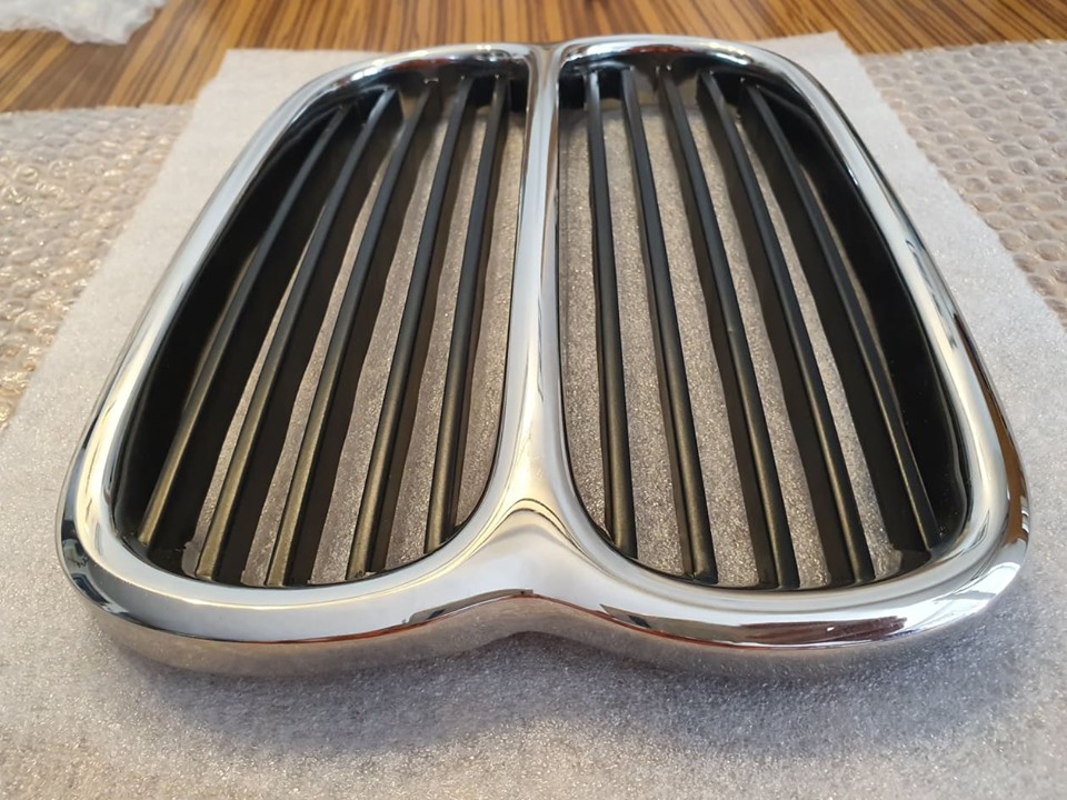

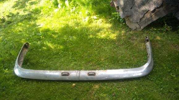

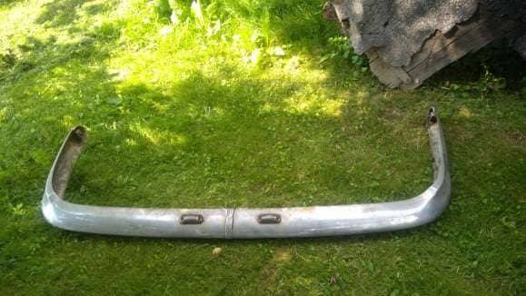

Got rear bumper from 2000cs since I will be running “clean” look with no bumper rubber in the back. Will install it after I get it re-chromed.

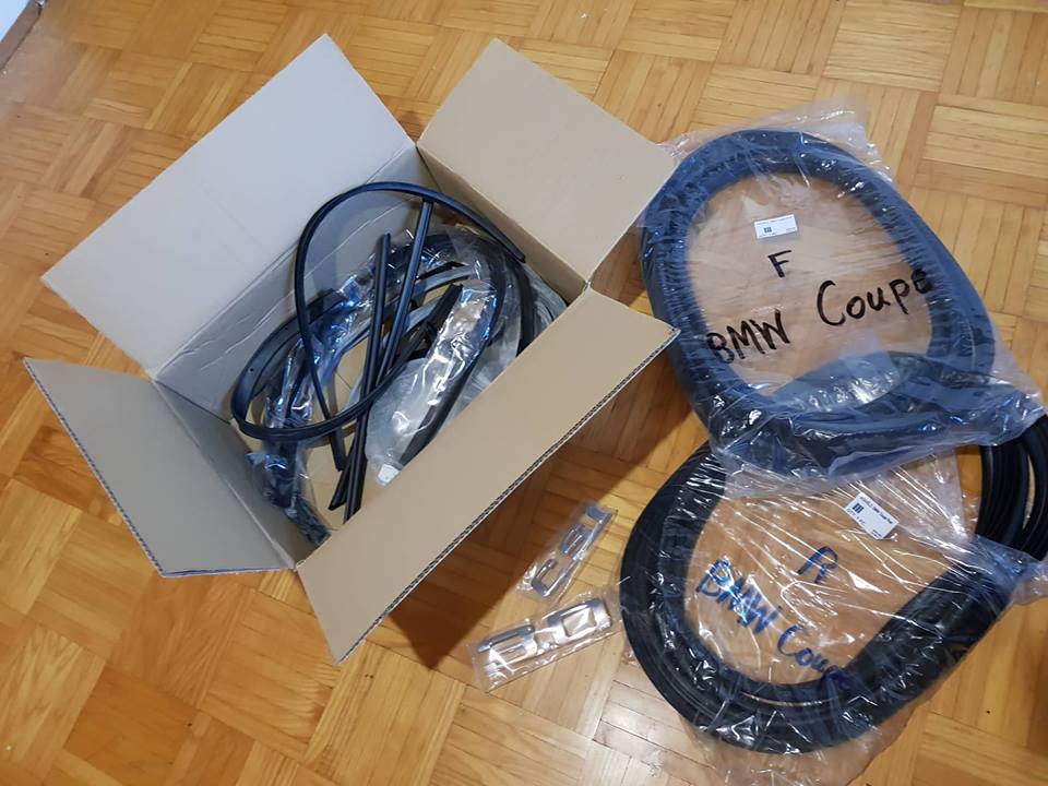

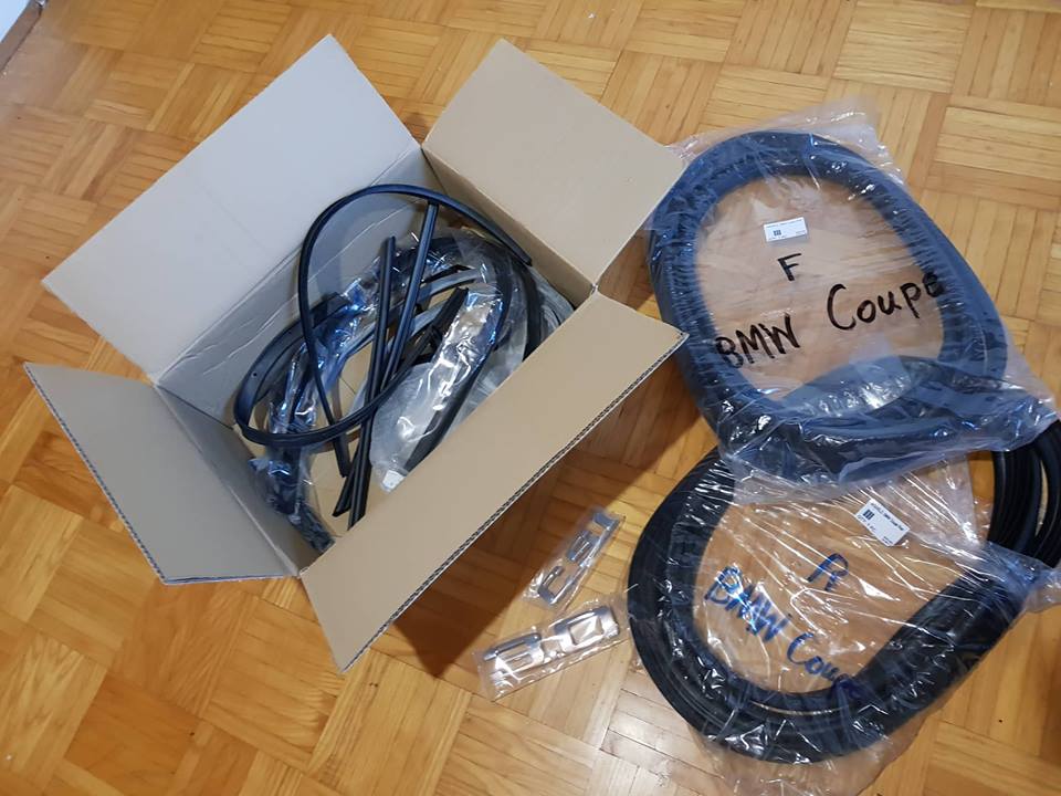

Also got some rubber parts – most important gasket for front windshield and rear as well. Will be removing both since I found some rust behind rear gasket and I don’t like to see edges of previous paint job since they didn’t remove gasket when they painted car.

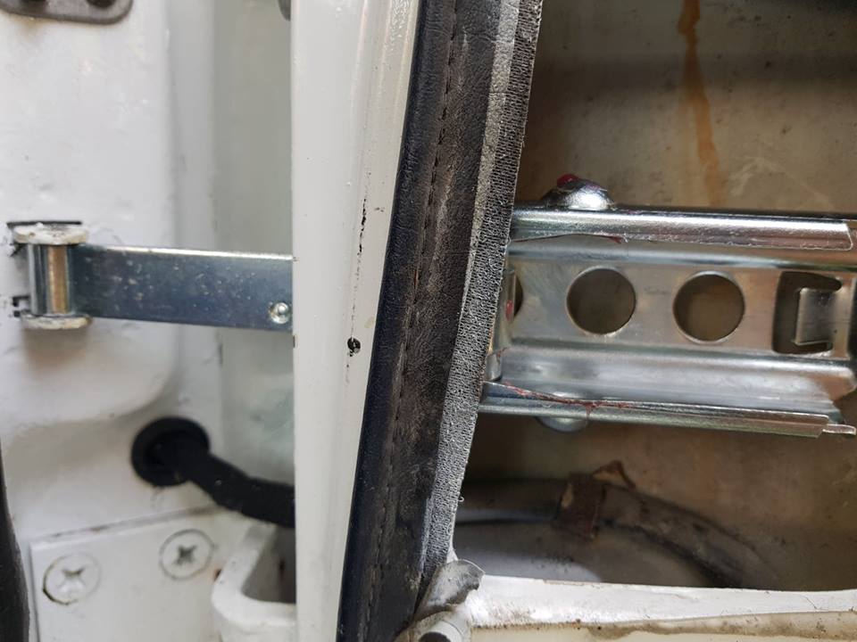

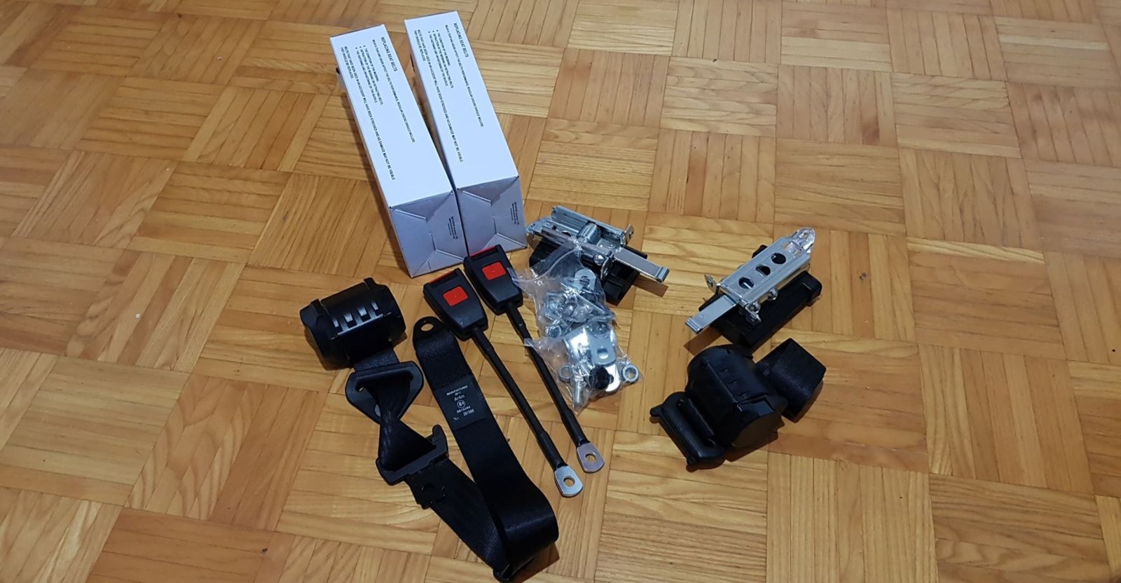

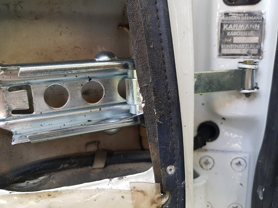

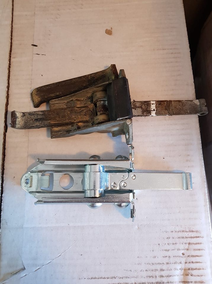

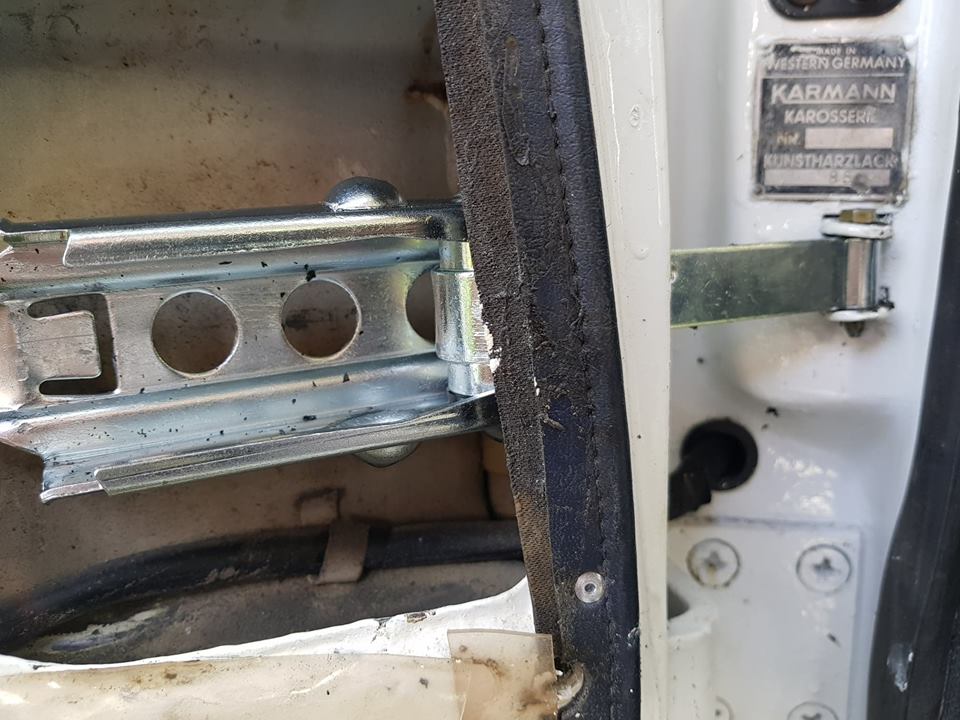

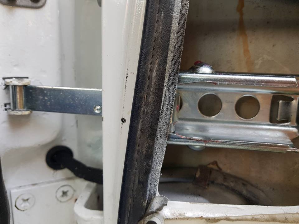

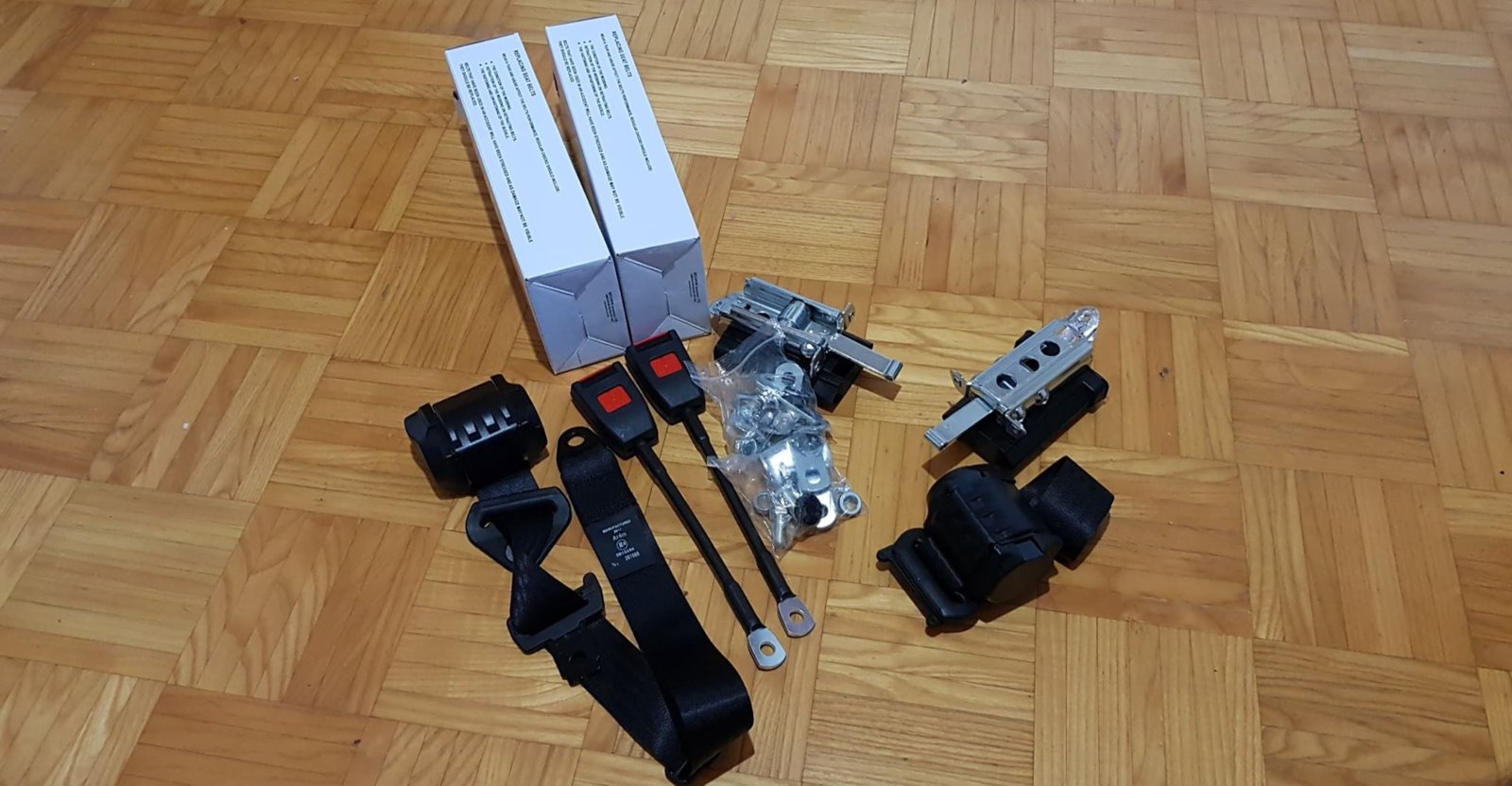

Also got new front seatbelts (bought it with no seatbelts at all) and door stoppers - drivers’ door opened so much that it touched body and passenger door didn’t stay open. Bought Meyle: 014 072 0034 https://e9coupe.com/forum/threads/door-brake-break.11538/page-2

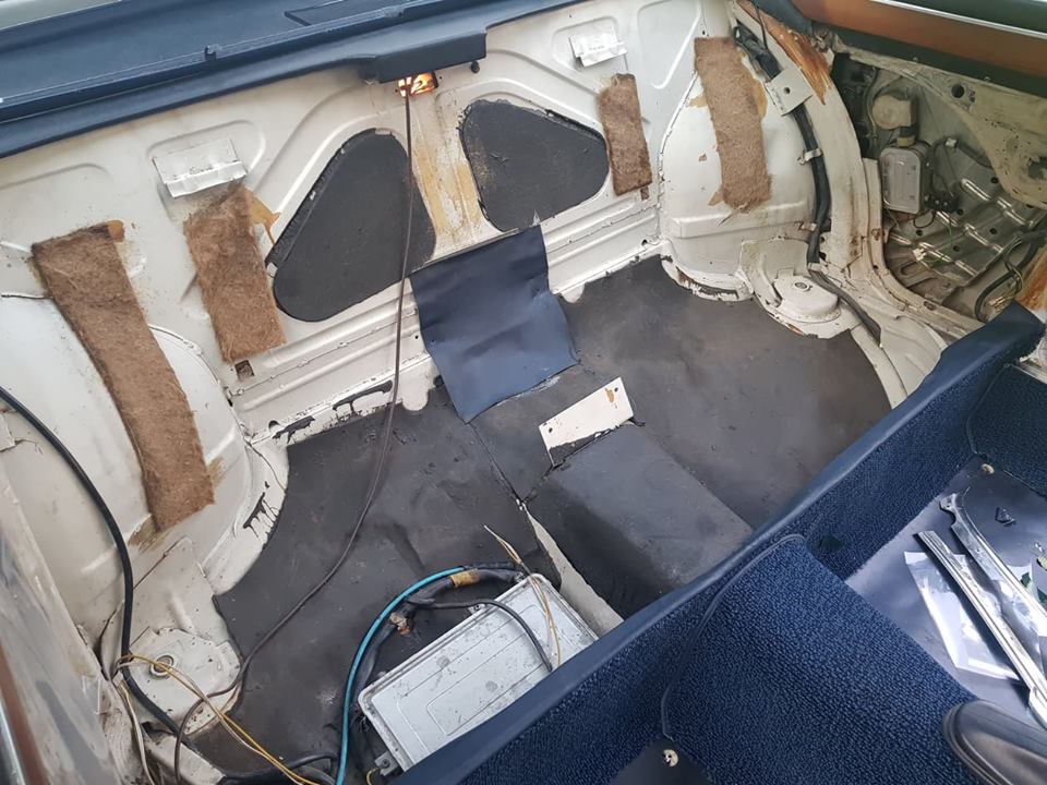

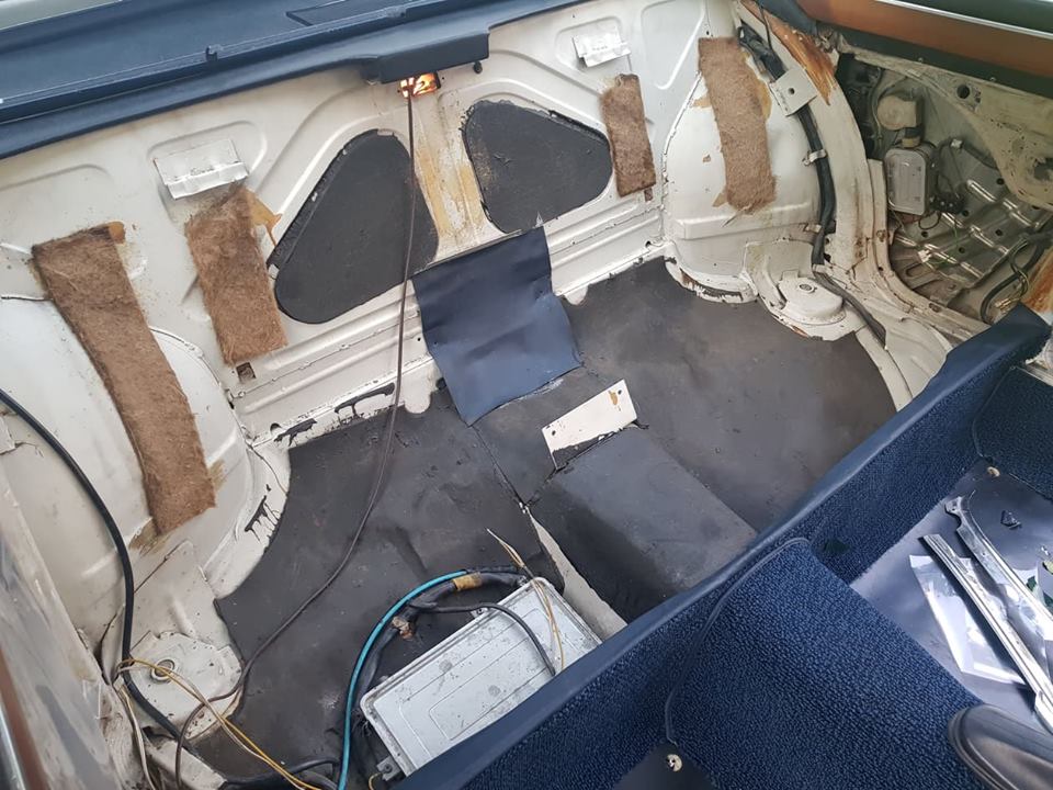

Didn’t remove sound insulation on the back of the car since it looked clean and I would never be able to fit new deadening insulation on the curves – maybe in the future but I don’t think so.

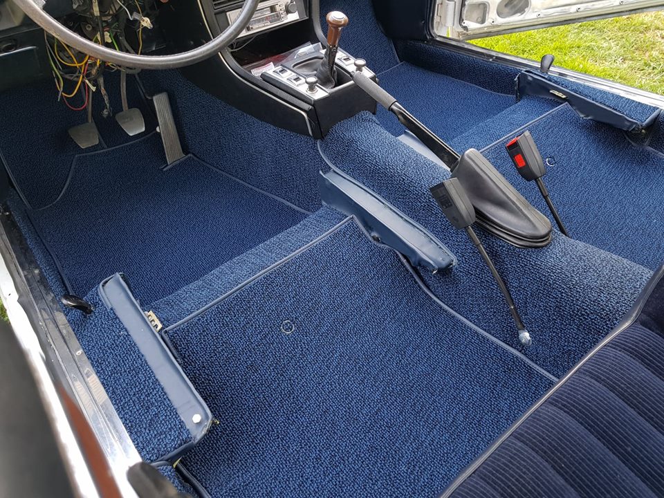

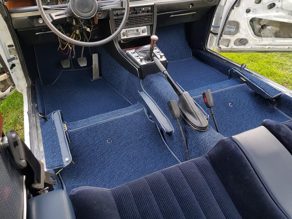

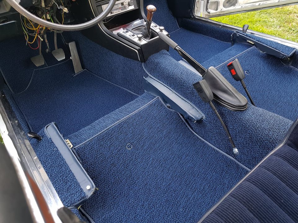

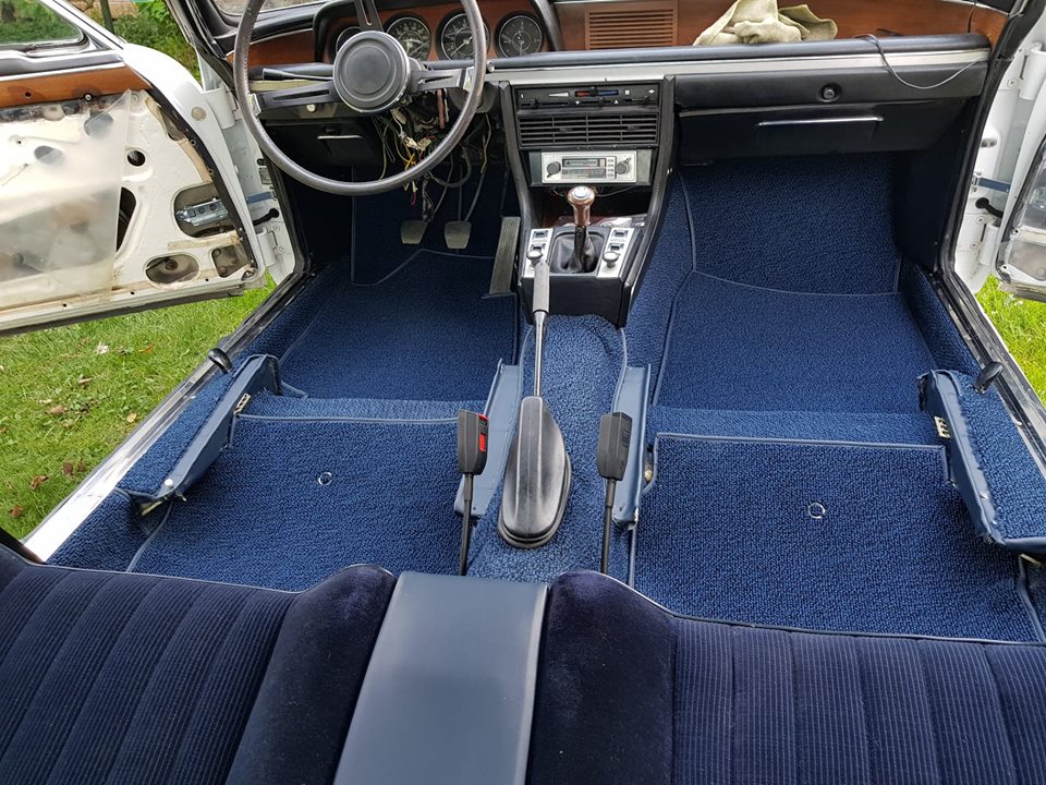

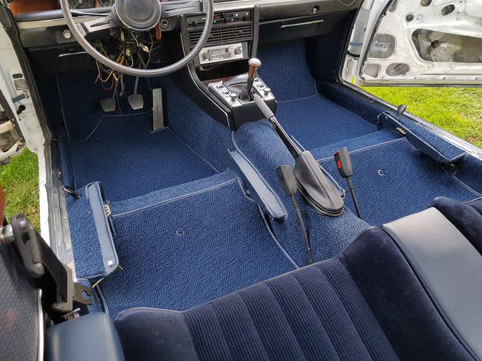

I put new carpets in the car:

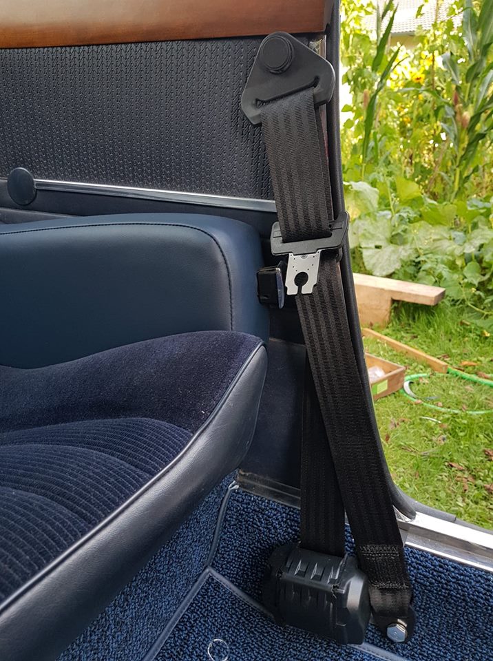

Mount seatbelts – I didn’t want to drill in wood so I made reinforcing plate behind panel and mount holder on.
Replace door stoppers:
View attachment 50055 View attachment 50056

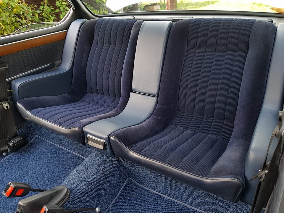

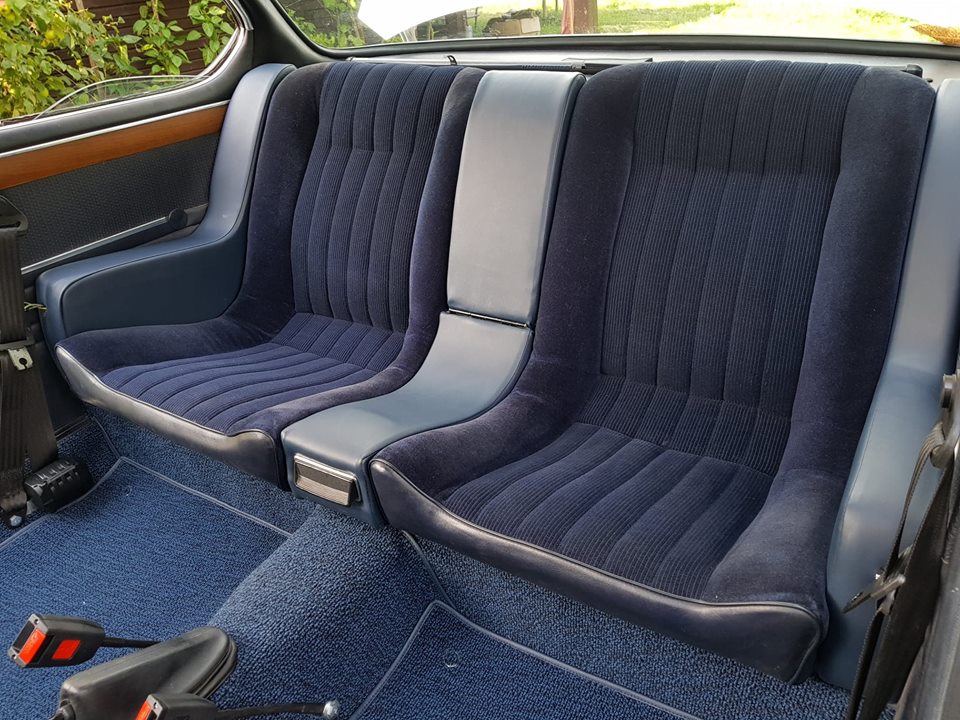

Put rear seats back in - I had them cleaned and middle seat section upholstery was replace due to cigarette holes. And all rear leather parts are reupholstered.
That is it for now .

Do you have more pictures about the seat belt mounting point and the bracket that you built on the upper point?
What model of seat belt did you buy and they have even the European omologation?
