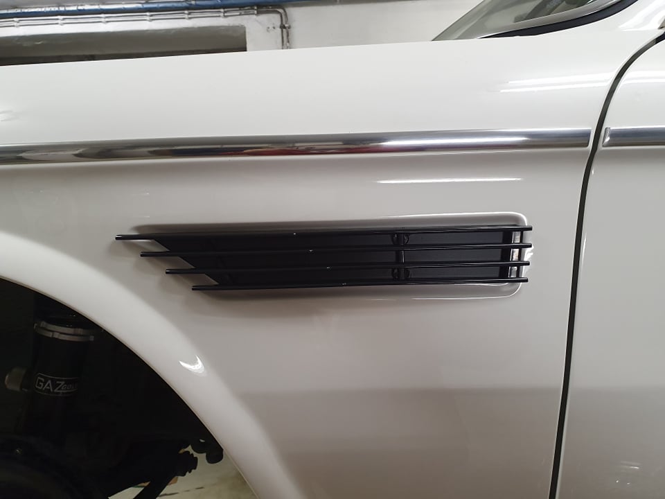

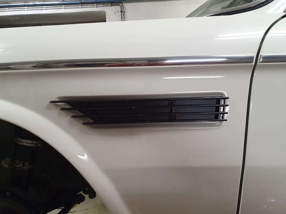

Wing sticker for fender grill was delivered and is now fitted for second time and this time I am happy with its position.

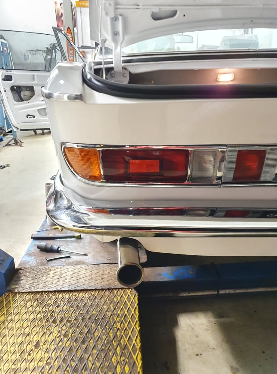

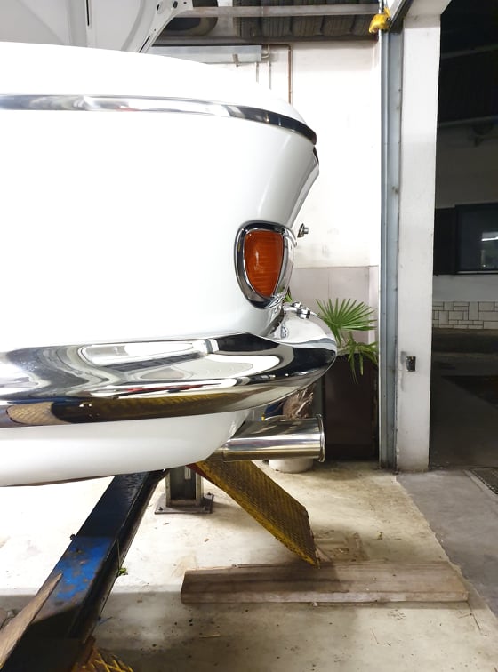

Working on exhaust tip to see how far out to position it

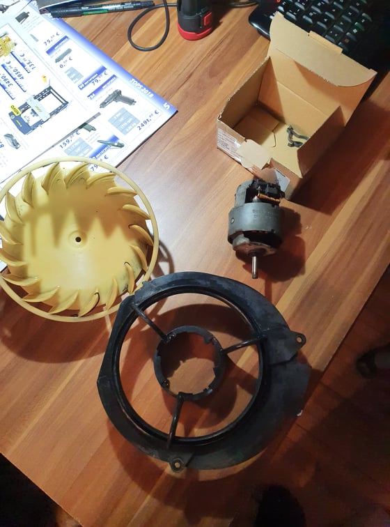

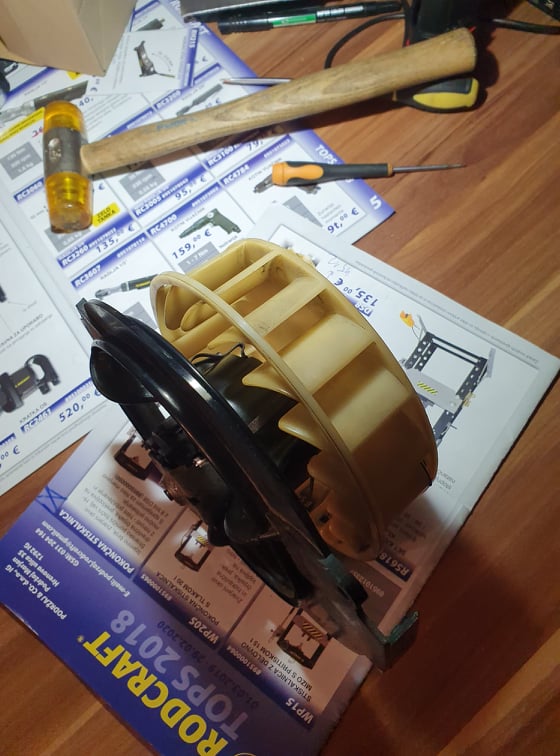

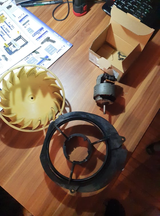

Ventilation was not working so we take apart blower motor. Now it is working but it is making noise like it is rubbing against something can’t figure it where or it is maybe just out of balance

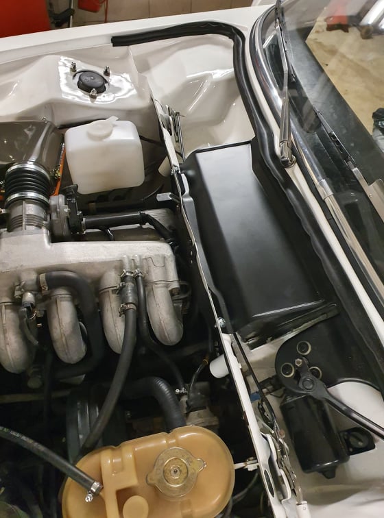

Installed new wiper tank and ventilation cover but will have to take it off again to access the blower.

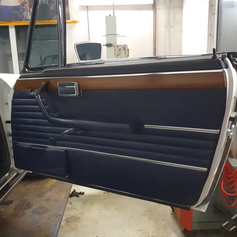

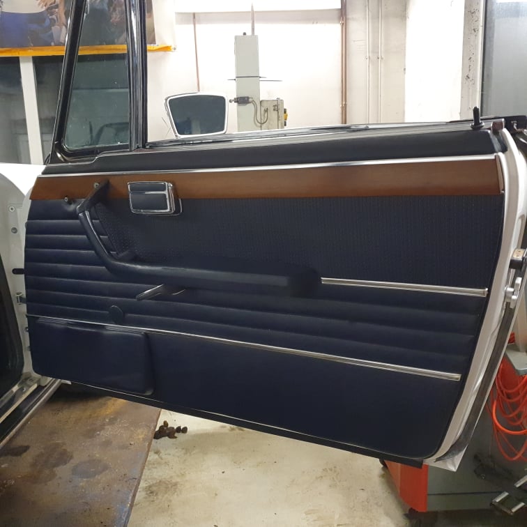

Installed door cards

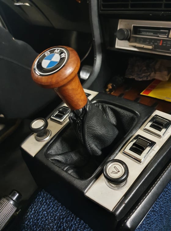

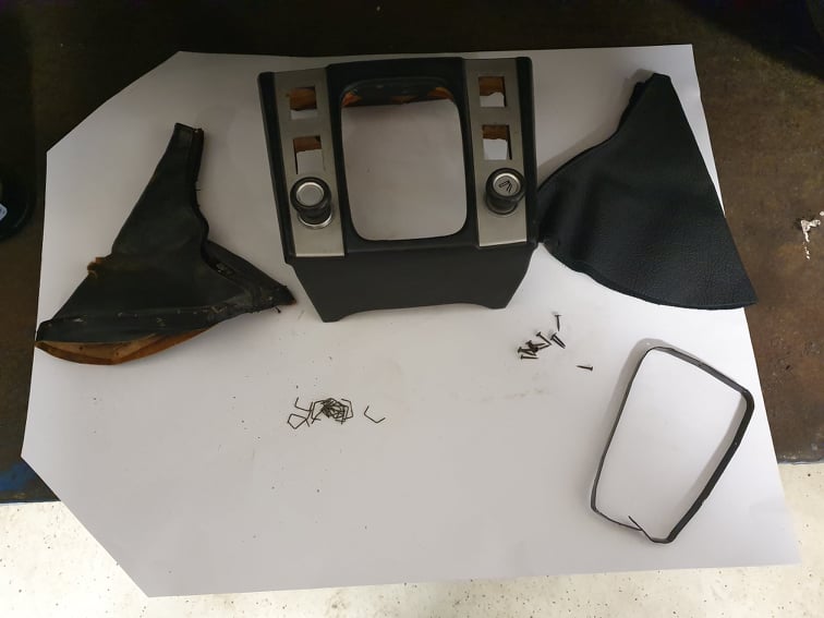

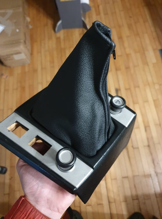

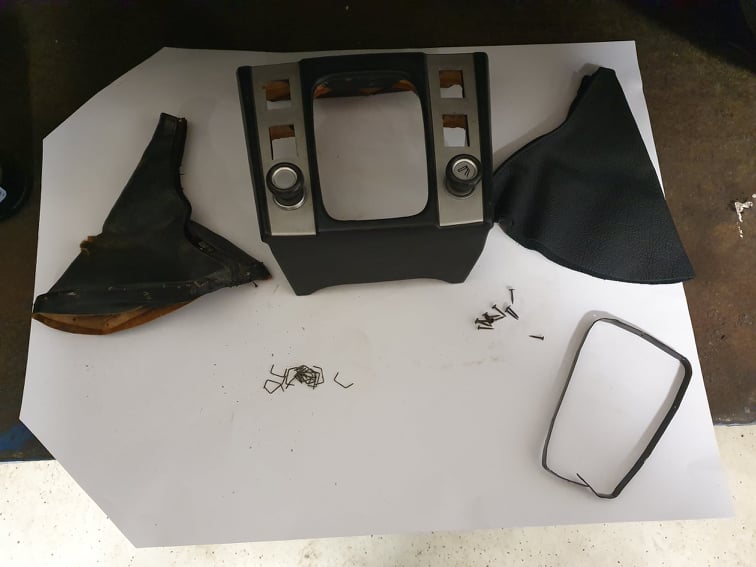

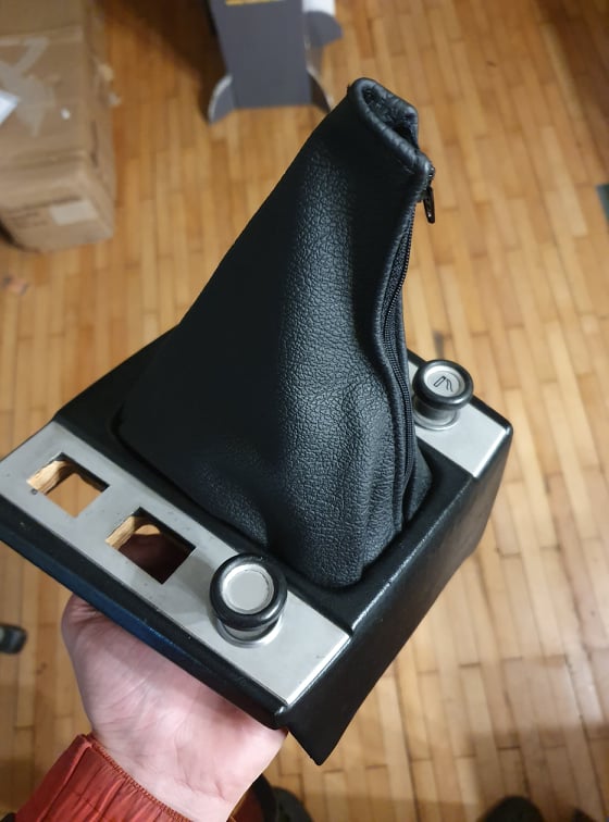

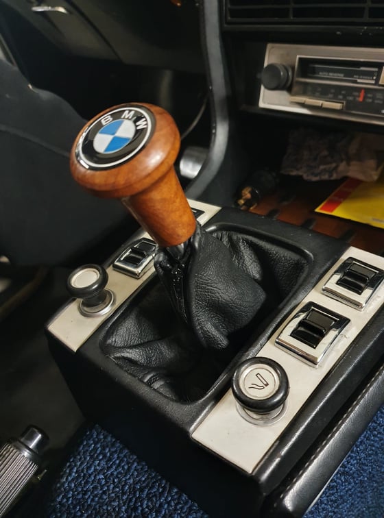

Installed new gear boot and knob.

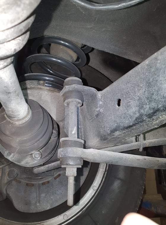

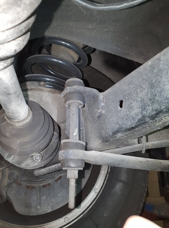

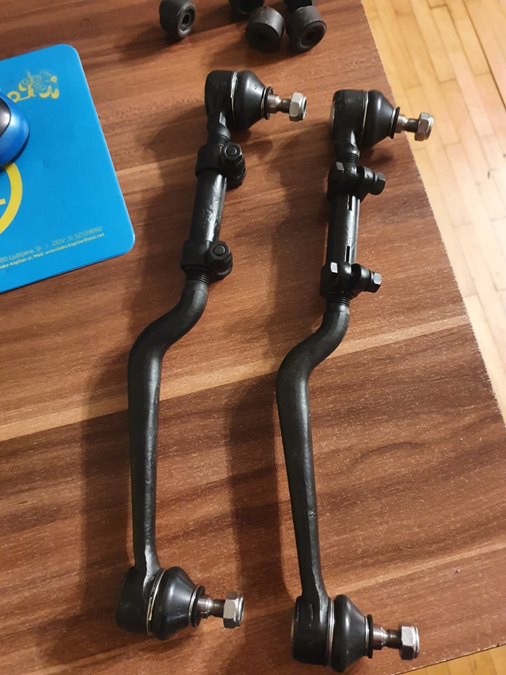

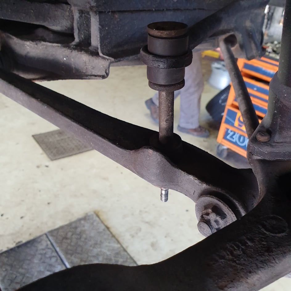

Had the rods rebuilt and new sway bar rubber bushings were fitted.

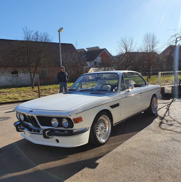

Installed BBS RS 17” 8&9J to check clearance. Rear fits with no problems also no rubbing anywhere. Front tire is too close to coliover thread nut (no rubbing just to close for comfort) so I will add 3 mm spacer.

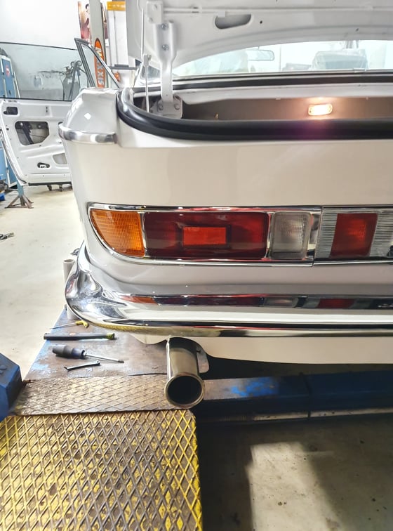

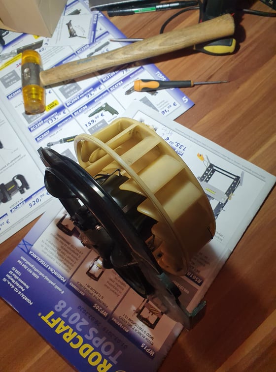

View attachment 86432View attachment 86431

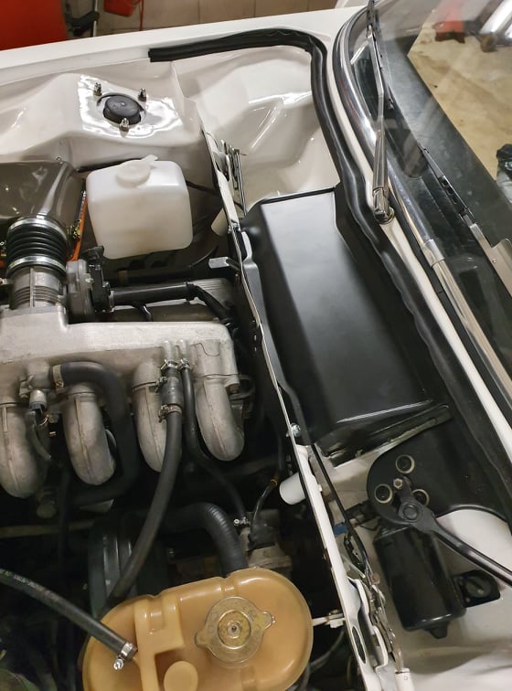

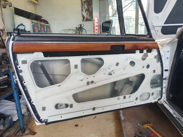

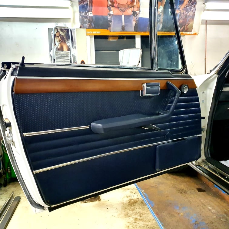

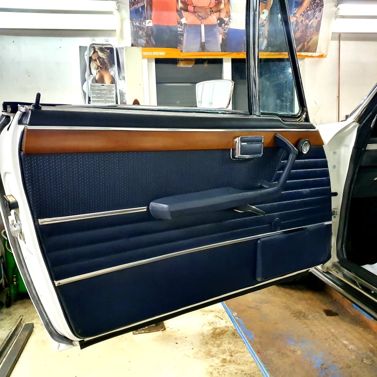

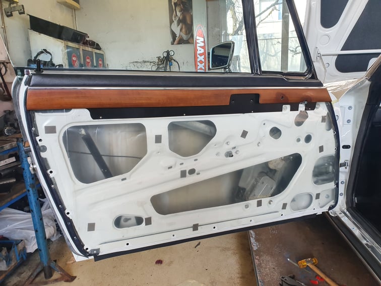

View attachment 86444View attachment 86454View attachment 86453

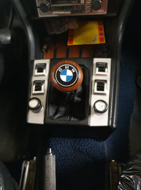

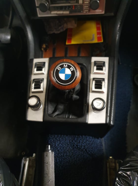

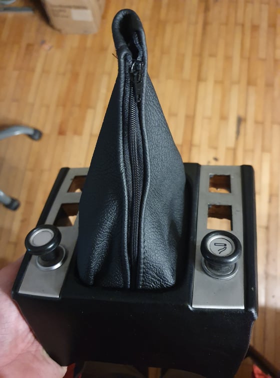

View attachment 86438View attachment 86437View attachment 86436View attachment 86435View attachment 86434

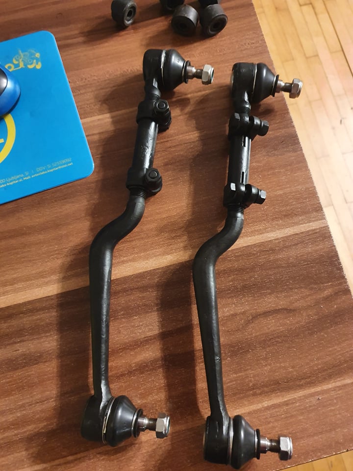

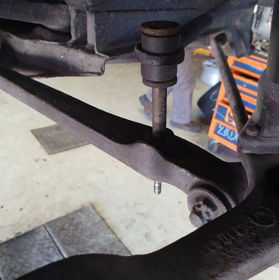

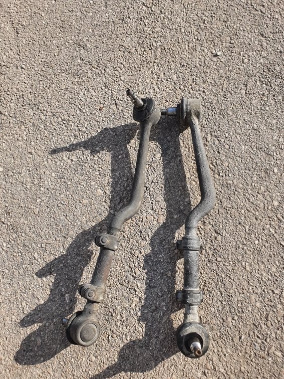

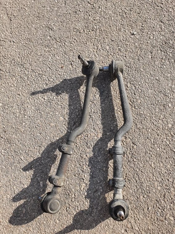

View attachment 86440View attachment 86442View attachment 86439View attachment 86441

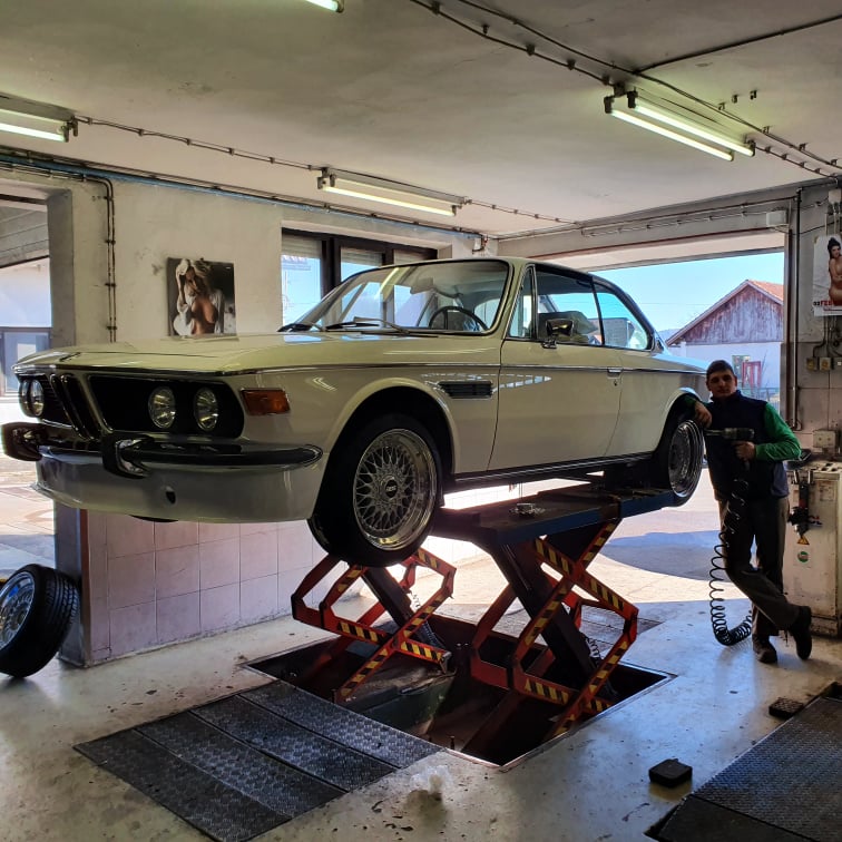

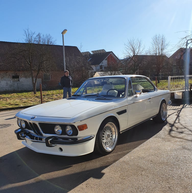

View attachment 86446View attachment 86445
That car looks beautiful. Love the 17 inch RSs and the stance. I had the same issue with my 17 inch RSs, but swapped the inner barrels to 5 inch barrels, after that there was no issue with rubbing or clearance. I did that to avoid using spacers but it is a PITA to swap the barrels now after the wheels are done.
@Ajay thanks.
I already swapped inner barrels I had 8.5J in the beginning but when I tried them on I had car lower than now so the coliover nut was above tire... I will drop the front end a bit and use 3 mm spacers.
@Ajay thanks.
Sounds good. I had good luck finding hub centric spacers on ebay and Amazon.

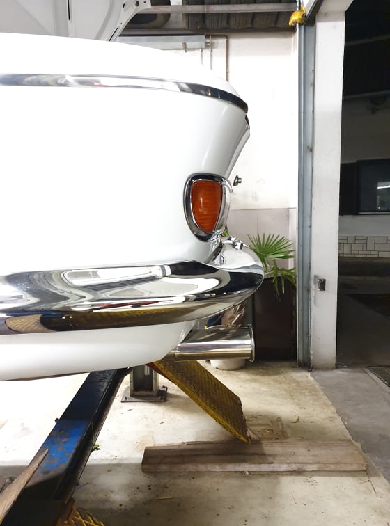

Removed rear muffler since it had hole in it and I was not able to buy stainless one already made so I simply replace it with stainless steel direct pipe. Will post sound clip later.
85098855_677019913038441_6042251960147509248_n.jpg85102041_891135648013741_6542966149527633920_n.jpg

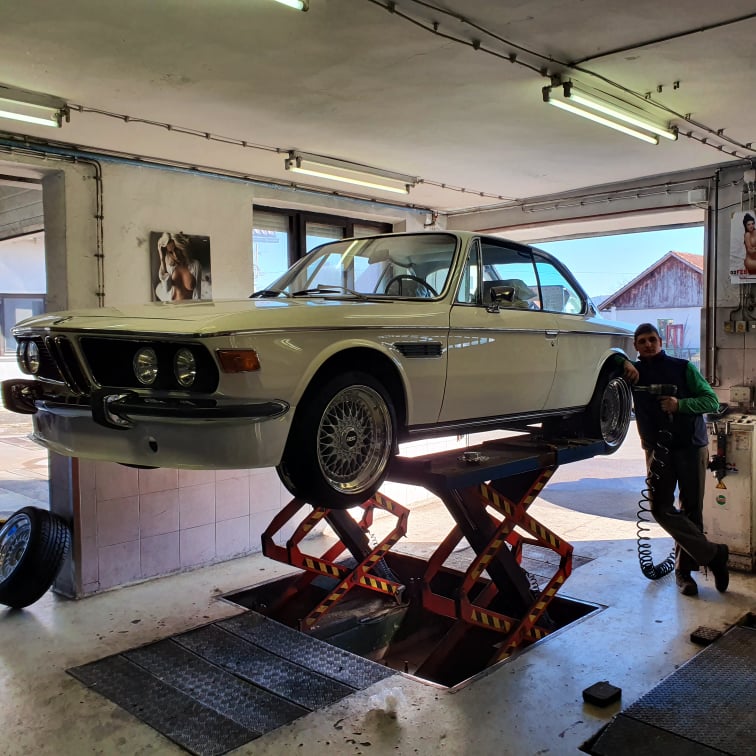

And I dropped car for 2 cm in front and 1 cm in the back now it is ready to have wheel alignment done.

Wheel alignment was done
