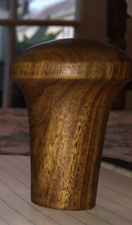

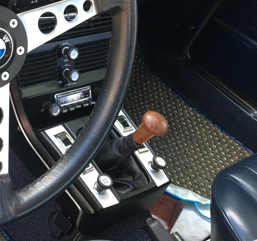

Replacement gear knob arrived today.
Looks great fitted.

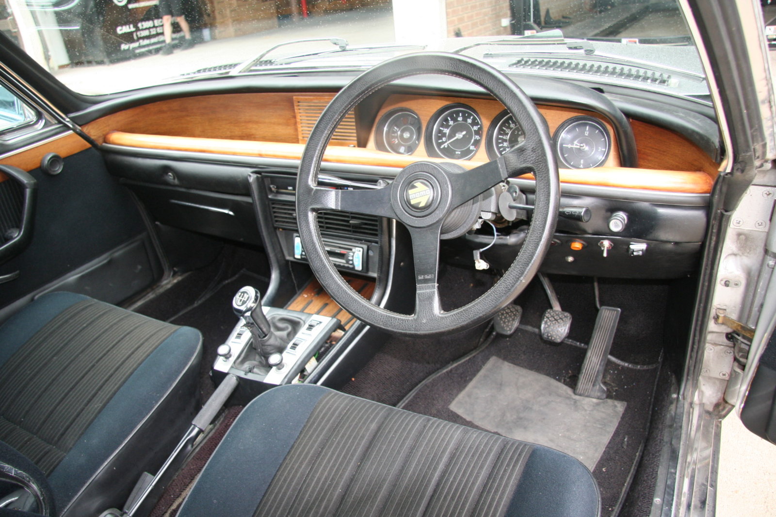

Thought I'd post a picture of my Momo wheel.
What would have my car originally had, I'm assuming a wooden Nardi?
Since this pic was taken I've ditched the gear knob in favour of a period wooden one and fixed the consul.
As I start sourcing parts I'm also curious what peoples feedback/ideas are on installing an air dam, as opposed getting the front bumper re-chromed.

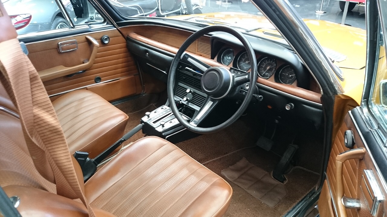

Unfortunately RHD cars (non-CSL) had original steering wheels as per below, with some having the wheel below with a wood rim. There may have been other variations but these are the most common for RHD cars.
