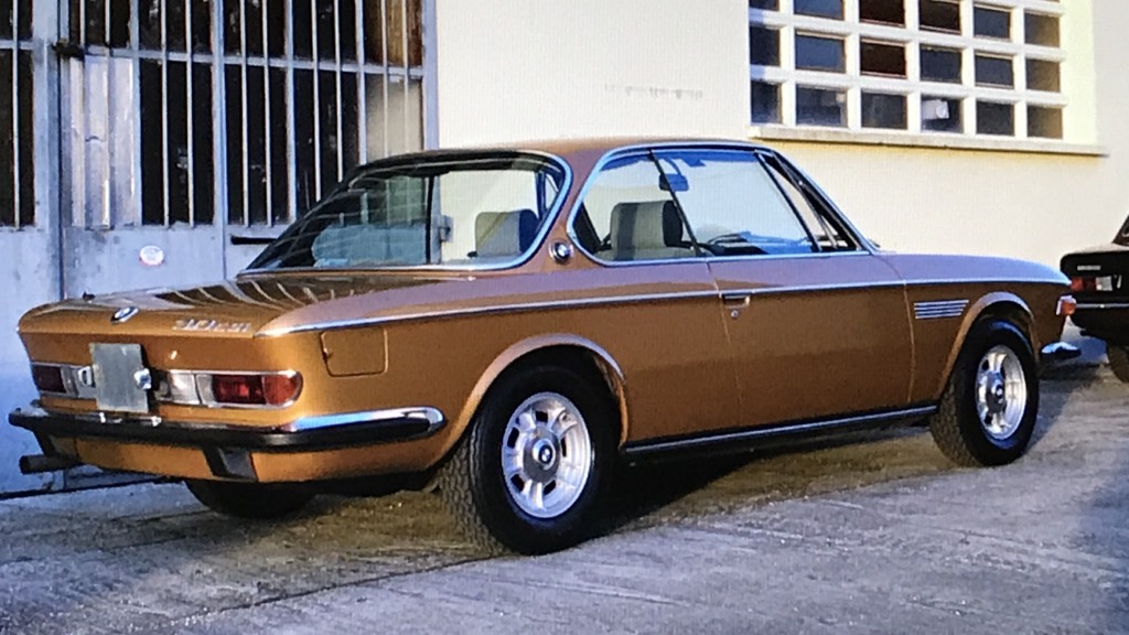

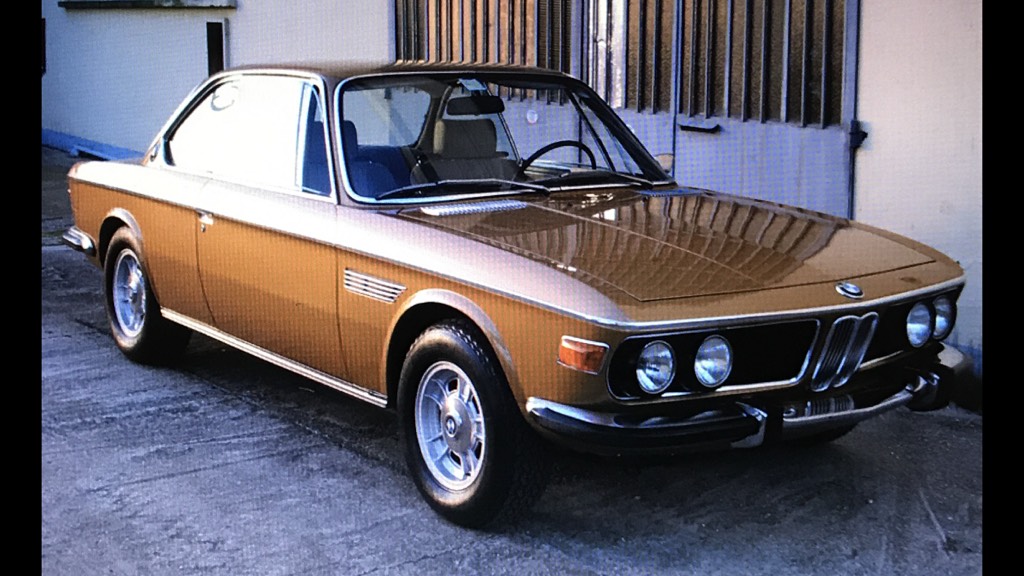

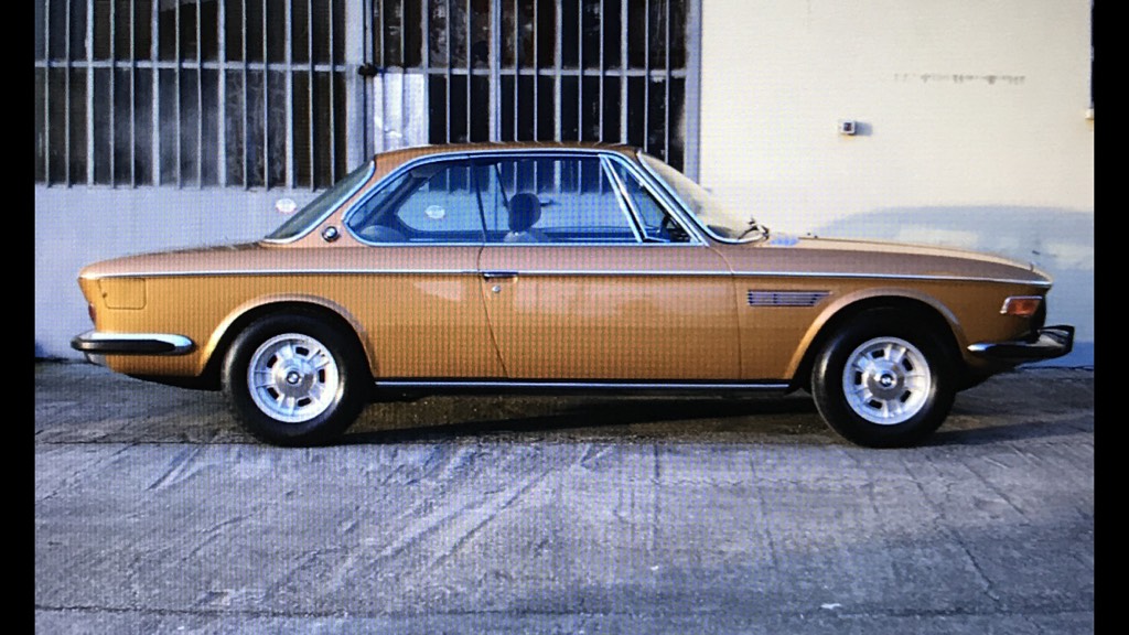

Some old pics but simply gorgeous in gold! Specially with the two tone, grey/ black interior
