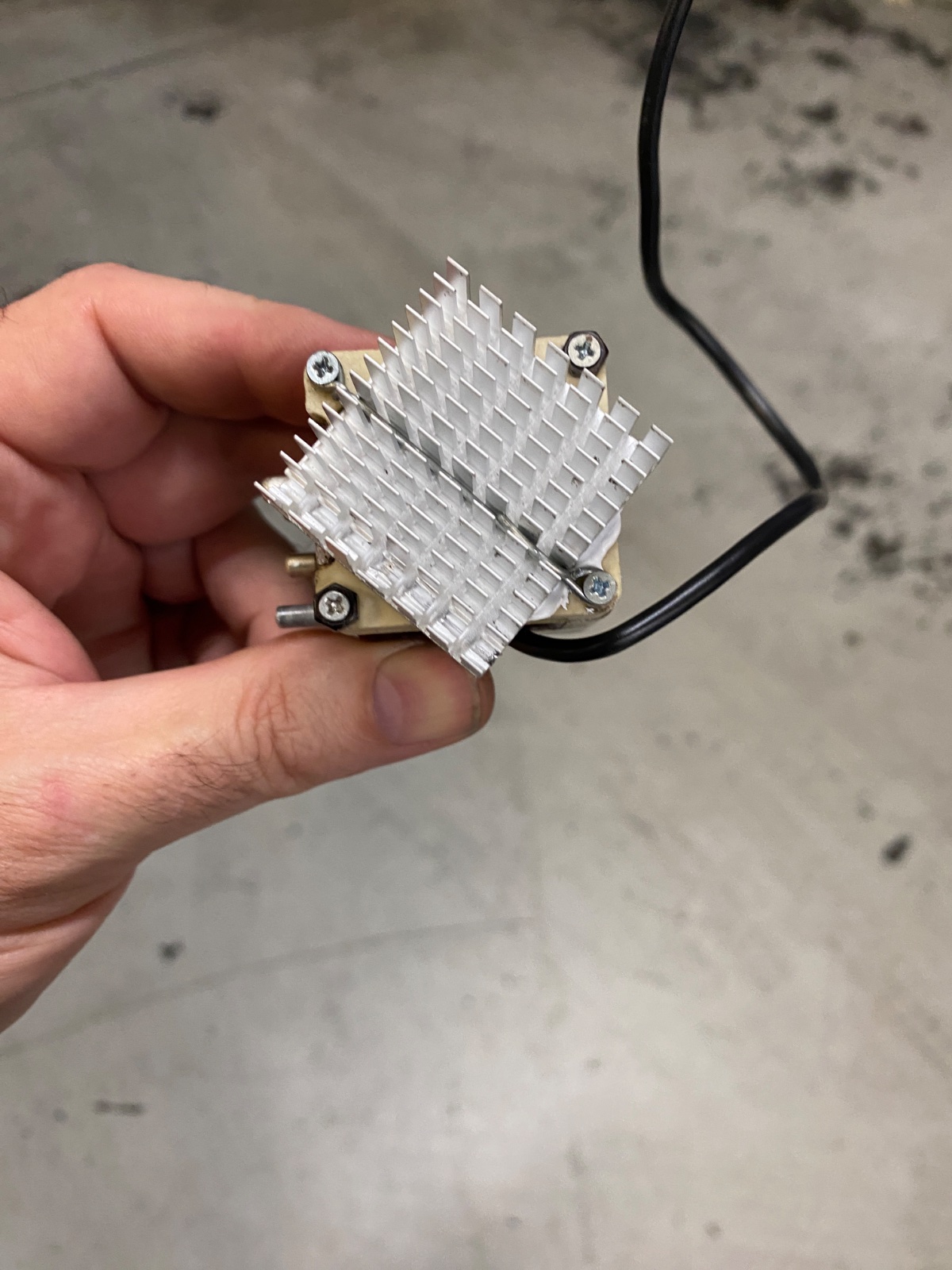

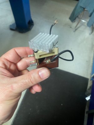

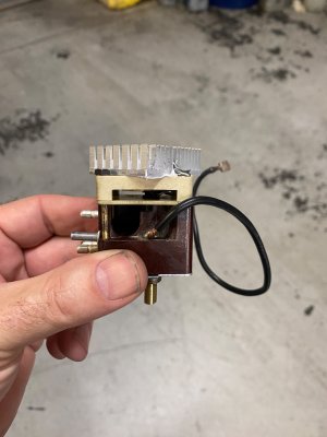

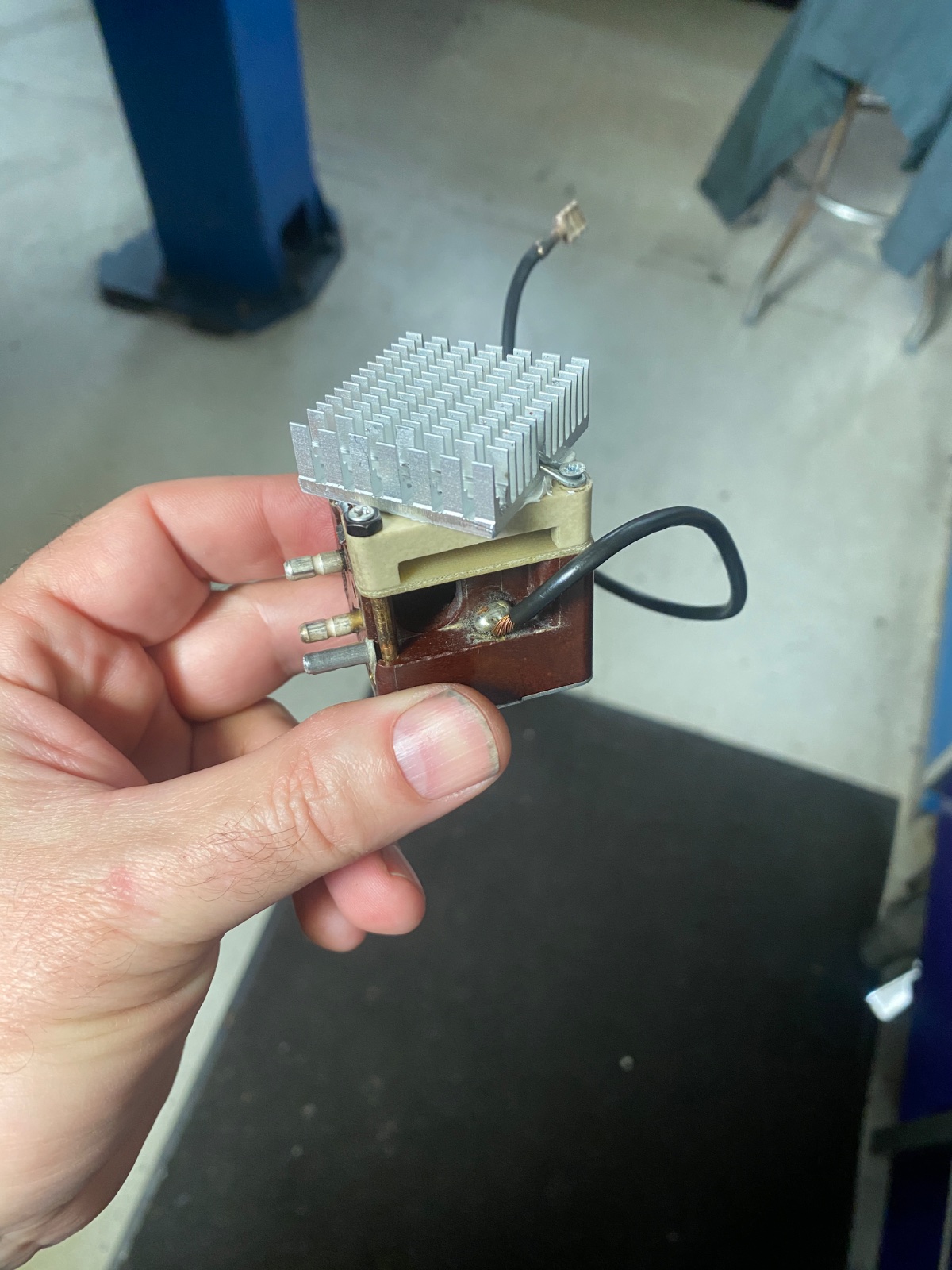

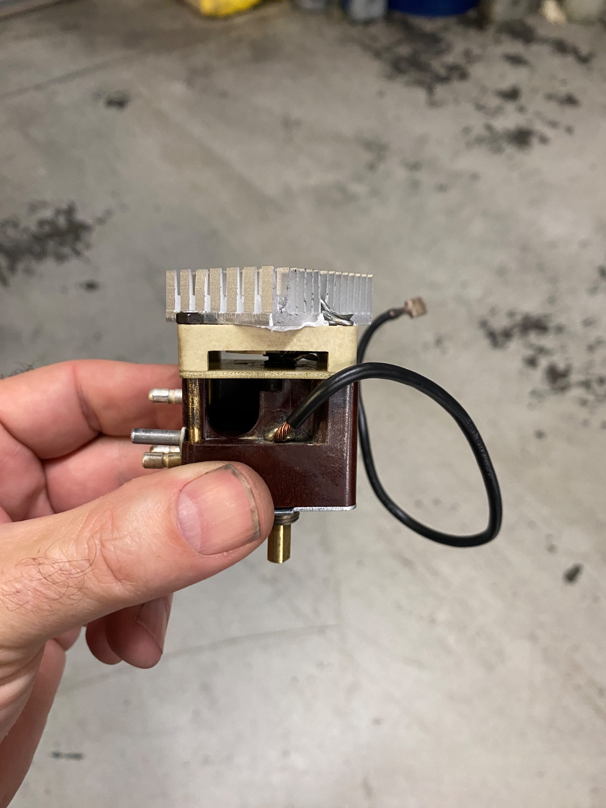

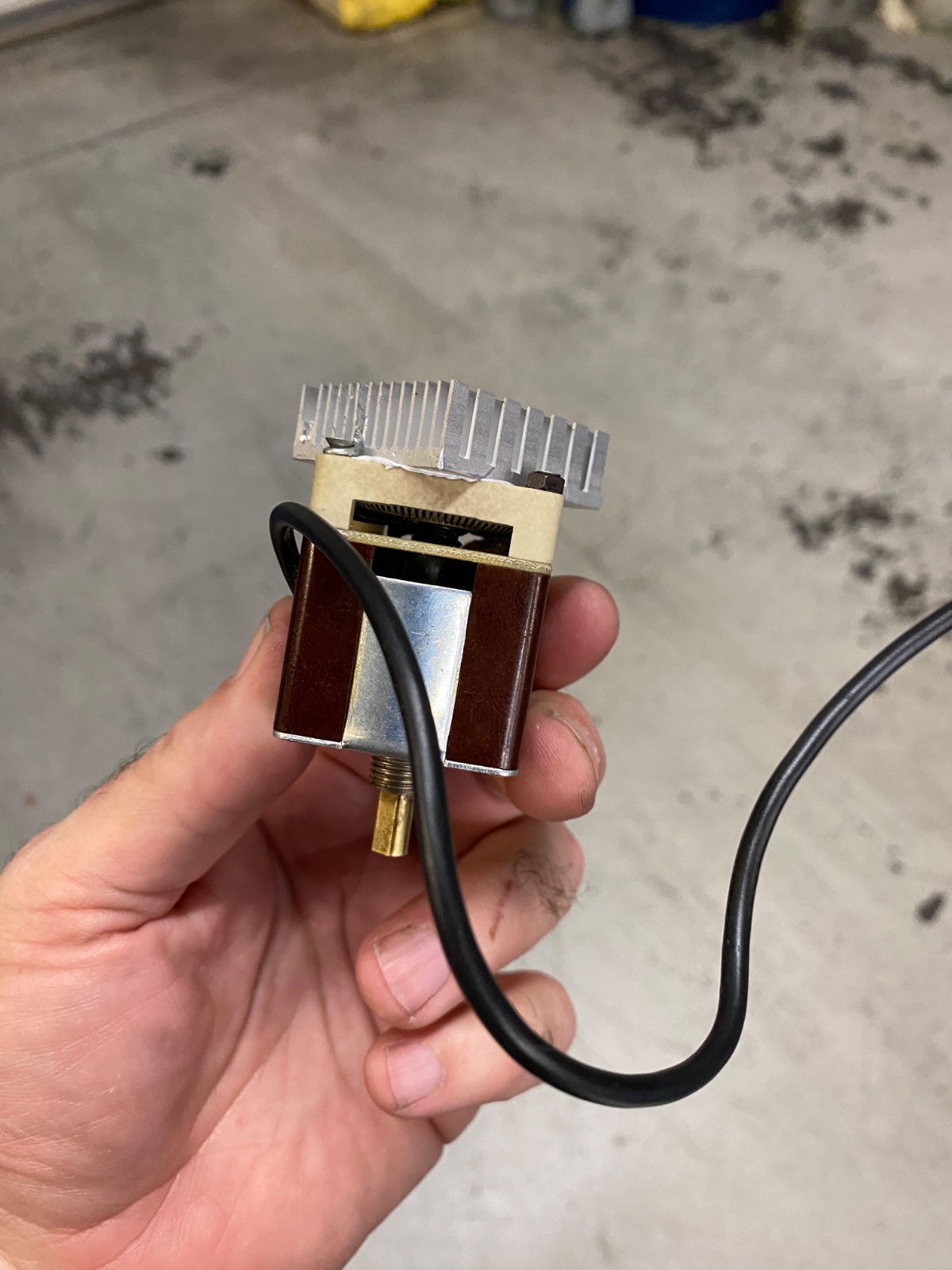

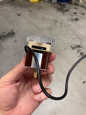

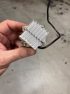

Might be too late but the fan speed controller needs a little more cooling to prevent damage. This is what we did for my daughter's car.

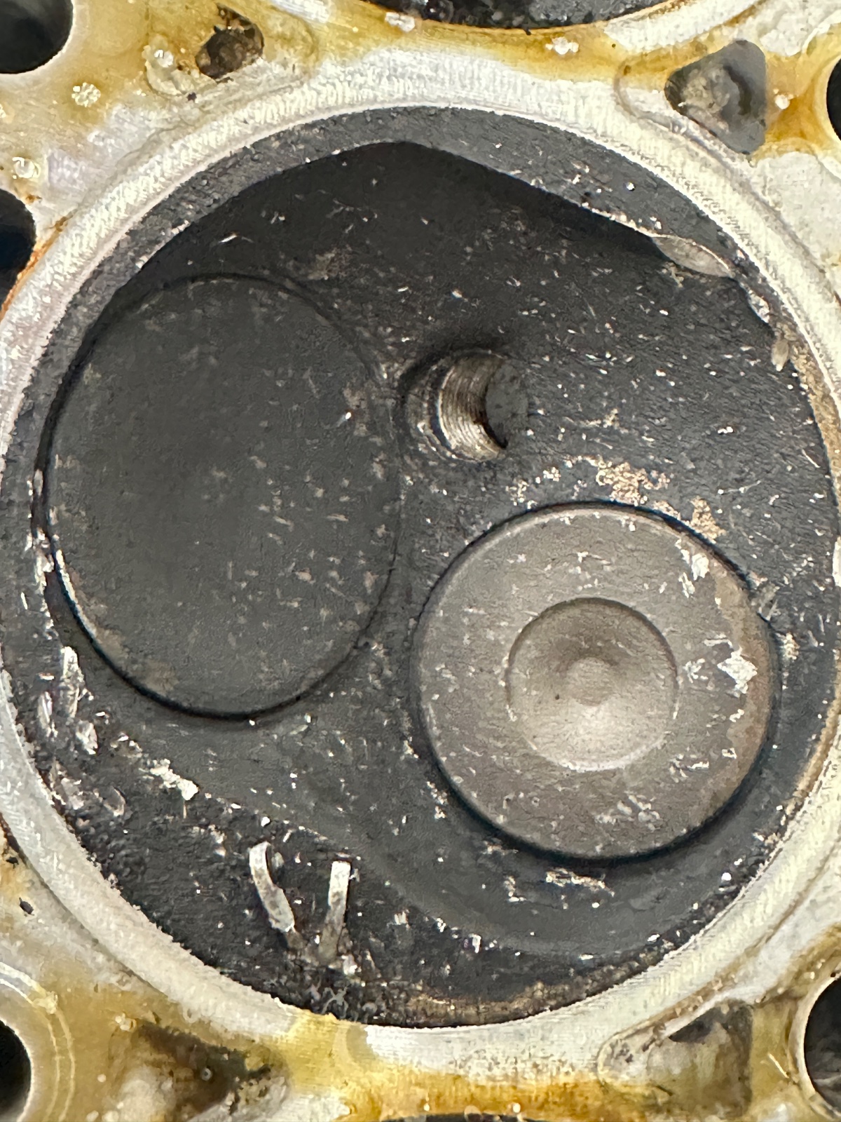

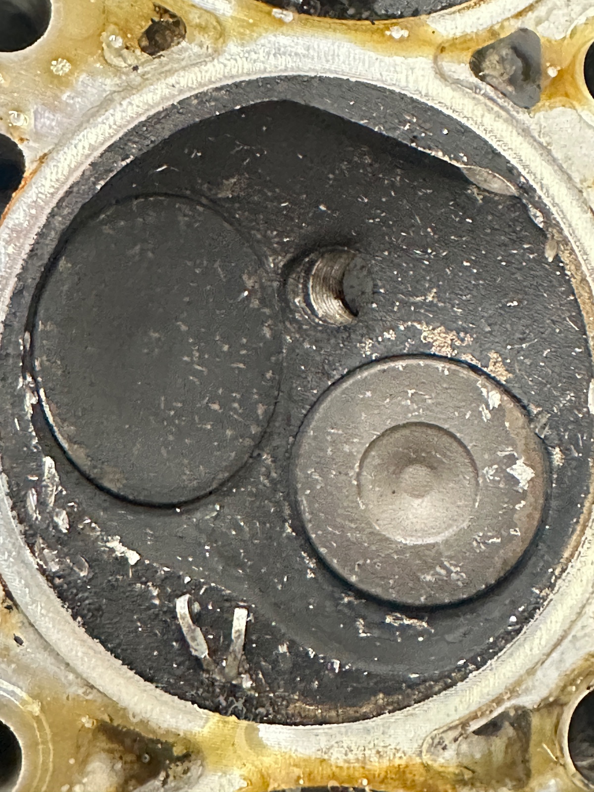

In April I had a problem while driving home from an event. I had the throttle stick partially open. It was the first issue I have had since rebuilding the engine about 4k miles ago. I “blipped” the throttle to see if that would solve the issue, but it didn’t. I shut the engine off and restarted only briefly to get around the corner into a lot…but that was to much.
What happened was one of the fasteners had come unscrewed and fallen into the rear carburetor, causing the throttle shaft to block in the open position. I had the car towed home and used the borescope to check, and sure enough the missing washer was in the cylinder.

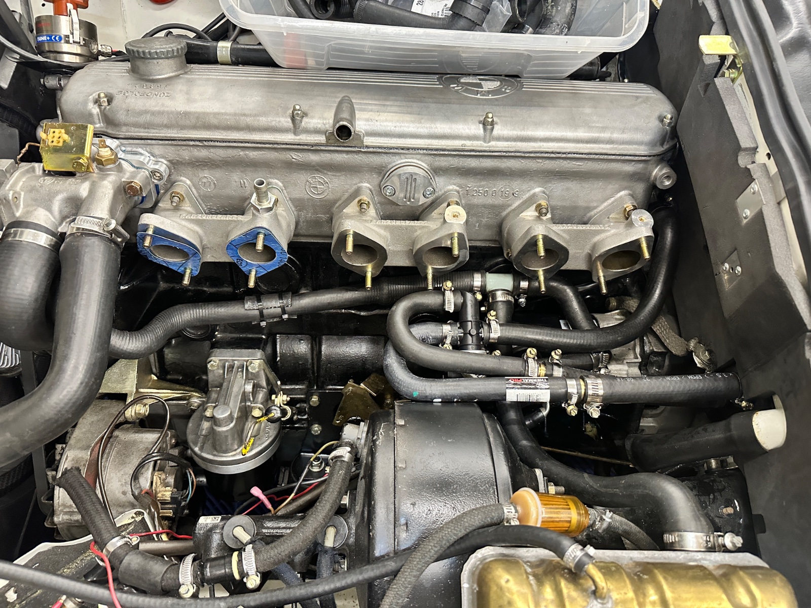

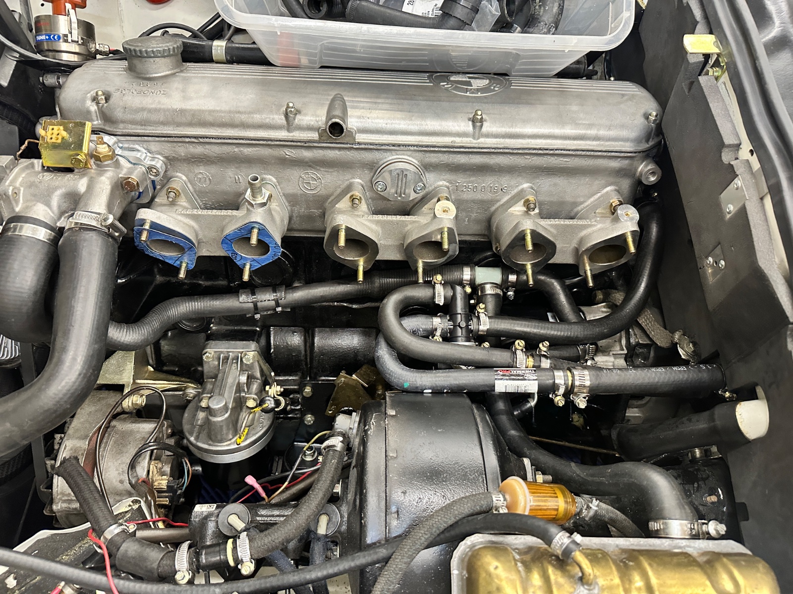

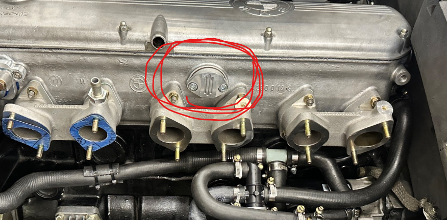

I am going to go back down the triple weber path and see if I can make that work. I had the manifold, carbs and linkage on the shelf. While waiting for the head to be finished at the very busy machine shop I spent some time soda blasting the carburetors and rebuilding them. It was a bit of a challenge as the carbs are a late Italian Weber DCOE model that has a different configuration with two “high speed tubes” that run from the carburetor top through the body terminating in the choke/venturi. The issue with these being different is that there was some damage to one of the tubes, so I sourced some brass tube of the correct ID/OD and cut to length. Removing the old part was fairly easy, getting the new one in took a little dry ice to shrink the new tube which was then tapped into place.

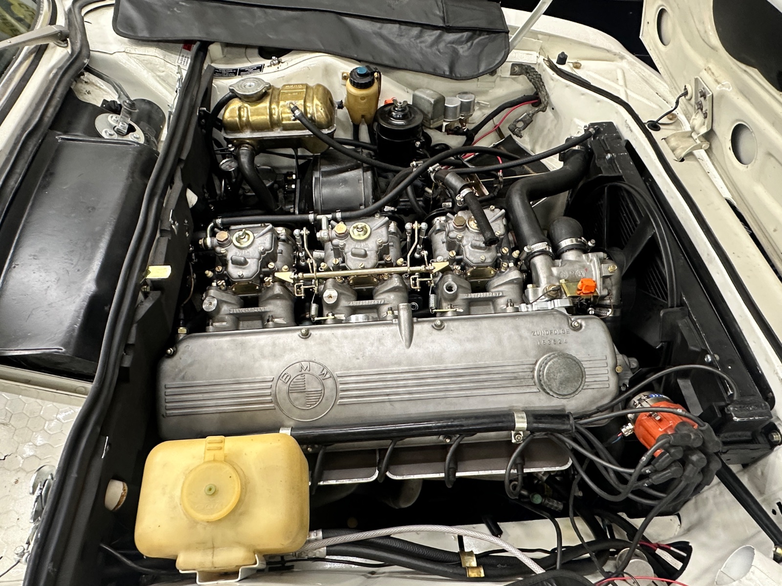

Installing the head went well enough, but the goal was to keep the electric heater shut off valve and, wow what a task. It was a challenge to plumb with dual Webers, triple Webers does not make the job any easier. It is a lot of hoses crammed under the carburetors.
It seems that I am always missing just a few bits to finish off the job. I am waiting for another carb fuel inlet (broke the last one trying to heat and bend) and new brake booster vacuum hose. Once I have those I think it will be ready for the fire-up and starting the tuning process.

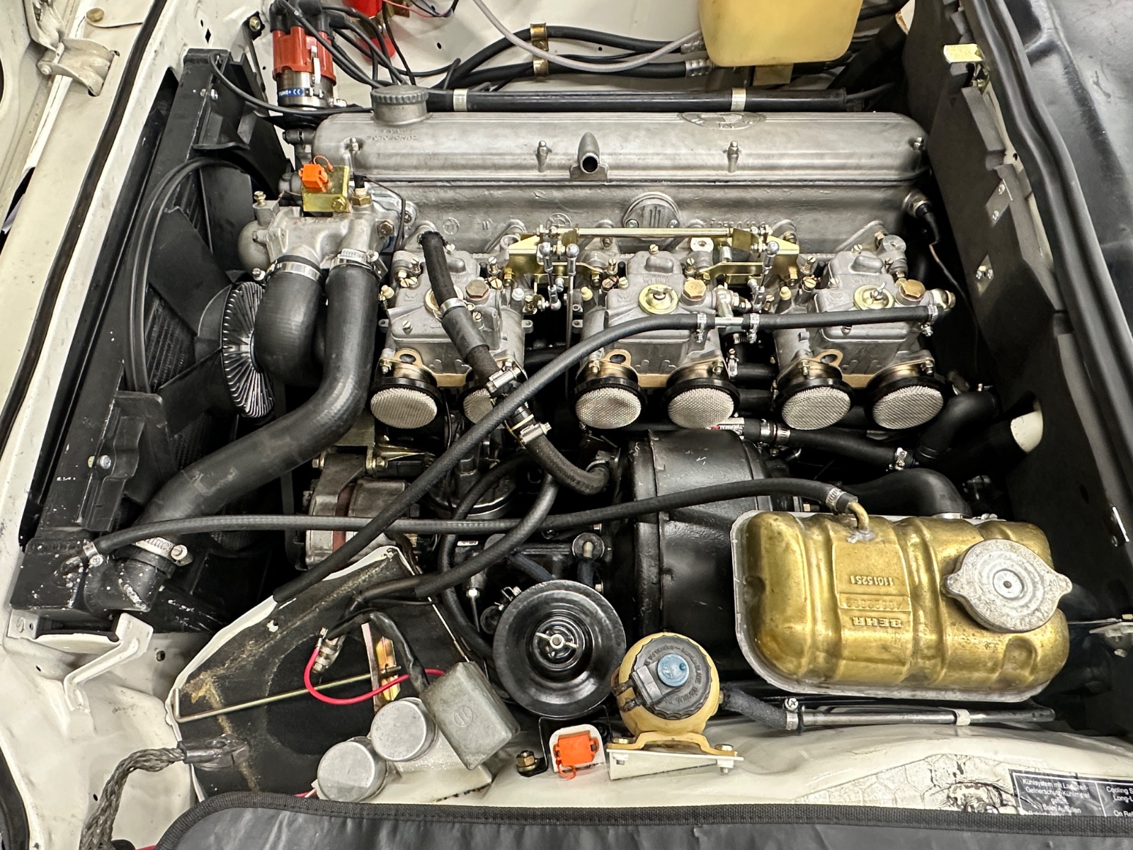

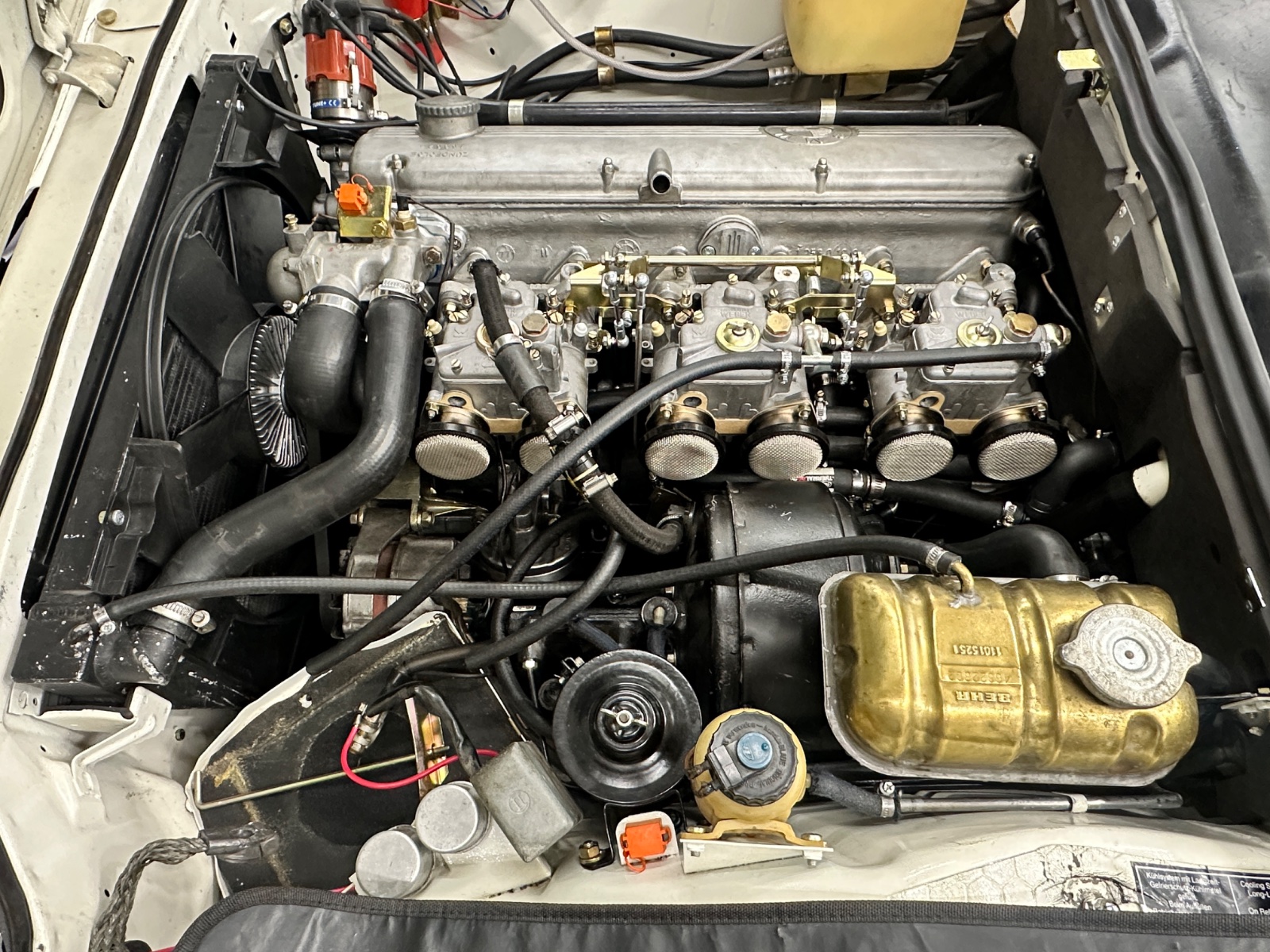

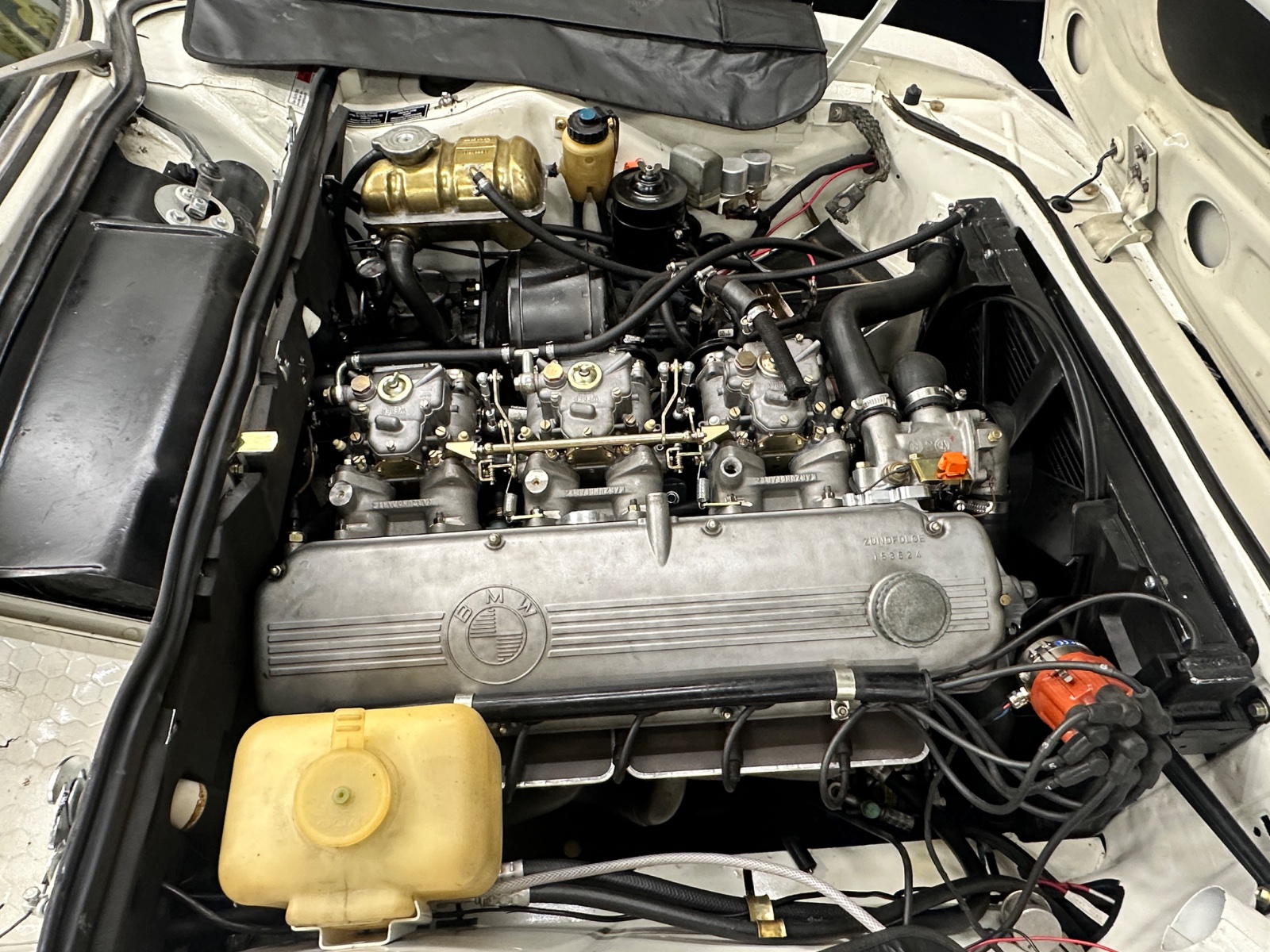

Finally got the last fuel part that I needed to fire up the engine after the recent work. It has been more challenging than the full rebuild. The ignition timing was off enough that it did not want to start, but got that adjusted, barely. It is running but popping back through the carburetors and is overheating quickly.
I filled the cooling system using the vacuum system that I used on my modern Audi, so expected that it would have a quick cycle to get any remaining air out of the system. The thermostat was not renewed, and has been drilled to help with the purging process. As I am having challenges despite this, I suspected timing, valve clearance and lean carburetors.

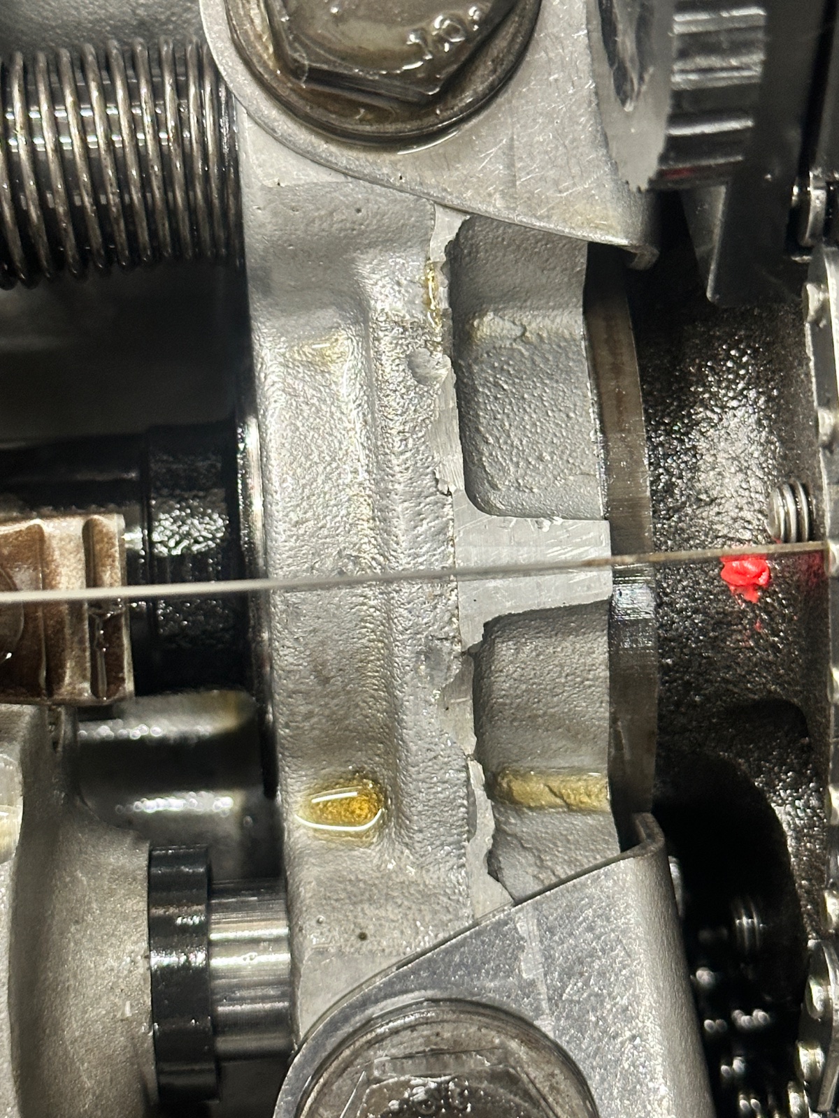

I brought the engine to TDC by lining up the timing mark on the flywheel and I believe that the camshaft may be slightly advanced…
I had to turn the engine over (by hand) while it was dis-assembled in order to inspect the cylinder for damage (thankfully there was none). I thought I had it lined up for assembly, but had to so a little tugging on the chain to get the camshaft bolts lined up.
I believe that the camshaft bolts need to be at 12,3,6,9 and the 12:00 looks like it might be slightly out of line. Thoughts?

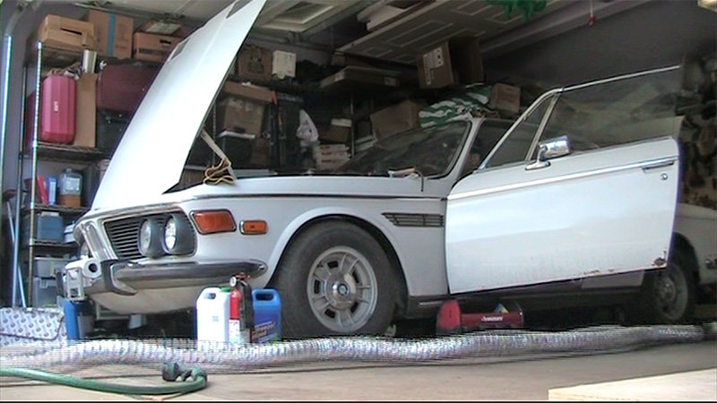

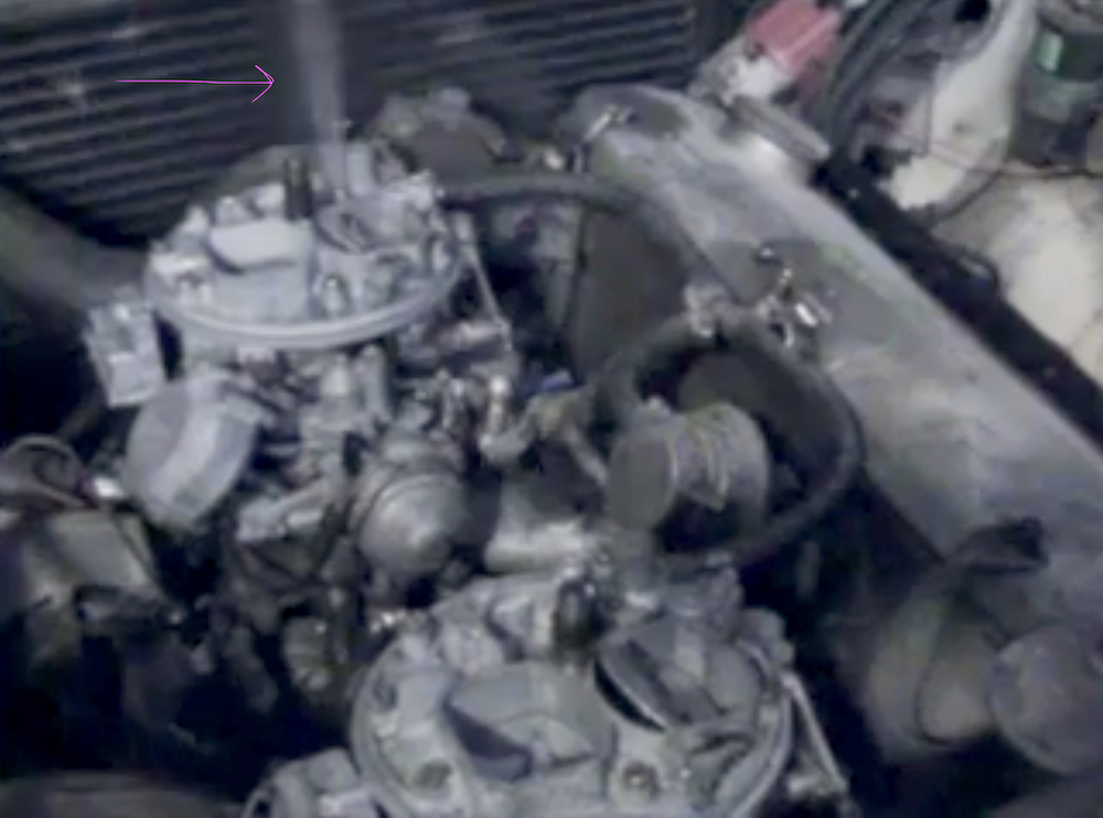

When I got my 2800cs, it was hard to start and barely ran. I replaced the points with a Pertronix and got it running but it would backfire through the carbs intermittently. It was impossible to time, the spark timing was very erratic, all over the place, thus the backfires both from the carb and tailpipe. Clearly the distributor was in need of repair, I sidestepped that issue and bought a refurbished one. Unfortunately I can't stay that cured all my issues as since then I've moved between states several times and the car restoration has been stalled. Soon though...
Lance, what curve are you running on the 123 diist? The triples like a little more advance.
