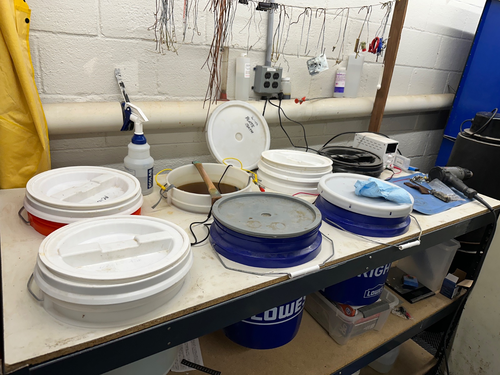

The table is set up with the following:
Buckets on the front row: cleaning agent (to be heated), then two rinse buckets. The rinse buckets were to be separated, one for the post zinc plating bath and then for post chromating bath.
I no longer use the bath, just a spray bottle to rinse the parts off as I take them out. I do pull the anodes when not plating and keep them in one of the front buckets.
If I ever re-make the top I will likely eliminate those front buckets altogether. I really don't use the cleaning agent bucket much either as I have an ultrasonic cleaner and a bead blast cabinet that do the work more effectively.
Buckets on the back row: Muratic acid bath, zinc plating bath, yellow chromate, blue/clear chromate
On the very back is the power supply for the zinc plating process.

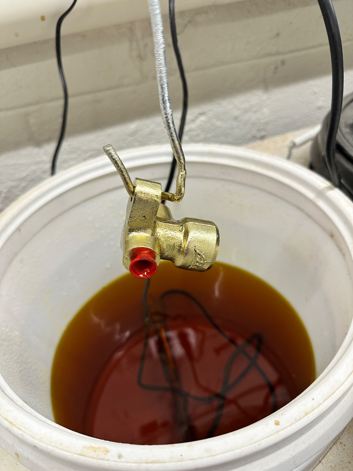

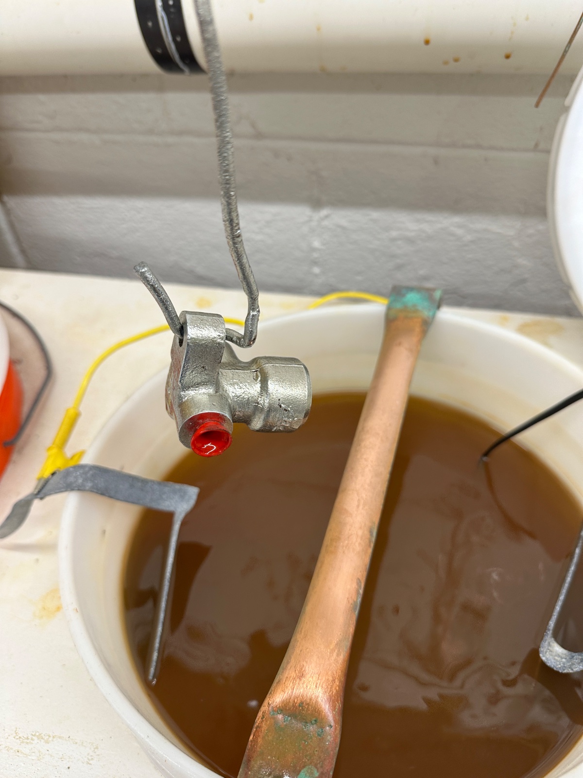

So, I have seen some zinc chromate parts that are matte finish, and some that are very shiny. Ids that a result of starting with a polished part and then plating it? Even your cast parts up in post 75 and 77 look pretty shiny...
I add a brightener to the zinc bath. The zinc comes out very bright and the chromate is then bright as well. It dulls over time as a result of the oxidation process.
