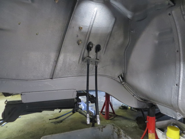

Getting close to engine install. I have spent most of the last month cleaning undercarriage, subframe, frame rails, suspension pieces. There was black undercoating on frame rails and wheel wells. I cleaned wheel wells and resprayed Polaris. Scraped it off the frame rails and removed all of the brown cosmoline type coating from subframe and then painted subframe, suspension and frame rails.

Notice the difference in original and new motor mounts! Also, used e12 strut bearings, much cheaper. I cleaned the original shock boot and reused it as well. Springs still had markings on them for stiffness.

Here is the motor mount. Yes, paint shop mixed up Polaris rattle cans. We are adding a 17mm front sway bar, 2800s only came with a rear bar. Stock springs, Bilsteins, e12 rear springs and Bilsteins to replace the Nivomat self-leveling rear shocks.
