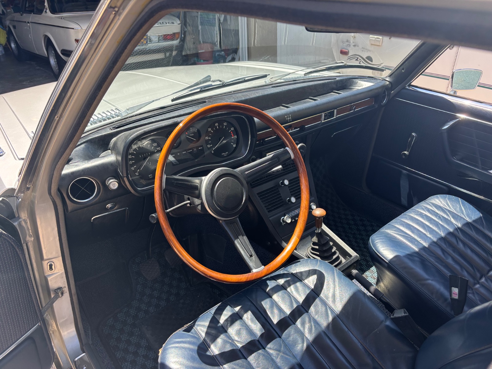

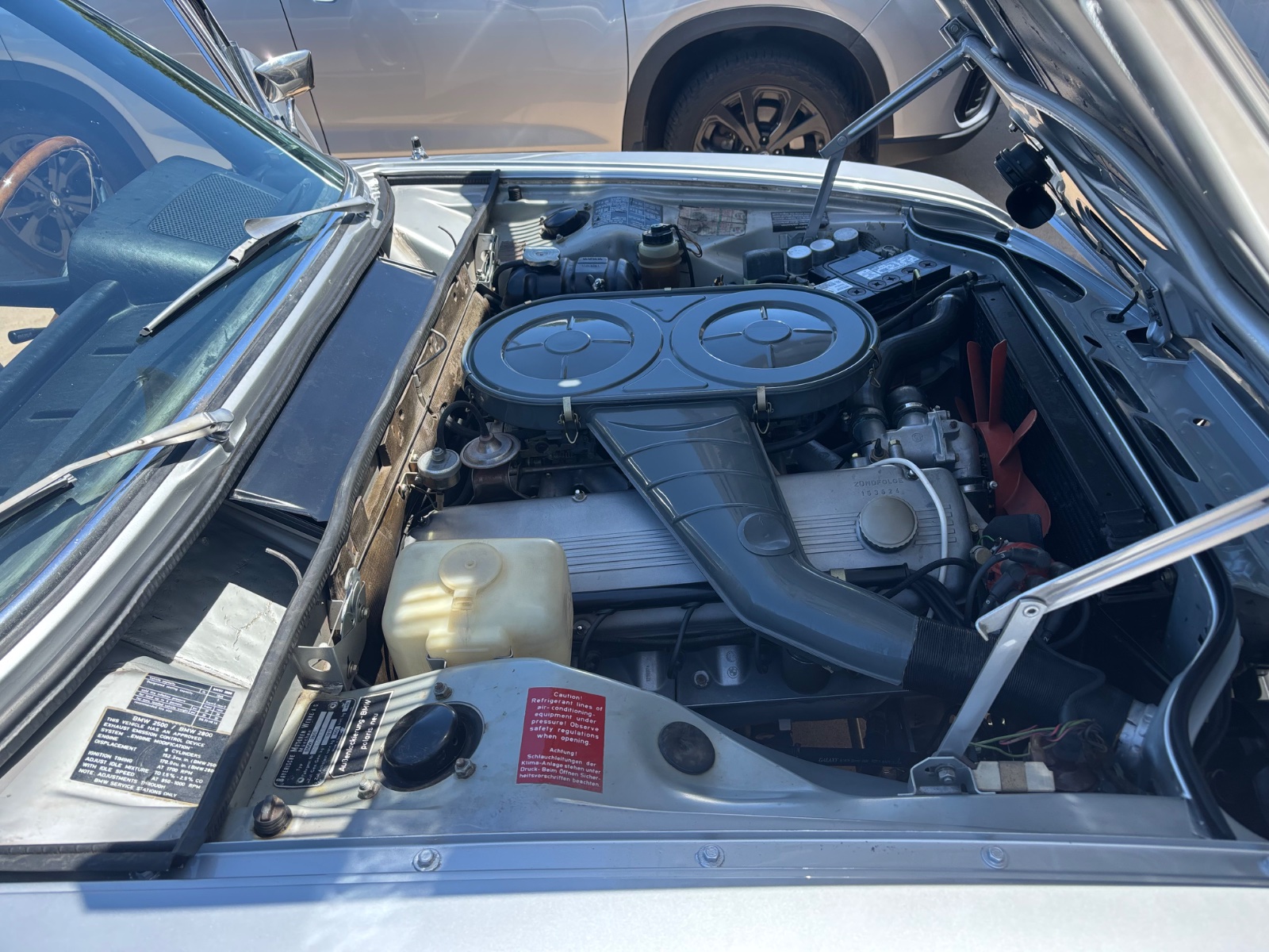

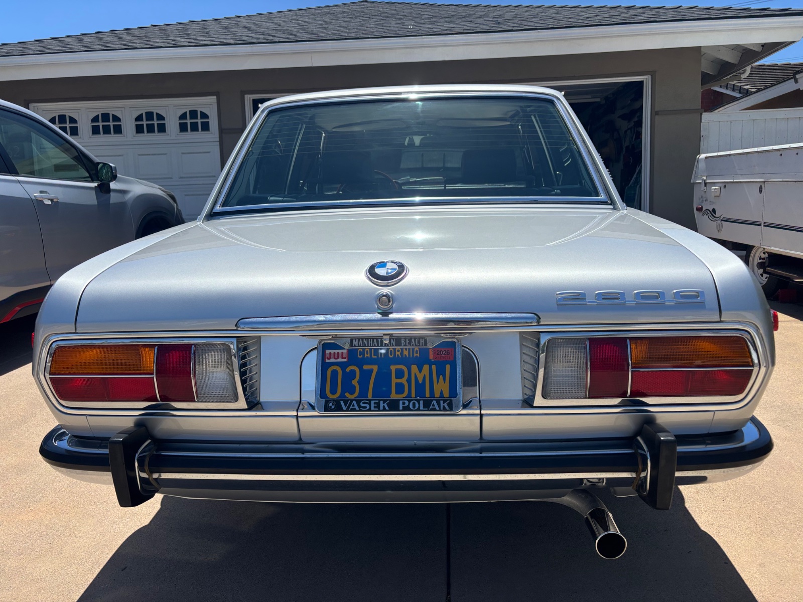

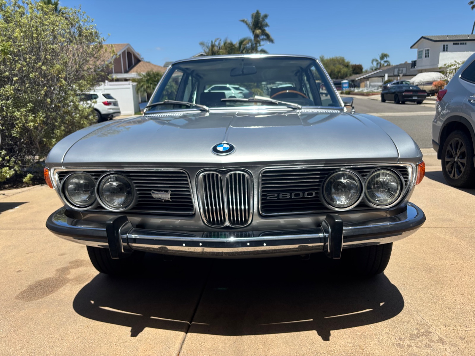

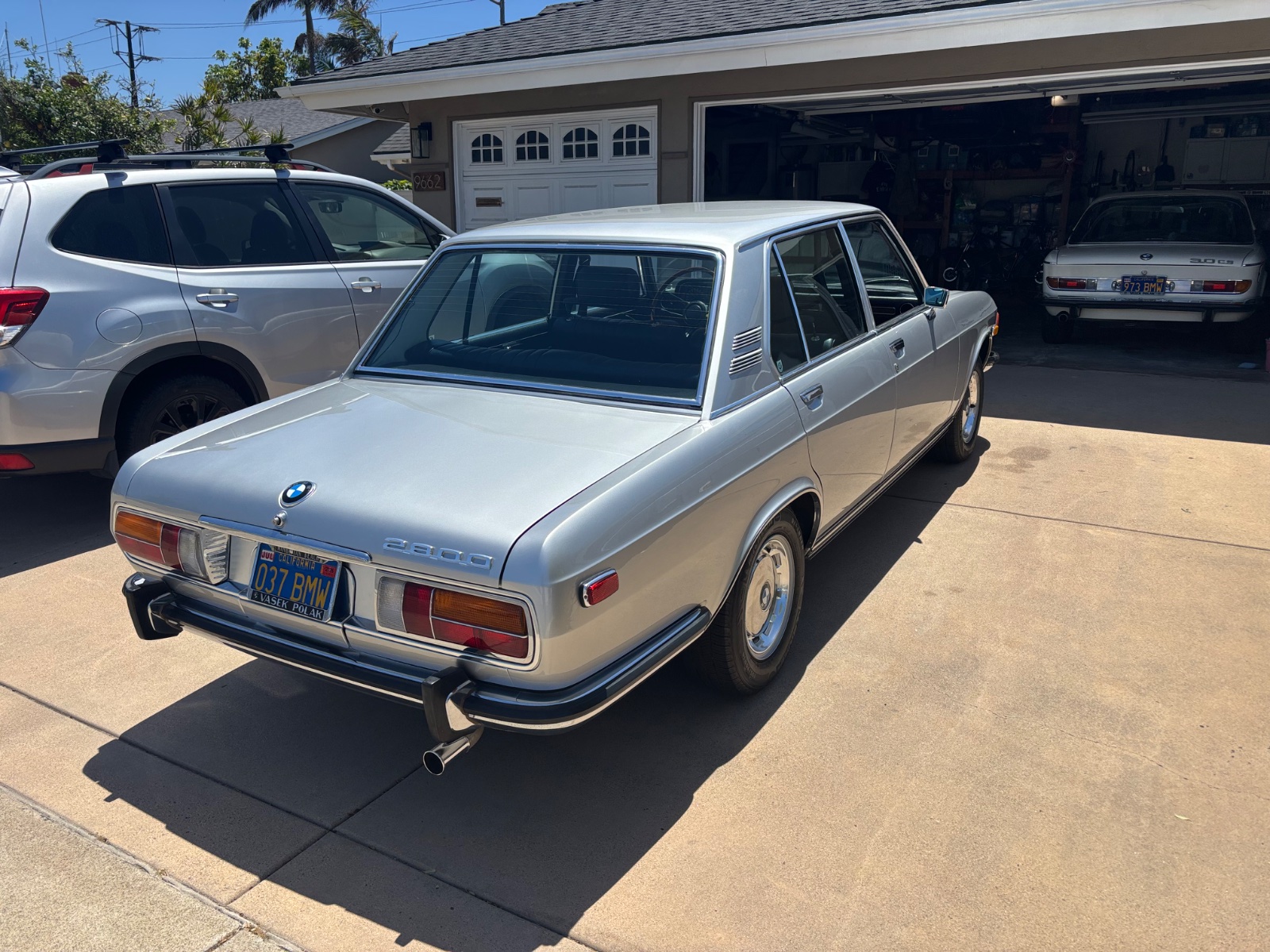

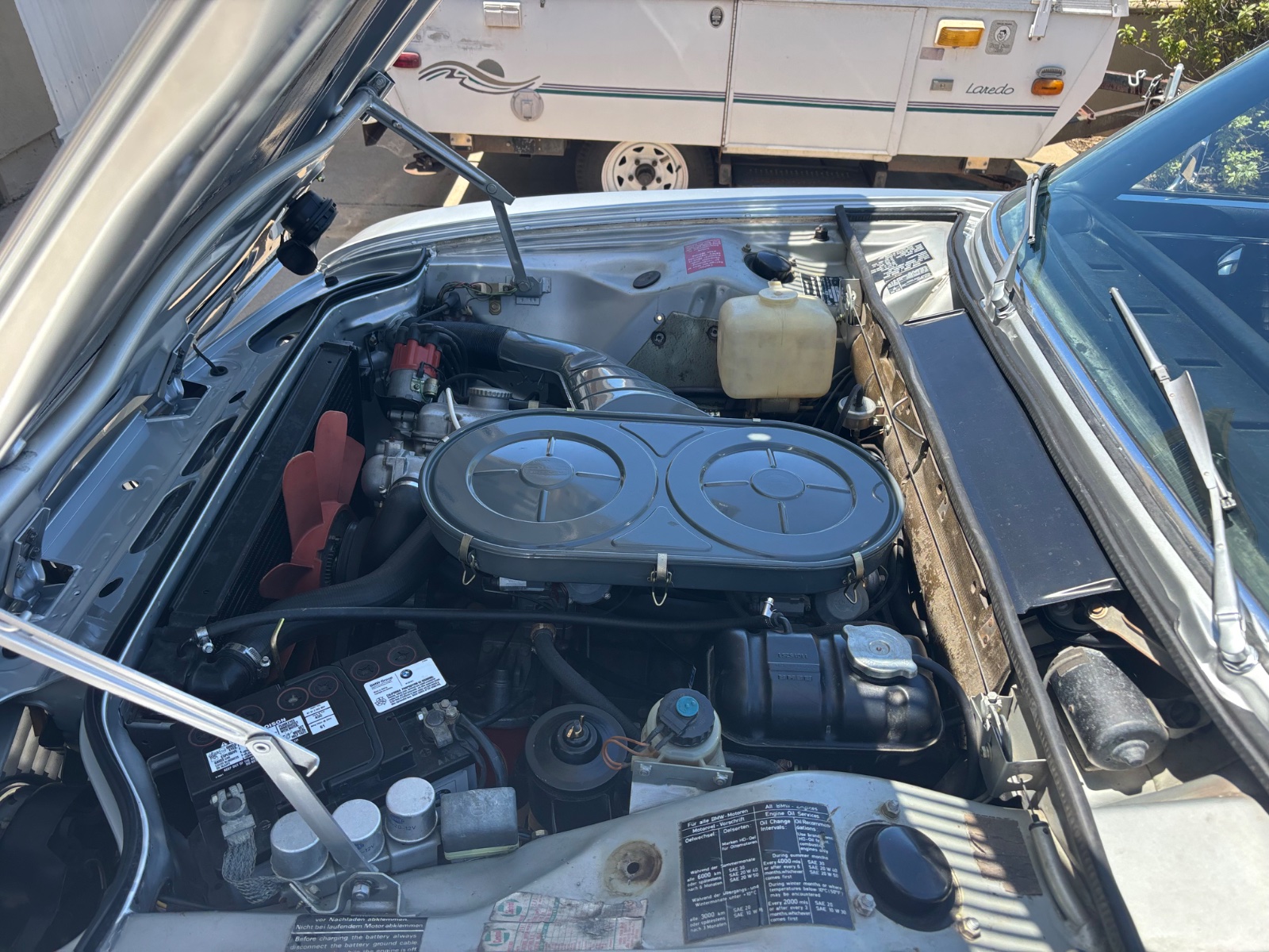

Just an update on our 2800 project. I've been driving it for a while and I can't believe how silky smooth the engine is, I think it is the bore/stroke combination that BMW got right when they introduced the M30. And the ZF 4 speed is equally amazing. I just adjusted the Zeniths with Steve's adapters and found one linkage wasn't quite as tight and caused a slight lag. While in there I adjusted the valves (1500 miles on motor now) and only three or four were a bit loose. I also replaced the original exhaust and it sounds so much mellower but still sporty. I will be driving it to Monterey with my son this year.
