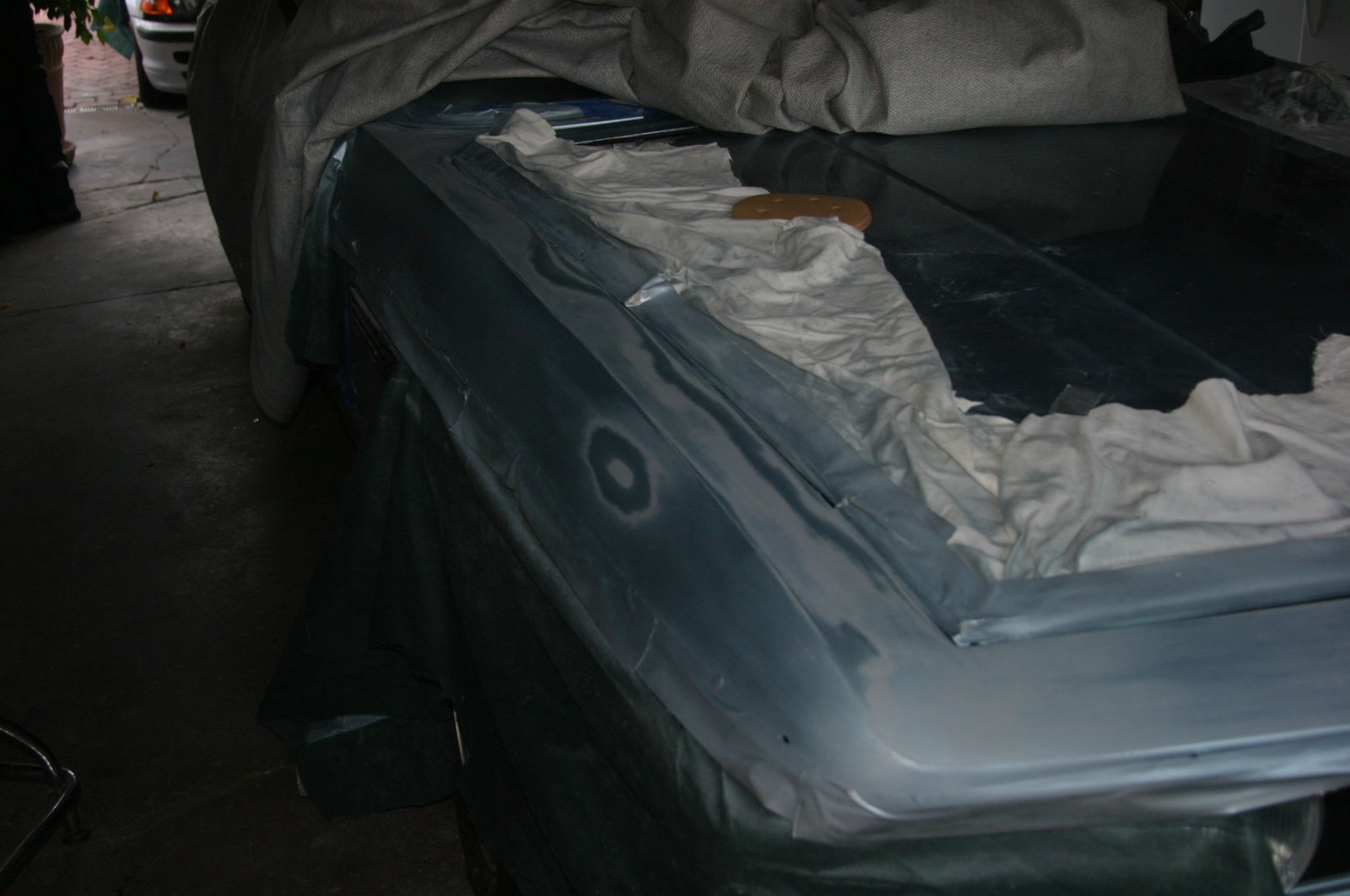

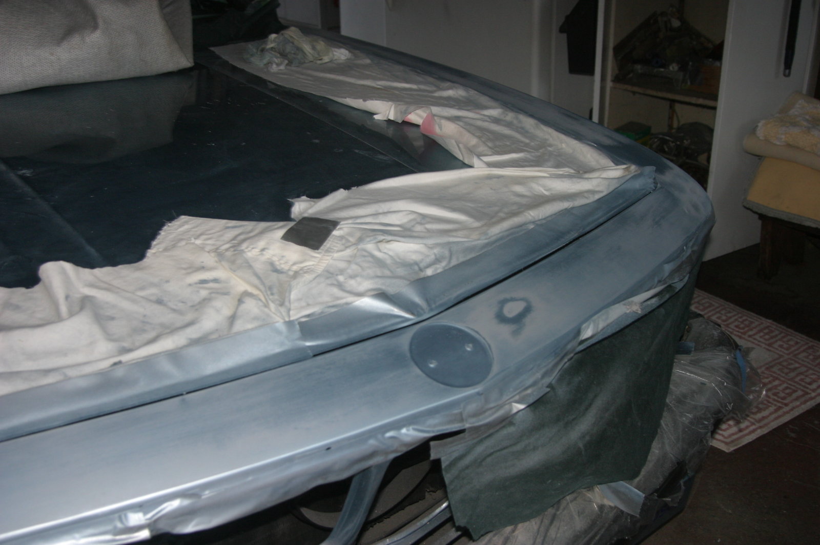

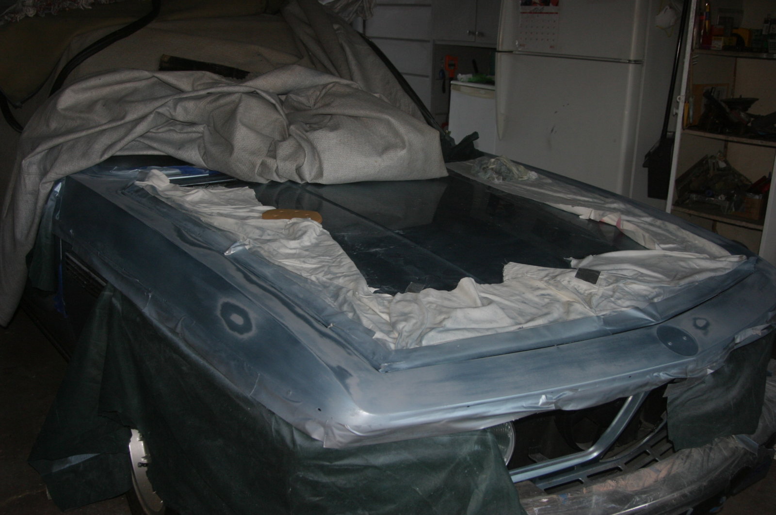

getting a few things done while i wait for the engine shop
had a few scratches on the fender tops from doing work
have fender covers yet still scratched some how
so im resanding and repainting the fender tops to the trim line.

SO LOOKS LIKE ILL TACKLE THE THE FRONT PAINT TOMORROW
ITS SO HARD TO TELL WHAT THE MATCH IS GOING TO BE.
I GOT THE PAINT THIS TIME FROM AUTOMOTIVETOUCHUP
IVE USED A LOT OF TIMES
UNLESS I GO DOWN TO NEDS IN CONCORD WHERE THE MASTERS
REALLY KNOW HOW TO DIAL IN A PERFECT MATCH
ITS REALLY A CRAP SHOOT.

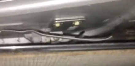

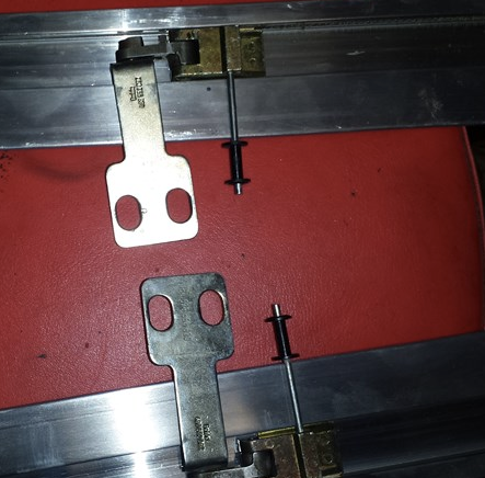

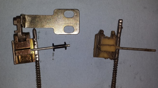

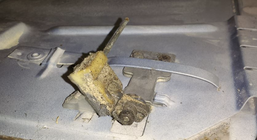

@aearch you may want to read the thread at https://e9coupe.com/forum/threads/sunroof-howto-wanted.18413/#post-316313 for insight into the sunroof issue. In retrospect, my analysis of how the little ramps work was a bit wrong but they are still part of the system. The ends of the cable where they attach to the sunroof are hinged and when the roof reaches the end of its travel in the closed position the force of the motor on the cables causes the hinged ends to pivot, riding on the curved metal strip ramps, thus lifting the roof panel. This works in conjunction with the curved metal strip on the panel and the "pin" with the little roller guides that sticks out of the side of the cable end and rides on that strip. @Markos has a video there that shows how it all works. Compare that to yours and you'll see what's missing.
FYI, I'm not certain that the original cables had these roller guides (mine didn't and it doesn't look like Markos did either) so I don't think they are critical -- the pin alone will ride up the curved metal strips just fine.
You can see how they pivot here:
