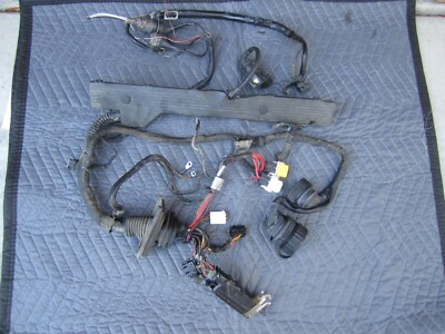

Use a e32 harness out of a 735i.

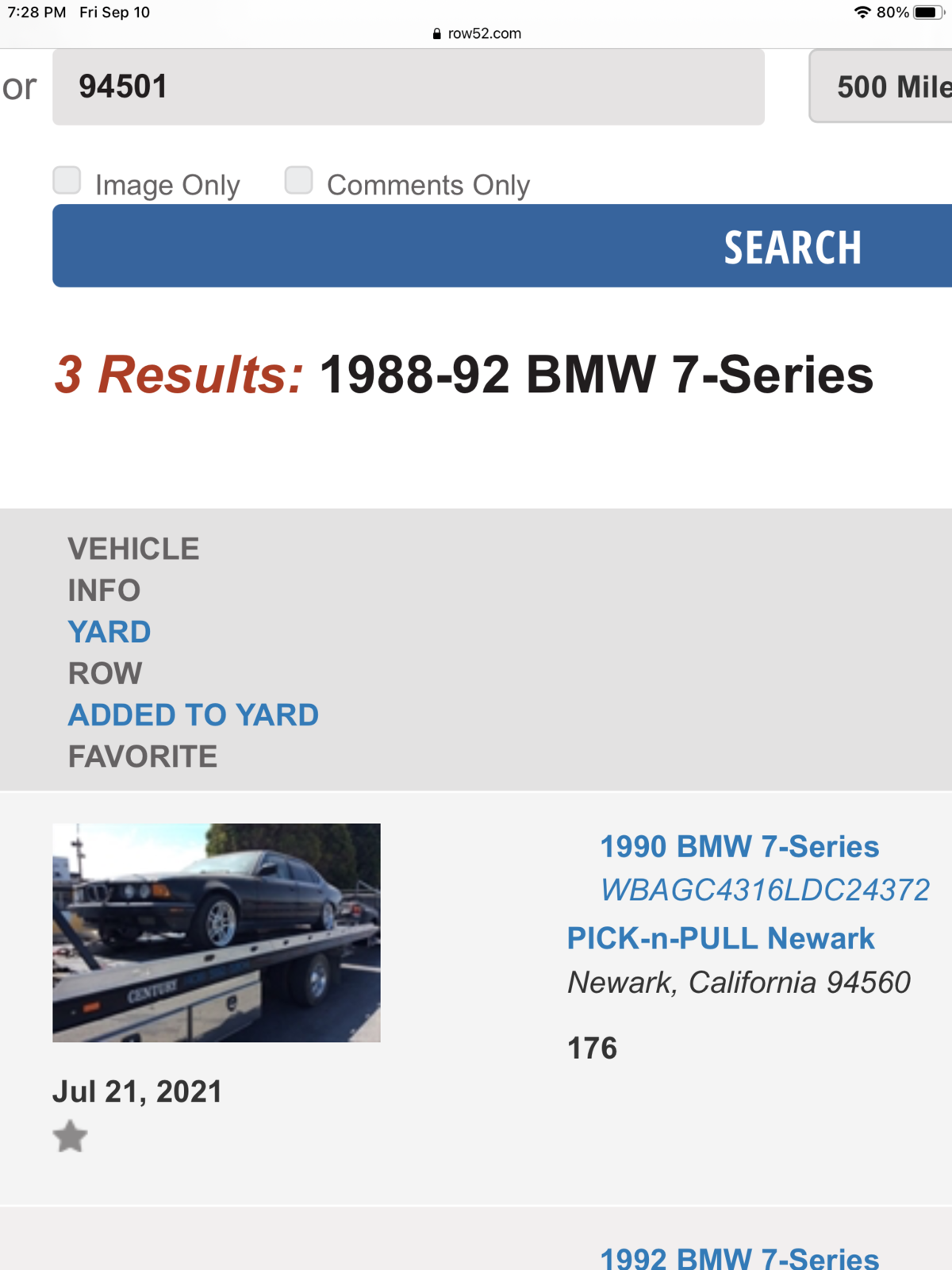

follow the row 52 search. When a fresh 735i gets dropped- go grab the harness.
Or pay a picker to get it for you.
don’t go to the one in Newark - I already got it.
so ill get the 7 one -

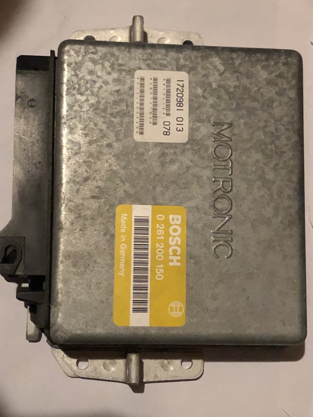

Here’s the ECU I have.
Bosch 0 261 200 150
And wire harness and other parts
Nope
150 ecu is one year only Motronic 1.1
Edit- 1 1/2 year.
735i/iL E32 M30/B35 86-88 0 261 200 150 Bosch Motronic M1.1

179 Motronic will fit instead of the older M1.1 150, and vice versa. But the chips are not interchangeable, that means a 150 chip will not work in a M1.3 179 Motronic and a 178/9 chip will not work in the older M1.1 150 Motronic. Tested and failed, someone from Europe bought from me a 179 chip and installed it in a 150 Motronic (as he did not know the differences). Nothing damaged, but the car did not start .I know that from the E32 especially in Europe where the older E32 were still equipped with the 1.1 150. I have tuning chips for the 150 and the 179 and most owners of E32 with M30 buy them especially from the German 7-forum , but some of them buy my 179 chip and buy a used 179 Motronic and install it instead of the old 150. In Europe the E32 was sold from autumn 1986 with the older 150 Motronic and later that changed to 179 1.3
The main differences between 1.1 and 1.3 I posted here http://www.bimmerforums.com/forum/sh...ic-1-1-1-3-BMW
s, Bosch p/n etc​
Courtesy of a tech article of pelican parts http://www.pelicanparts.com/BMW/tech...DME-Repair.htm
In case of E32 we have there (based on U.S. specs/years):
735i/iL E32 M30/B35 (211hp) 89-92 0 261 200 179 Bosch Motronic M1.3
740i/iL E32 M60/B40 9/92-4/94 0 261 200 404 Bosch Motronic M3.3
