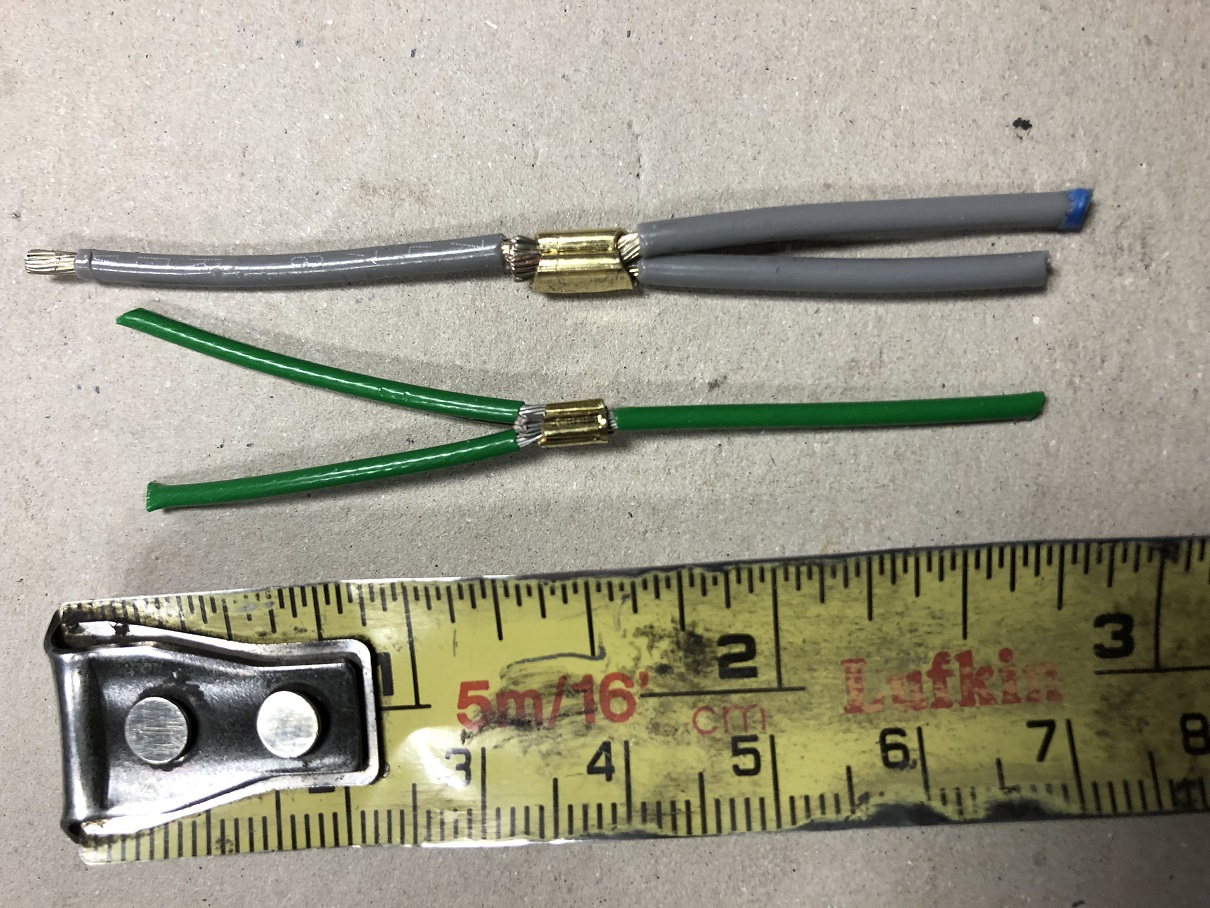

A couple of practice crimps, with scale, in case this helps.

Another pro-tip for @aearch. If you stagger your wire cuts you won’t end up with a giant lump when you tape the harness back up.

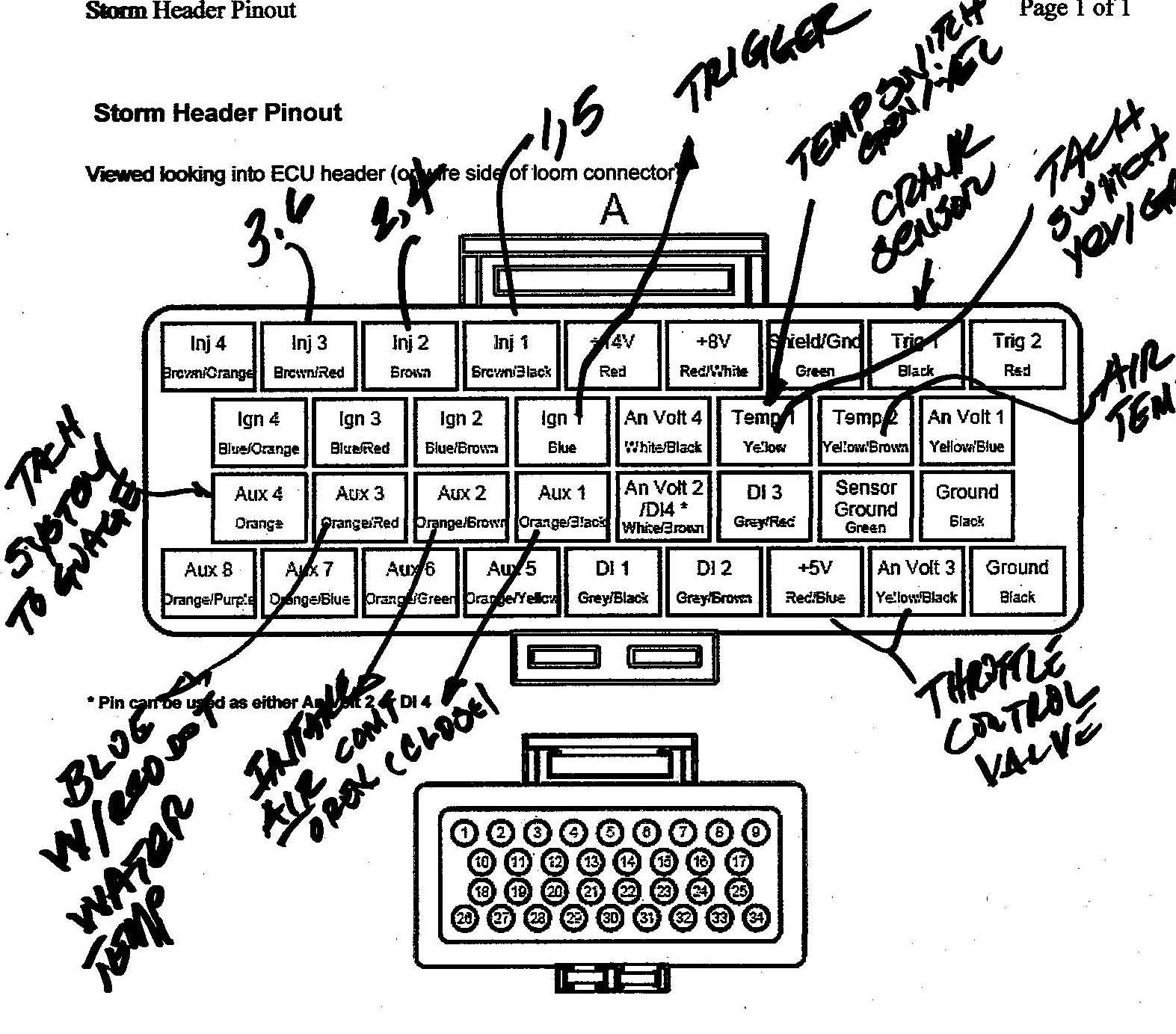

I GOT IT
IVE BEEN TAKING A 2ND 4TH LOOK AT THE INSTALATION AND WIRING MANUAL
IT REALLY A NO BRAINER FOR ABOUT 85%
THE 15% ILL FAKE AND BLOW UP THE ENGINE
HIT THE FRIGGIN TOWN RUYNNING
