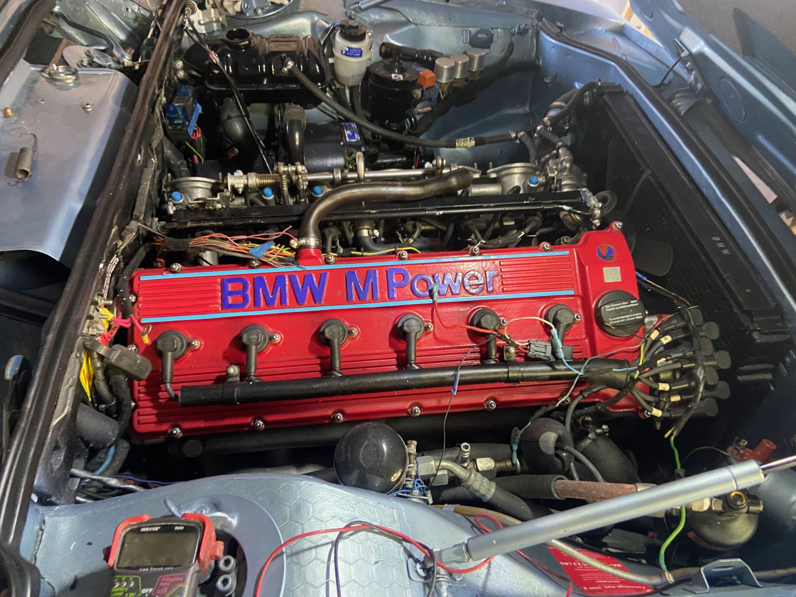

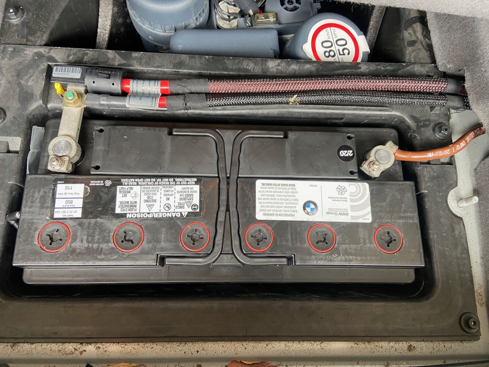

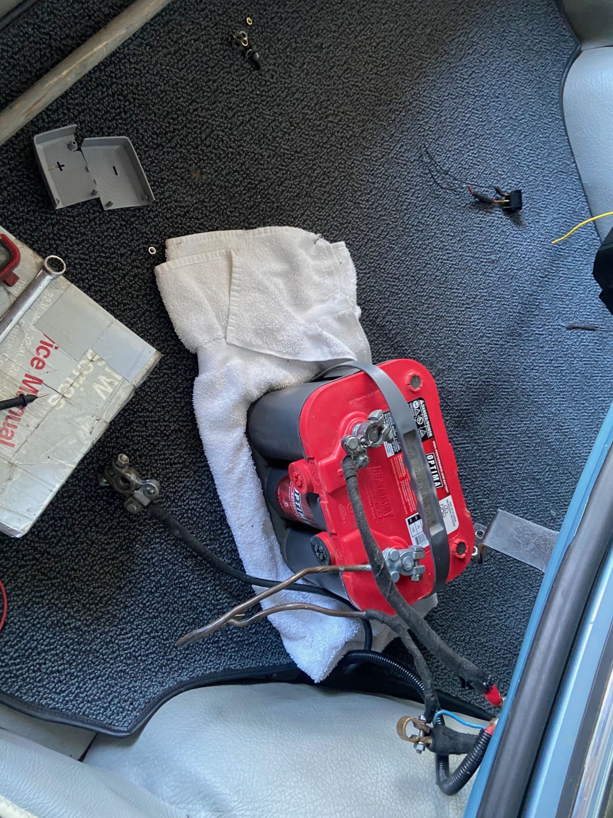

Starter saga: Followed the +12 from the trunk battery to a post in the firewall, to the starter +12V. Checked both voltage and continuity, it is there but the reading was not consistent and sometimes it wasn't. I think either the +12 or the ground are not solid. Even if they are I compare the thickness of my E39 M5 battery lines from the trunk and they are much more beefy (see third picture). Yes, it is a V8, but still. We did not have jumper cables to take the battery directly to the alternator.
The solenoid wire never gets +12V, and that is why the car never cranks with the ignition key. Alan followed the wire and it turns that it goes to a relay and not directly to the ignition key. Was a relay ever used? The wiring diagram has no such relay. It is a 74, maybe then? Help.
Alan plans to bypass the relay, so that will fix that.
Alan shorted the +12V at the starter to the solenoid post, then it briefly cranks but runs out of juice. I measured the voltage at the battery when he did that and it drops from 12.6V to 11V, so the battery needs to be recharged for sure. I never got to measure the voltage drop during the crank due to the wiring, but I suspect that may be a factor later on.
Alan reports being able to rotate the engine manually with a wrench applied to the alternator. That to me settles the issue of compression, a starter has more torque than most humans using a wrench, so I do not worry.
The suggested plan would be:
-charge the battery
-move the battery near the front and jumper cable both 12V and ground to the starter and engine block to see it it cranks non-stop while shorting the solenoid post to 12V.
-If that works, bypass the relay, move the 12V to just the starter but not the solenoid, see if it cranks using the ignition key.
-Move the battery to the trunk, see if it cranks non-stop, if it does not, rework the wiring for 12V and ground.

Highly recommend getting super flexible multi strand welding wire from any welding supply shop. You can get the lugs at napa or online.
Home run all 3 connections at starter to spare battery.

Seems like you'd want to get any low voltage issues handled before dealing with the computer anyway.
Yes!!! Alan had the laptop connected to the ECU and talking to it. That is great, but I have enough laptops and IT in my life, so I did not even look at it.
Another crappy GUI to learn probably based on Windows 95, yikes. But I am speculating. Let's get the low voltage high current stuff working.
I would run run a wire from battery positive to solenoid terminal at 6:00 position, it should crank. There is no relay for the starter. I would also run an extra ground from valve cover to inner fender, i had to do this even though i was sure i had two good grounds as the starter clicked but wouldn’t crank. If car started life as an automatic there is a neutral safety relay under dash closest to firewall which needs to be jumped for key to work.
All the cars did not come with a starter relay BUT I put them in all my cars, takes the load off the ign switch contacts ( as if they aren't getting harder to find ) so finding one in this car should not be construed as bad or that old owner ( damn him ) wiring issue. Good luck and good on you to help out

Agree, I have a relay for my starter for the above reasons and it puts full current to the solenoid while bypassing the ignition switch.
Great point. So did 4310316 start as automatic? I trust your database can answer that faster than I can ask :).
