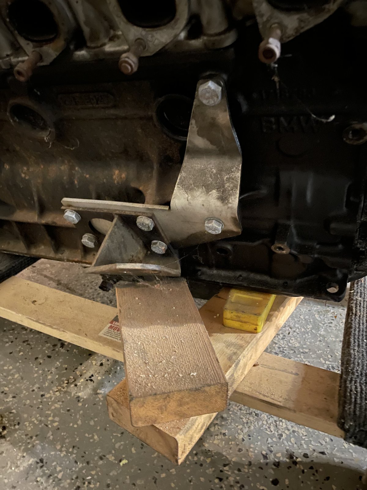

Note that the e32 (735) passenger side motor mount doesn’t work with an e9. If you get the e32, you need to buy adapter bracket like this. The e34 (535) is a direct bolt in. On the plus side however, I think that e32’s were treated better, and likely plagued by electrical gremlins and not motor issues. Their values don’t hold as well as the e34, so you can buy the whole car on the cheap.
I still think you should buy the whole car, drive it for a little bit, then pull the motor. Remember if you aren’t keeping the donor, you can cut the car out from the motor. Just be sure you can dispose of the chassis. I know that is tough in CA.
