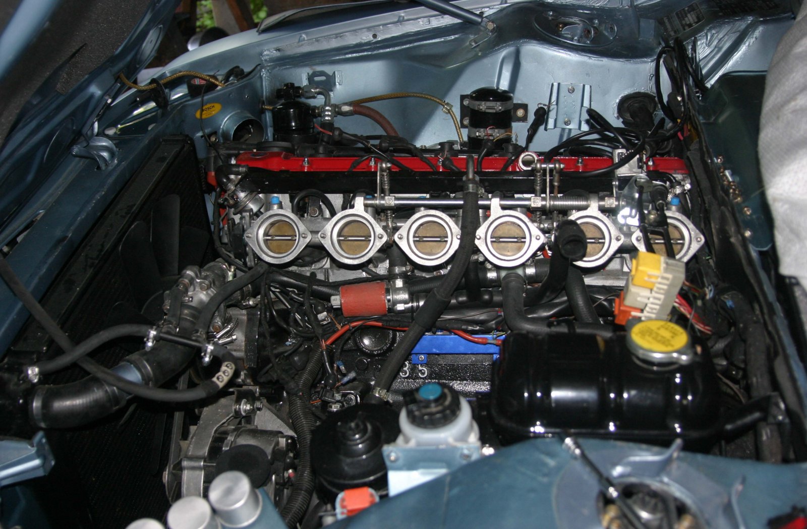

thats great -- pic thats close -but no cigar.STYLE
LUCKED OUT big time
ive found the carb setup -so finalllllly something simple
and
functional !!!!!!!!!​

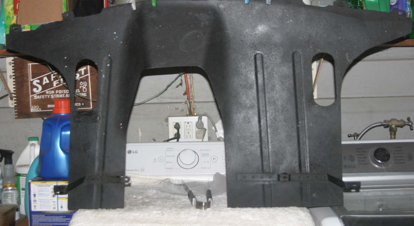

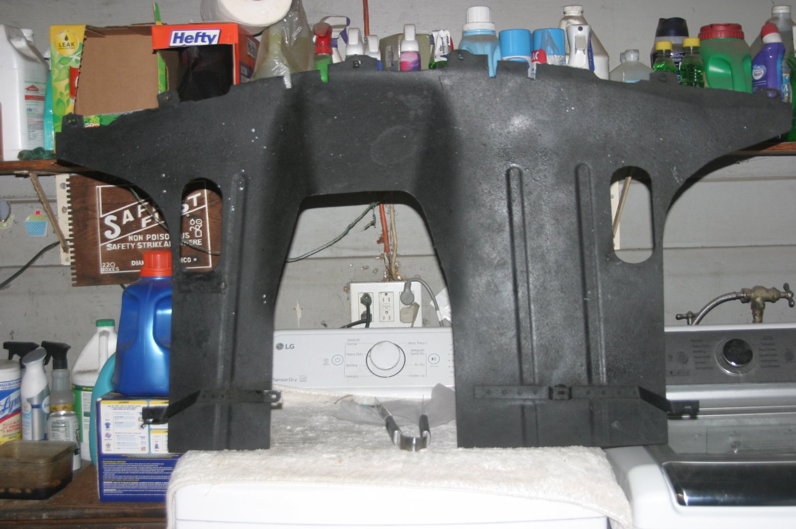

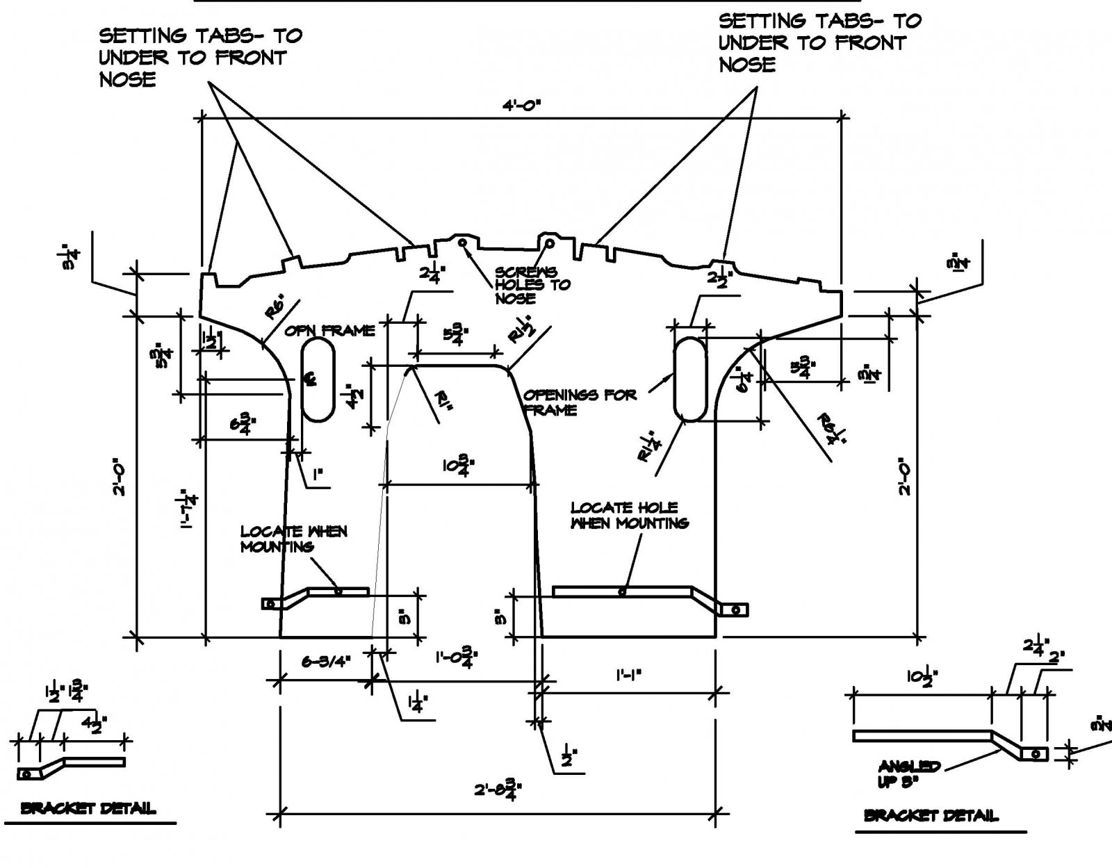

OK FINALLY GOT THIS SQUARED AWAY FOR ALL
FRONT SHEILD
theres a much better version of the merc.
so hopefully ssomeone can use the shield drawing
the darn thing cost me way near 40o bucks
ok onward
FRONT SHEILD

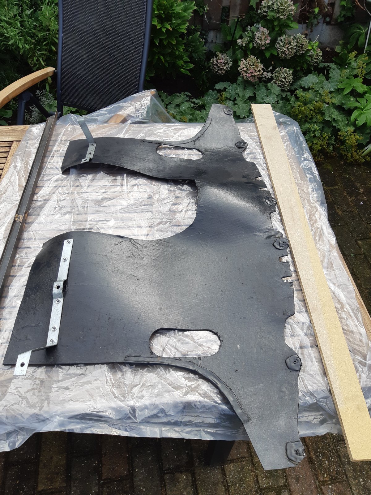

Mind you that you have drawn the replacement part as made by BMW a few years ago. The original (made of a hopeless fibre board) one has a tad different shape. Here's a NOS one; notice it doesn't have the strengthening ribs & the metal brackets are a bit different.
Nevertheless; If i'd repro the part, I'd be happy to follow your drawing as that is the better functional design.
One aspect that would make your drawing even more complete is a side view; as the part has a shallow front to back curve in it and in the middle it has a recess for the oil pan that stick out.
My NOS part is (looks) a bit sagged, so I wouldn't want to take measurements from it.

ill edit the file for the bottom sheil to locat the mounting holes and top
edge as it rather critical to mount correctly
and have the oem fitting.
