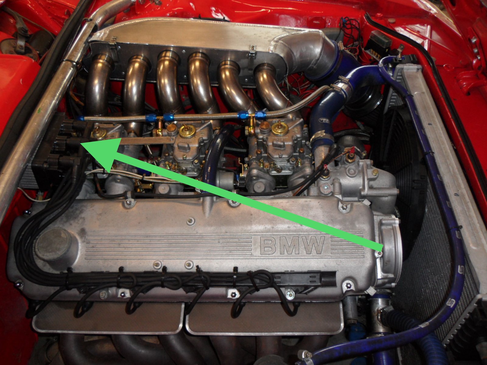

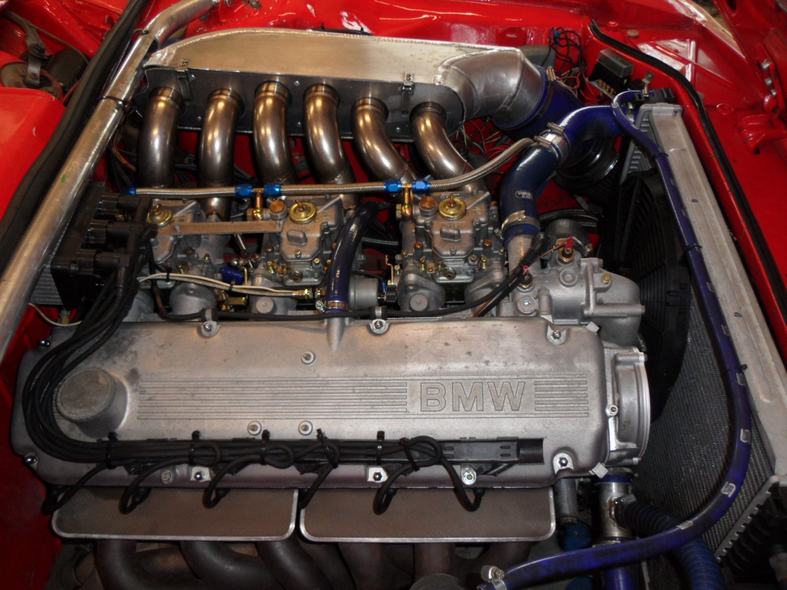

meanwhile 7 years "abuse" without any problem.... no wires, no pins, no connections ... no software, just hardware :cool:
Not entirely true. You are running wasted spark or sequential ignition (probably wasted spark). As you mentioned before, you have a motronic 60-2 toothed wheel and a crank position sensor. Some computer (likely in the glovebox) is driving your ignition. Said computer uses software to operate, and different software to tune. On top of that you are running an electric fuel pump.
I know you are running triples but isn’t a walk in the park to setup this type of ignition system. As you mentioned, you had a professional rally garage perform the work.
Busted... :D
yes, this is a little KMS ignition ECU which was programmed once by a "rallycars" garage... and never touched again.
We did runs on the dyno advancing timing 1° untill there was no gain .
But i had the top chain cover and distributor ( not yet that special nut ) in case it would give troubles.... it did not.

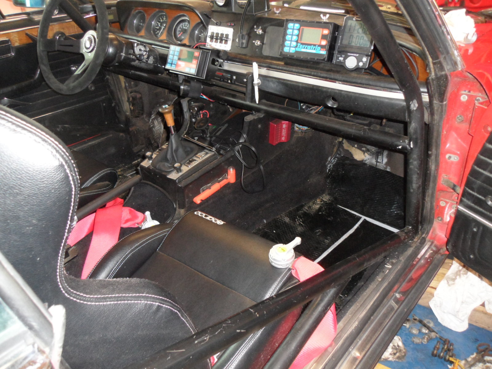

One can see it here mounted on the center console ....
and of course a low pressure electric fuel pump & filter/pressure regulator , but that is simple basic stuff.
