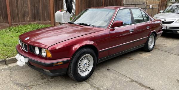

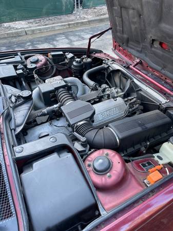

Okay LAST time. Buy a running car. Get it PPI’d. It will cost you 3-4x as much as buying a stand alone motor. The difference is that if the swap doesn’t work, you have nobody to point fingers at but yourself (for better or worse).
The car below has 155K miles on it. That is 5,000 miles a year for 30 years. This motor should have 100k left on it. Car has new tires and plenty of little things you can sell if you don’t want to dump the chassis immediately. Wheel will also fit on your car. You will want to register it properly or you will be stuck with the carcass.
Before negotiation you have a $4,500 working driving vehicle that can tested prior to purchase. Didn’t you sell your s38 for $10K?
FYI Motor is an M30B35. Yes there are cheaper options, but is cheaper the best option for you? I really don’t know.
With all due respect, please stop saying that you don’t know what motor to get, or what car to get it from. The info has been relayed too many times to make that claim, and now you have a visual aid.
This is exactly what my M30B35 came out of for my E3. A simple flat steel adapter (@Mike Goble made it for me) Drop it in, throw some Weber 38/38 carbs on it and go. I should've put that motor in my coupe along with the 5spd gearbox I have sitting in storage. It's quite a bit different than the 2.8L but I'm not ready to tear the coupe apart just yet.
