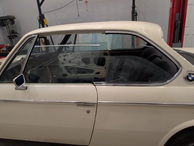

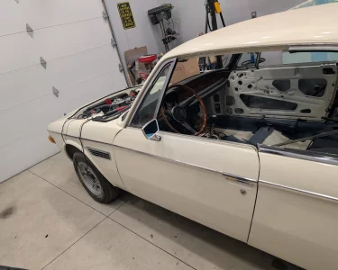

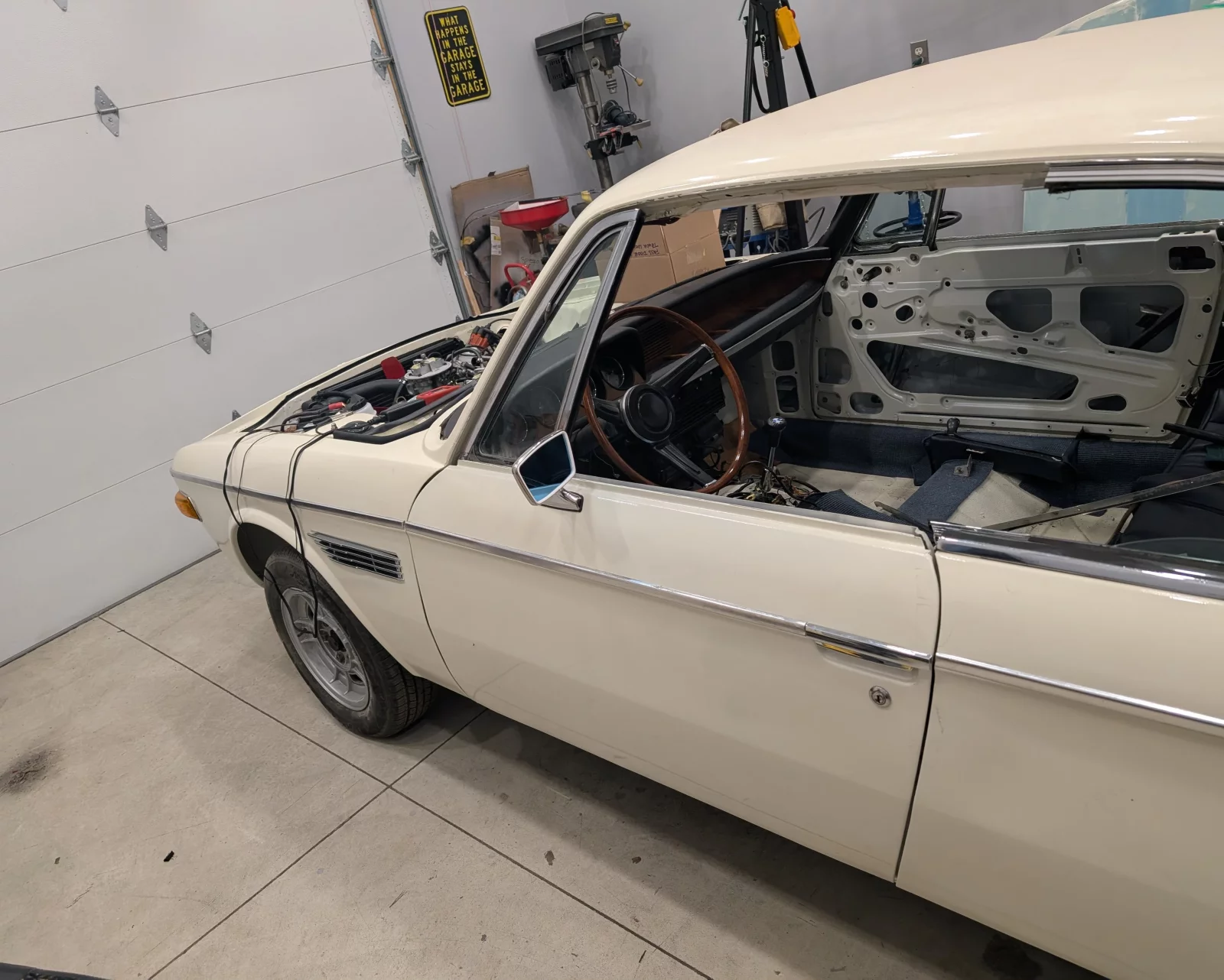

Got the doors back together with internals. And got all the windows working. Still rocking the tuna cans... Hey... They work.. pokey but they work.
Back drivers needs adjusted. I must have accidently messed with the up- stop when I cleaned everything... Needs to go up a bit more. Also have a weird thing with the switch. Armrest switch works fine... Front switch will only go up... Not down.

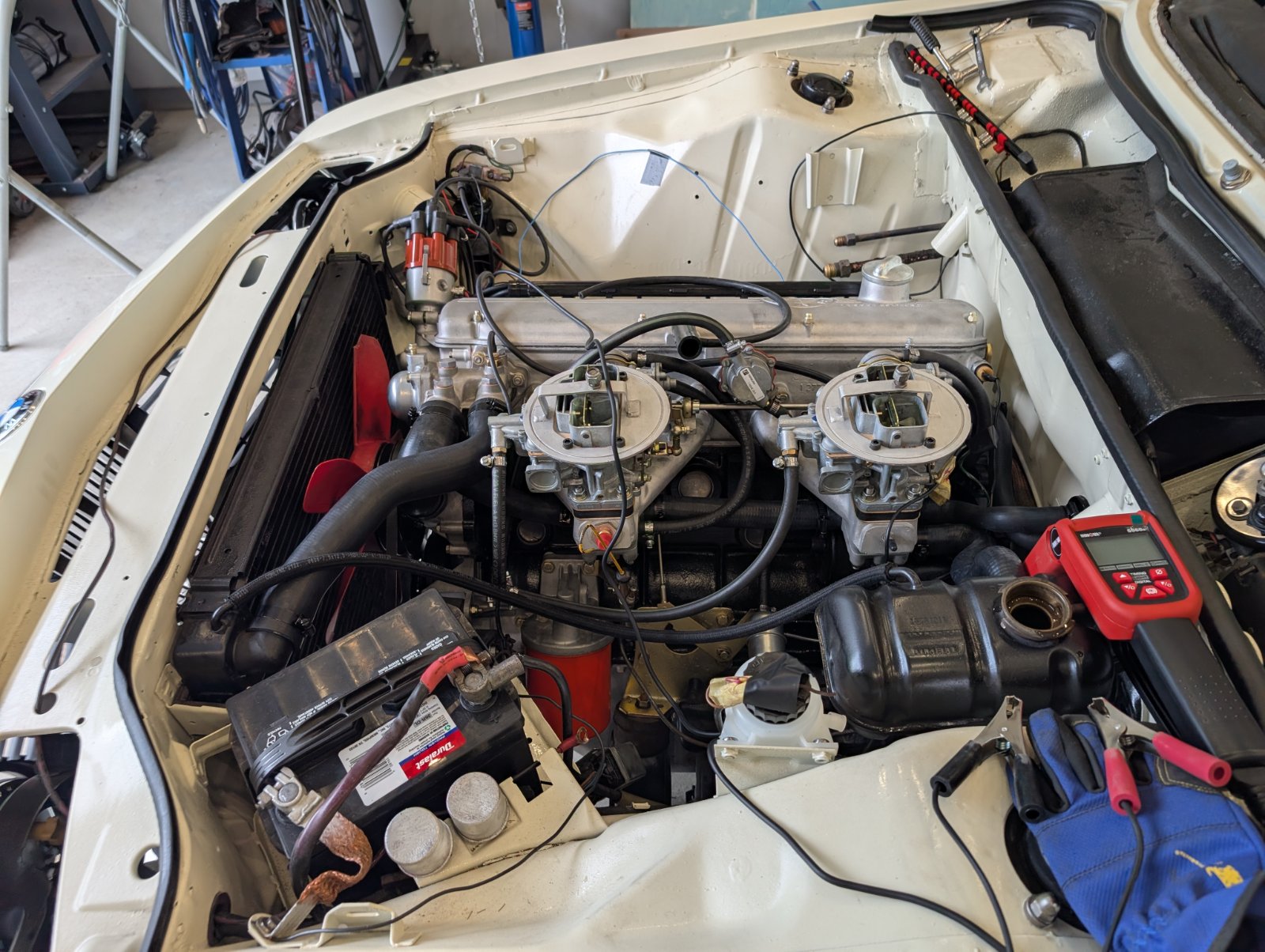

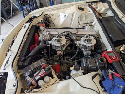

Engine is still a work in progress.... Lots to do in there.

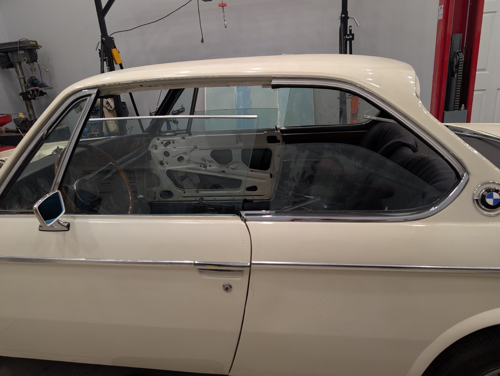

Oh and I got the new outside mirror mounted… big improvement over the POS that was on there.

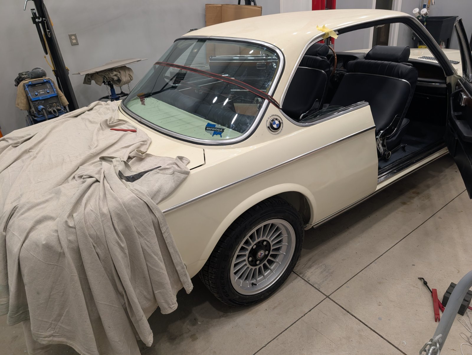

Screw them. So today I decided to tackle it myself. Did the back window first... Big learning curve as I had no idea what I was doing.
Amazingly enough it only took two tries. But thanks to some wise words I read here I got it in. Only one bruise to the seal.
I found the best way was to seat the bottom as well as you can and then work the rope from the top down. When I did it the other way the bottom popped out. The ratchet strap is a must if you are doing this yourself.... Oh edit here... No pictured are the foam blocks on the ratchet strap I used along the process. Another must.
Will attempt the windshield tomorrow. I'm sure it will be worse.

Few cars these days have traditional rubber mounted glass, so most of the technicians only seem to know glued in glass.
I put the front and back glass back in my 635 after I painted it. Pretty easy. I used liquid detergent to lube things a bit. I also don;t use a very heavy line, really a thin nylon cord is all that's needed.

Yes… 1/8 inch cord… and I used WD 40… which is basically slippery water. I’m not a fan otherwise.

I can't stand the smell of WD40 and it's a bit overkill for window installation IMHO. A google search found this result: "Yes, traditional WD-40 Multi-Use Product can damage rubber seals with use over time. Because it is a petroleum-based solvent, it can cause certain types of rubber to soften, swell, crack, or harden, leading to degradation and failure of the seal."
There is a special version that is more rubber safe, WD-40 Specialist Silicone.
There are lubricants specifically designed for rubber. I found one with a quick search on Amazon that sounds pretty good. The 8 oz size is a better buy if you are doing more than one window and I'd rather have too much can not enough.
There are other lubricants that might be more available, I've seen some water based and wax based ones used for pulling wires through conduit that would also probably work quite well. Here's an example of one at Home Depot.
Cheaper than the rubber specific product, but I think the one designed for rubber will be my choice when it's my turn to reinstall my glass.
Smell? Have you tried Kroil? Amazing product, but also unique and lingering smell. Have gotten used to WD40 "fragrance". Kroil...I don't think I ever will. I have drifted toward Dawn dishwater detergent. Slippery and kind to ...well everything it touches.
