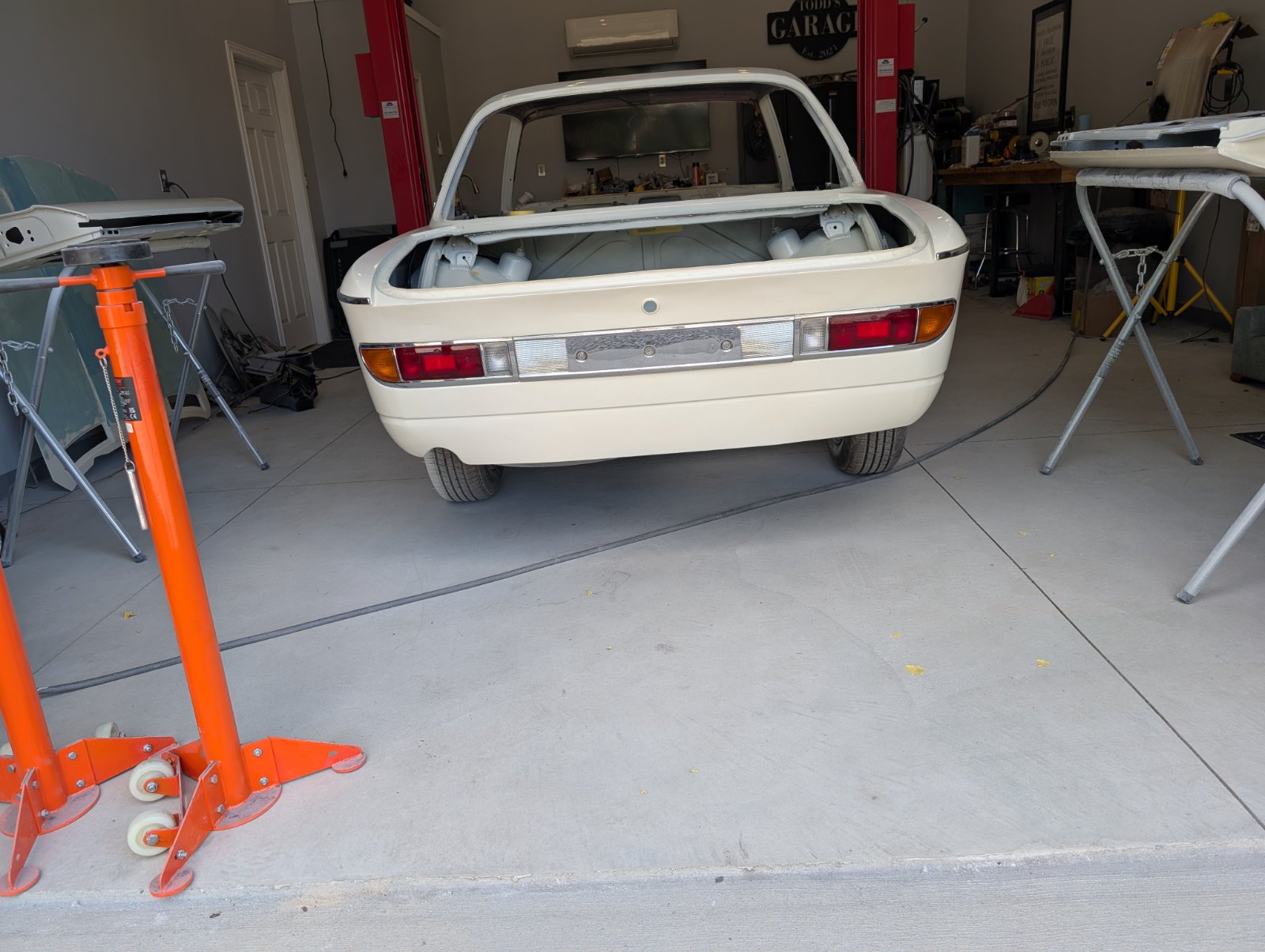

Once again thanks to @TomHom for the tail lights, dash pads and probably something else I’m forgetting. Guess I missed the fact that it’s a 3.0 dash with the extra hole by the right column. Maybe I’ll put an ejector seat button there.

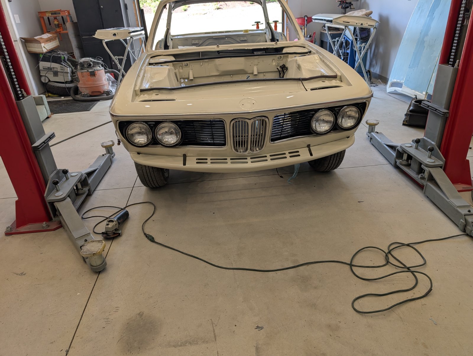

Still have to figure out why my one headlight surround is sitting back so far. It seems bent... Not sure how that is possible.

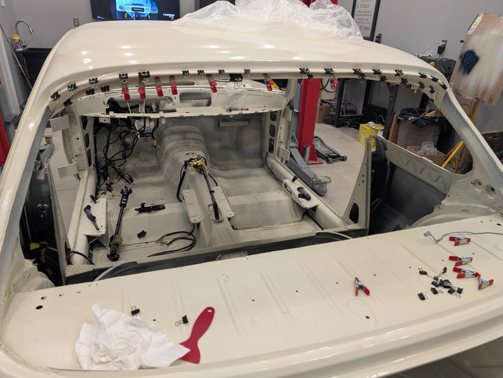

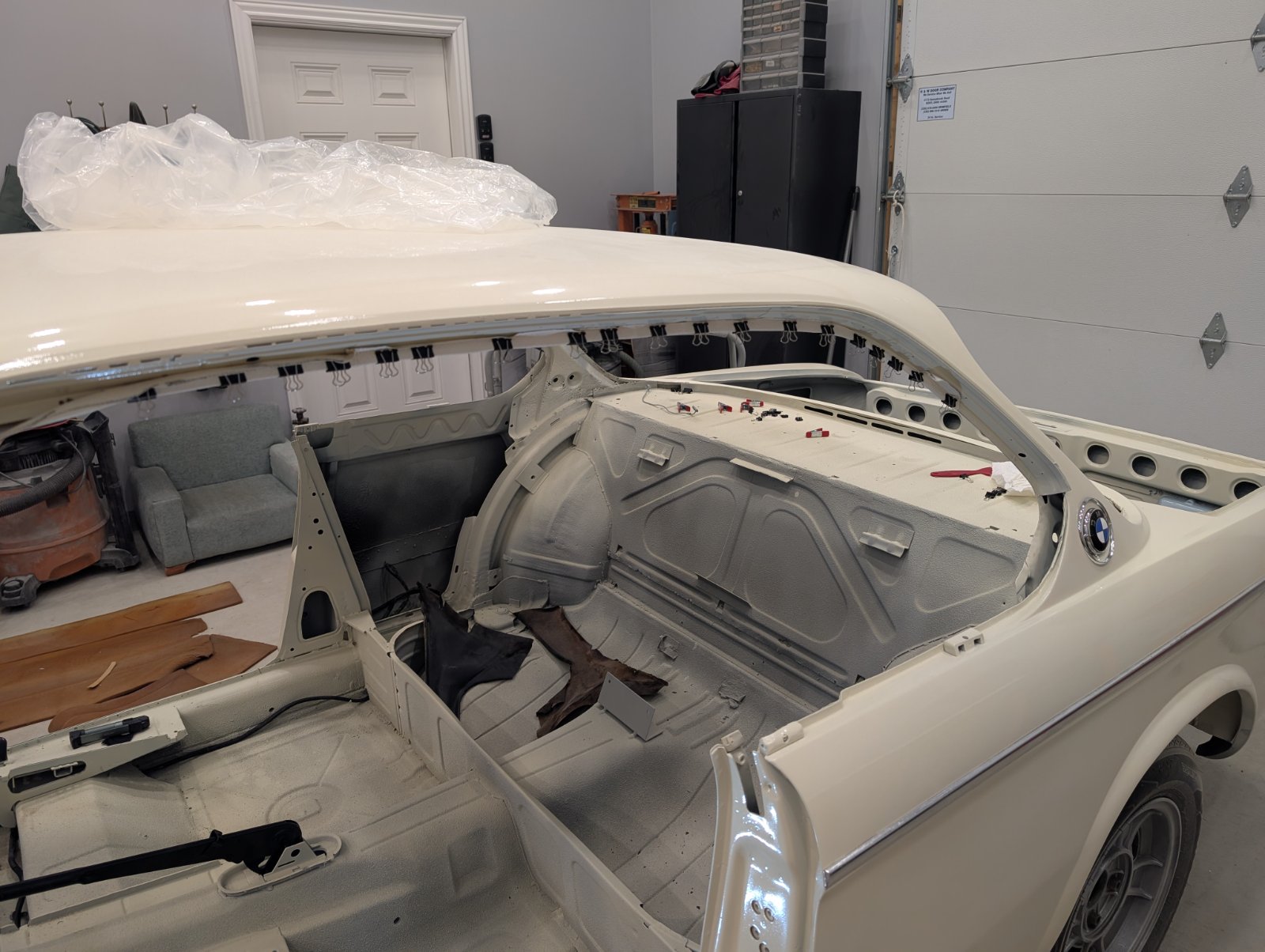

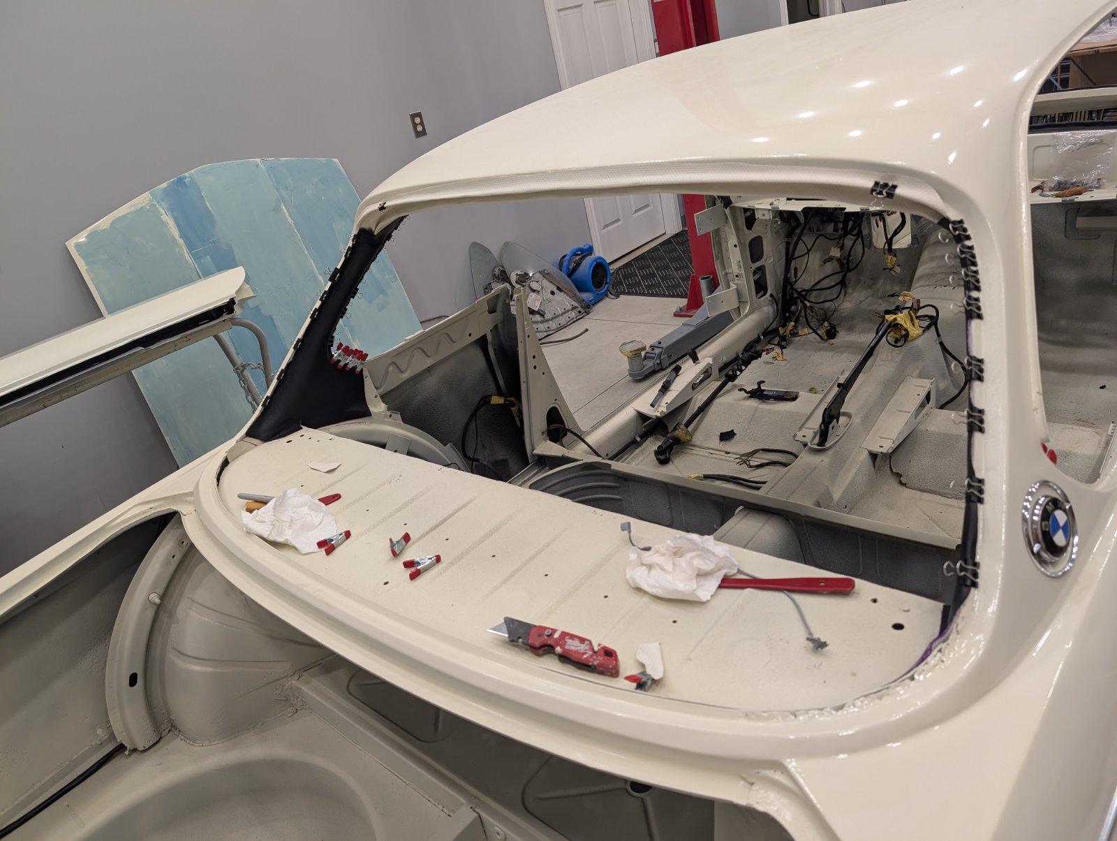

Anyway... The headliner was a ball... Not. Unless you really love binder clips... As stated ... Not done until I get the new piece.

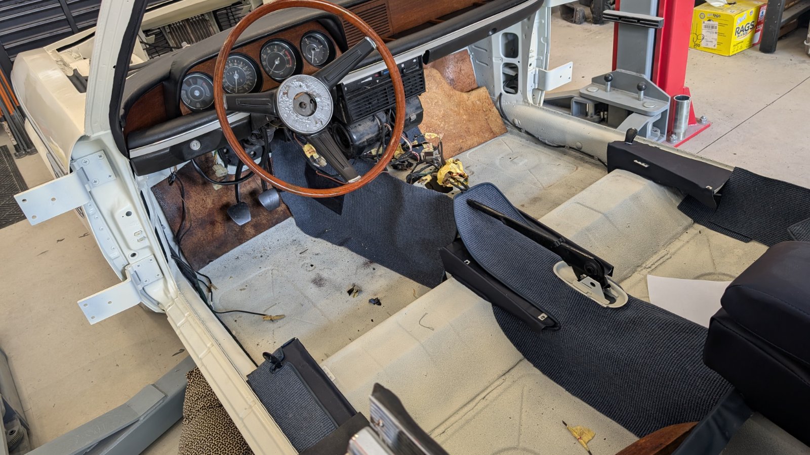

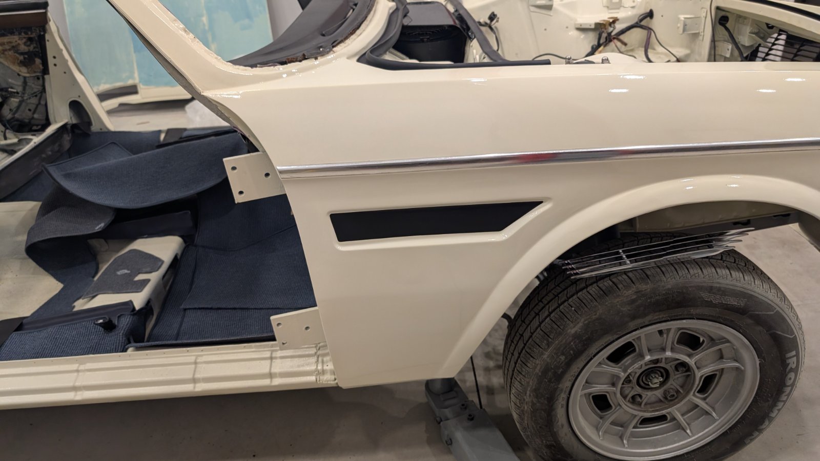

Recovered the a and c pillars. Used the old ones as templates... Slight miss on one side but fixable.

making great progress Todd ... keep it going! chances are that the tail end has been bumped and fixed. a good body guy can make it fit right. the turn signal end of my left tail light stuck out a bit. before painting, my guy fixed it so that it fits perfectly.

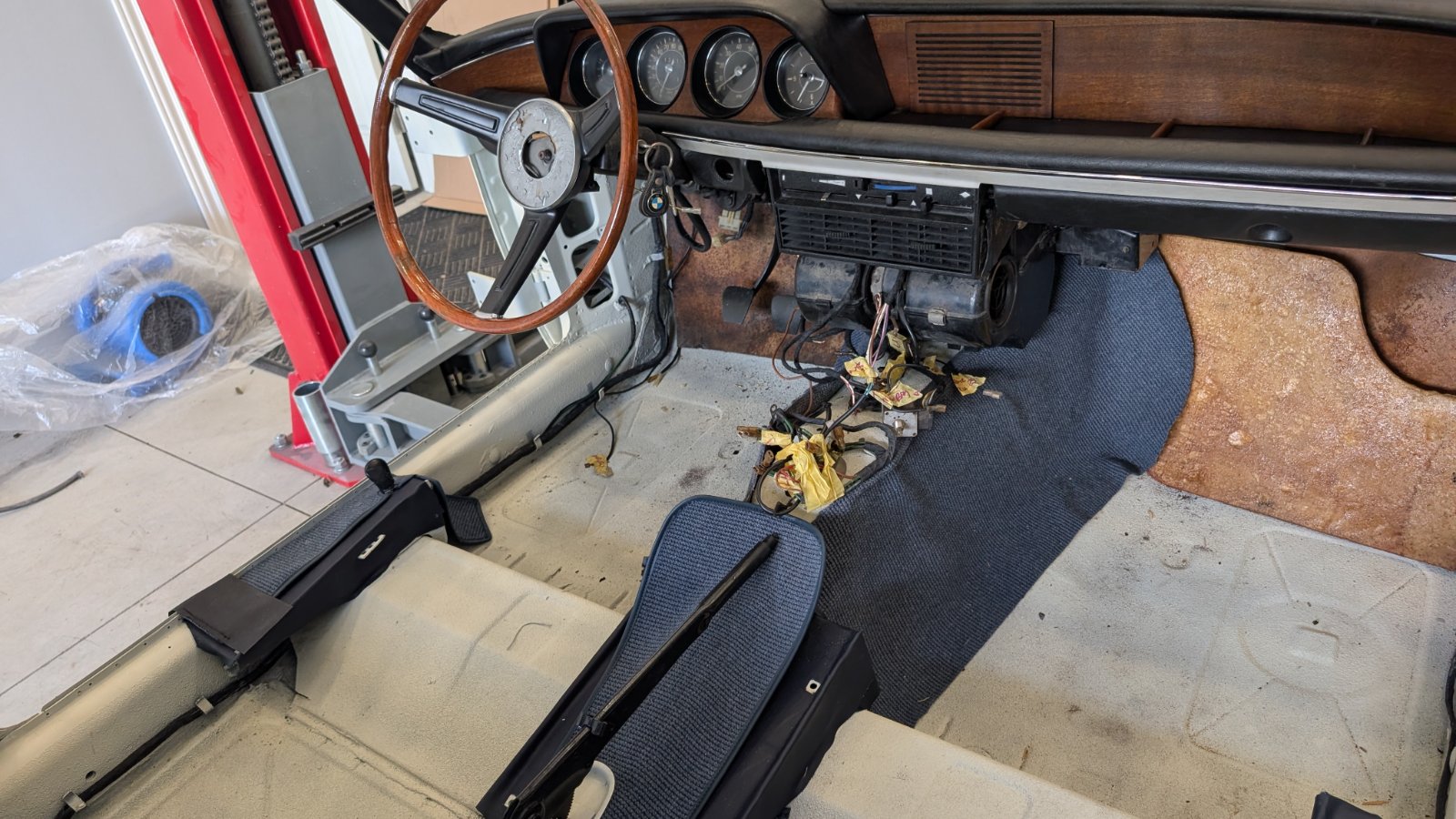

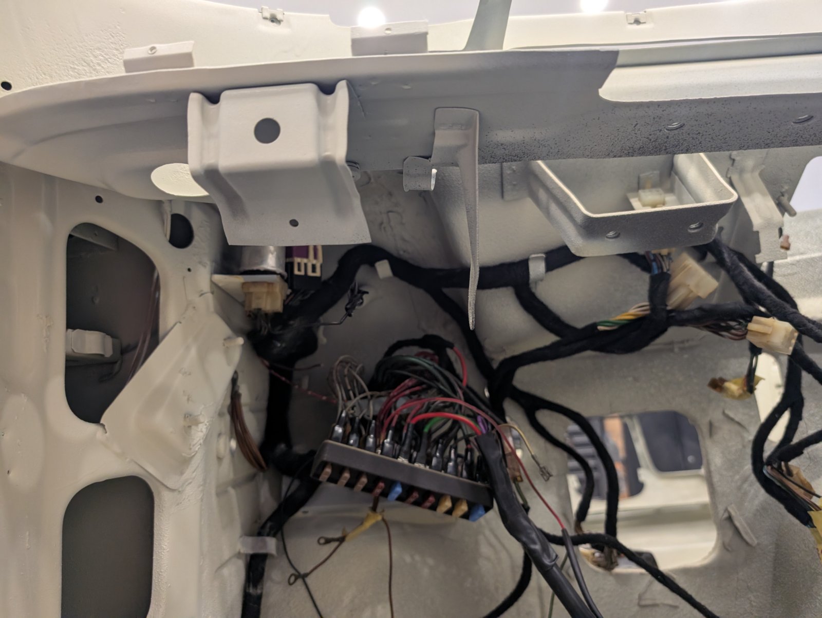

Started laying out the carpet so I could put the heater and evaporator back in.
  • Like
Reactions: Dlc
The heater / evap was total bitch of a job... Took me 4 attempts to get it in right.
But looking good this far. Scratched the panel up a touch but I can fix it.
I need to put some more padding on the tunnel.
Oh yah. Got the gasket for the pedal box so I could put the column in. Now we can move it around a bit better.

question - did you spray thermal or sound insulation on the floor? if not, have you given any thought to dynamat or dynaliner ... especially at the tranny tunnel / firewall to lessen heat transfer. might be a good idea before you stick the evaporator in.
