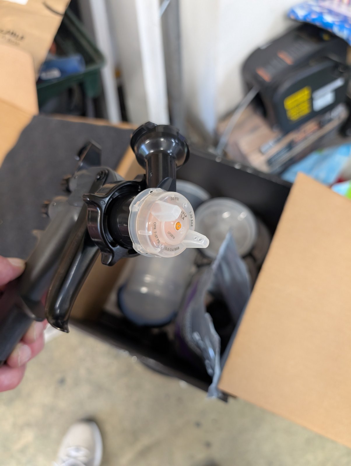

Will share that I got a really cool new spray gun. My old Sata died on the MGC paint job.
It's a 3M PSP. Disposable nozzles and cups... Very cool. They kill you on the consumables but it's so cool not to have to clean the gun.

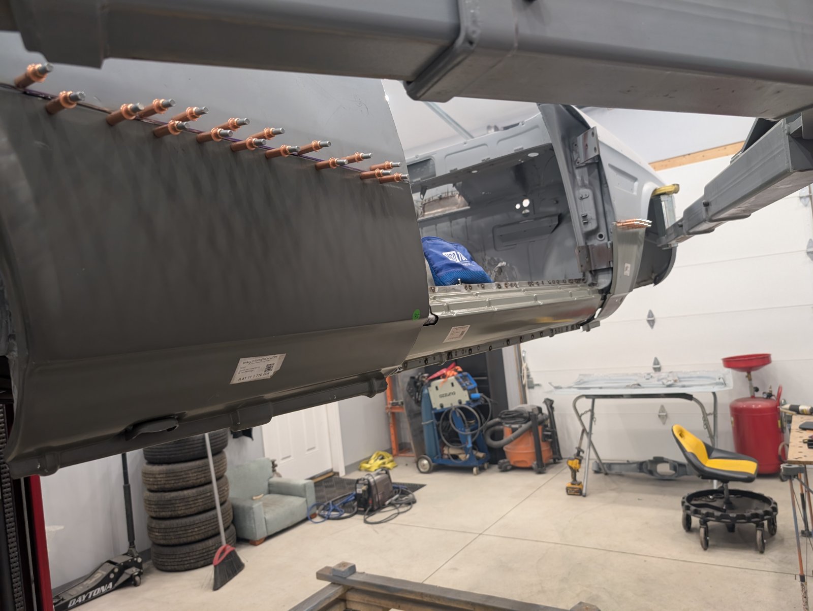

Oh shoot... Sorry this is why I should have done this more often... Forgot. I installed the new fender bottoms before I took off too.
Glued in but not finished quite yet.
I love this structural adhesive. Those are panels that would warp pretty good with a lot of welding.

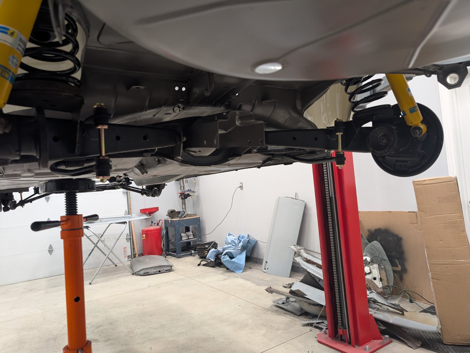

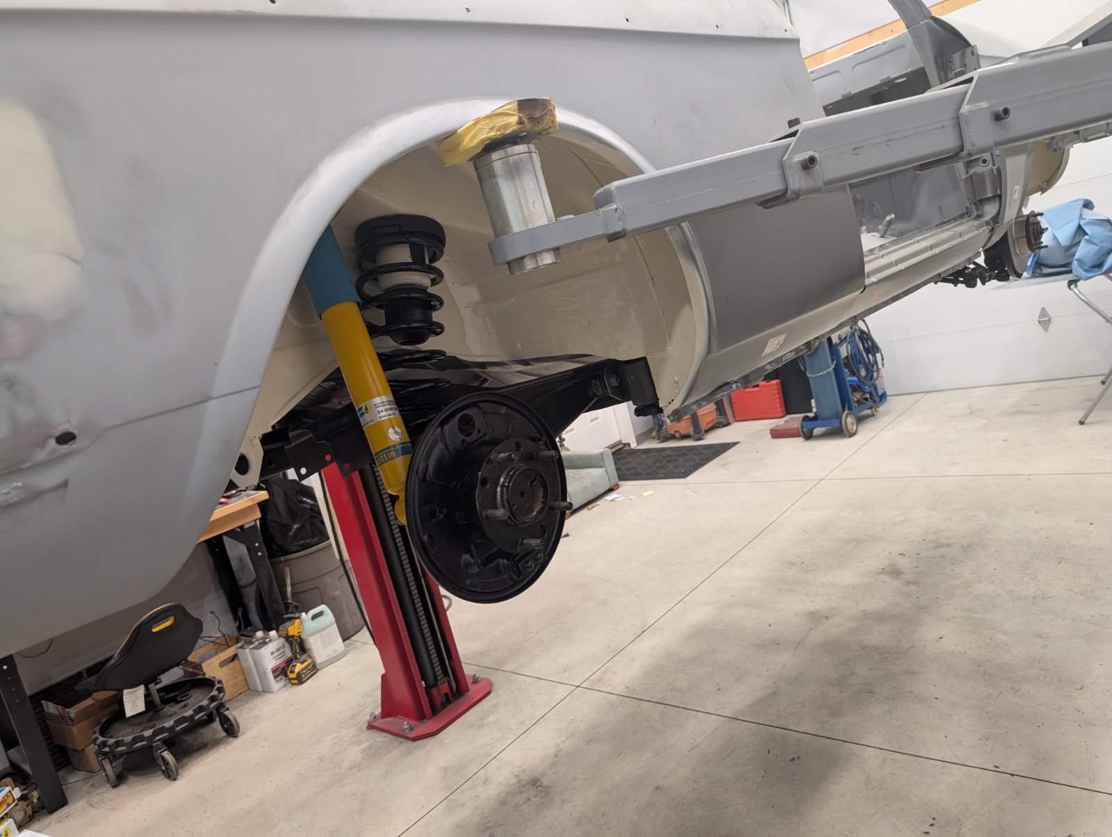

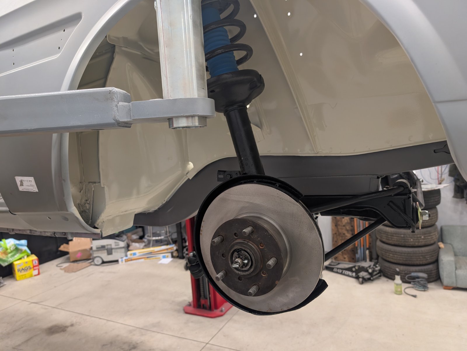

Finished the rear trailing arms. Shocks and sway bar.
Now if need be we can throw some wheels on it and roll it. Which we will when it's ready to go in the paint booth which goes on the other side of the garage.

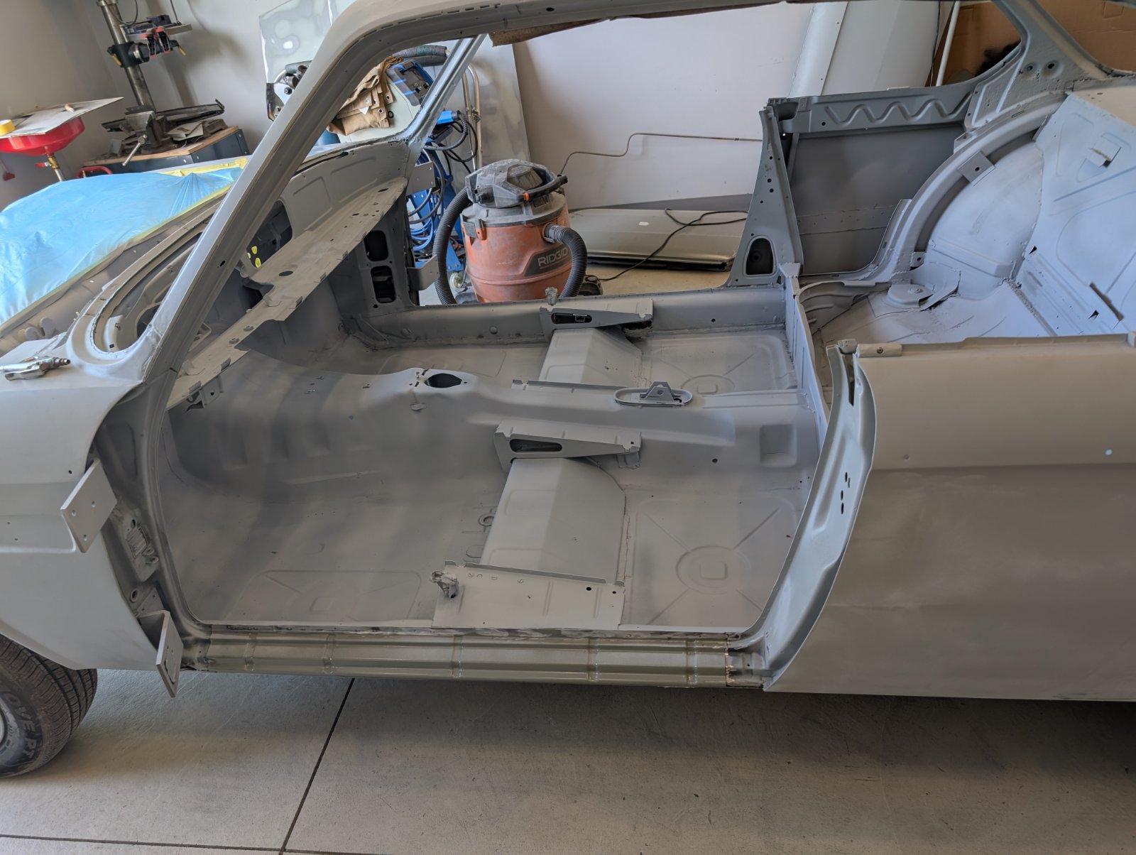

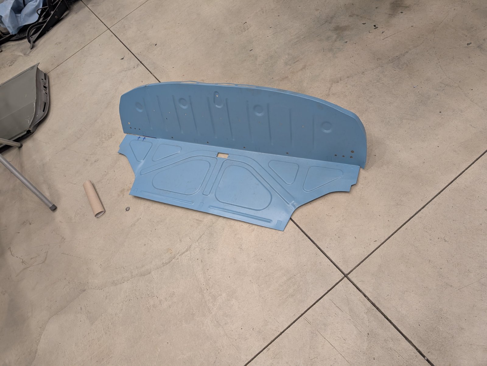

Finished the rear package shelf... Such as it was.
Unfortunately it was not a good piece. Happens. Required a lot of cutting, remaking of radiuses and general cussing and fighting. Tidied up some things inside and rolled it outside for some primer.
I am doing lizard skin on the interior. Sound proofing and ceramic heat shield on the firewall, tunnel and heater shelf. The lizard skin instructions says it cannot go over bare metal.
The sound proofing has to go on first apparently. It requires a 24 to 36 hours cure. Then the ceramic coat and then the same cure. Should be interesting. Never done this before

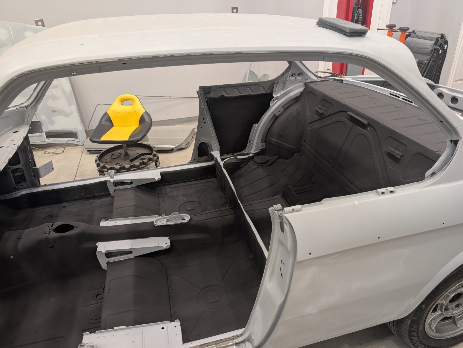

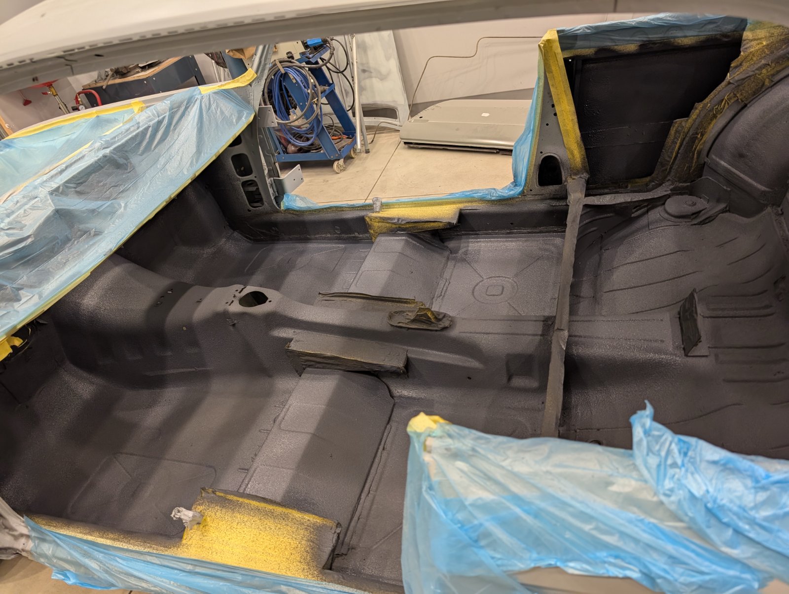

Well that stuff is really interesting.
Man... You just keep spraying and spraying and spraying. At some point I just kind of went... That has to be enough. About a gallon used.

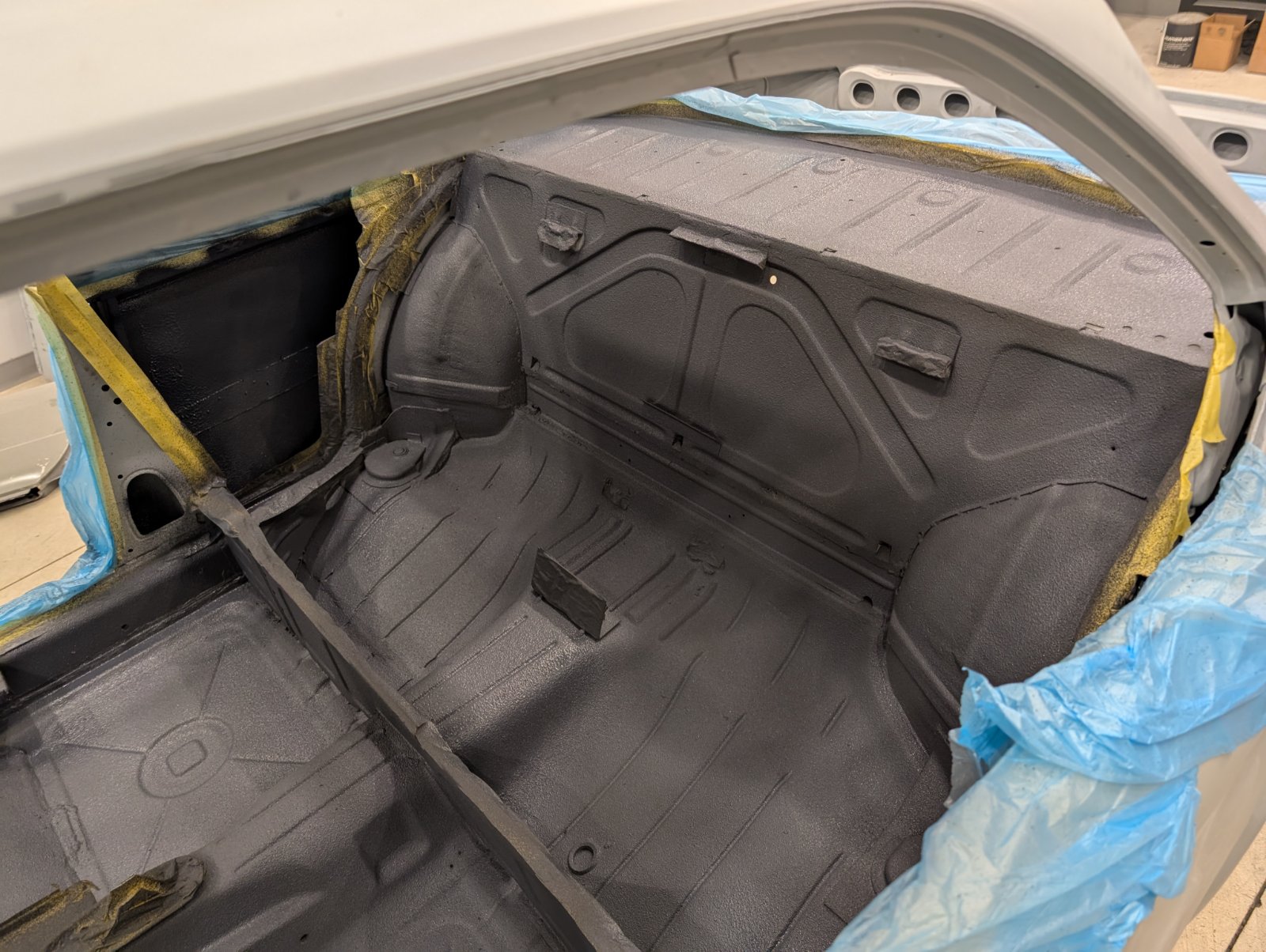

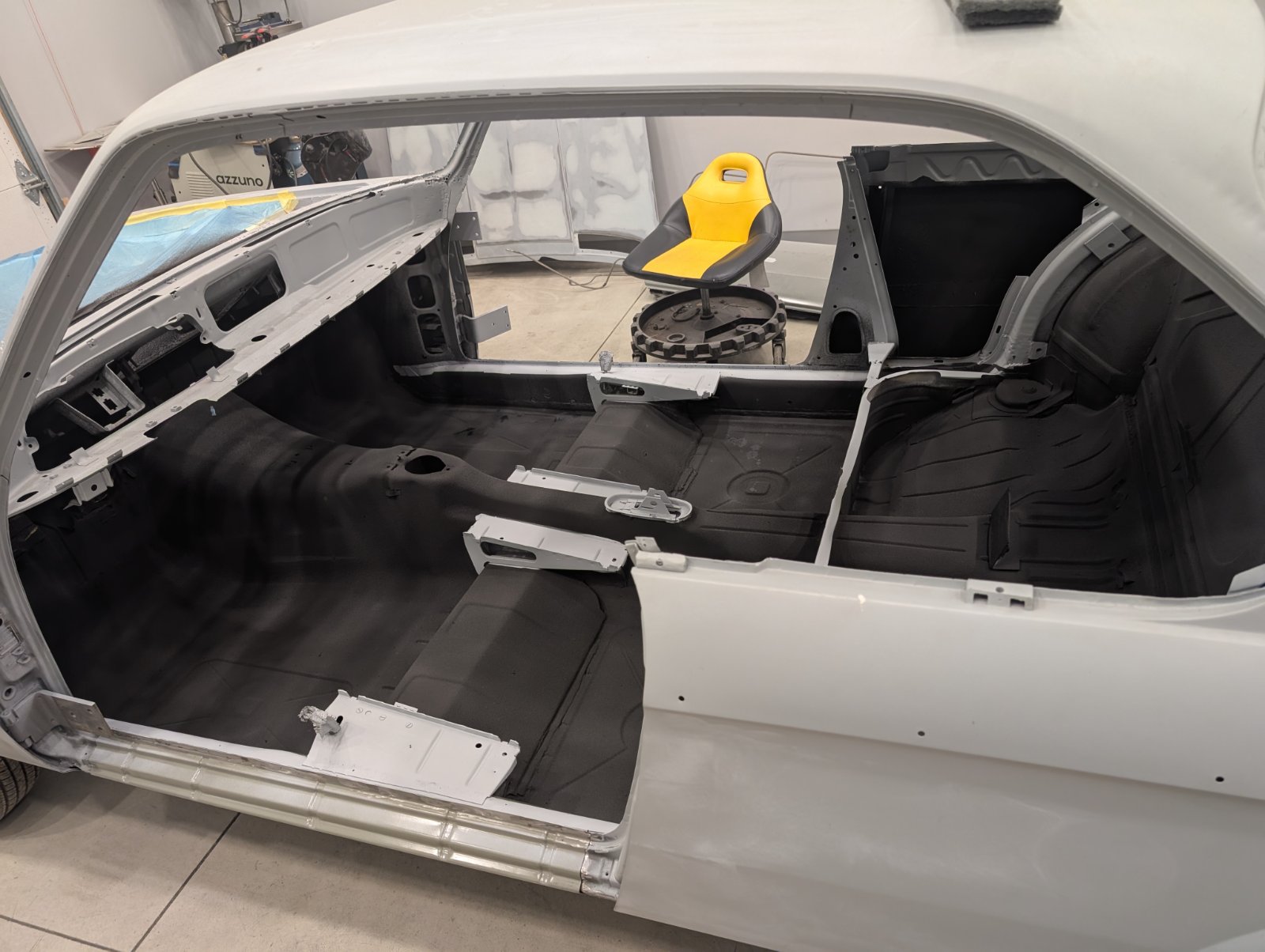

So I sprayed the ceramic coat today.
Highly uneventful.
So the tally was about a gallon and a quarter of sound control for the firewall floor boards rear seat, package shelf and roof.
About 3/4 of a gallon of ceramic coating for the firewall floorboards tunnel and heater shelf.
Now we will see if it actually works.

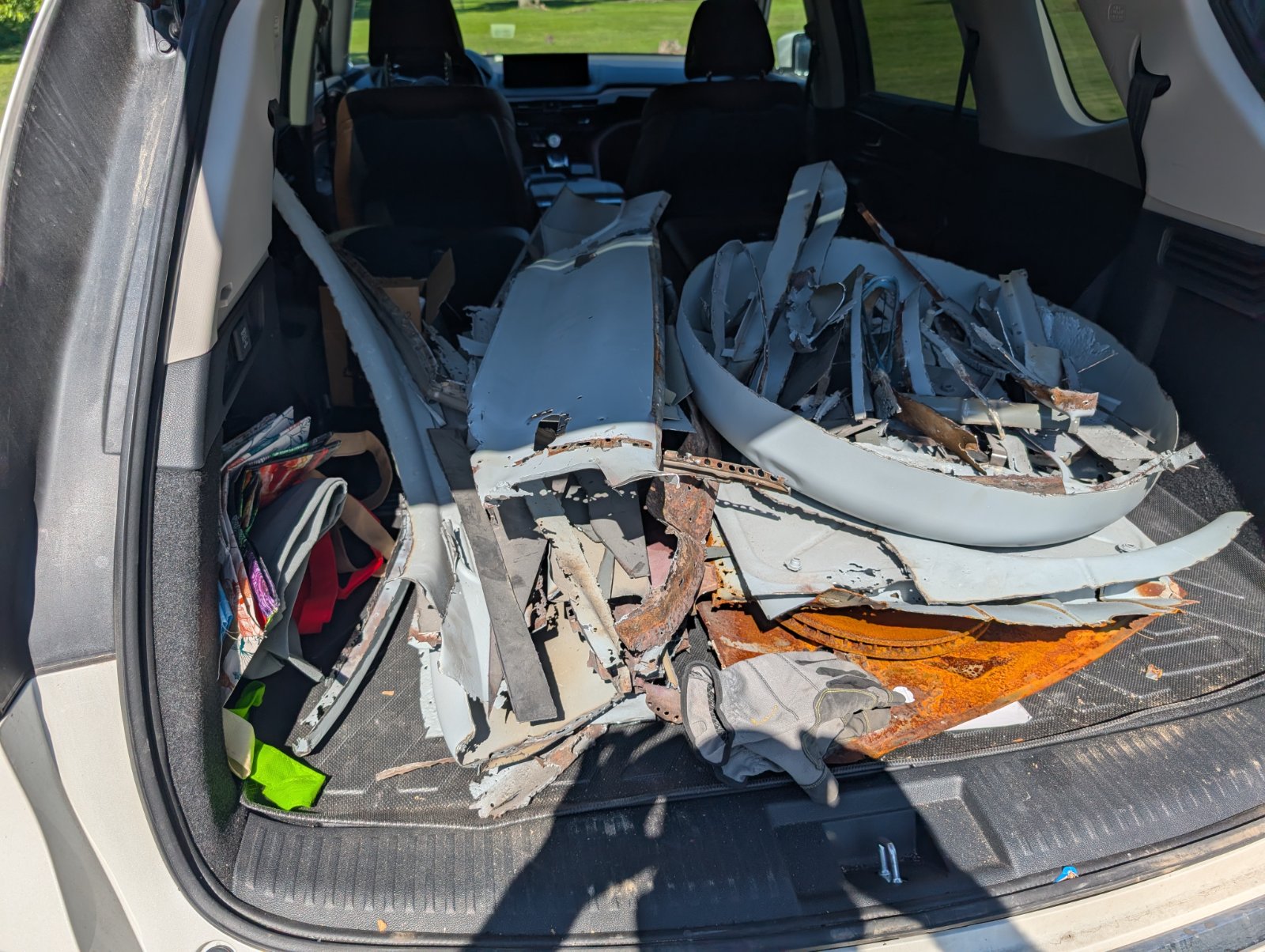

Took all the scrap metal from the car in for recycling on Wednesday.
As usual...the lesson. When you think there is X amount of rust... There is Y. BTDT so many times. Oh the things I get myself into

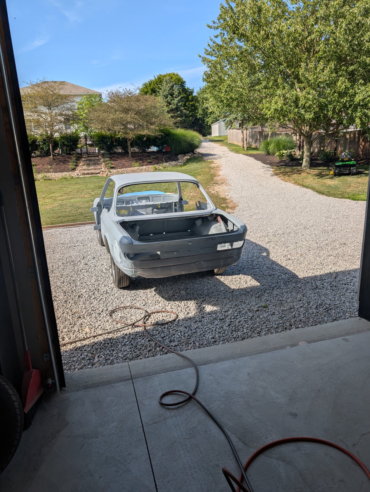

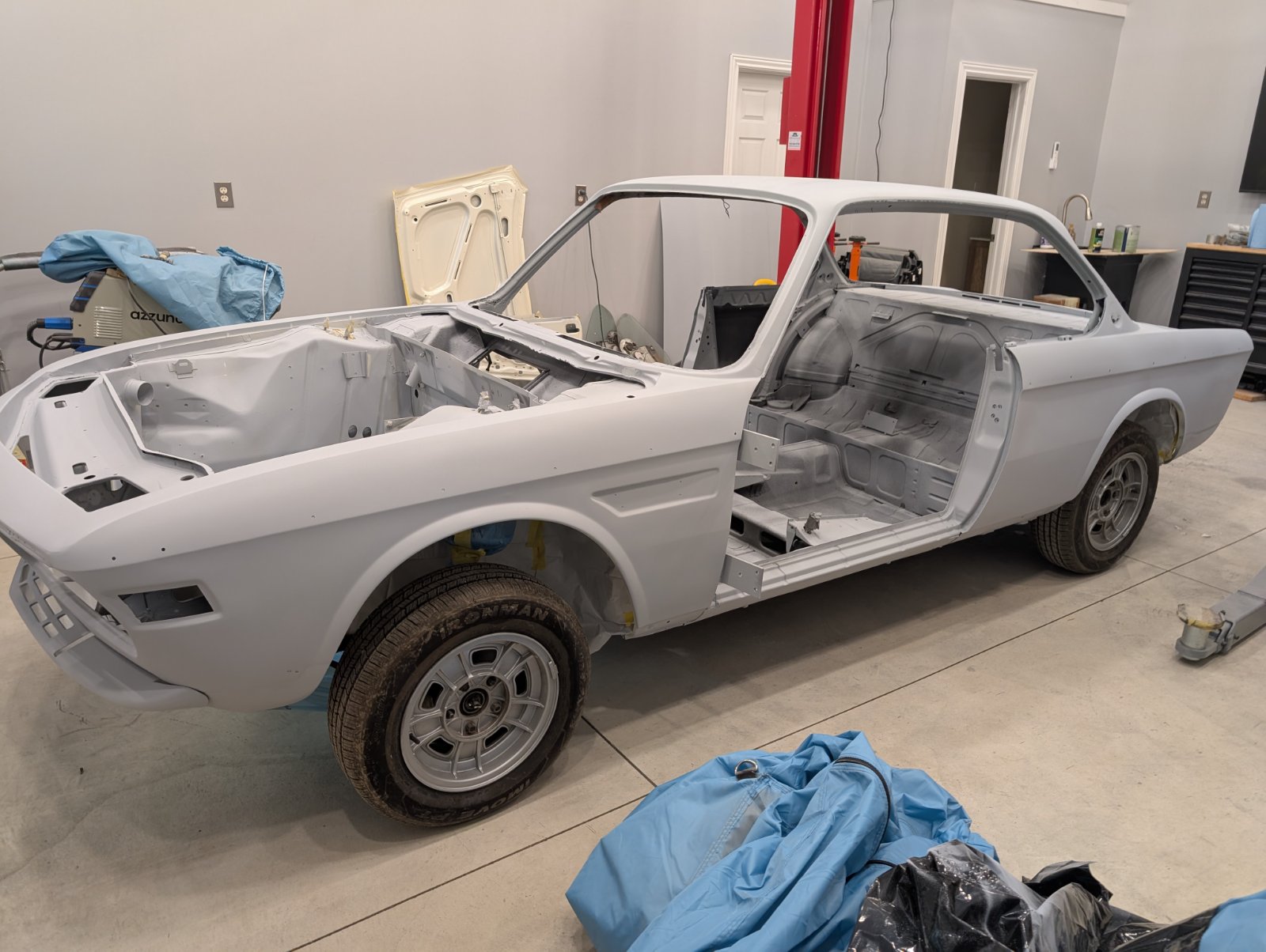

Well the body is completely back in primer.
Pretty much the typical. Places I thought I may have to go back in are fine and places I thought we're good... Go back in. The normal.

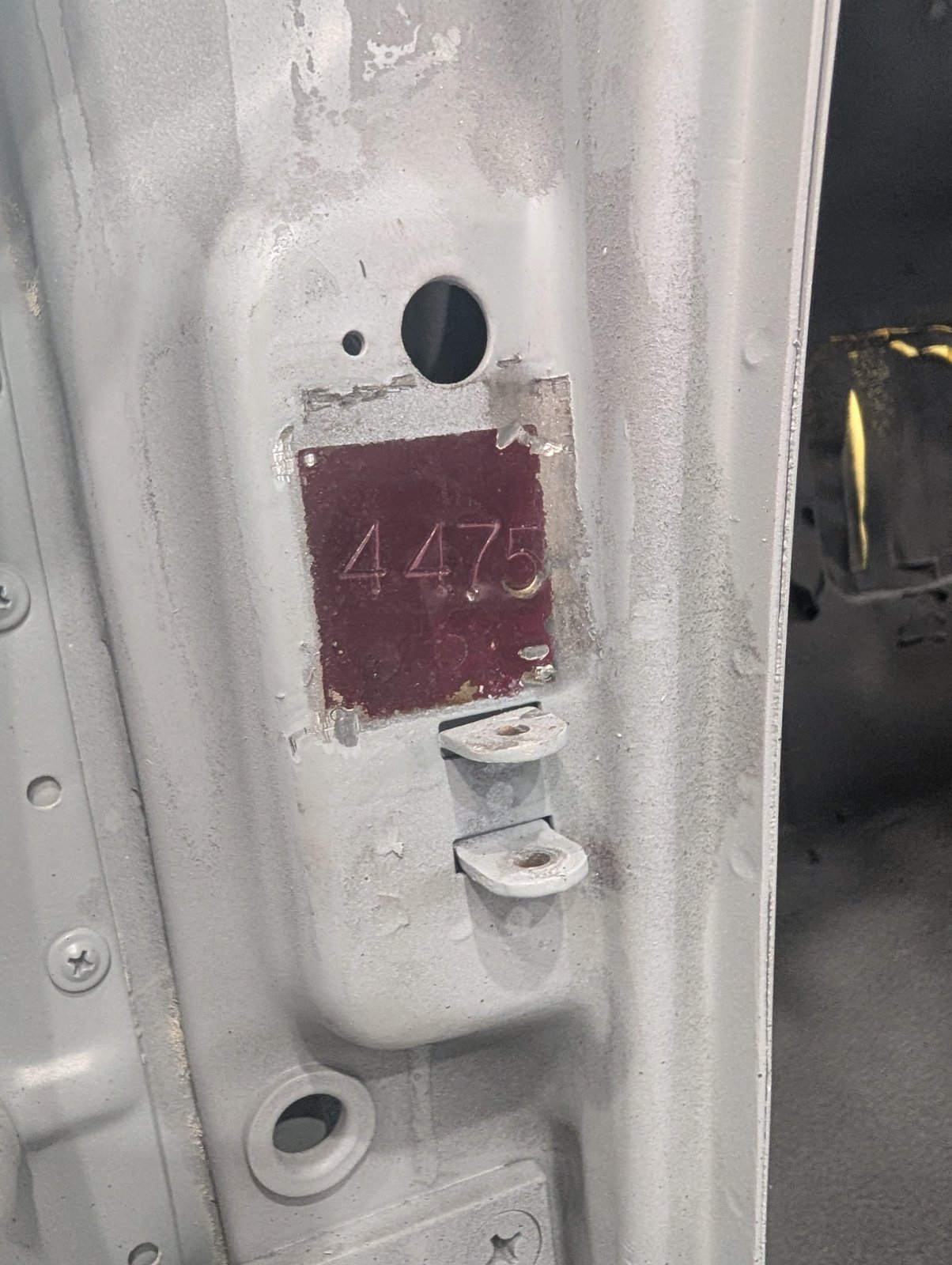

Somebody a bit back was asking about the body number on our cars.
Indeed it is underneath the body color tag.
Here is mine.

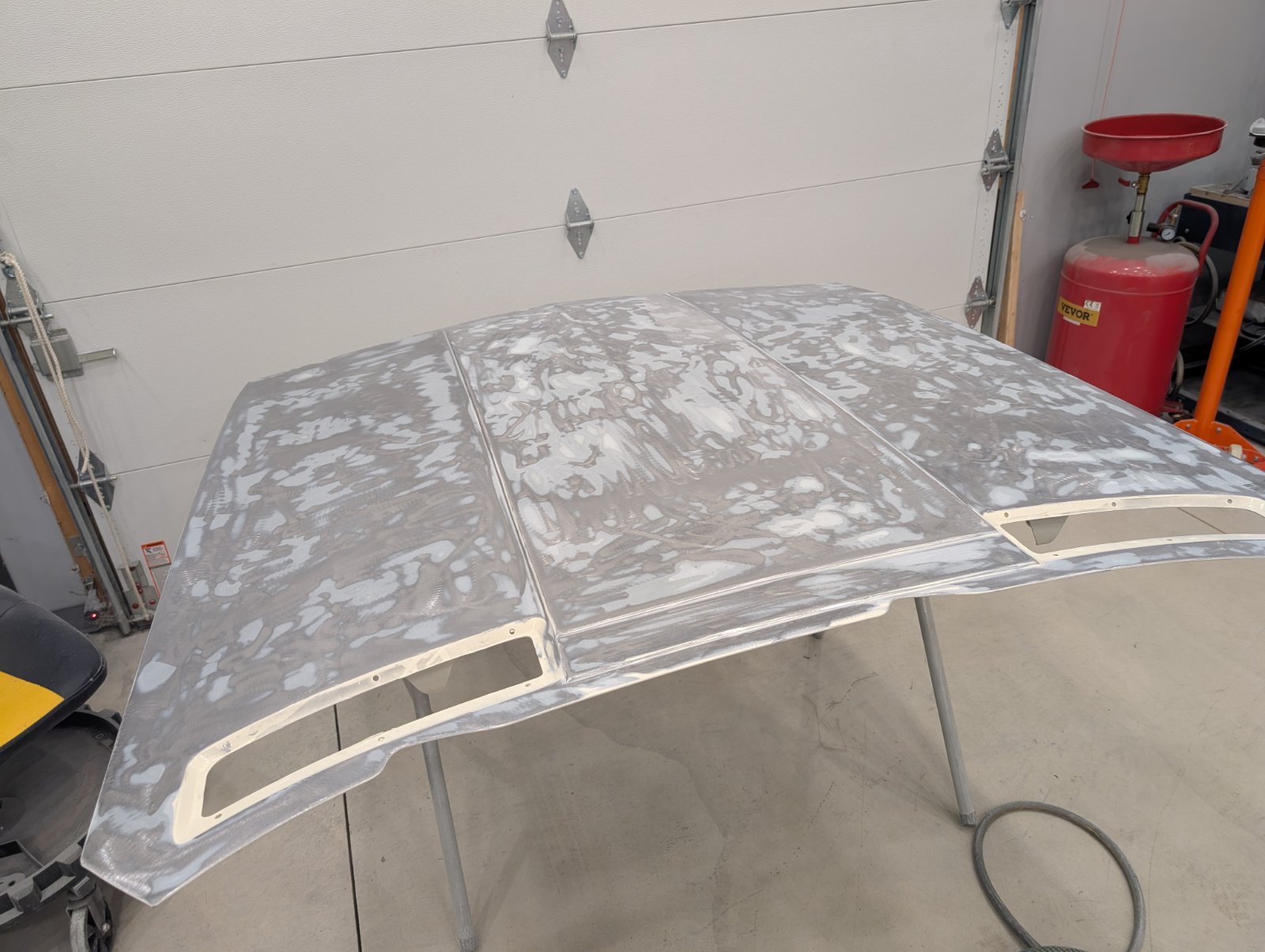

Body is in paint... The hood. Well sheeshus. I have seen a lot of screwed up panels in my life. I've had a lot of MGs. But this sucker takes the cake. Not a straight damn part on it.
Obviously I've cut in the back etc. what a mistake.
Sorry i use a laughing smile, but I feel with you.
Mine has also everywhere dents, ok, not screwed up, but other whorse sh.t.....
Good luck with straight panels.
Breiti
Yah… everything else is fairly straightforward. I went to final block the hood and was so cheesed at my work that I just stripped it all the way back again. Darn thing is like a potato chip. What the heck did these people do :oops:

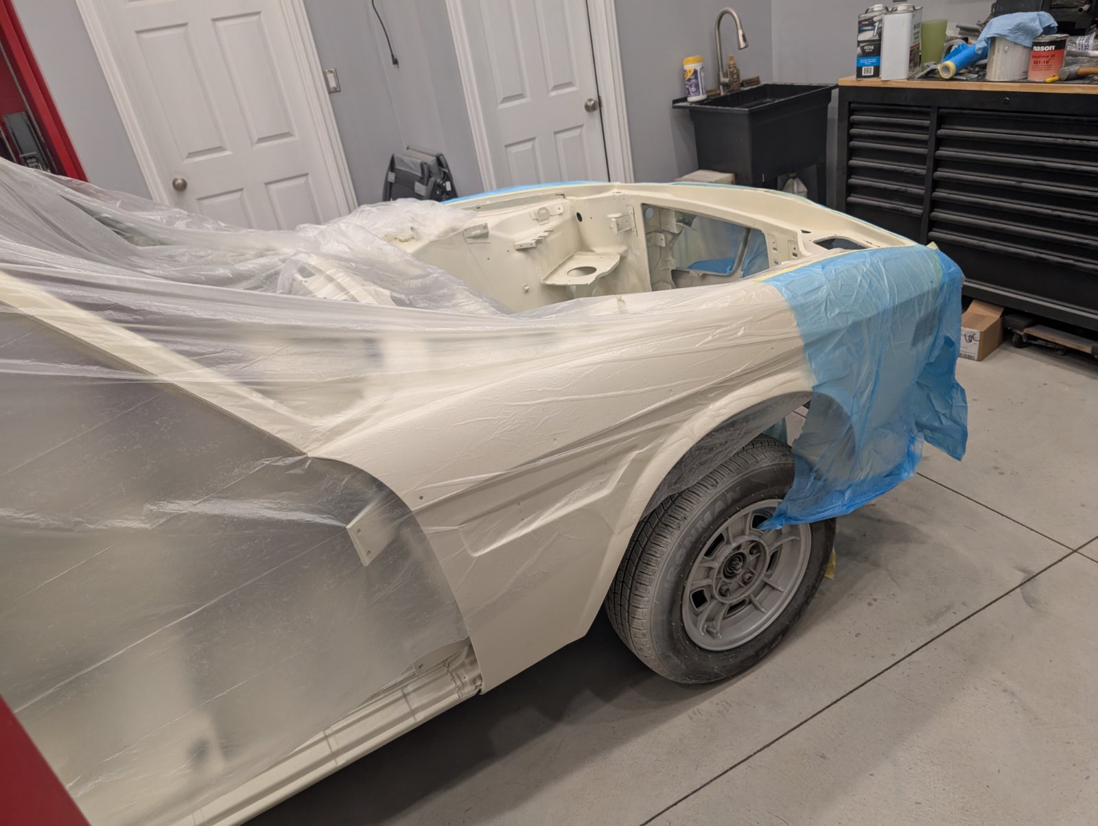

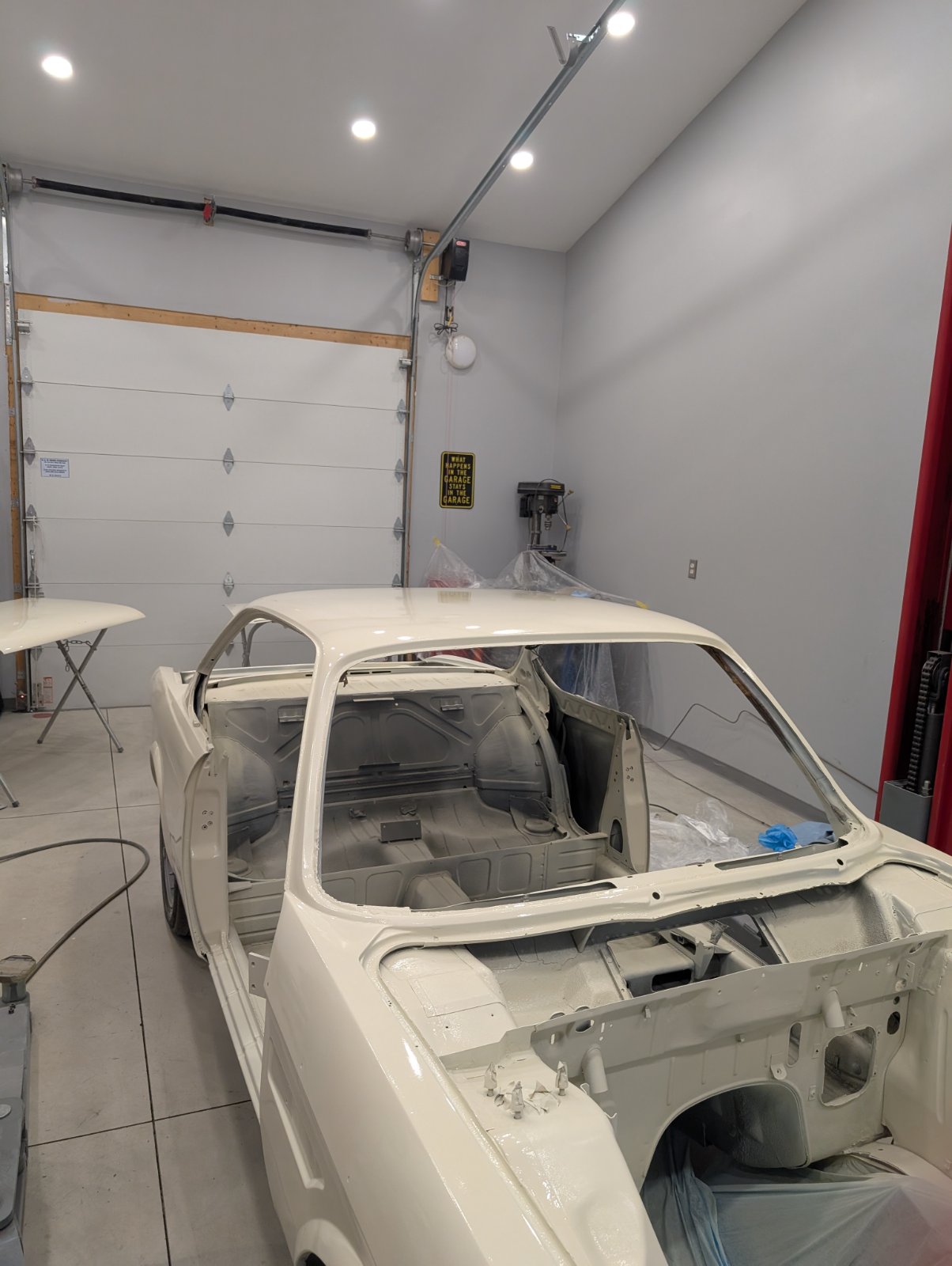

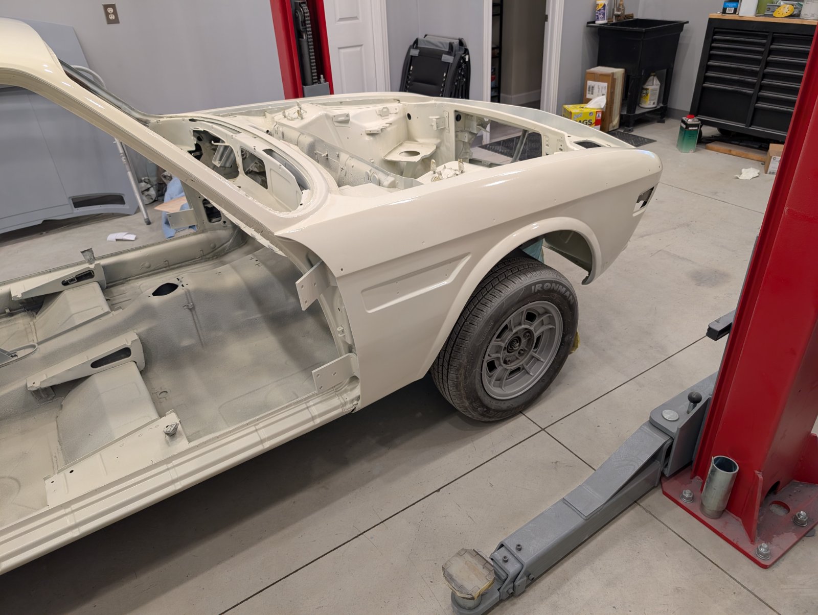

Cleared the body and doors. Couple repairs to make. One run on the door... That stinks.
Silly nose of the car.... Could not get the spray gun angled right to get the inside of it without dragging the air hose on it. Tape it off and get it tomorrow. Couple of dry spots in the clear. Hit them with 1500 and coat.
Primarily why I use the spot panel clear... Very repairable. And I do not claim to be a professional at all.

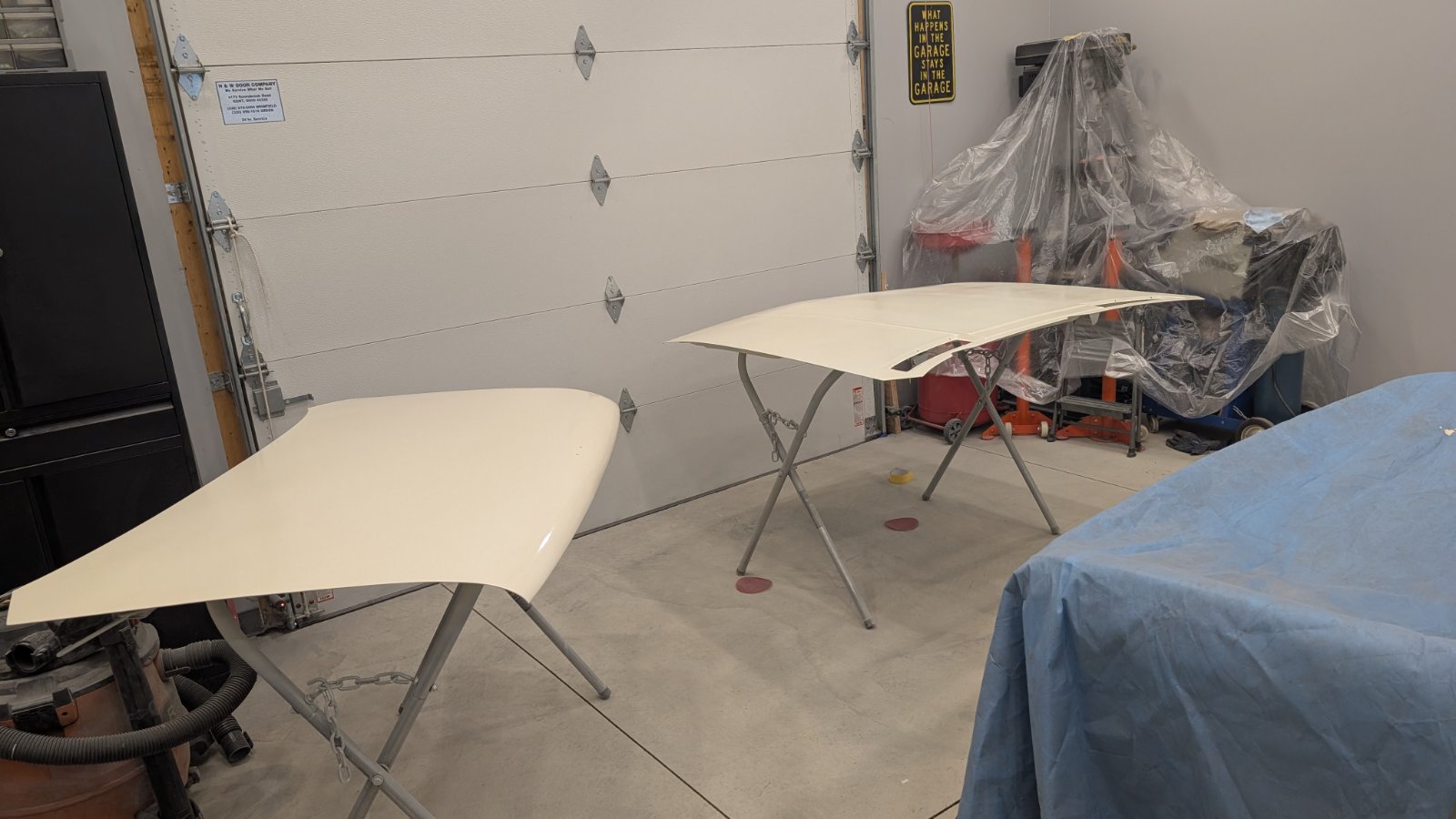

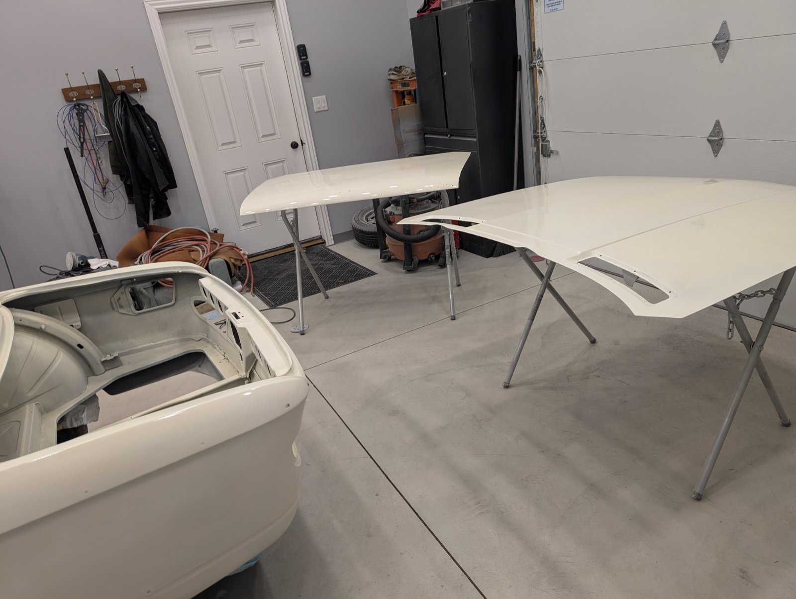

Got the trunk and hood done again. Trunk was just the lip. Hood... Well we know that piece of crap.
Sprayed the nose interior.
No clear yet... Later this evening. Too hot out.

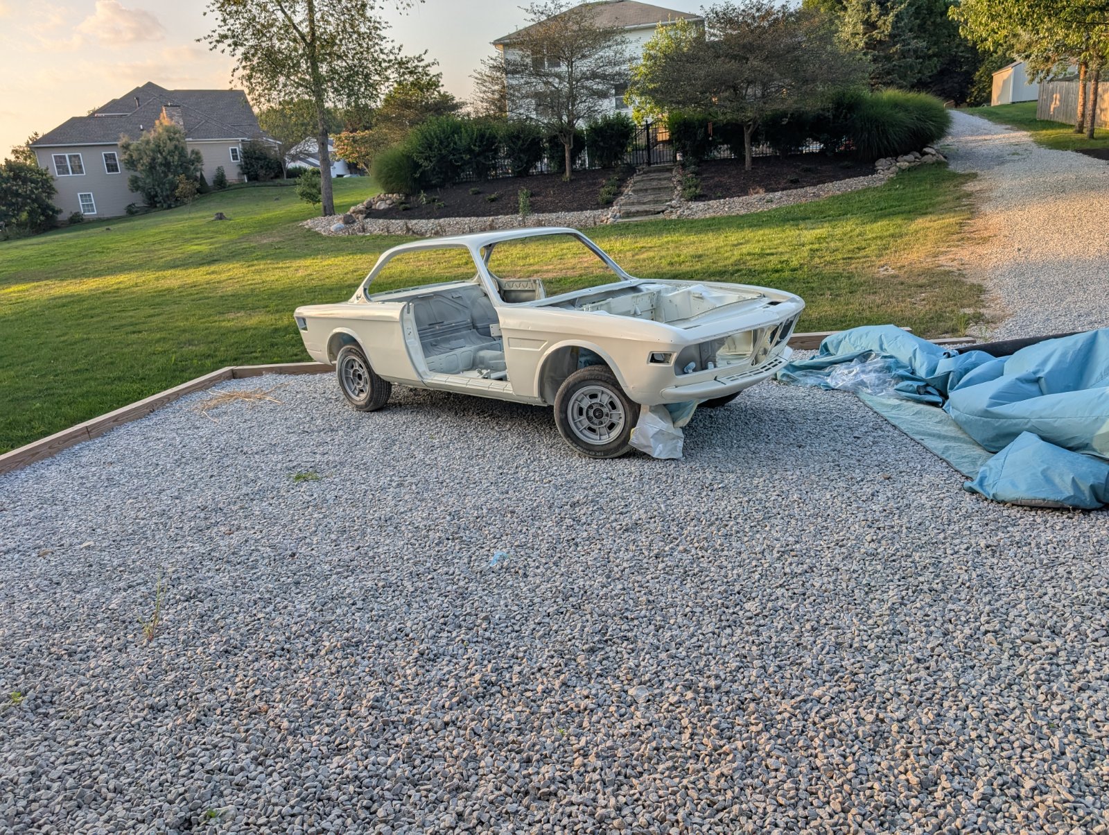

Much better.
I just told my wife if I ever say I'm gonna paint a car again she has the right to kick the ever loving shit out me (my cousin Vinny reference).
But I do mean it. At 57 years old with leukemia I am just past it. Mechanical work.. no problem. It's less demanding.
