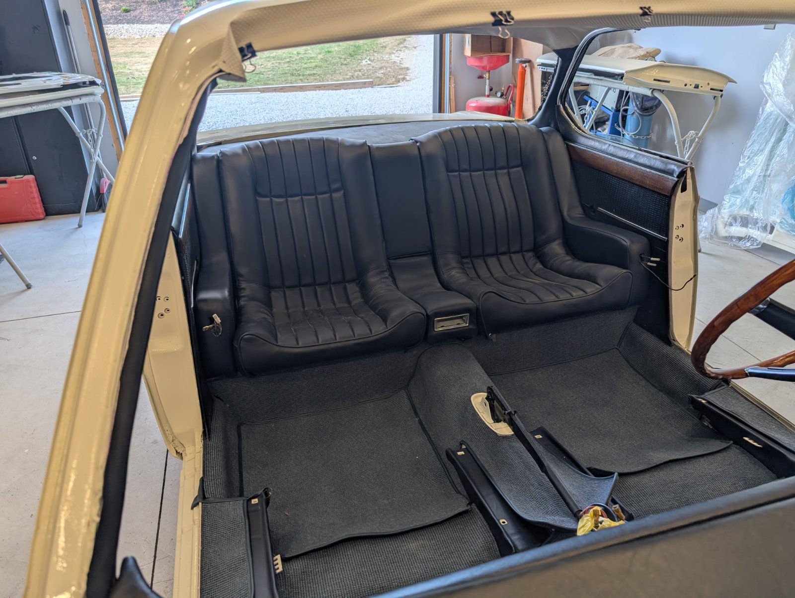

Not documented in pics but got the rear quarter windows in. Trim etc. obviously waiting on the front trim when the headliner is fully in.
Fitted the back carpet pieces. Figured I would test fit the seats... Still not happy with them so they will come out for more fiddling.
Floor carpet is not glued down yet of course... More work to be done in there and I don't want to mess them up.

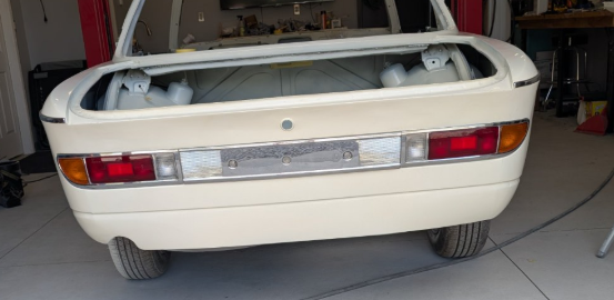

One thing I totally spaced out on... If you noticed... There are no holes for the rear bumper in the new panel.... Whoops.
were they filled by accident? also no bolt holes in the side quarters?
If the reinforcement brackets are still present on the inside, then one could make new holes by drilling them through from the inside. Then at least the positioning is OK.
CSL panels do not have the holes for the under riders as the black CSL bumpers didn't use under riders.
Think about if you want under riders - if so, you need holes for them as well.
the lower valance panel is a new replacement panel. It did not come with any holes for mounting. And I tossed the old one. Side holes are still there. Will just have to mount up the bumper on the side and do some measurements to drill holes and fab up mounts. No biggie just a pain. And no Erik. I don’t plan on using the underriders. Think it looks cleaner without them. But I still have them if I should decide to put them on later.

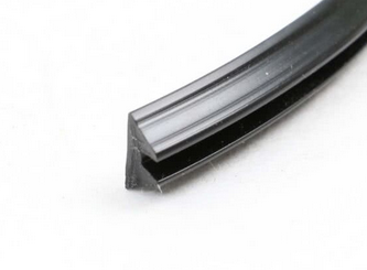

very good point Erik, i have extra rubber trim that is used between the two pieces of chrome and i have planned to glue it to the inside of the underrider to prevent the chromed steel from rubbing on the lower valance. part #51111808420

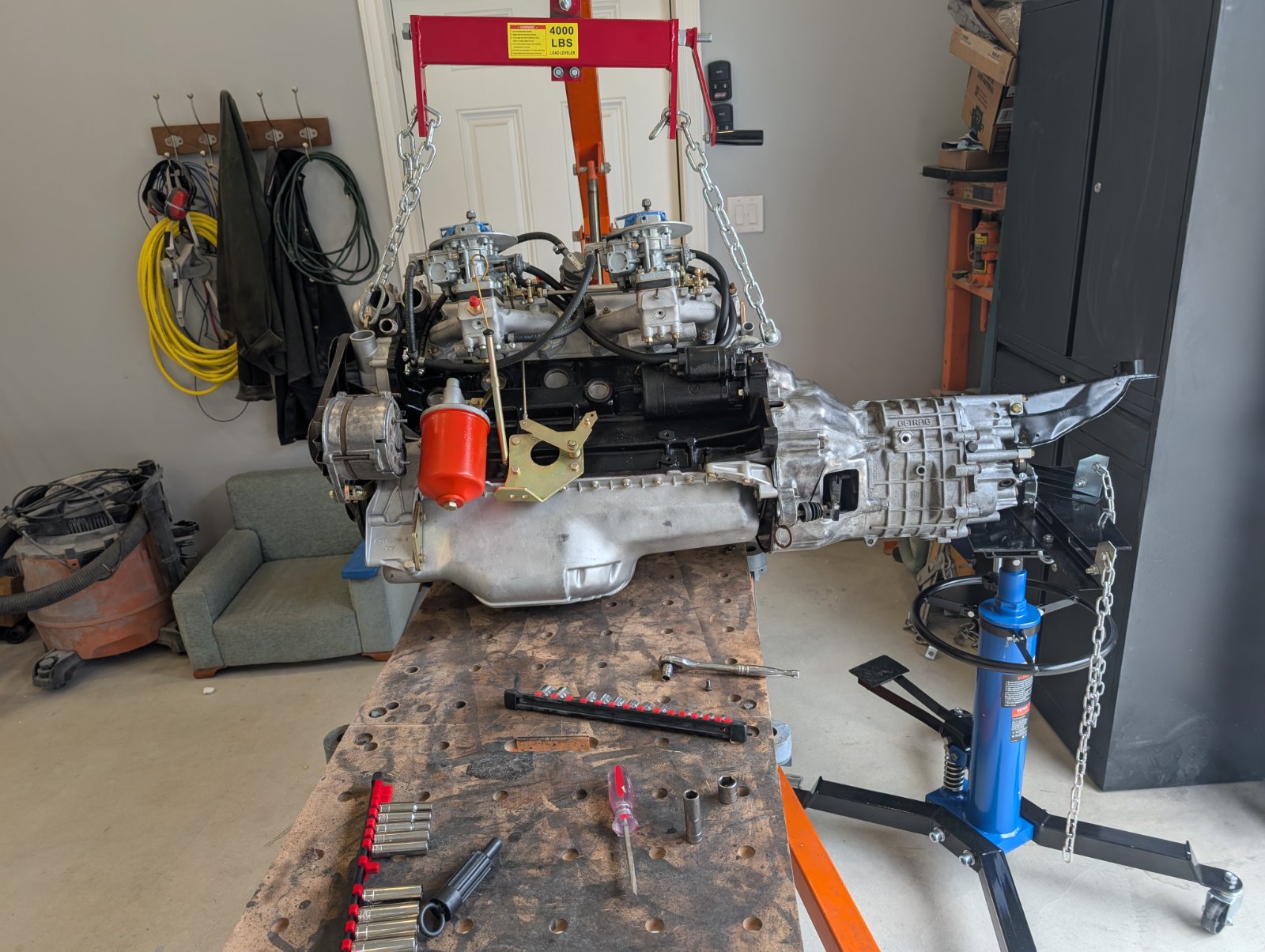

So the engine and transmission are finally able to be married.
So as you know… this is 3.0 engine and getrag 4 speed. The tricky part is this is my 2800 bell housing and the trans has been modified to accept my guibo and driveshaft. The trans is also fitted with a Korman short shifter.
Interesting to note… the bell housing does not “quite” match up to the 3.0. It’s very close and all the major holes line up just fine. The starter bump holes do not match up and the bottom cover had to be slightly modified.
The clutch fork is also my 2800. It looks very forward to me but I have not fitted my slave yet… I have to go find it upstairs in the parts loft.
