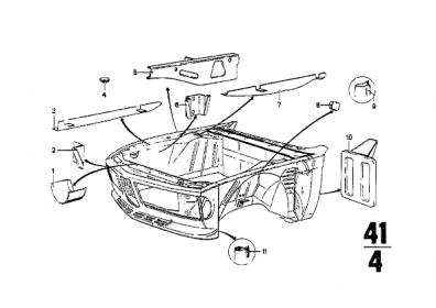

    Have just come from the sandblasters - refer attached photos. The result was perhaps a little better than I thought, the only evidence of pitting was found in:
    - the sills (I have all replacement guard fix panels),
    - part of the fire wall,
    - and the top of the front guards in the seal/gutter area... any parts/fix ideas for these?
    - one bodgy fix at the front right headlight (looks like a minor accident) panel beating was a combo of metal and bog....
    but all in all, it seems the car including main panels, floors, strut towers etc are quite clean....
    Now for a quick prime and its off to the panel beater for all the new panels and some paint.... Maybe this time next year I'll be mobile.
    I welcome your comments and feedback!
    Chris

    Hi Chris - are you planning on replacing the fenders ?
    If not, the very least I suggest you remove the front and rear connecting plates which connect the outer fenders to the inner fenders along the gutter that you mentioned above. There is a hollow area under the gutter that needs to be treated and the only way to get to it is by removing those connection plates. (numbers 3 and 7 on the diagram)
    How do your A pillars look from inside the glove box and behind the kick panels ? There might be some unpleasant surprises there as well.

    My advise, for what it's worth.
    REMOVE THOSE FRONT GUARDS & SILL PANELS or don't bother continuing.
    DO IT RIGHT & DO IT ONCE!

    From what I see on the pictures after the soda blasting, I fully agree. You're spending $50K on something that's rotting from the inside.
