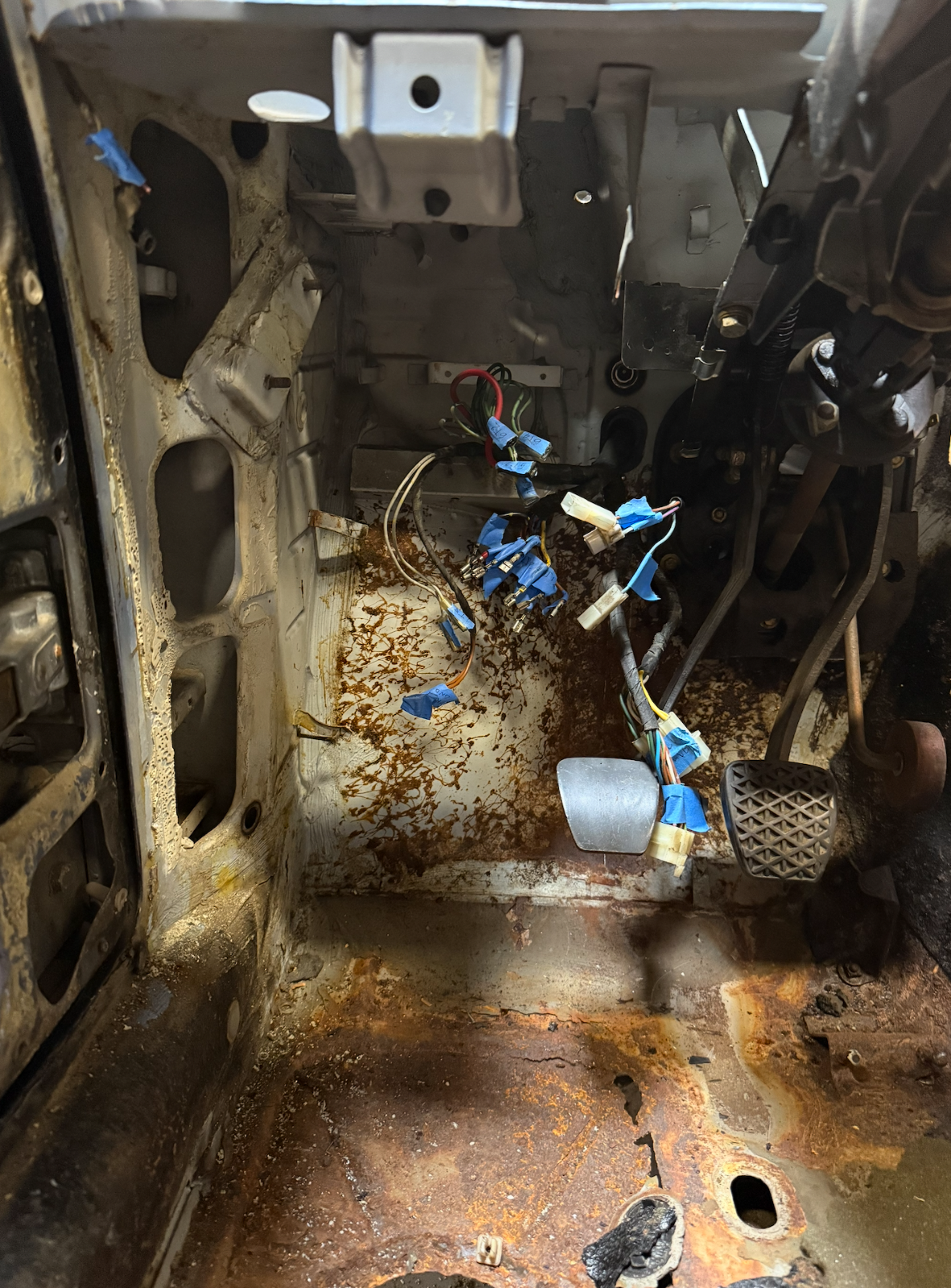

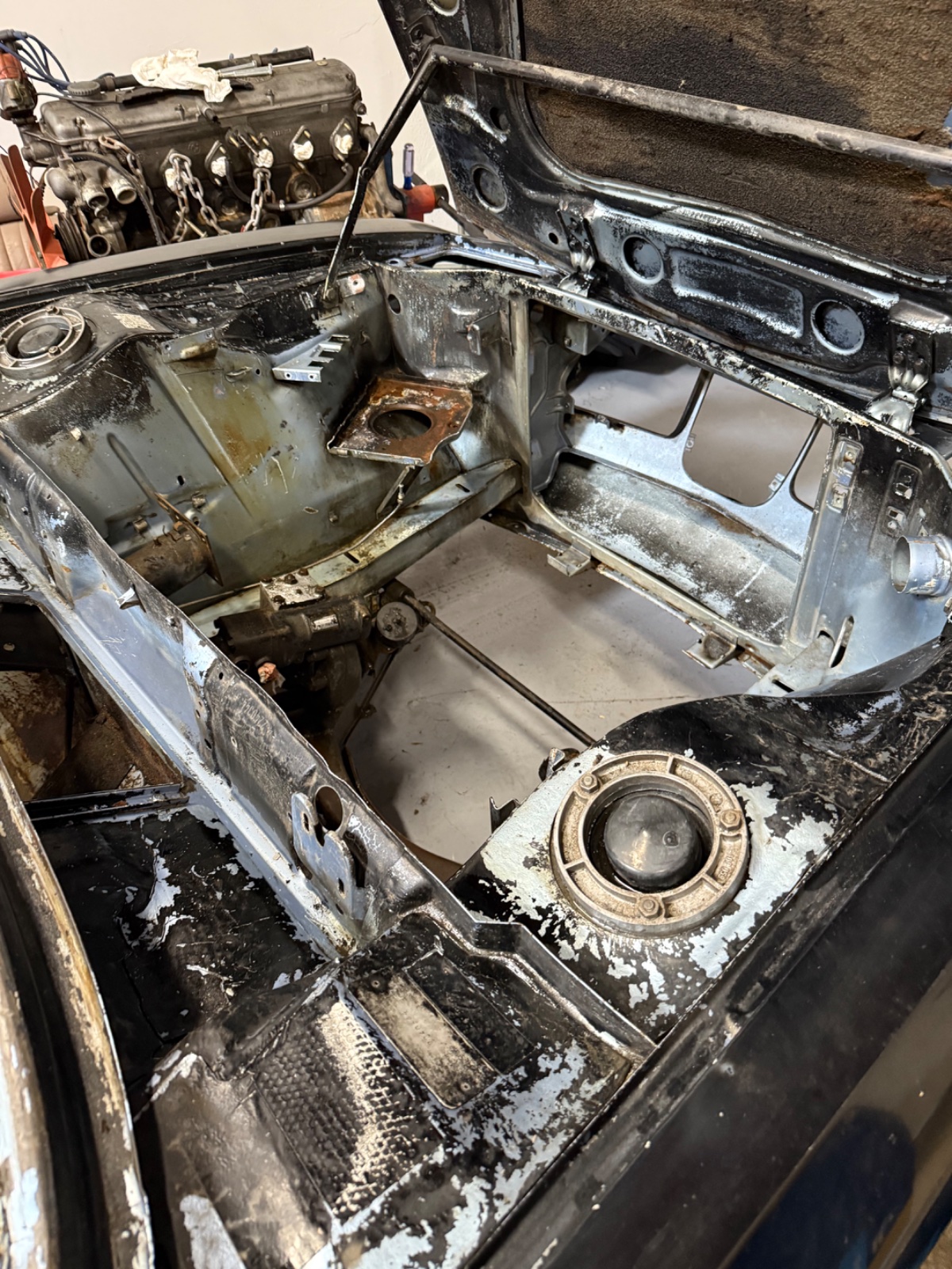

Got all the wires out of the car with the exception of a wire that goes through a separate firewall feedthrough and down to the transmission area. Not sure what that is for, and one of the two wires is clipped.

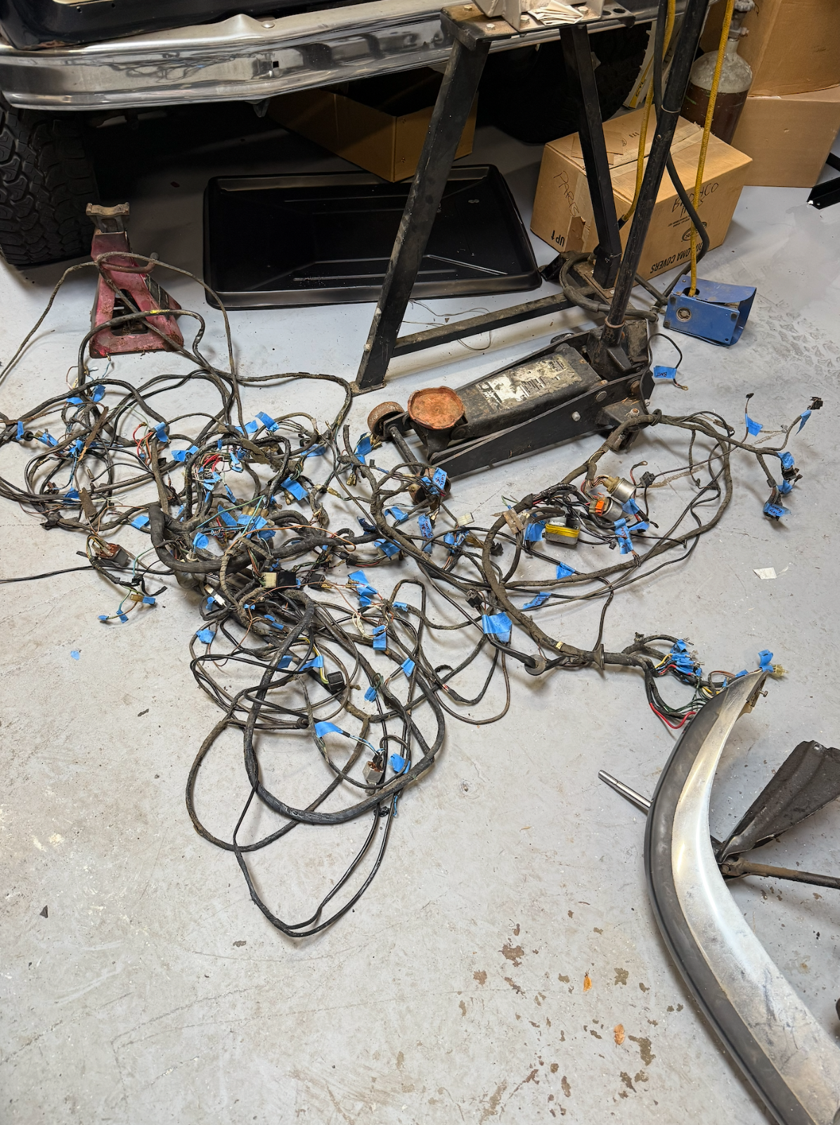

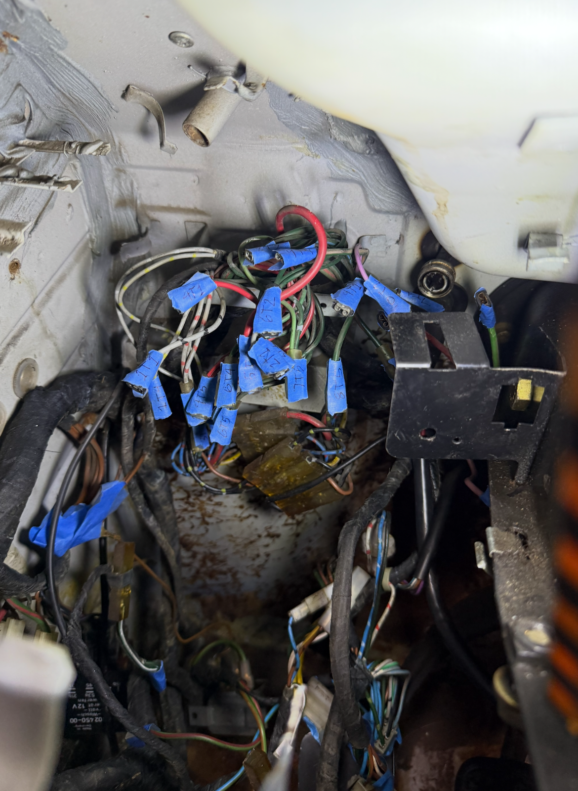

This was a long tedious job that involved labeling every wire I disconnected, and then carefully feeding long sticky and dirty wire bundles through cramped spaces. I made comprehensive notes and took lots of photos. There are numerous bits of odd non-stock wiring up around the fuse box, including spade connectors that are not connected to anything, etc.
Since I am not removing the headliner, I labeled and clipped the wires to the dome light (at the driver's side A-pillar). I'll put a spade connection on that when I re-assemble things
I am replacing the fuse box with one of Galahad's blade fuse units, but I labeled every wire, so when I go to install that I won't have to track down every wire.

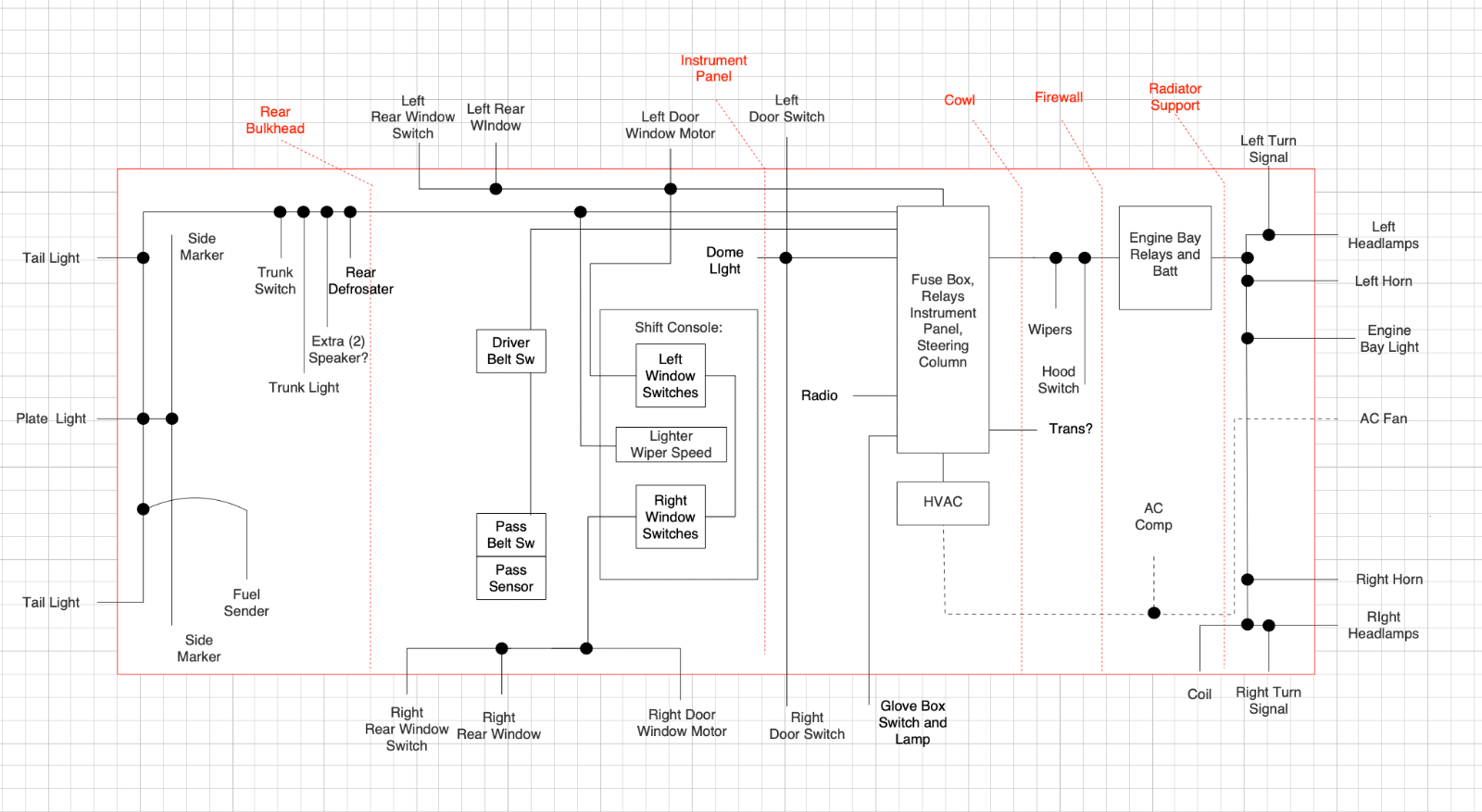

Once the car body is gone I'll lay out the harness on a wood frame in its basic geographic configuration, and start matching the wires with the numbered wires in the wiring diagram. That should help me sort out the non-stock wiring as well as identify a few wires that were not connected to anything.
While this was a big job, and will be a big job to re-install after the big job of replicating it with new wires and connectors, I am glad I did this. The layout makes sense, so re-assembly should be OK, and a new harness will be easier to install. Having the old wiring out will mean the body shop can clean and paint the entire car, inside and out, so a very fresh and clean start to re-assembly.

you can unplug everything in the engine compartment (labeled of course) and pull everything into the interior still hooked up to the fuse box and remove the entire harness. the hole in the firewall is like 30 or 40 mm
It was actually easier to go the other way. Once the wiring under the dash was all disconnected from the fuse box and a couple of spade junctions, the wires pulled through into the engine bay with relative ease. I then just lifted the harness out of the engine bay, relays and all

Some additional detail on my geographic map of the wiring harness. This corrects some of the looms around the console and the instrument panel.
Still need to sort out the details of the IP/fuse box, and the engine bay.
Seems that in addition to the fuse block, there are two cluster connectors (#66 in the diagram), 2 spade connectors (#37 - 5 position, and #40 4-position), and two large connectors (#57 9-pin wiper/indicator, and #59 5-pin Dip switch). There may be a handful of other single spade connectors as well.
Note: this is for a 1972 US Carbureted car.

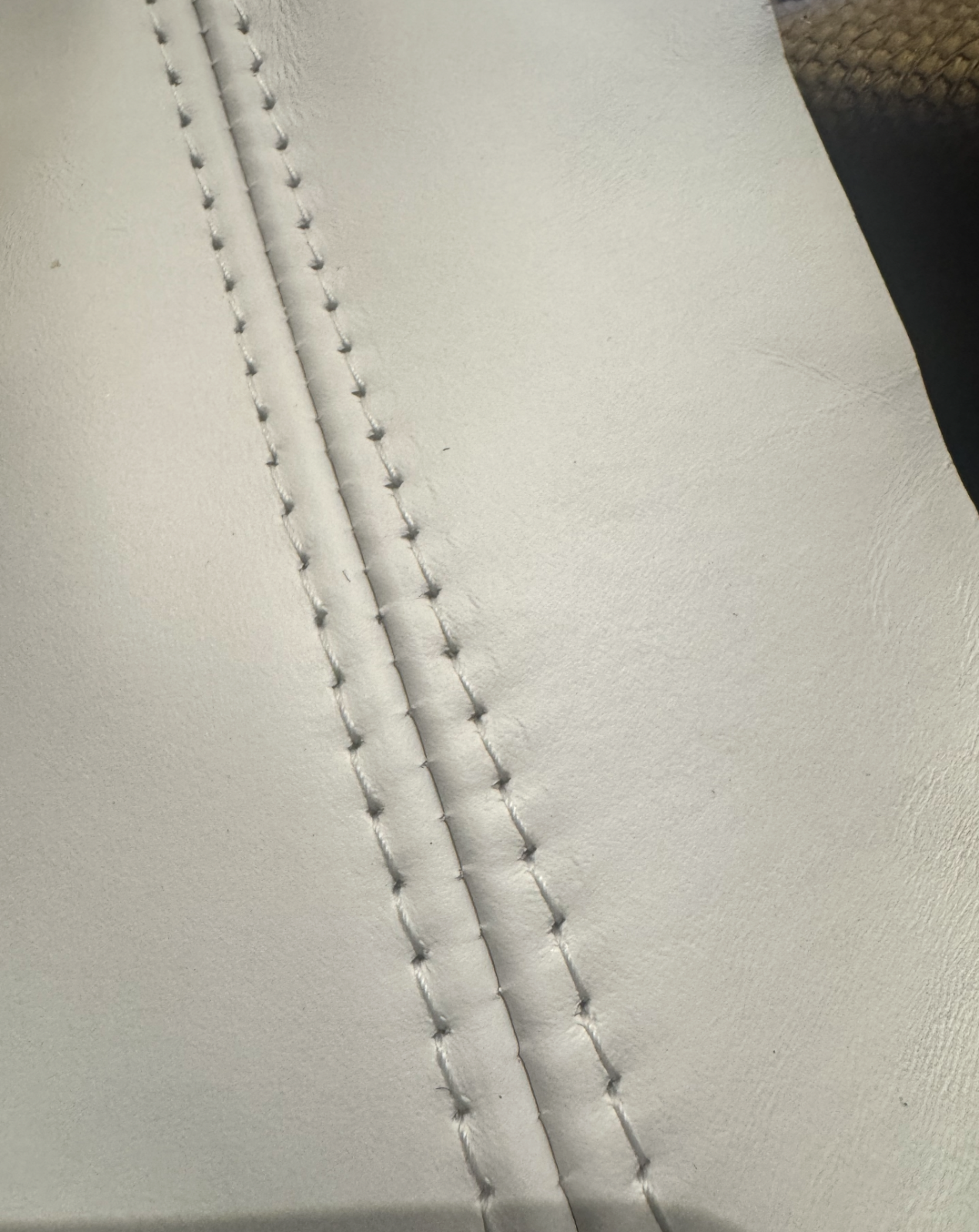

In the meantime Erik at Coupe King sent me a sample of the stitching for my seats. I had the hides drop shipped to them, and they are now restoring the Scheels. The centers will be perforated using a Porsche diagonal grid, and the sides will be solid. So far I have been very pleased with both Coupe King in Wilmington, and Fix Auto Body in Berkeley (Thanks @sfdon for the intro to Eugene!). Both have been super communicative and easy to work with.
