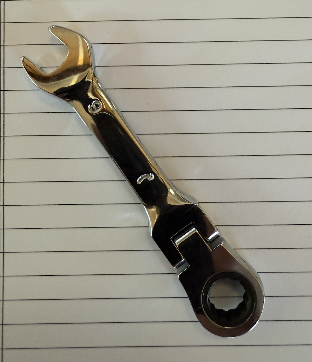

I got all of them except the crazy one behind the door hinge. Of course I have every socket size known to man, but only 5, 6, 7, 8 and 10 mm small combo wrenches, and these are 9mm nuts, 11/32 is too small, and 3/8 too big...:mad:. Ordered a micro ratcheting swivel 9mm wrench.. should come tomorrow.

If there a Harbor Freight near you, they sell a small ratcheting socket set that is phenomenal at getting into these tight corridors. I suspect Gearwrench and others have similar sets, but yes, a mini ratchet with pass through bits for extra low profile is helpful for some of these bolts and nuts. And enjoy that gas flap third nut but yes definitely review the recent gas flap thread, lots of good tips there

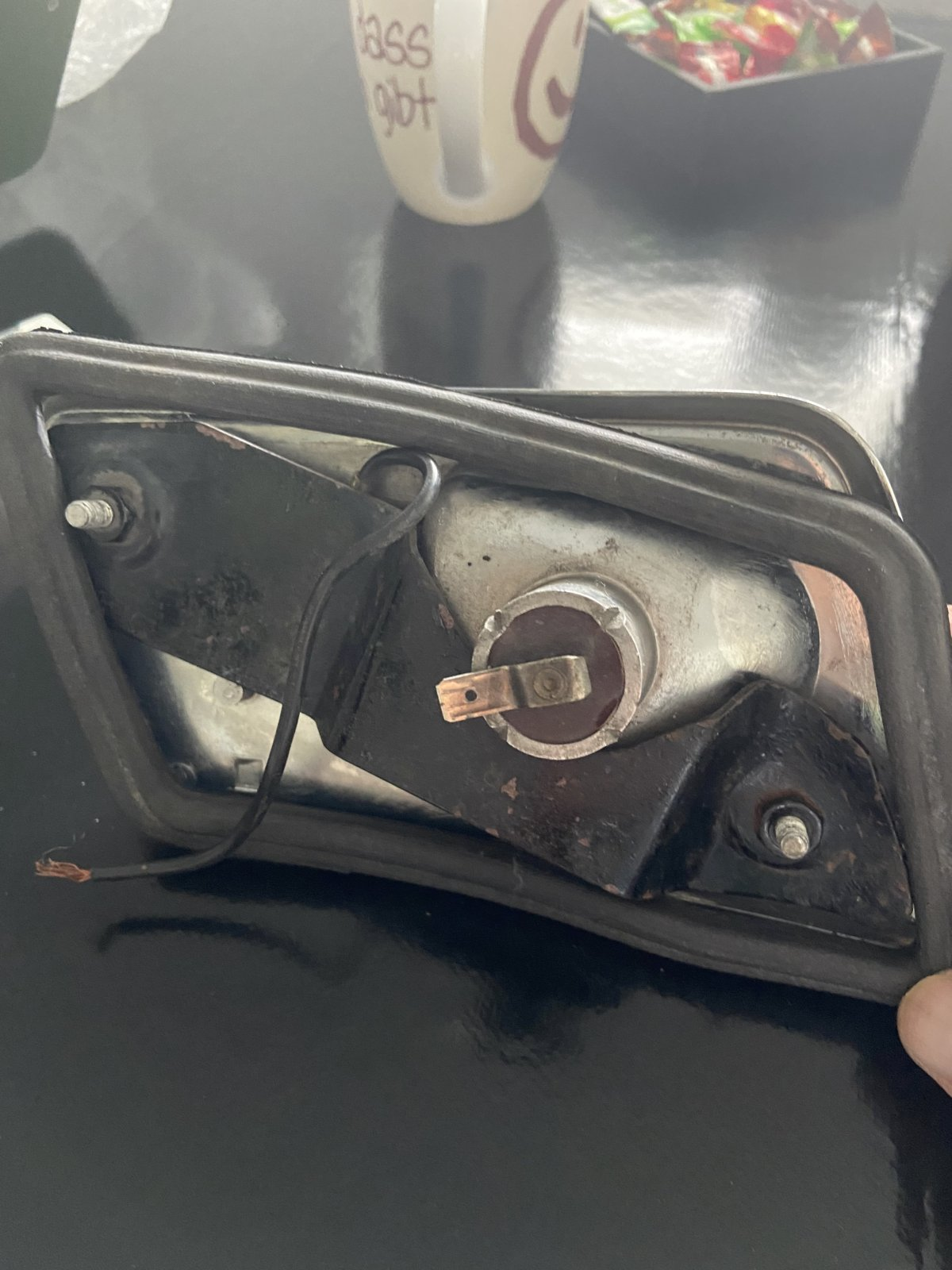

Looking good! I feel like you and I are on similar trajectories with slightly different endpoints - you’re doing whole car, I just did engine bay, but yes, removing everything is a bit of a task. Regarding turn signals, if you’ve removed the screws holding the backing onto the car that should be it. I removed mine to replace one of the rubber surrounds. Perhaps your rubber has just gotten old and sticky and is holding it on there?

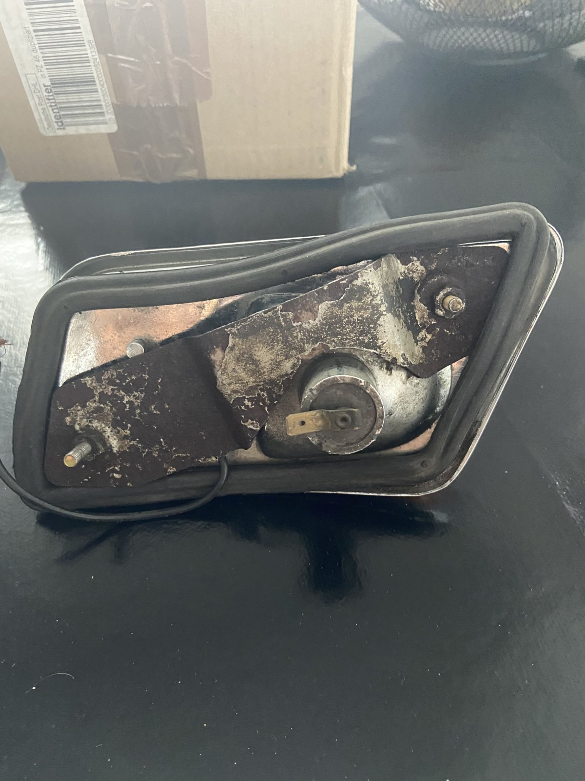

@ScottAndrews : Wrt to the turn signals, here is a pic showing the bracket that resides behind the front fender through which the 2 screws hold the chrome frame in place.
In OEM condition, after removal of the 2 screws, the bracket at the back should fall off (unless waxed / body-schutzed in place) and the chrome housing should come off.
If the housing doesn't come off, it's likely held in place by the rubber grommet that has developed an adhesion to the chrome housing and fender.
Some gentle massaging should set it free.
You can actually access the inside of the fender and that backing bracket when you remove the front grills around the light cluster.

Yep! I had removed the backing plates, but the chrome housing would not move. I used a long large screwdriver and put it between the body and the housing ON THE INSIDE (to avoid buggering up the housing or the body), and twisted it. Sure enough the housing came loose, and I had to peel off the gasket.
All good.

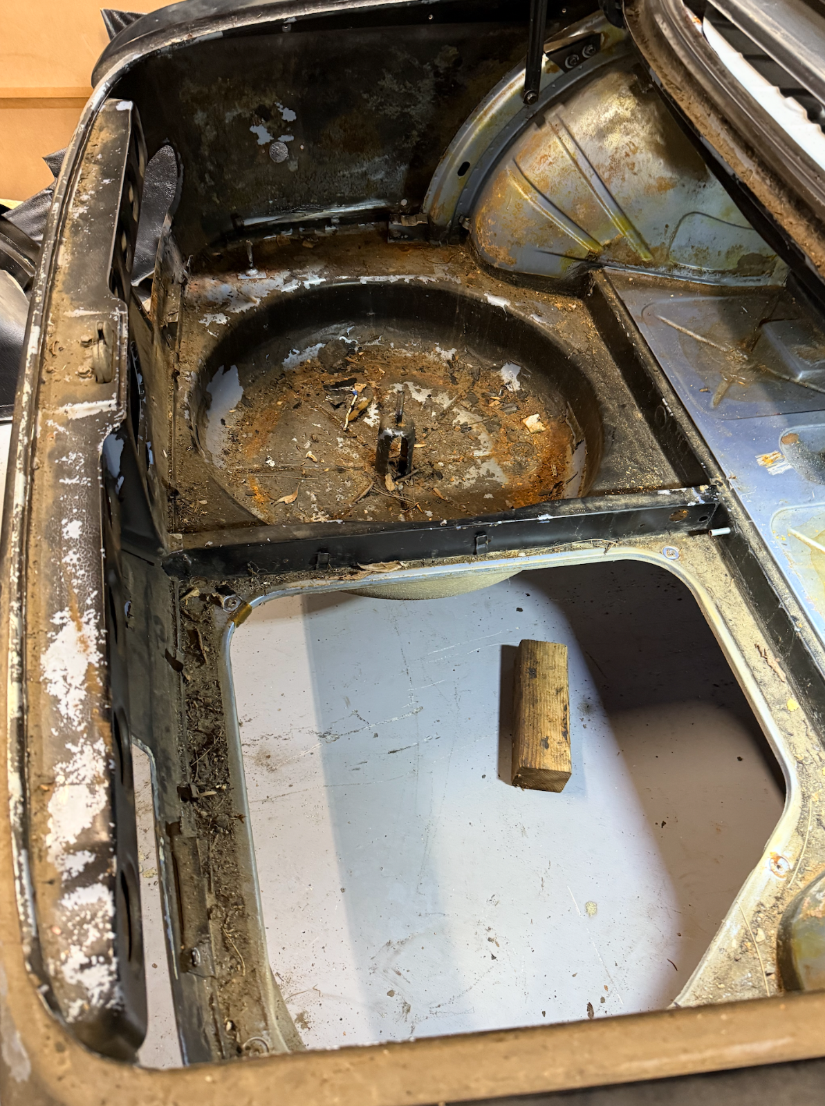

After viewing the hot mess that is my entire trunk, I decided to just go for broke and ordered the various panels from Christoph Bier, and the tool box from W-N.. In for a penny... I'll start collecting tools going forward. I assume there is a list of these somewhere..
All of the elephant skin has been painted black, the various boards are warped and cracked. The lower "floor panels" are missing, etc. I may yet try to salvage and re-paint the plastic wheel house covers, although one of the inboard ones is cracked. Christoph cannot send the floor panels (too big), but he is sending the vinyl, so I'll find some that I can borrow for a template.
As mentioned before, the PO had some sort of massive stereo system going on in the back. Deeeee-luxe particle board panels covered with wooly black cloth, held on, of course, using drywall screws! WTF??!! Good to get that all cleared out - feel like I need to go disinfect myself!
