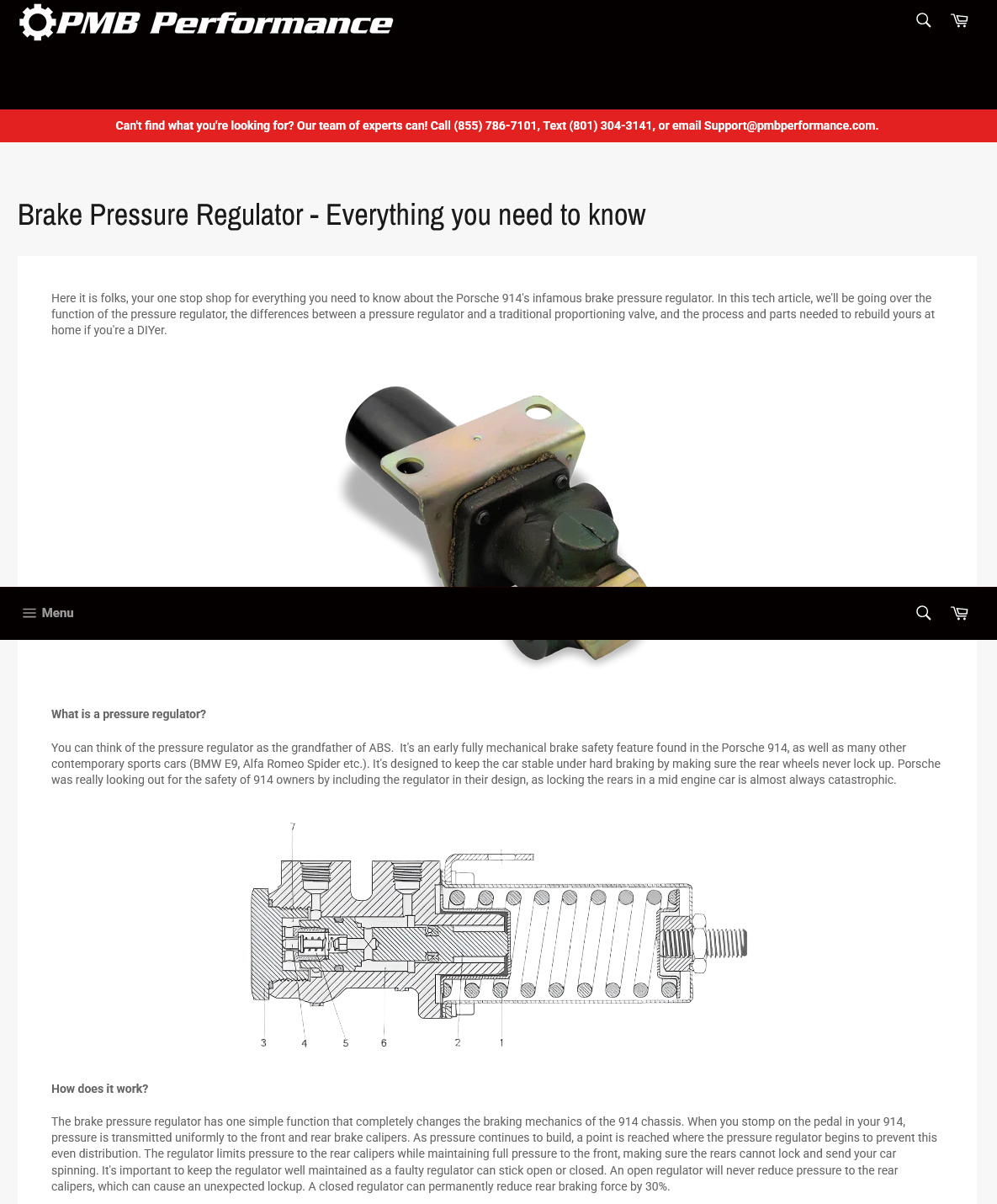

i remember seeing them on pmb's website, as i had it listed in the FAQ top sources. i don't see it shown now. if anybody knows of the part number, please post it here. in the post below there is a link to buying the rebuild kit ... but when you do you get a 404 error message <not found>
they do sell the 914 regulator for 200 bucks
i just found this on PMB's website

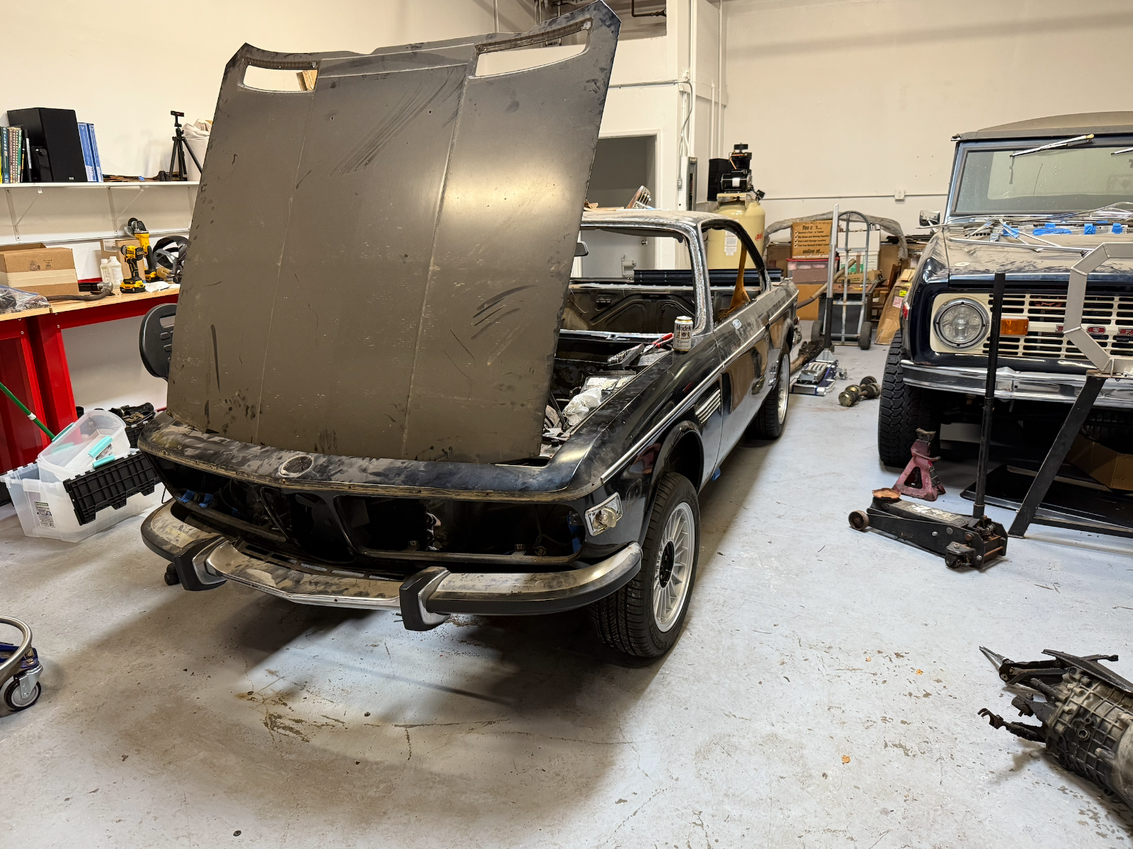

OK. Wife is sick, boat trip postponed, time to work on the car!
Spent some time cleaning up the shop after the saga of removing the trans, driveline, diff and exhaust. Gunk everywhere..
Then I removed the grilles, headlamps, side reflectors, front belt line trim, master cylinder, PS pump, reservoirs, roundel, etc.. Lots of small steps. And amazing how dirty the nooks and crannies of an old car can be!
Tomorrow I'll remove the rest of the belt line trim, the pedal box, booster, etc., to completely empty the engine bay, and pull the fuel tank, and brake calipers.
Currently puzzling over how to remove the front turn signals. I have the lenses off, and the screws out, backing plates out, etc. But the light fixtures themselves seem to be solidly attached. I am a bit reluctant to start jimmying them, since I certainly don't want to crack them, or bugger up the edges.
The current state of affairs. I felt I deserved some of the Amber Elixir after the past few days!
Looking good! I feel like you and I are on similar trajectories with slightly different endpoints - you’re doing whole car, I just did engine bay, but yes, removing everything is a bit of a task. Regarding turn signals, if you’ve removed the screws holding the backing onto the car that should be it. I removed mine to replace one of the rubber surrounds. Perhaps your rubber has just gotten old and sticky and is holding it on there?

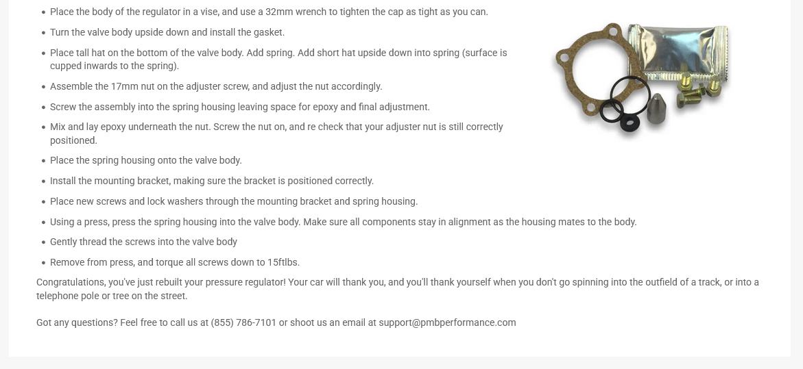

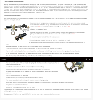

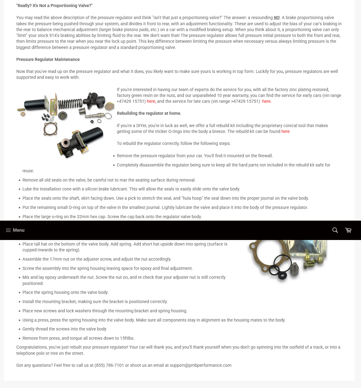

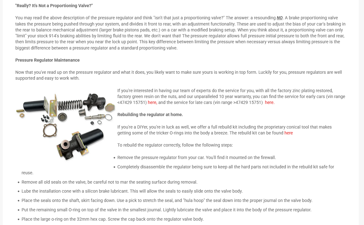

There are rebuild kits available for the valve, the easiest to find is for the Porsche 914, I believe.
Bah, I'm way out of date there. Looks like PMB was perhaps the last to stock the kits for sale. I've not found any others yet online. But PMB does still offer to refurbish the 914 brake proportioning valve for $199 instead of selling the rebuild kit for $59. Previous posters have mentioned that the BMW version is slightly longer and required a little 'tape' modification of the tool to insert the gaskets, but was virtually the same otherwise. I suppose it would be prudent to check that PMB will rebuild your BMW version before sending it off. Here's the link for the repair service.
Isn’t this part from Ireland Engineering the same item? Looks cheaper than even a rebuild as long as you’re ok with not OEM.
That appears to be a proportioning valve, which PMB explains produces a constant proportional reduction in force to the rear at all pressures while the OEM item allows full current pressure of the system to pass until a preset limit is reached beyond which the pressure does not increase because that was determined to be dangerous.
Yes, it could work reasonably well, once calibrated for your car, but isn't as sophisticated as the OEM version.
