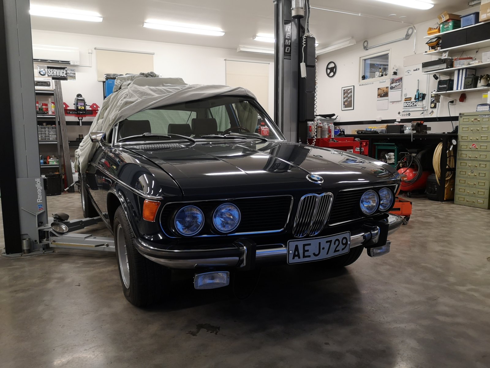

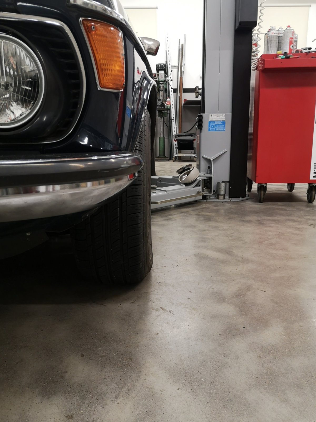

Installed negative camber plates since the positive camber was too obvious in the front.
Camber pretty close to zero after installing the plates:

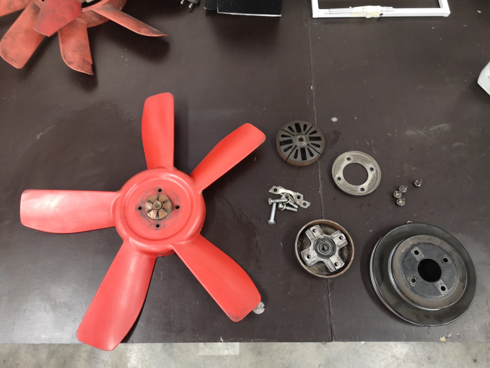

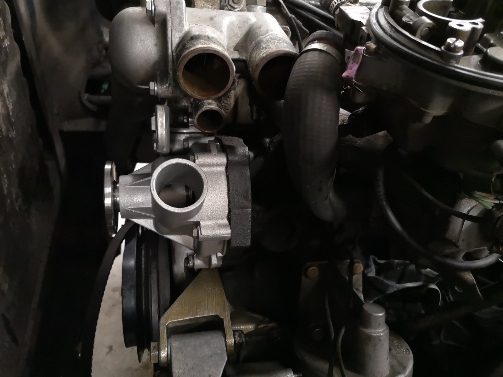

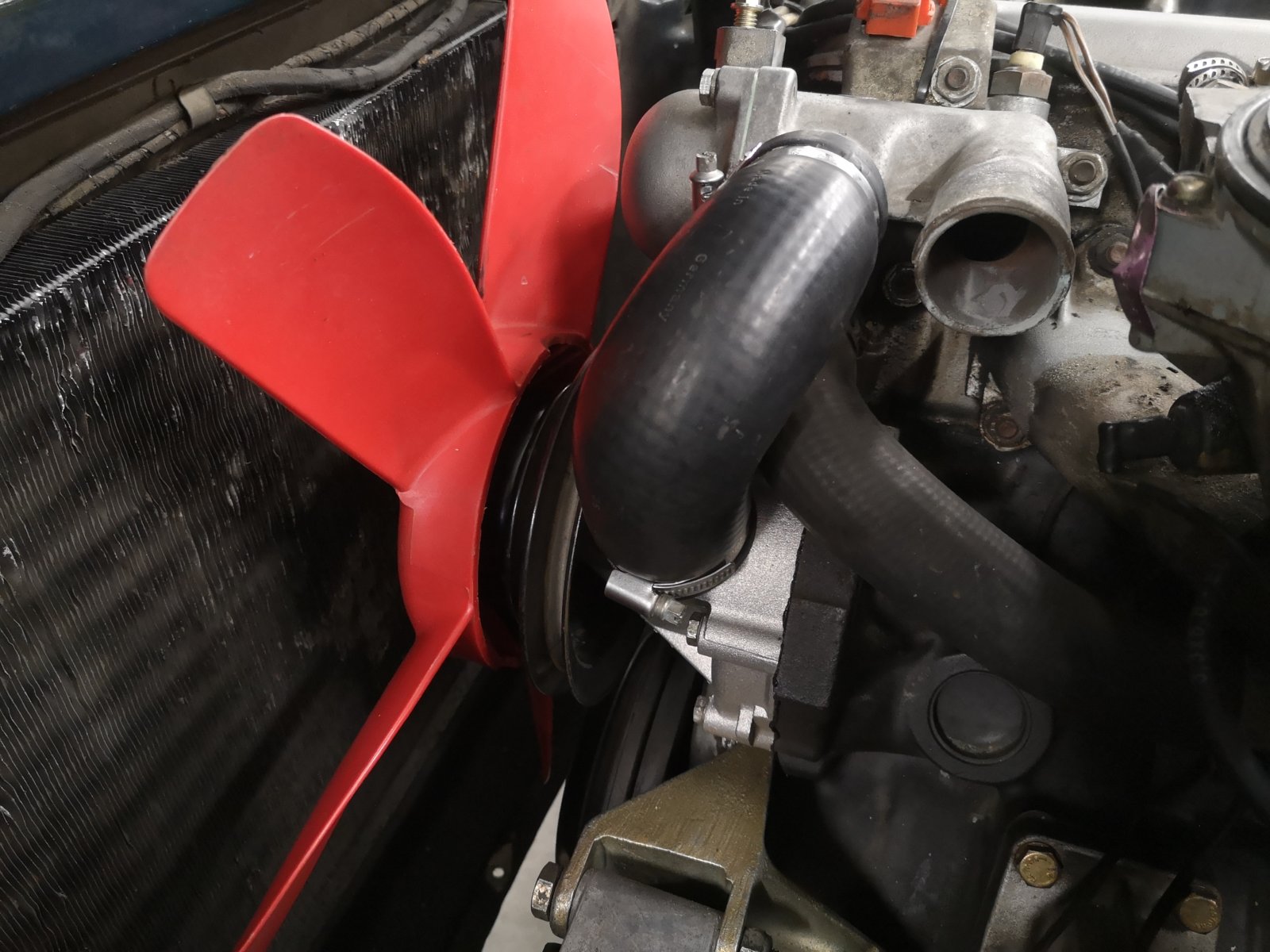

Had some problems with the temp on the warmest days last summer, had the fan locked with a bolt as a shortcut but now we took it all apart.
Put in a spacer for the thermo coupling in the fan clutch so now the fan locks up much better than before.

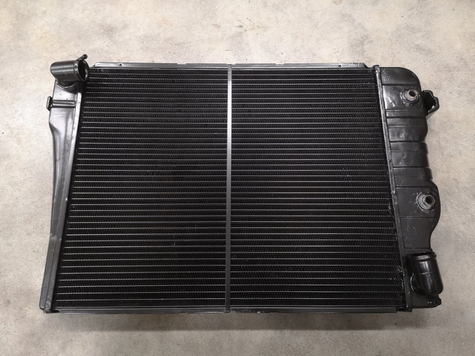

Replaced many of the coolant hoses, all hoses around/under the carbs + new water pump.

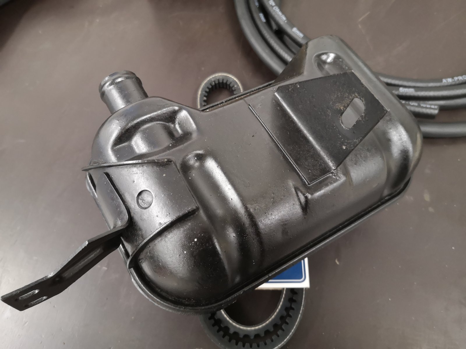

The radiator had two small cracks around each of the automatic gearbox in/out oil cooler connections, so that went to the radiator shop along with the overflow tank which had a loose L-bracket on the bottom.
When the radiator was opened at the shop, they noticed that a big part of the core was full of gunk even if I had tried my best before to flush it out. They were able to clean it all out, so I hope this was a part of the over heating problems.

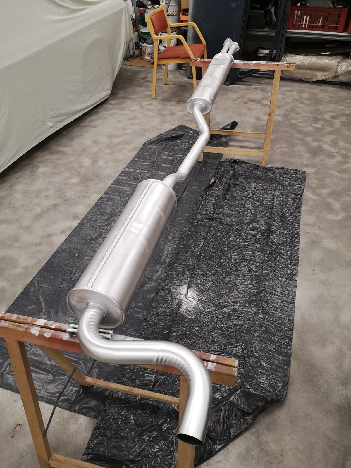

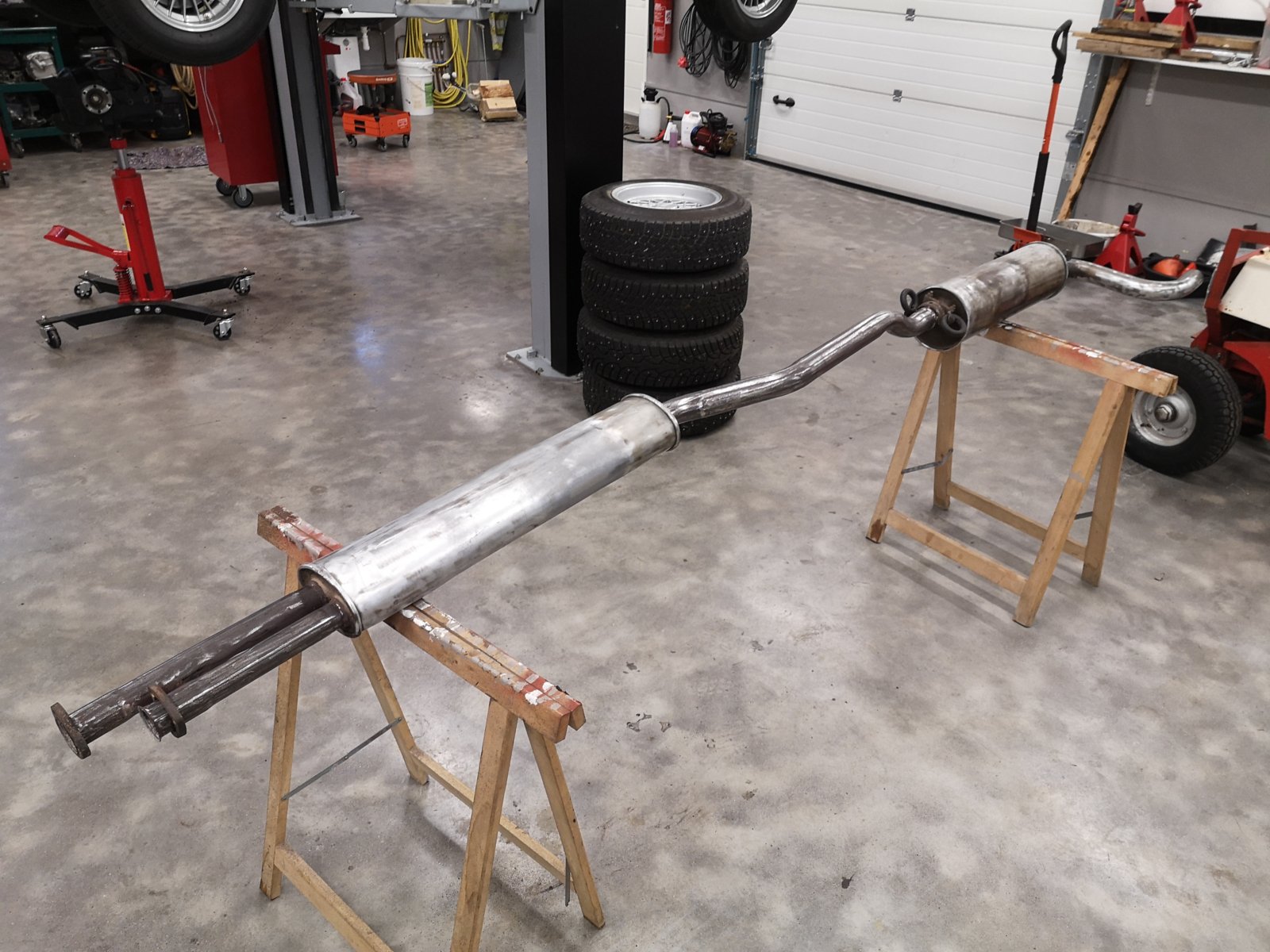

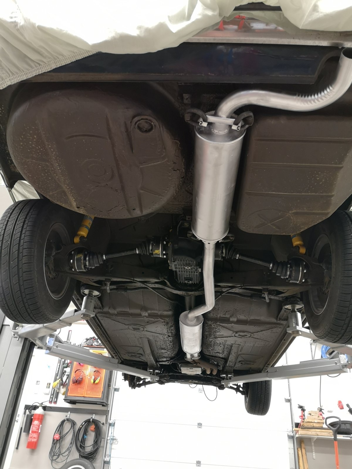

The exhaust was oily, dirty and rusty. Tried to find a stainless solution, but couldn't find anyone who makes one for the e3. It isn't leaking so opted for a quick fix to make it a little bit more presentable.
After several hours of grinding (outside, in -25°C, we don't want to make a mess in the garage, right!):
Paint:

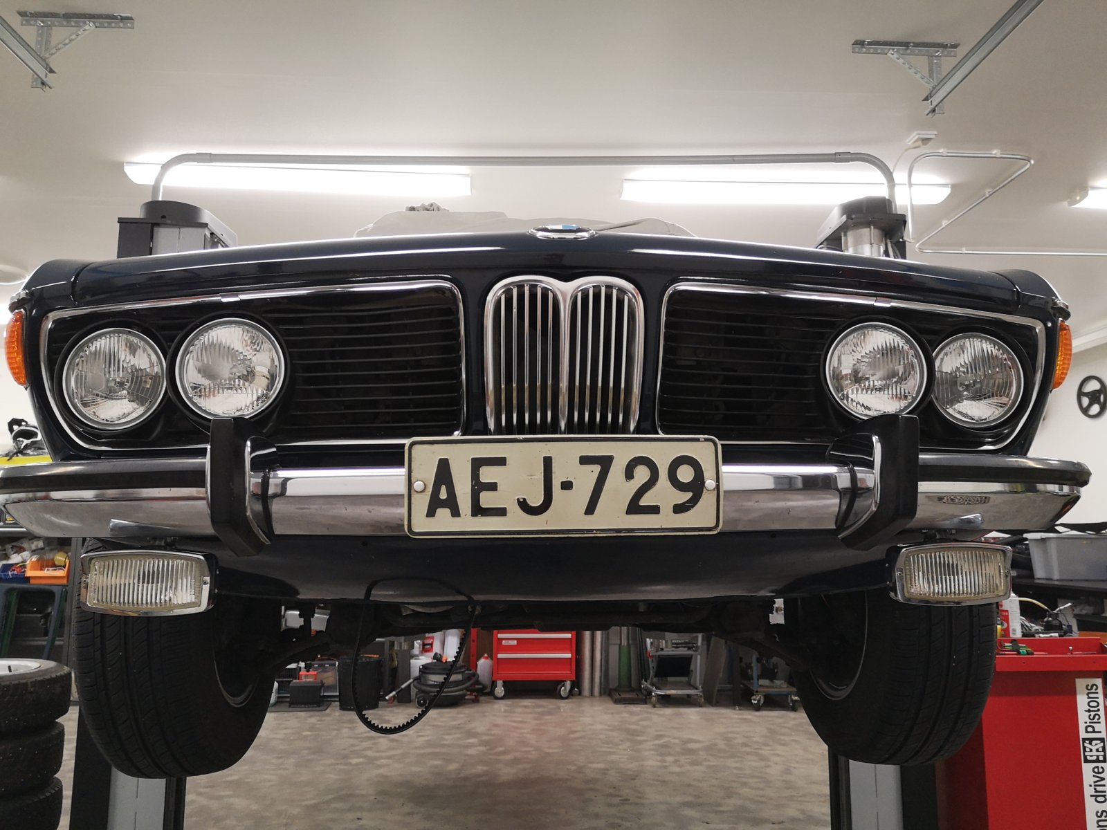

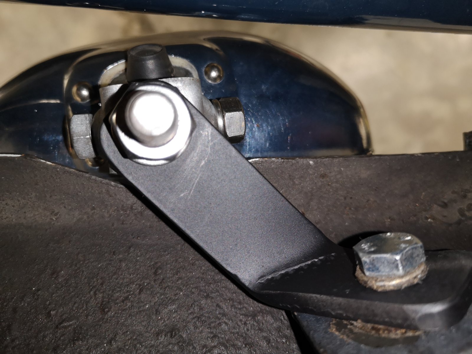

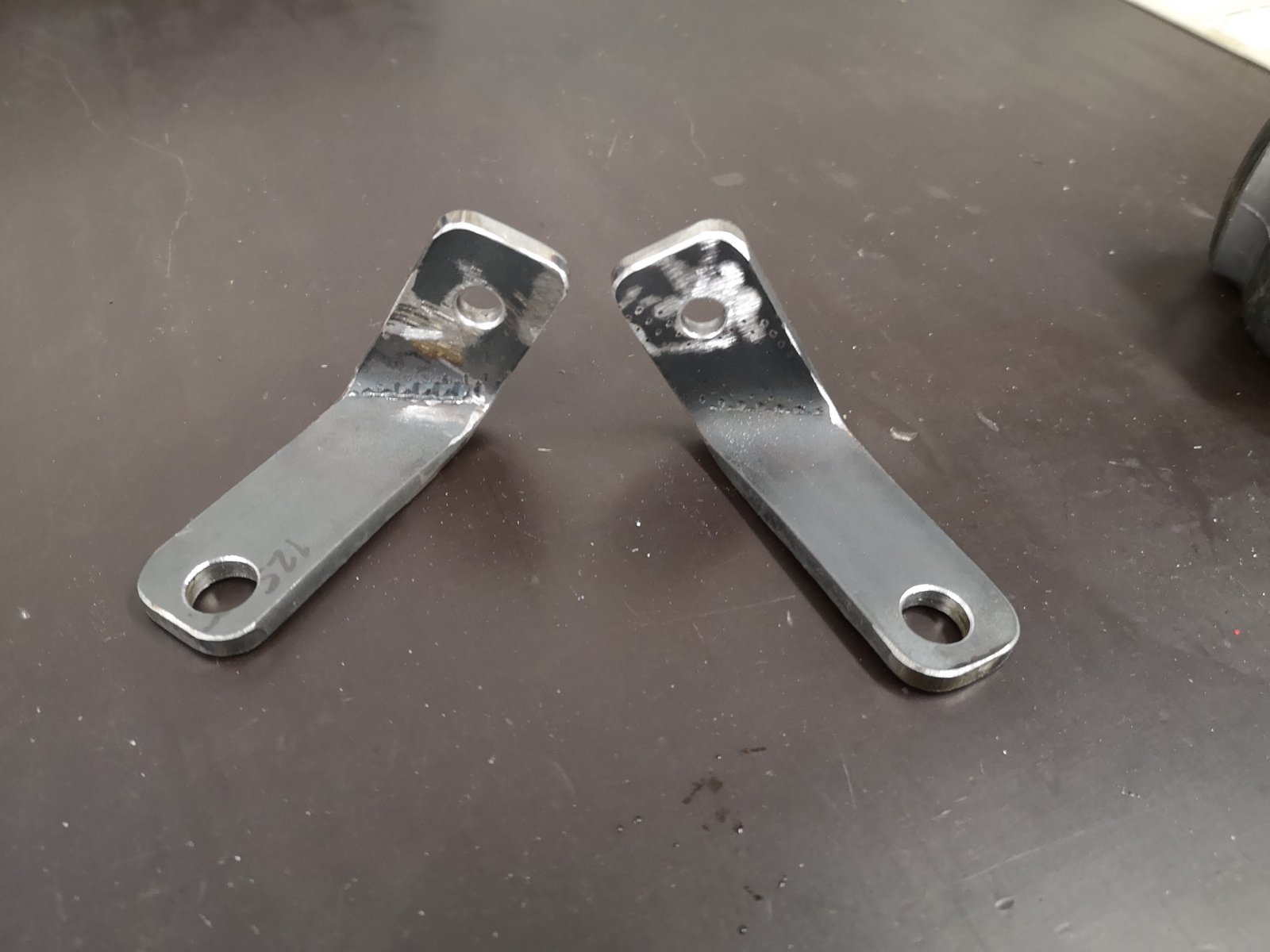

Also made up some brackets for the Hella 139 fog lights and installed them:

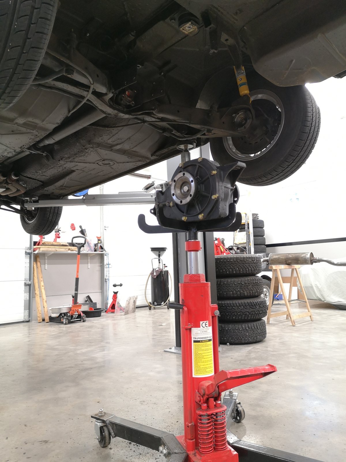

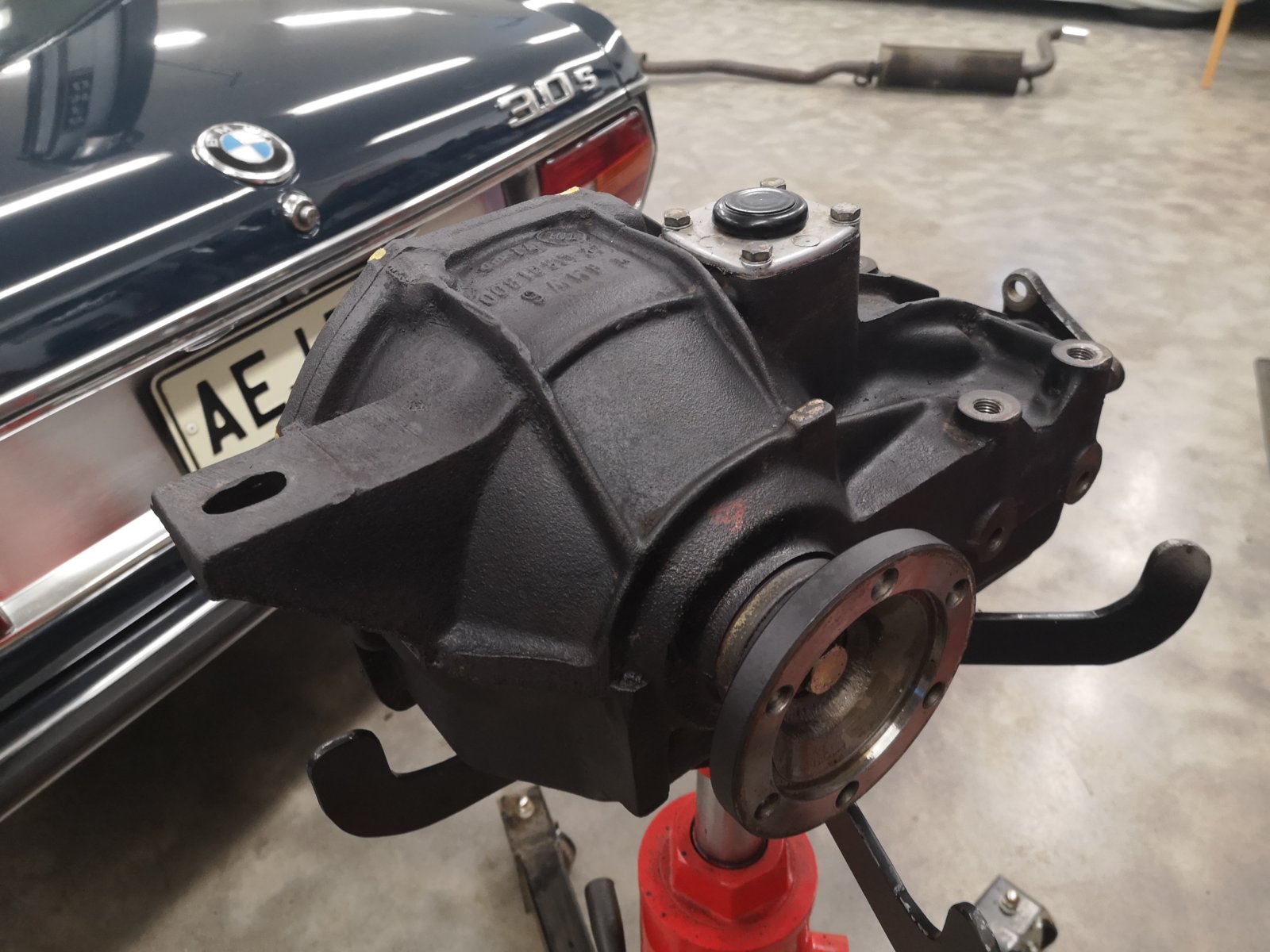

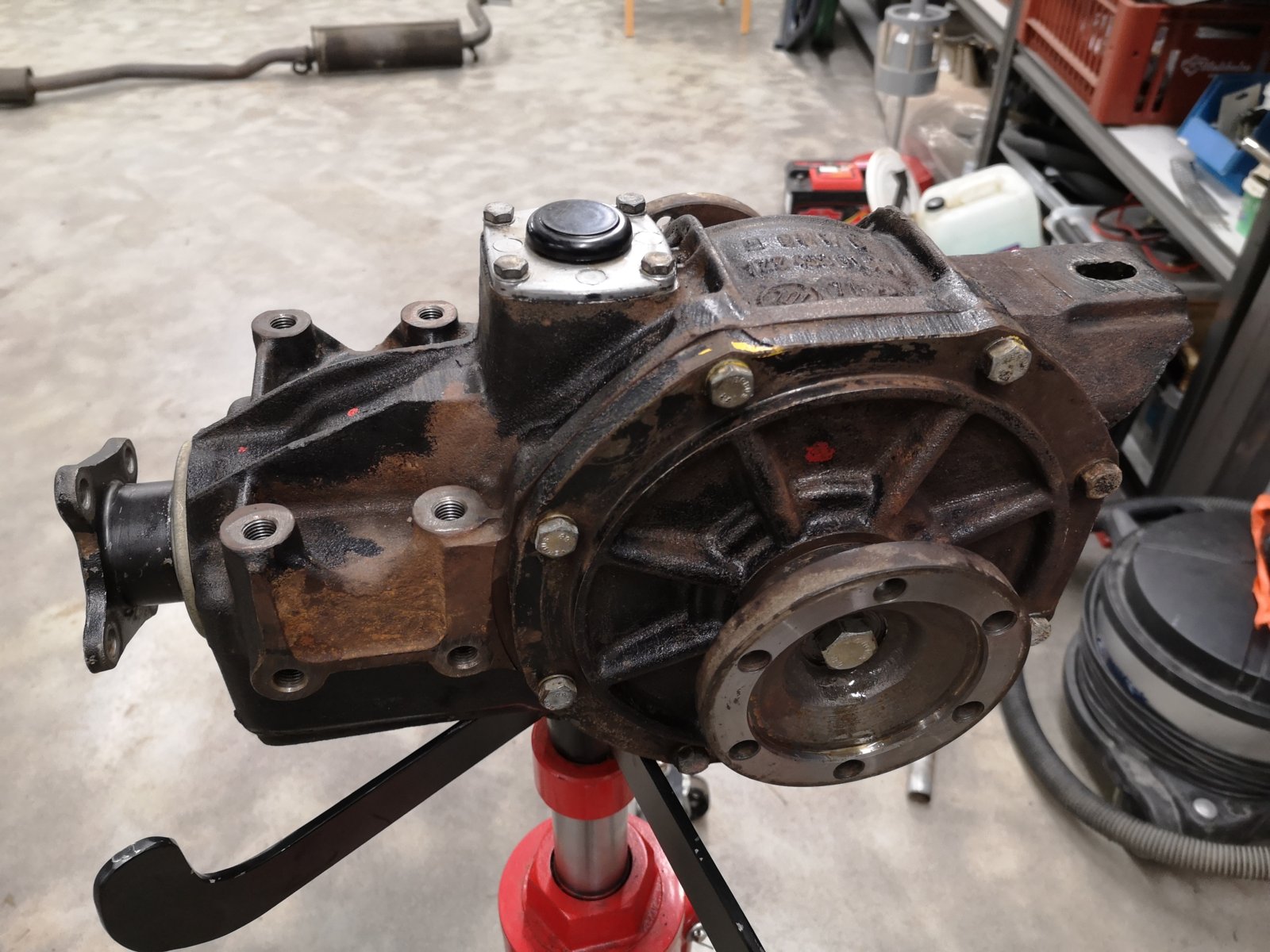

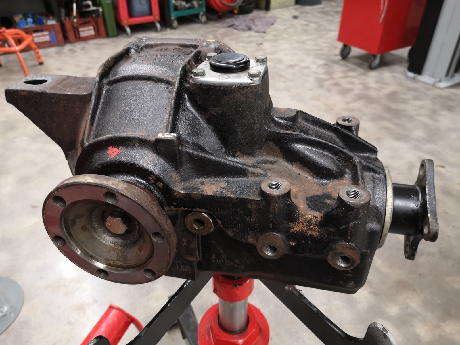

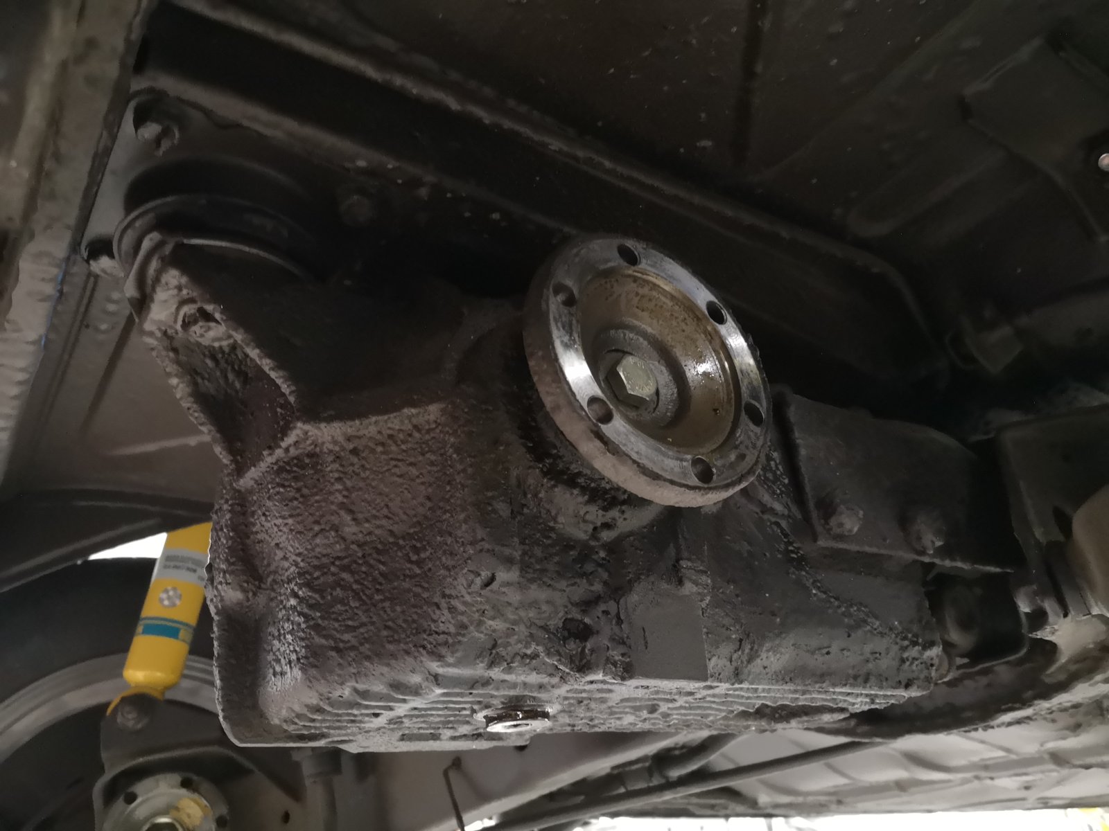

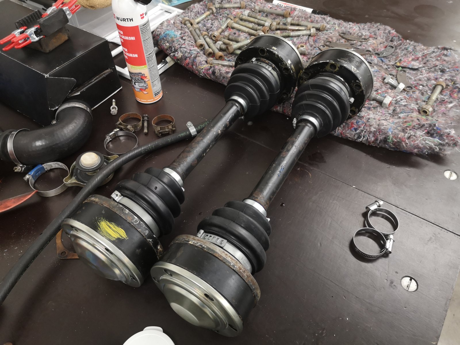

The rear diff was extremely dirty and leaking from all seals, the drive shaft boots were also about to die at any time, so took it all down for a refresh.
After degreasing and new seals:
Some light paint, trying not to overdo it.
New boots and fresh grease:
Going back in:
And done:

Great work! May I ask where you got the camber adjustment plates from? Also have you tried them out since fitting? I guess maybe you’re not driving the car during the winter?
Gransin
1,494
1,239
Vasa, Finland
Thanks!
I bought the plates from ebay, and just as you suspect, I haven't driven it since I installed them.
I have the same plates on the coupe, and they work great for me and my purposes (looks/stance and keeping the wheels away from the front wheel arches)
You need to adjust the toe after installing them.

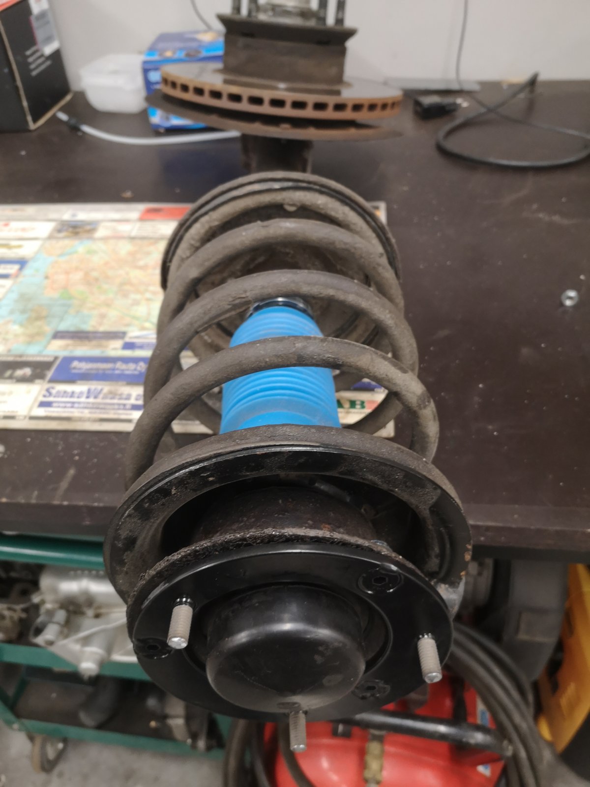

Excellent, thank you. That’s the sort of thing I’m looking for. I’m going to be fitting Bilstein shock absorbers and E12 M535i front springs to my ‘77 3.0Si.

Looking awesome. The cooling issue I had with mine was similar to yours and it also ended up being the radiator.
