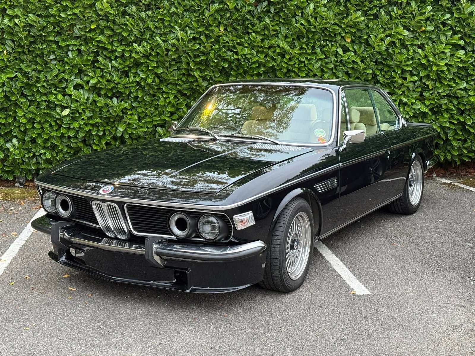

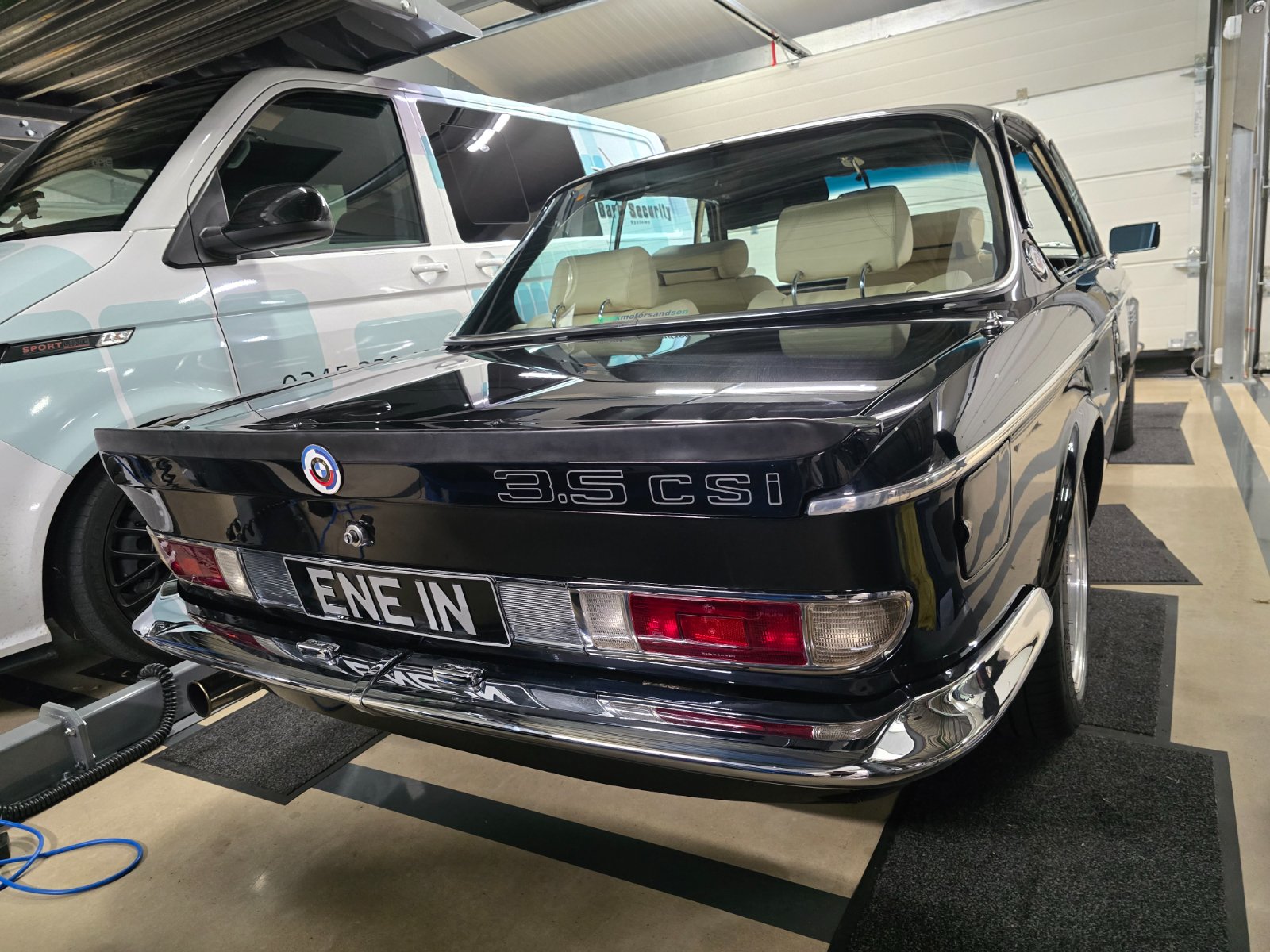

'73 3.0CS - M88 Jerez Schwarz build

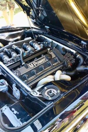

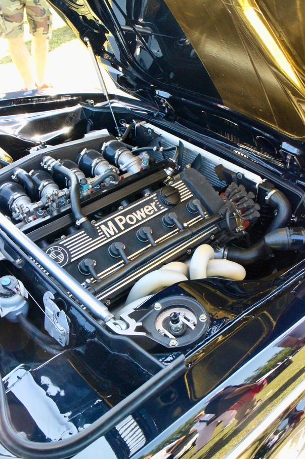

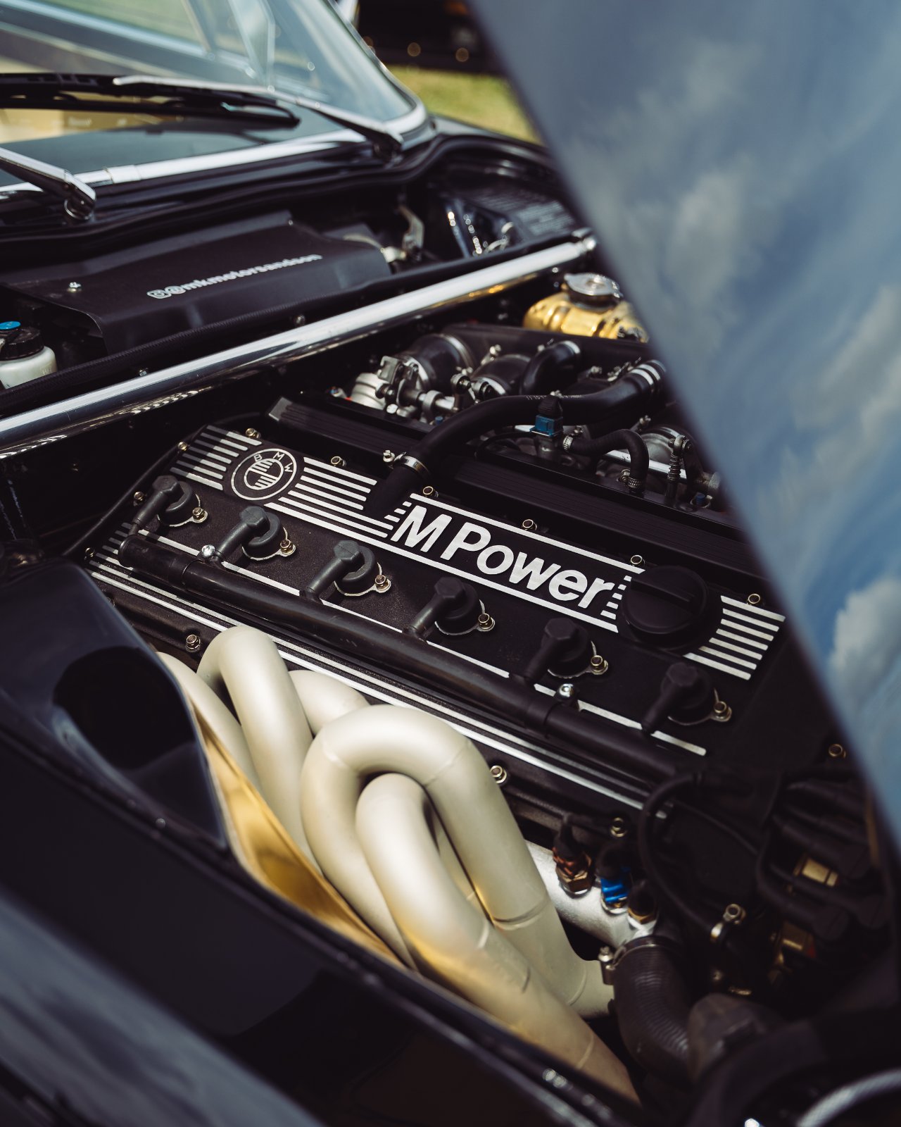

A few shots from Bespoke show, great turn out and came away with the People's Choice award!

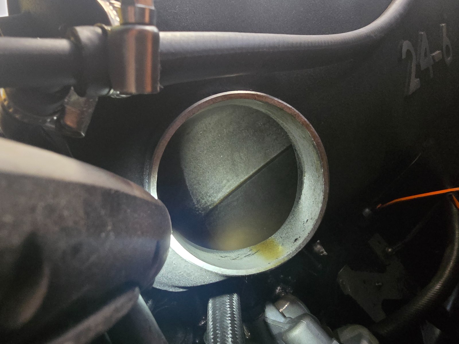

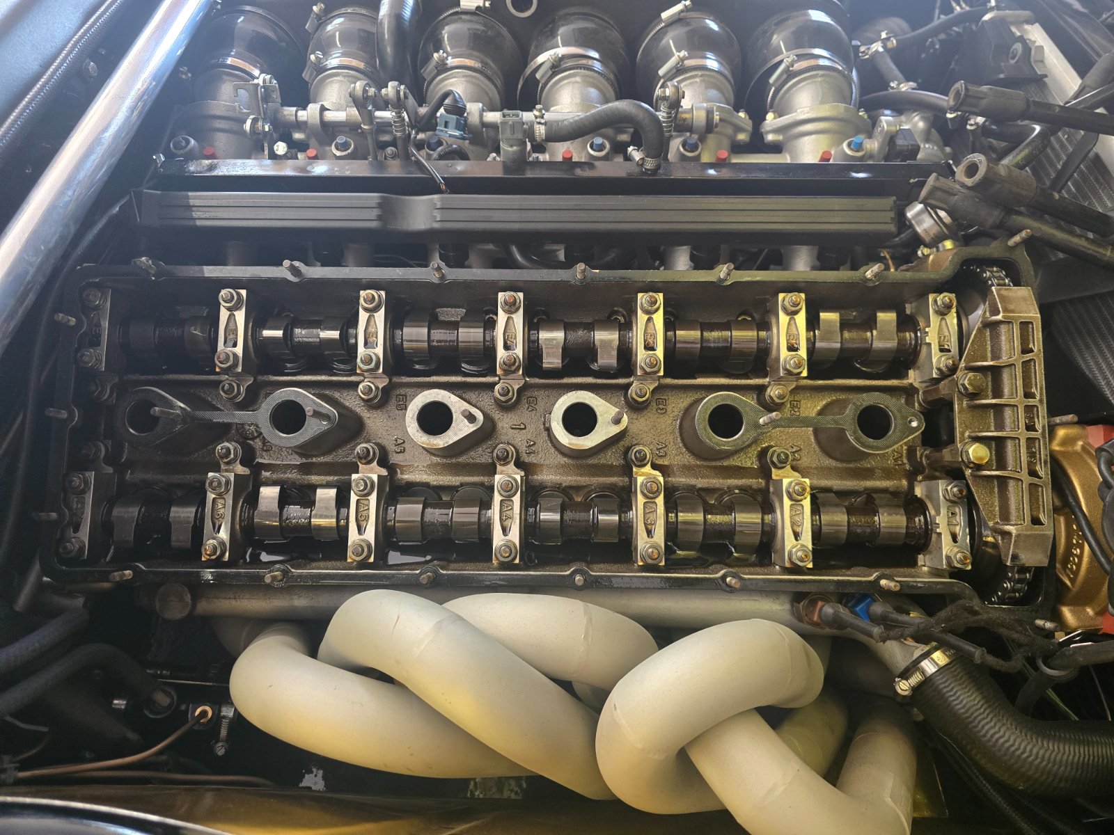

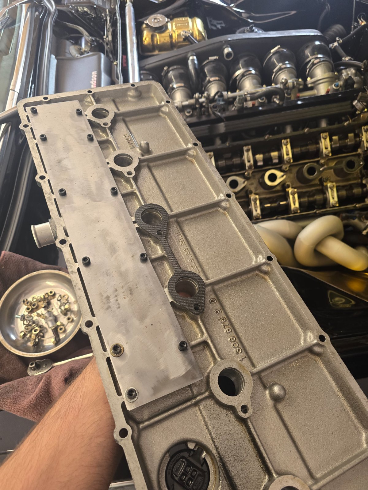

So lately I've been having an odd issue with the car driving absolutely great, no smoke or leaks but using a LOT of oil. Probably 500ml every 250 miles. After about 600 miles of driving every 100 miles or so was getting a james bond esque smoke screen for a few seconds, driving back yesterday from storage to look into it, happened twice in the space of 20 miles. No smoke on start up and very random smoke didn't have me thinking it was anything major although when I pulled the breather pipe off whilst running I was met with oil spitting everywhere and a lot of pressure!
Pulled the AFM to reveal a secondary oil sump in the plenum, extracted over 1.5L of oil!
Turns out the problem was remarkably simple. A missing breather cover plate on the rocker cover from when it was restored but never refitted so the cam was throwing oil up and into the breather pipe. I over looked this when I purchased the engine. Quickly fabricated one out of steel plate and threadlocked the bolts in. Cleaned up the plenum, refitted the rocker cover and all is well!

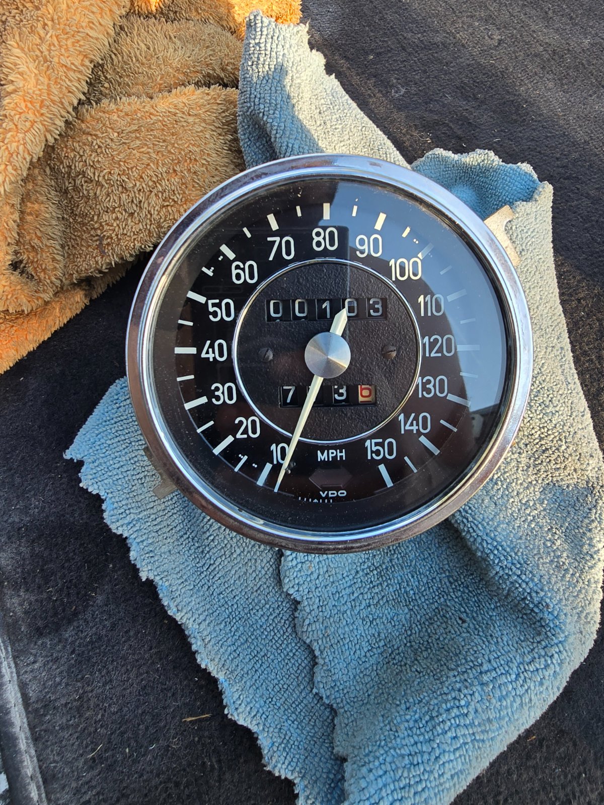

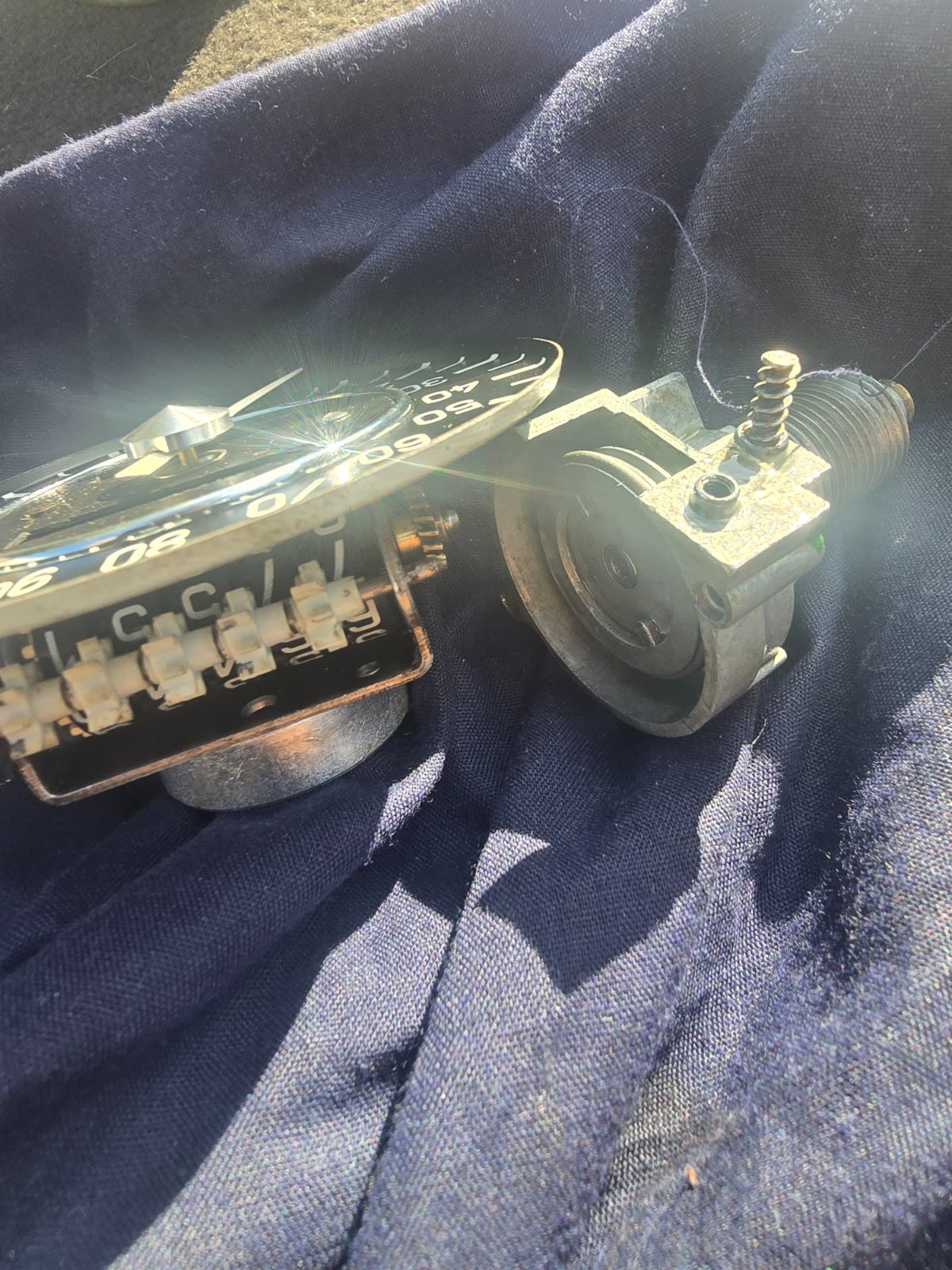

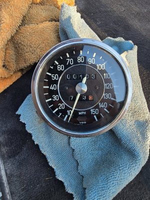

Next issue, the case of the snapping speedo cable! Original blew after approx 500 miles but looked like it had been welded up at some point. Stuck another on which failed after 70 miles.
Upon removing the cluster I found this time the speedometer was actually stuck. Managed to free it off but was still very stiff.conpared to my spare cluster there was no play on the drive mechanism and it was binding against the casing. Stripped it apart and cleaned and regreased it all. A bit of jiggling and persuasion and it now has the same free play and is nice and working freely. Time will tell if this works! Also took the opportunity to clean and polish up all the cluster glass

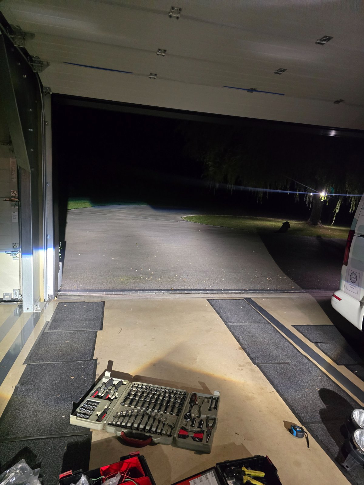

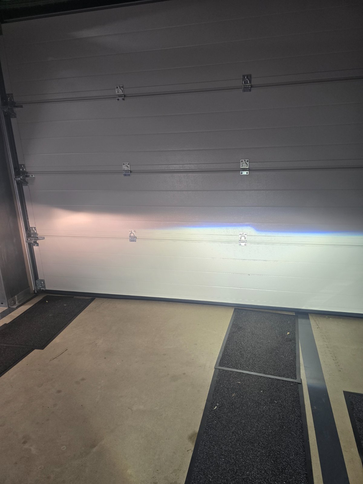

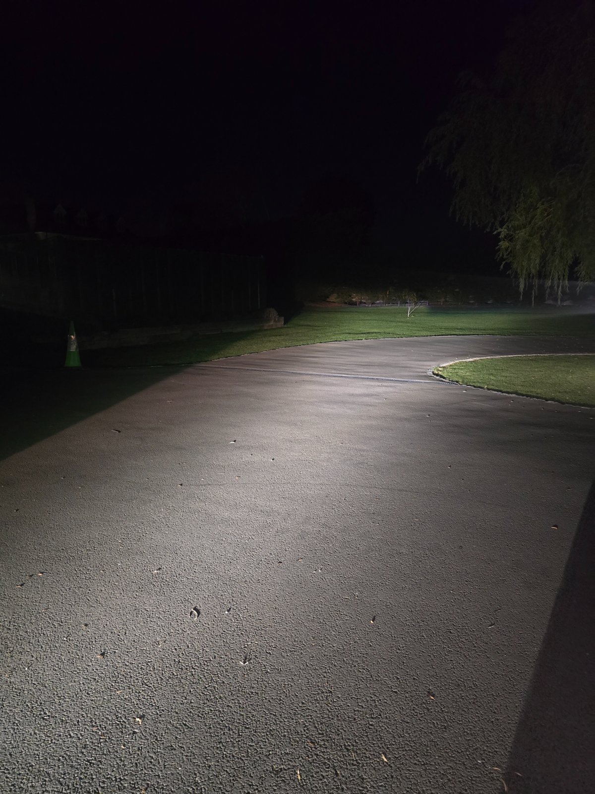

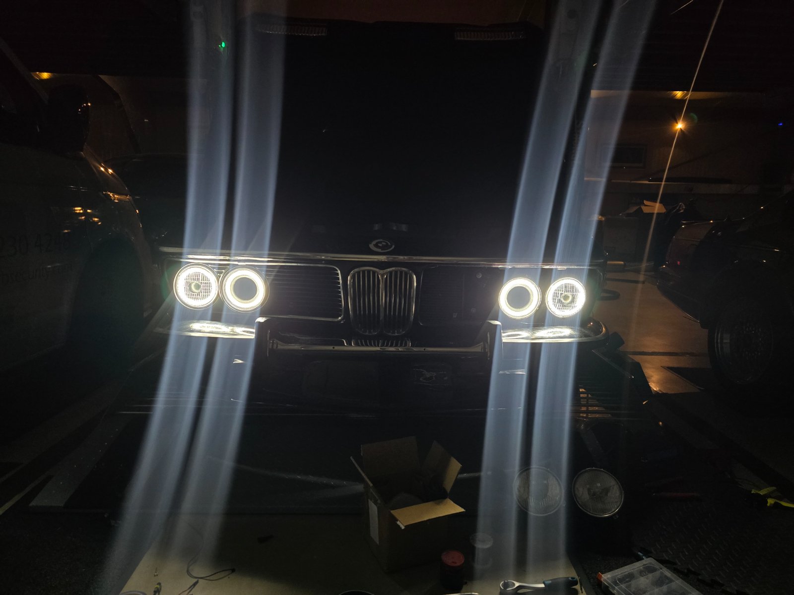

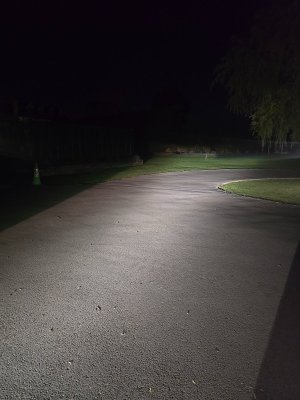

Not much to report, have been using and enjoying her although lighting was an issue.
These definitely wont be to everyones taste but a bit of a test and the price i got them for i couldn't complain.

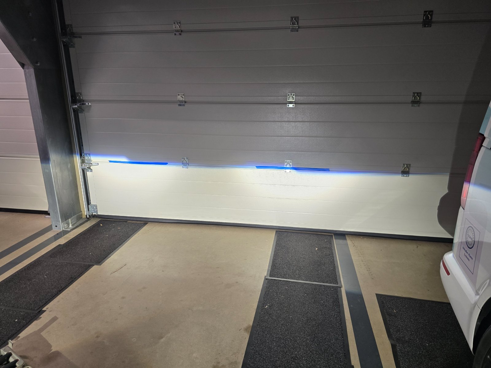

Modern BI-LED projectors with proper cut offs, really nicely made die cast aluminium housings. Sidelights are halo rings which also double up as side repeaters. I have had 4 occasions where people in the dark havent seen me and changed lanes causing me to have to brake hard to avoid accidents. Absolutely transformed the lighting, I had osram nightbreakers with new hella lights and relayed wiring harness so as good as it could get stock.
Undecided yet on the headlight intakes. I may swap them out for the same as the outer lights but lhd beam pattern so when driving on continent I can switch beam patterns to not blind oncoming traffic.

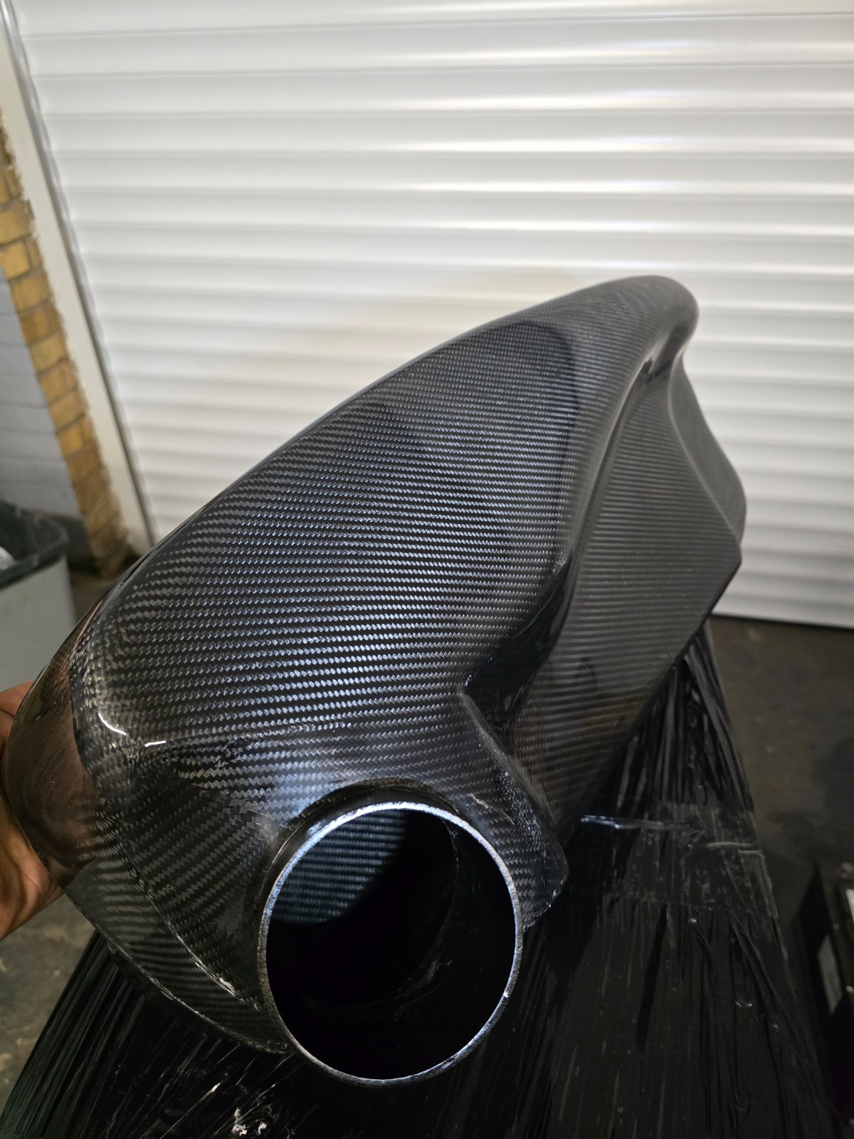

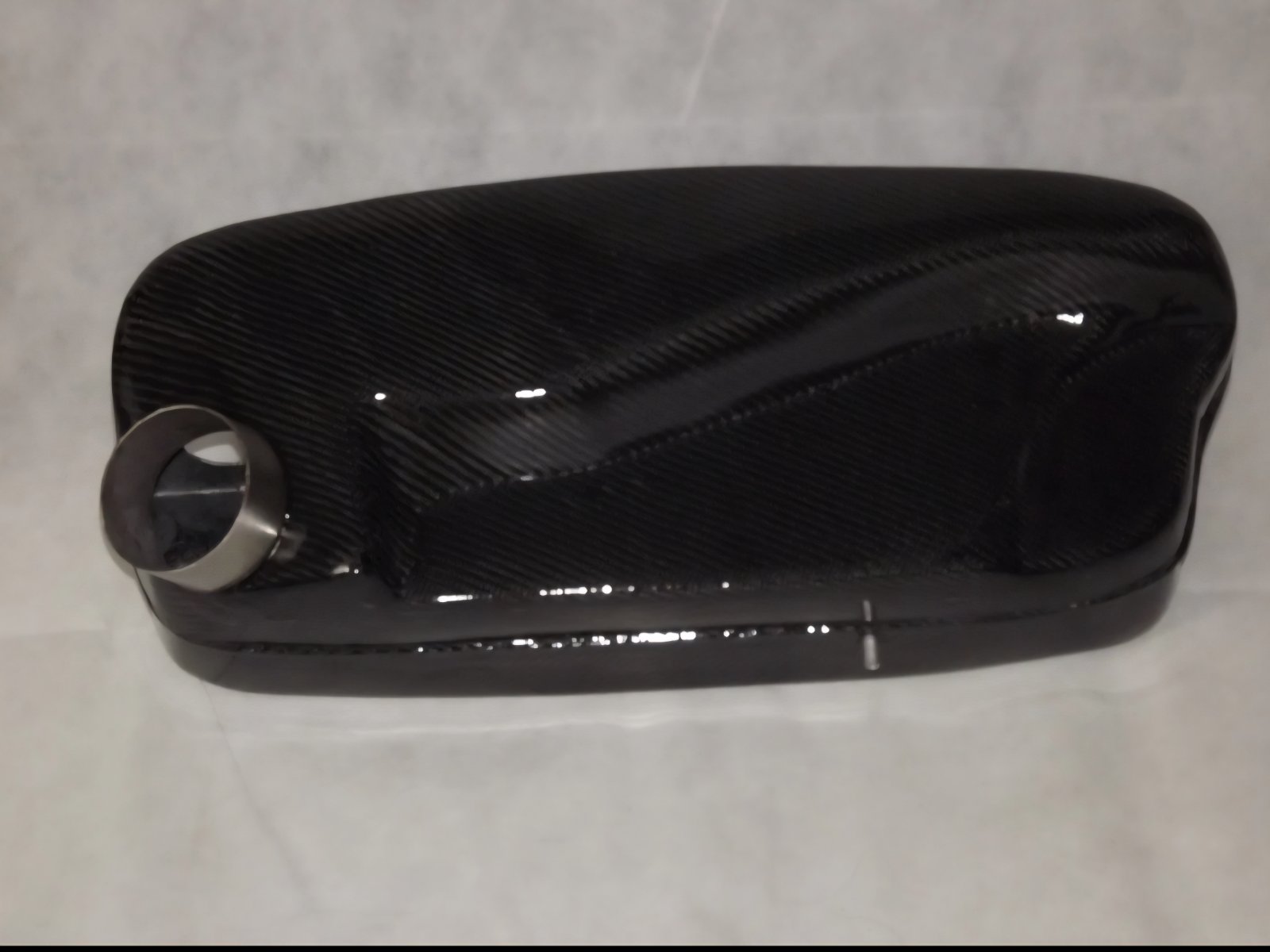

Plenum arrived today so flatted and polished it up, cleaned up a bit, still some more to do!
Tuning shop now has all the parts to go on as well. Emerald make an adaptor to the motronic harness for a true plug and play system. Waiting now on a larger induction kit as going from 3" to 3.5" to hopefully flow better. Going to be dropping the car off just after New Year!
Dry carbon. Beautiful. Which original part is that molded from, or is it a new design?
From a company in Germany
They make various BMW plenums, this is slightly larger in volume to a stock M88 plenum although they do have a larger one. I went for the one with indentation so it has room for the header tank.

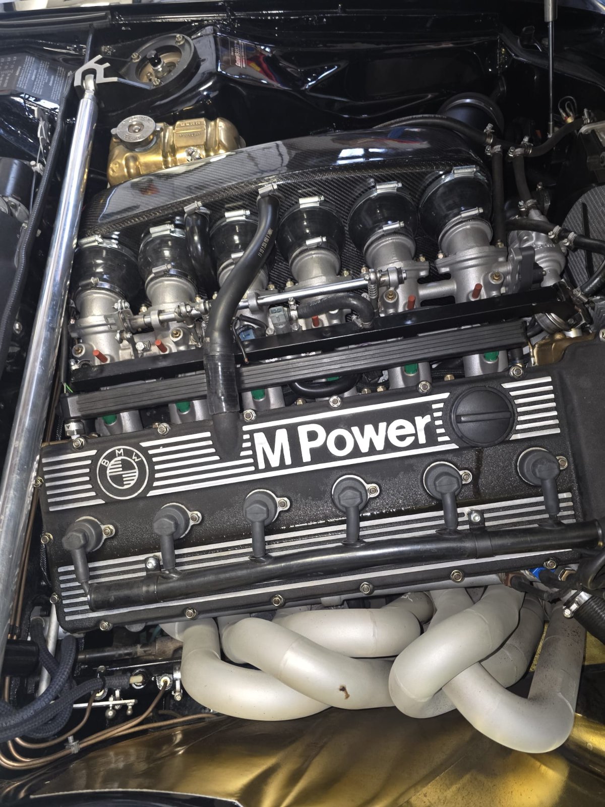

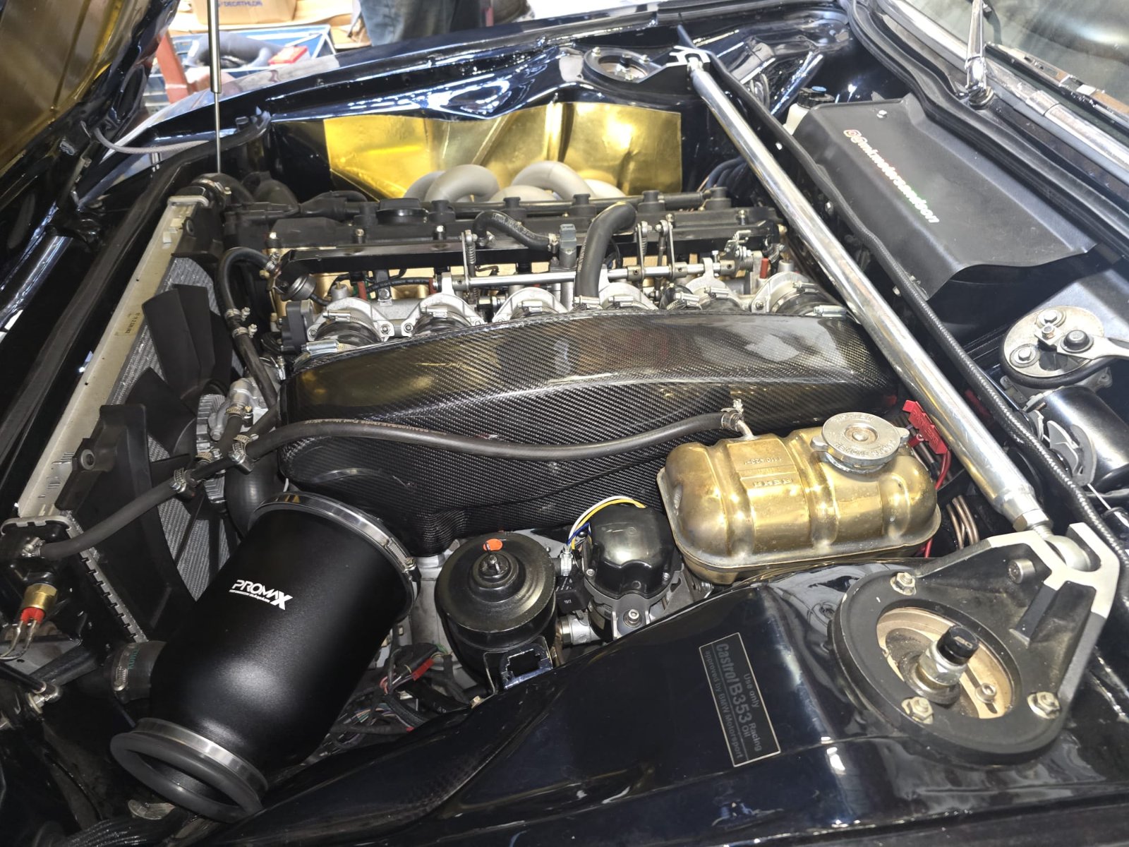

Emerald ECU in along with new injectors and the carbon airbox and larger intake. A modern TPS now on there for Alpha-N mapping and completely eliminating AFM or MAF. Wideband o2 sensor is also installed so should help the engine run far more optimally.
Even on base map car runs much better with the flat spot and stumble around 1500rpm has gone. Throttle bodies were then set up and vacuum matched. Needs a bracket made up for full throttle stop as currently it is inconsistent. Also the idle bypass screw is seized so need to work a solution out for dropping the idle as a touch high at 1200 rpm.
Once done can then go onto the dyno for mapping hopefully by the end of the week!

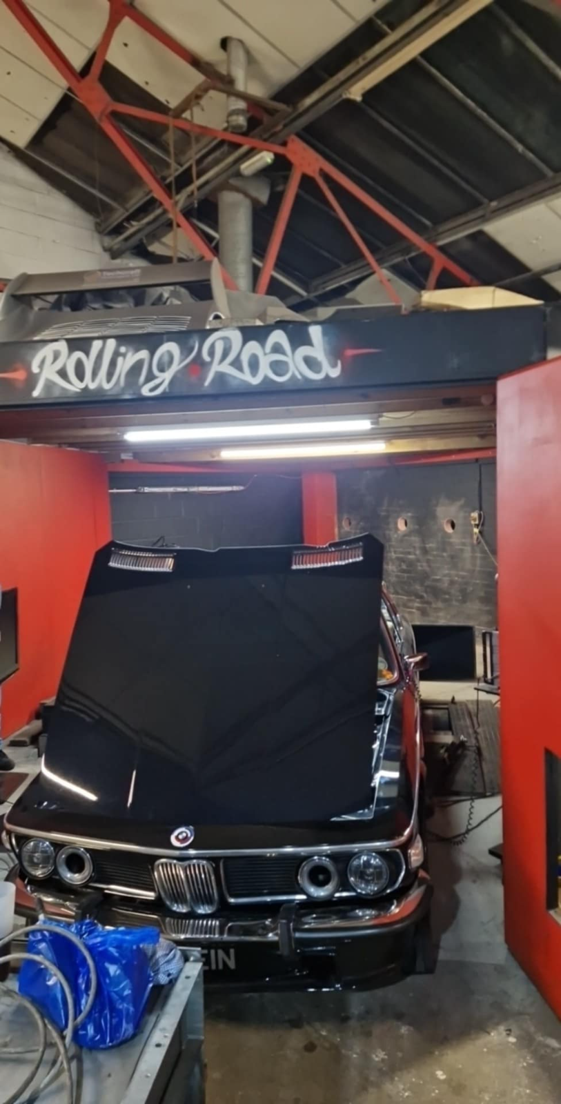

318bhp at approx 6100 rpm
Will wait for the proper print out but peak torque a touch over 300ft lbs so a good 20% increase on stock figures, but most importantly that is across the board so i have the same peak torque as a stock lump 1000rpm sooner which is exactly what i was after.
Considering the only mods are exhaust, plenum and air flow meter i would say that is good going. Really wakes up at 4000rpm when it comes on cam.
If I went coil on plug could run a bit more timing and nudge past 330 but it's a bit much for me to do now and I am happy with that.
