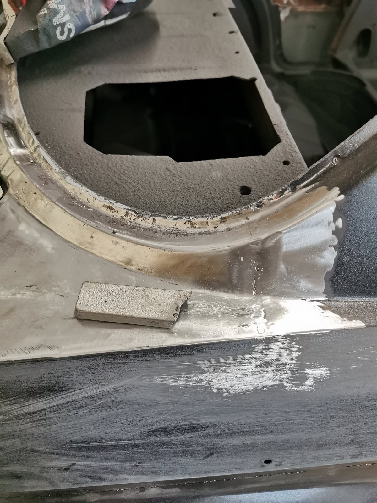

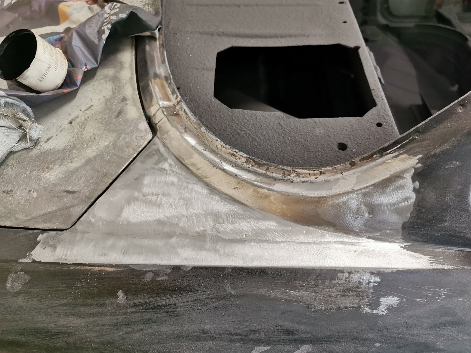

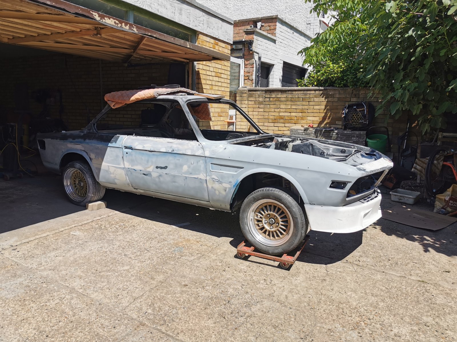

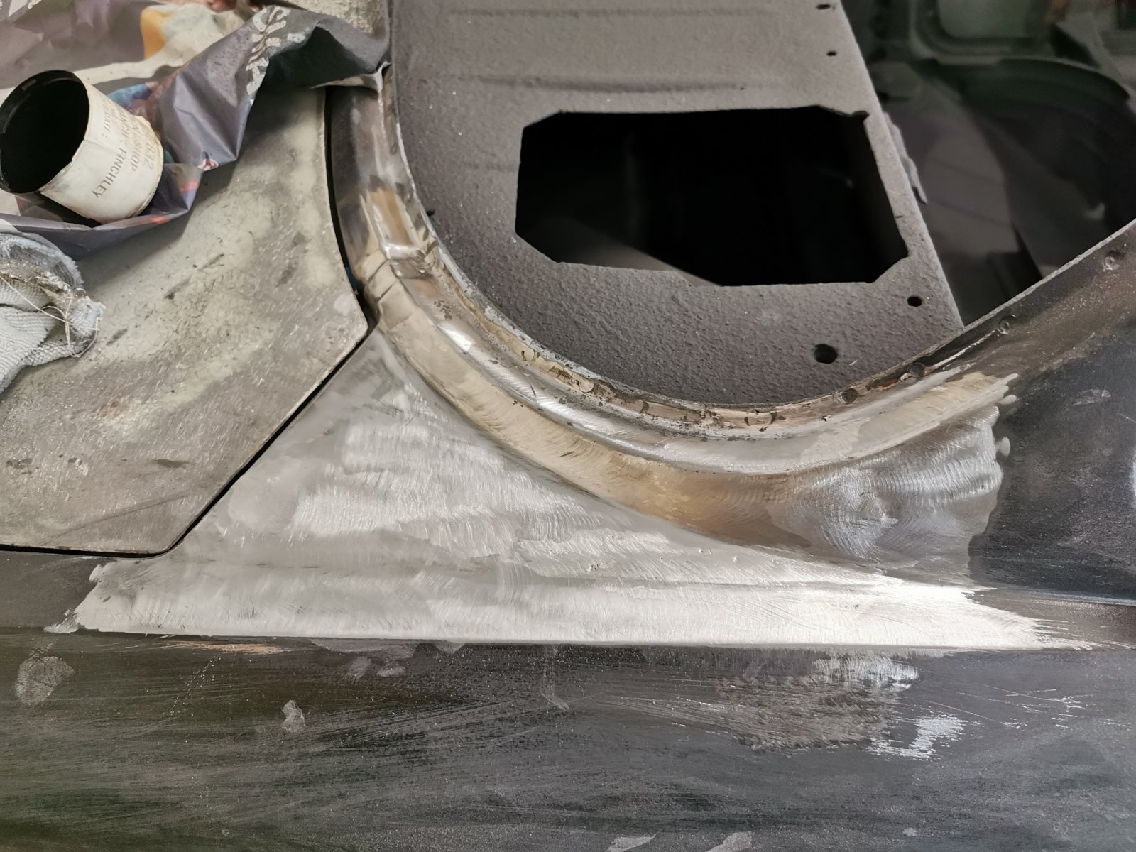

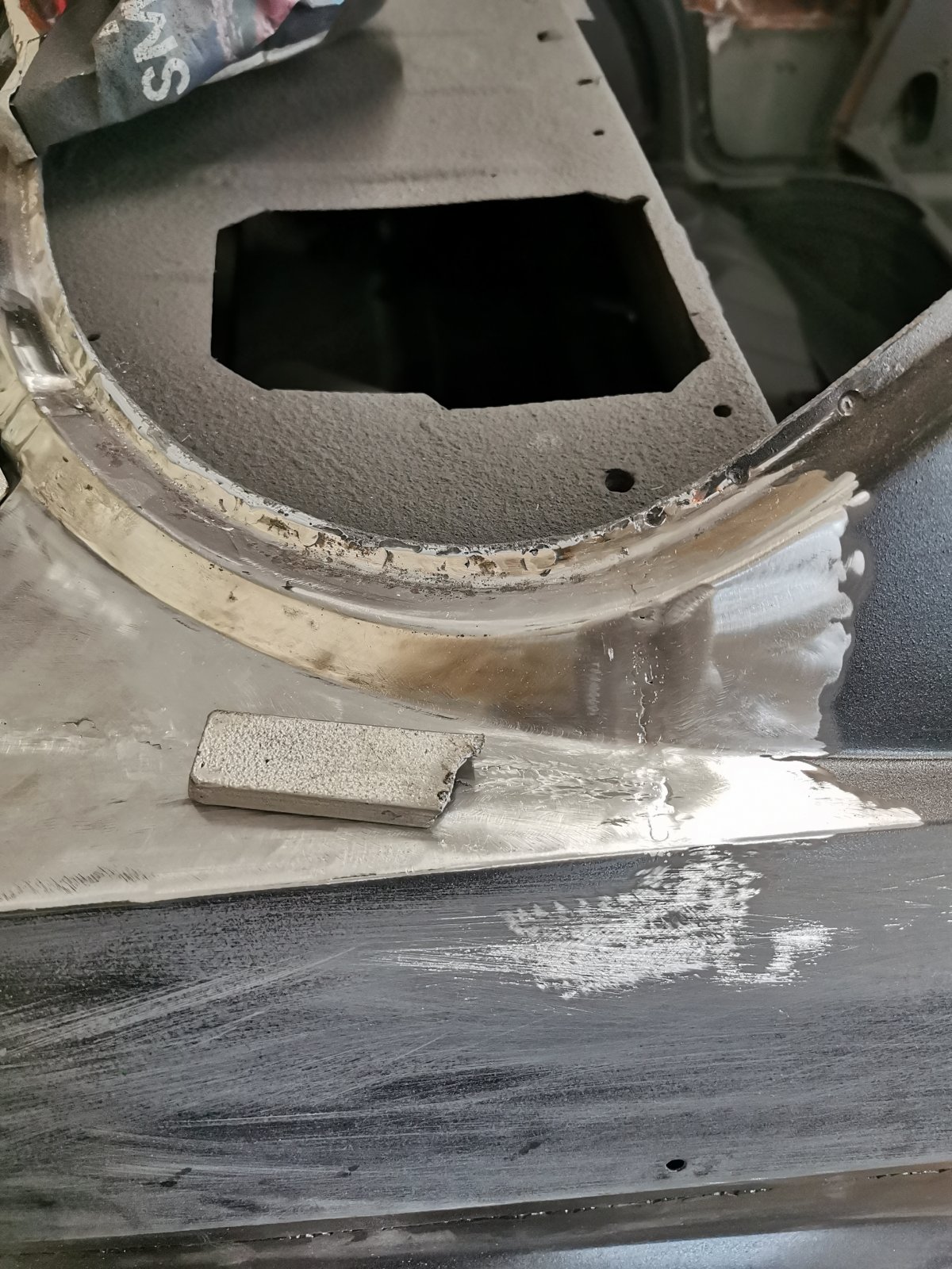

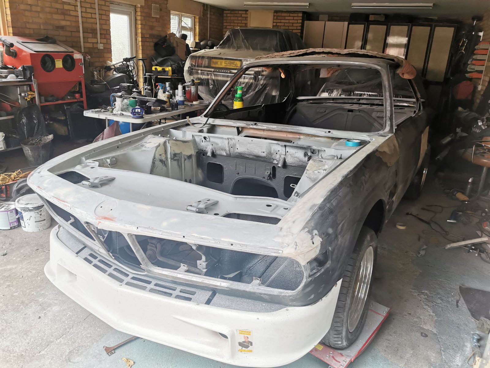

Been spending the last few weekends and nights after work on the drivers side. I'm a bit picky with shut lines and want minimal filler on the car so it's now getting done here and then will send it off for paint. The money I'm saving can be put towards the interior! It's needed a few tweaks to the doors and wing on the drivers side so far but really coming along nicely and even the worst areas needed no more than 1mm of filler so I'm very happy so far. Gapped with the seals on and the door lines up lovely!

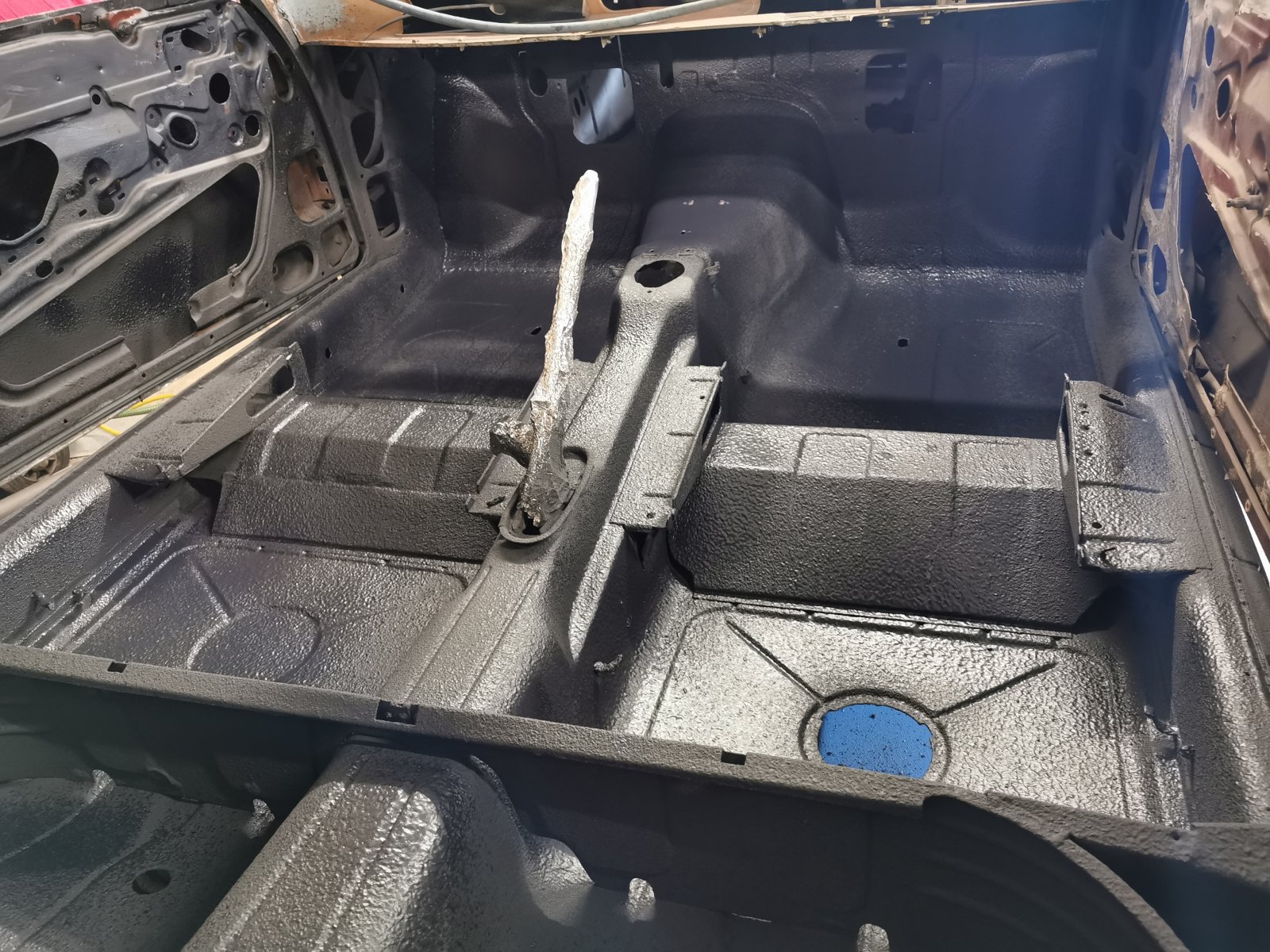

Engine bay also got epoxied and seam sealed, still need to get the ceramic insulation onto the firewall. Currently going through a fair bit of 2k high build primer to get the body as flat as possible, filler is upol fantastic and for smaller repairs and pinholes I'm using 3m red acryl putty which is brilliant stuff.

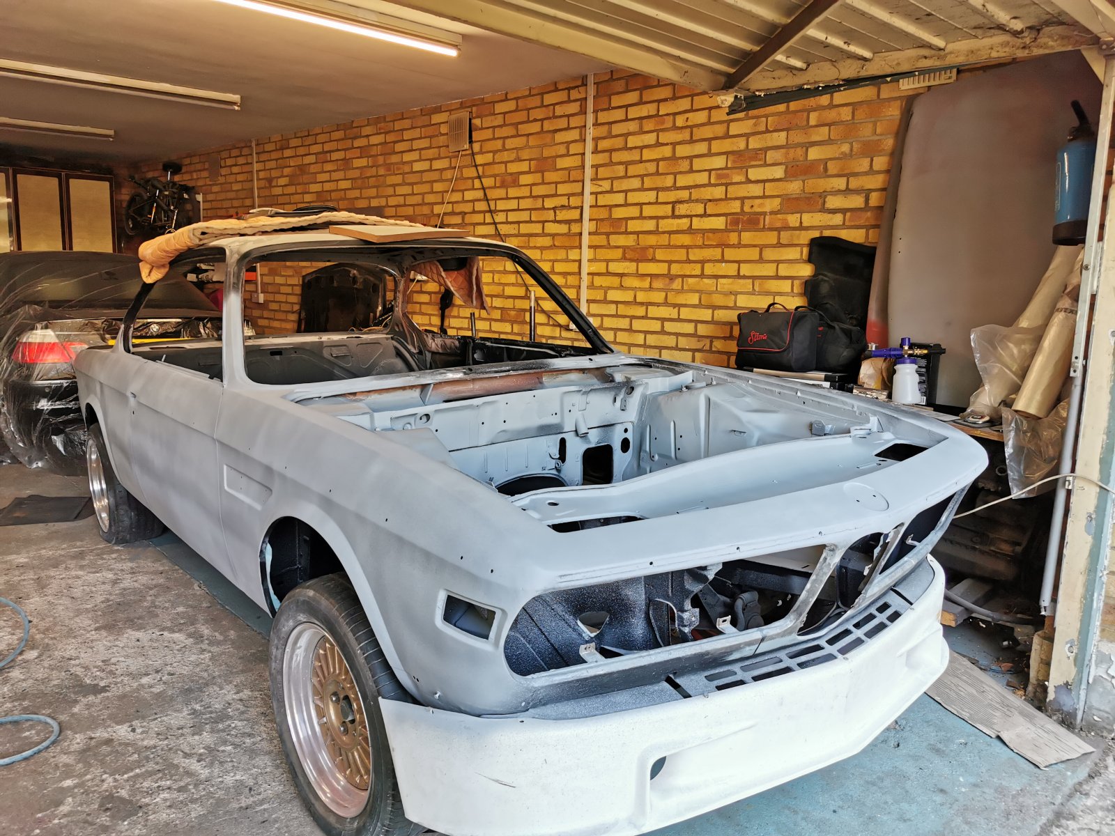

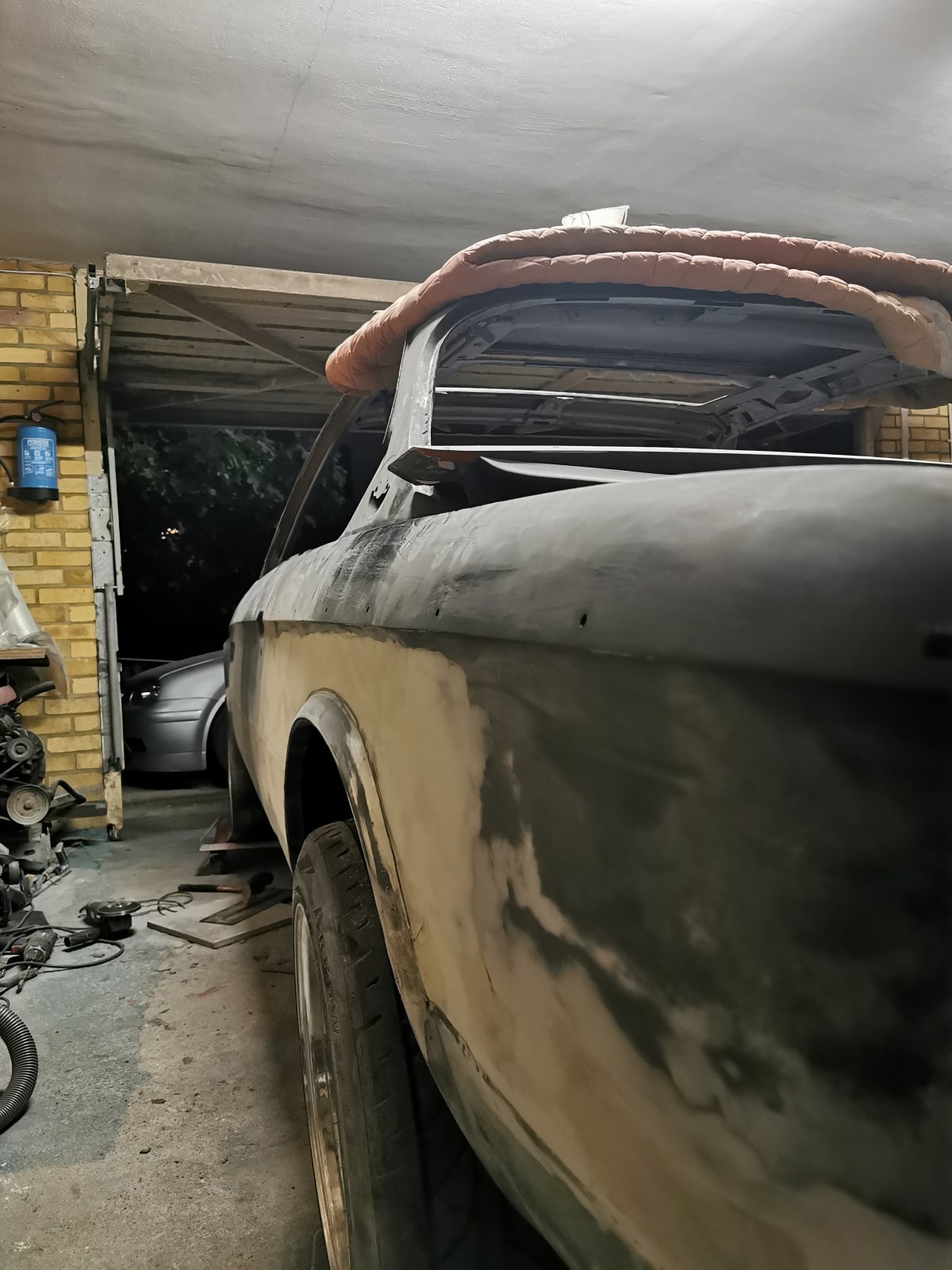

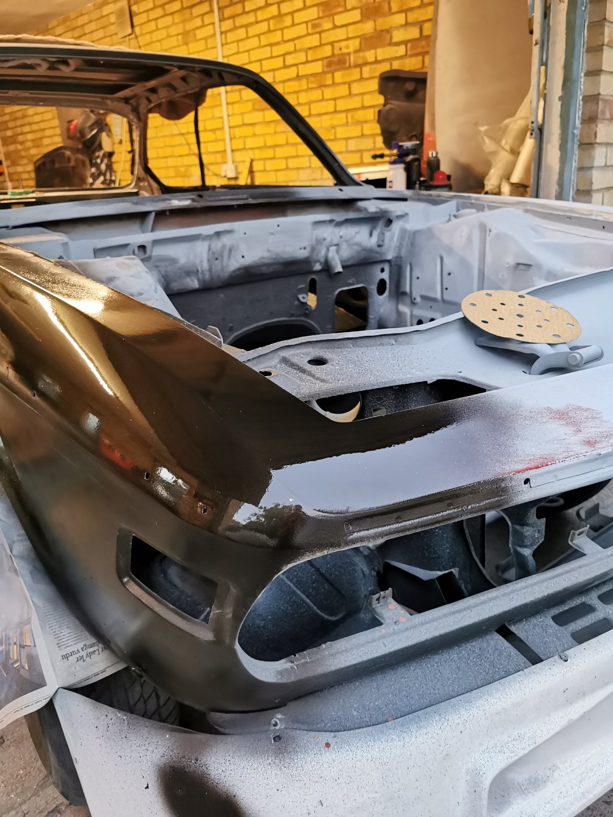

Expect minimal progression as the car will look like this for a few more weeks yet, making a start on the passenger side this week, getting all gaps and lines adjusted is a tall order. @Marc-M learnt a lesson from your resto making sure that seals are in place before trying to gap and paint!

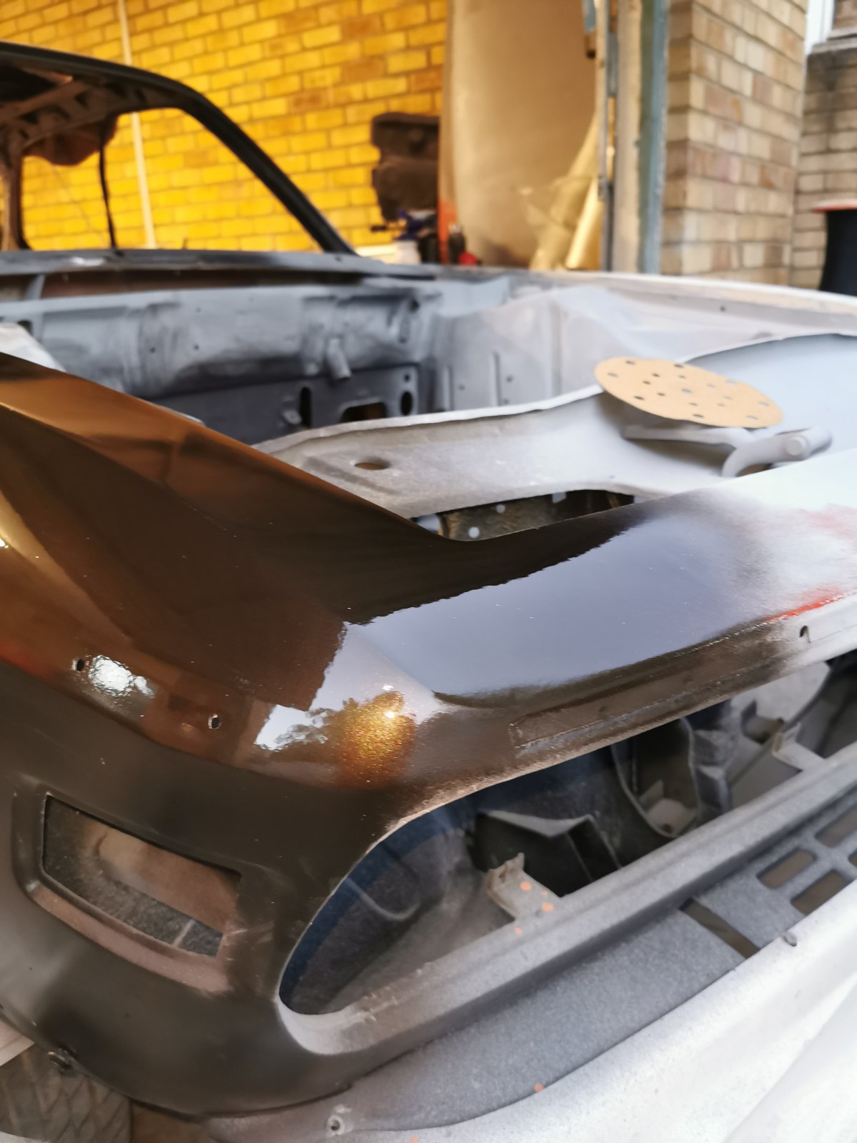

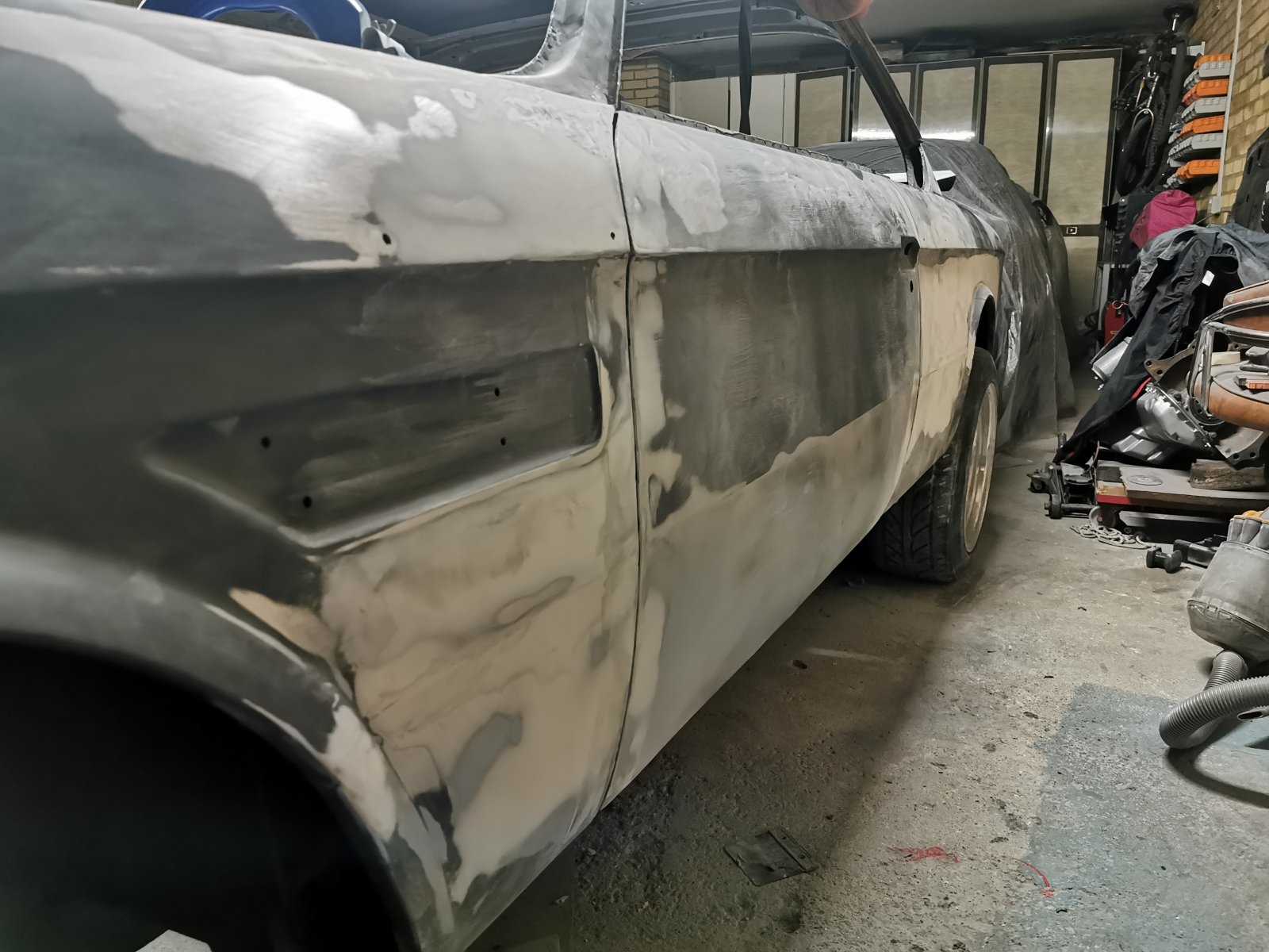

This side is coming on much much faster as it was done with a bit more knowledge and the door skin is new. A slow process pulling all the dents out with the pdr kit but it does mean a very light skim of filler around the welds and some high build primer is all that is required.

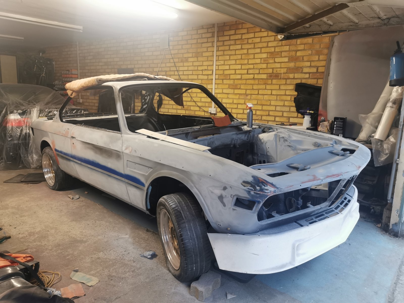

Starting to look nice and straight. Hopefully ready for some high build this weekend

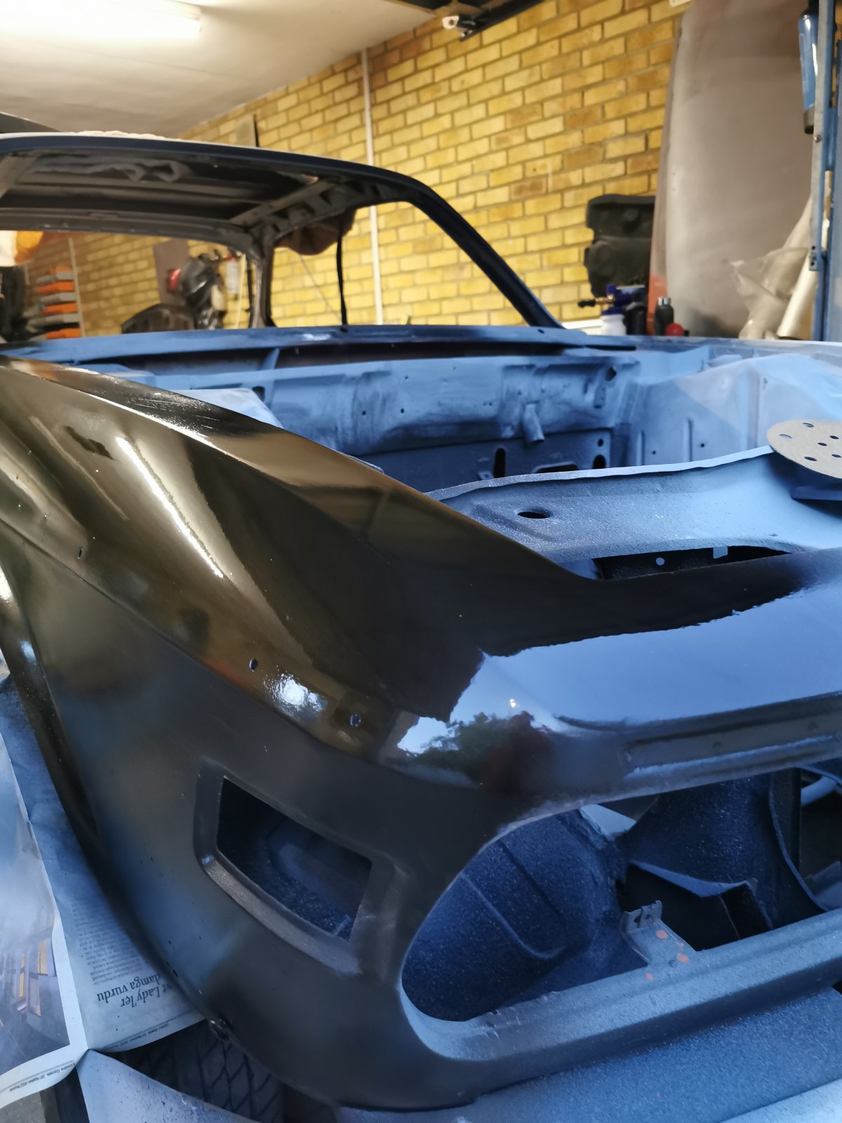

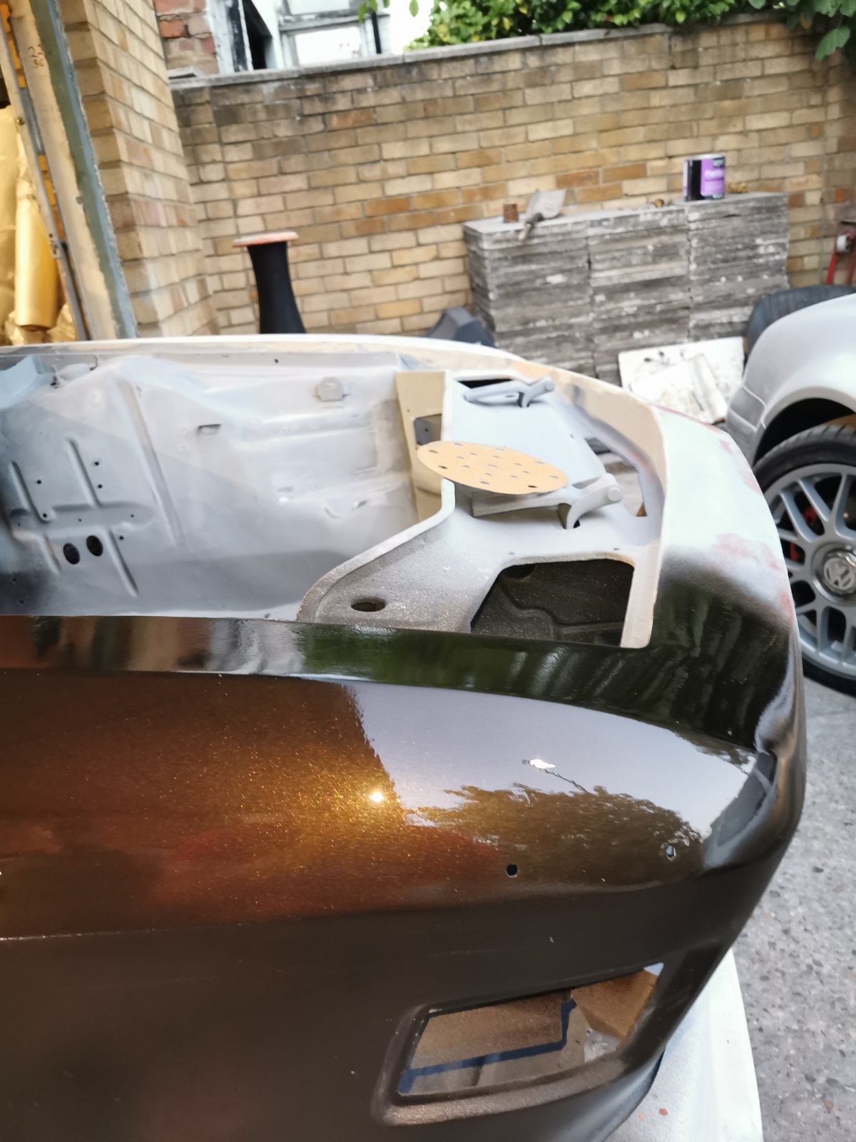

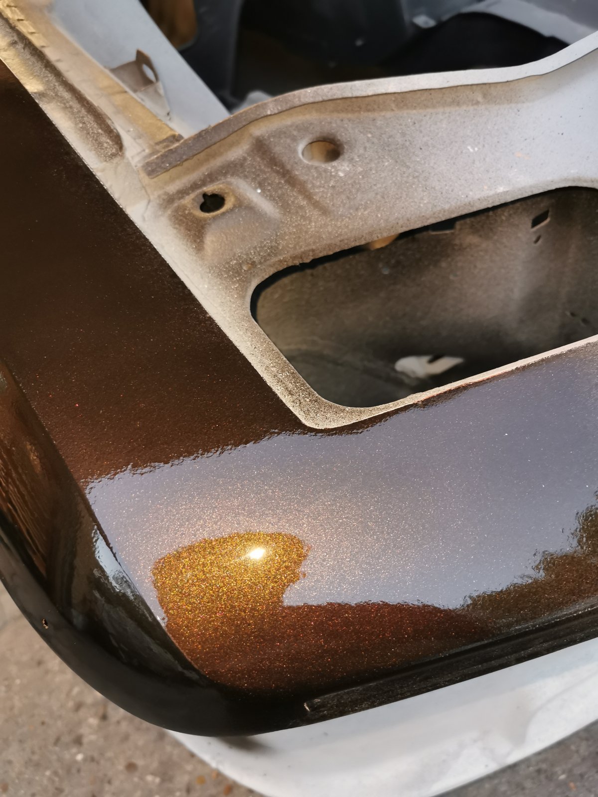

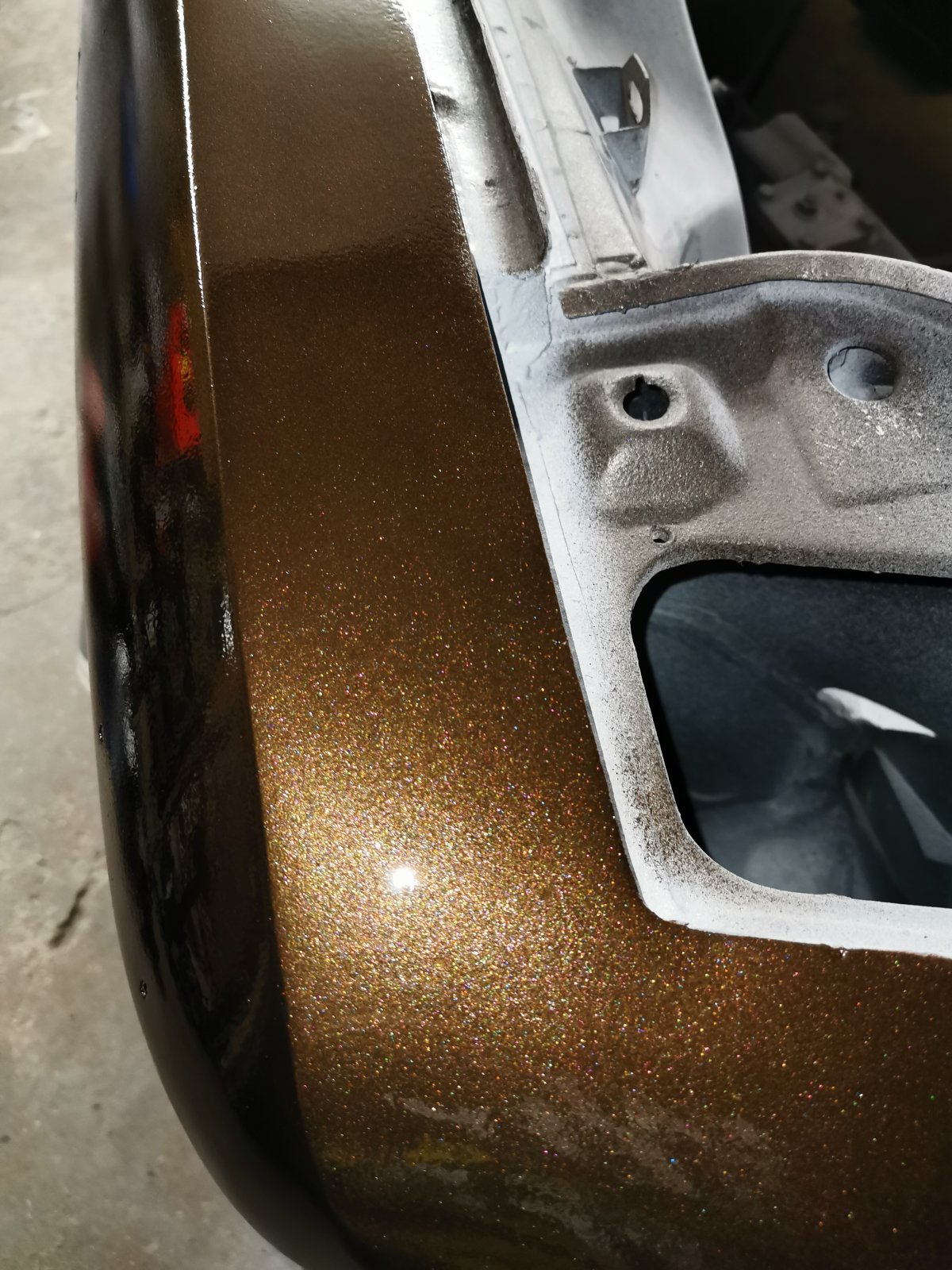

No, not sienna (I’ve owned a Sienna) but I do like the flake as Sienna can look a little dull (turd like) in anything but direct sunlight. It’s a great 70’s color for a coupe; I got more compliments with Sienna than for any other couple color that I owned.
After a quick polish up (I am by no means a painter) very very dark brown almost black, then flops to brown.
Colour is pyrite brown, a recent colour from BMW individual
