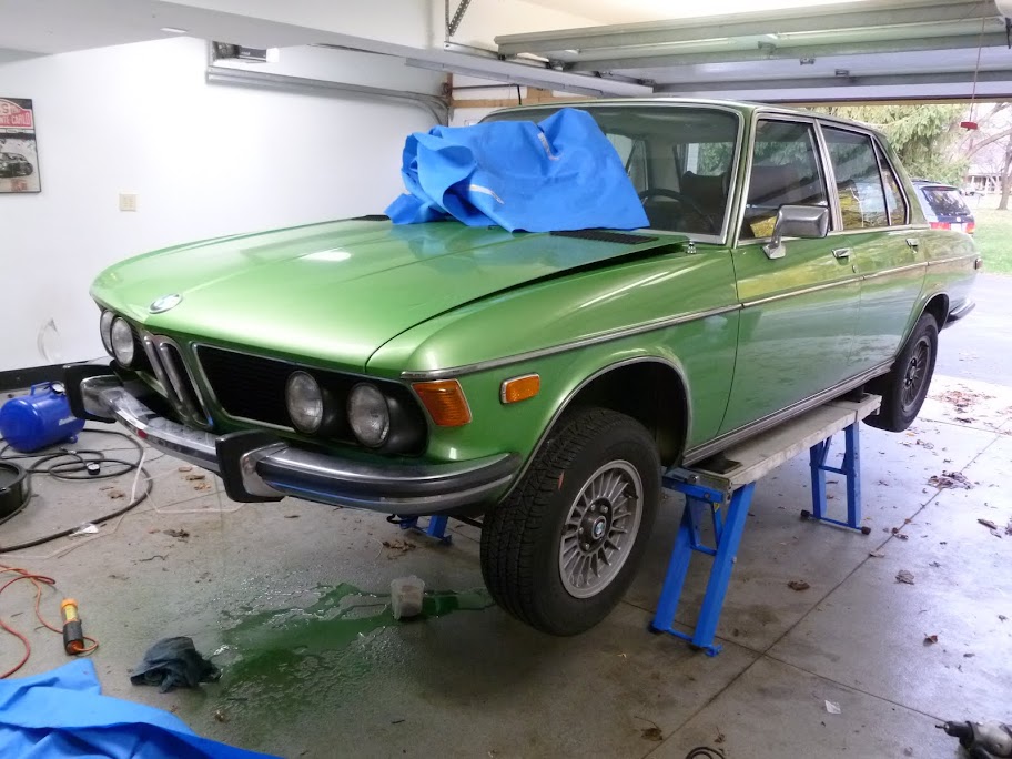

I recently picked up a 1976 3.0 Si, automatic (ZF 3HP22) in the crazy cool period color of Taiga. Built 7/76, last month of US 3.0 Si production. Many thanks to Chris Macha and Ron Perry who were invaluable in assisting me with this purchase.
Hi, nice bav! Mine is fjord, love the green!
interesting car lift, looks very handy.
