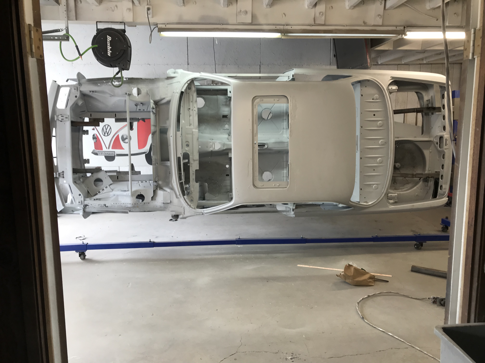

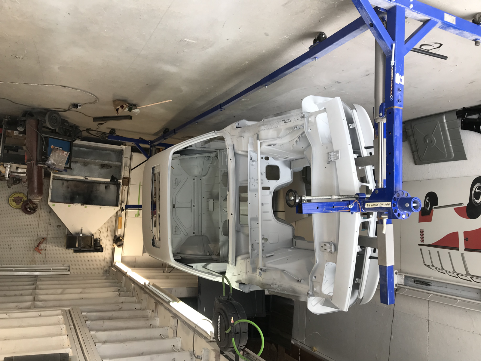

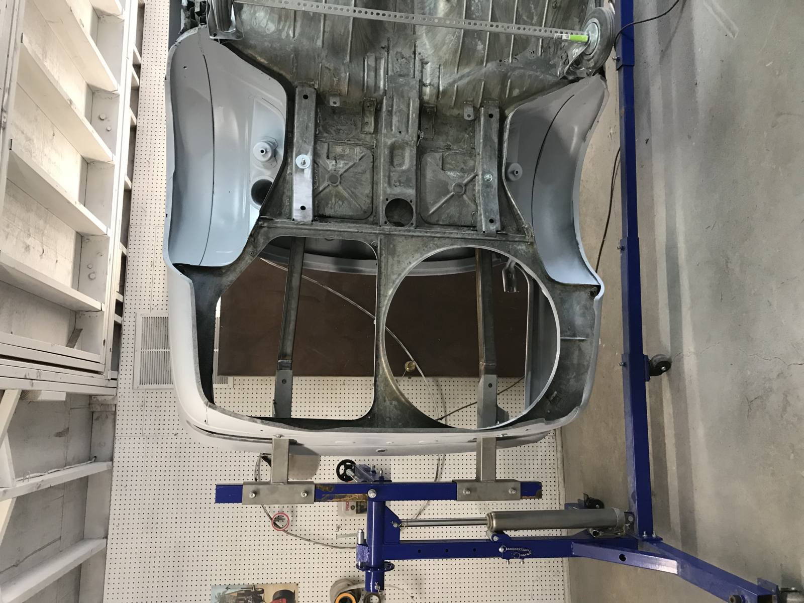

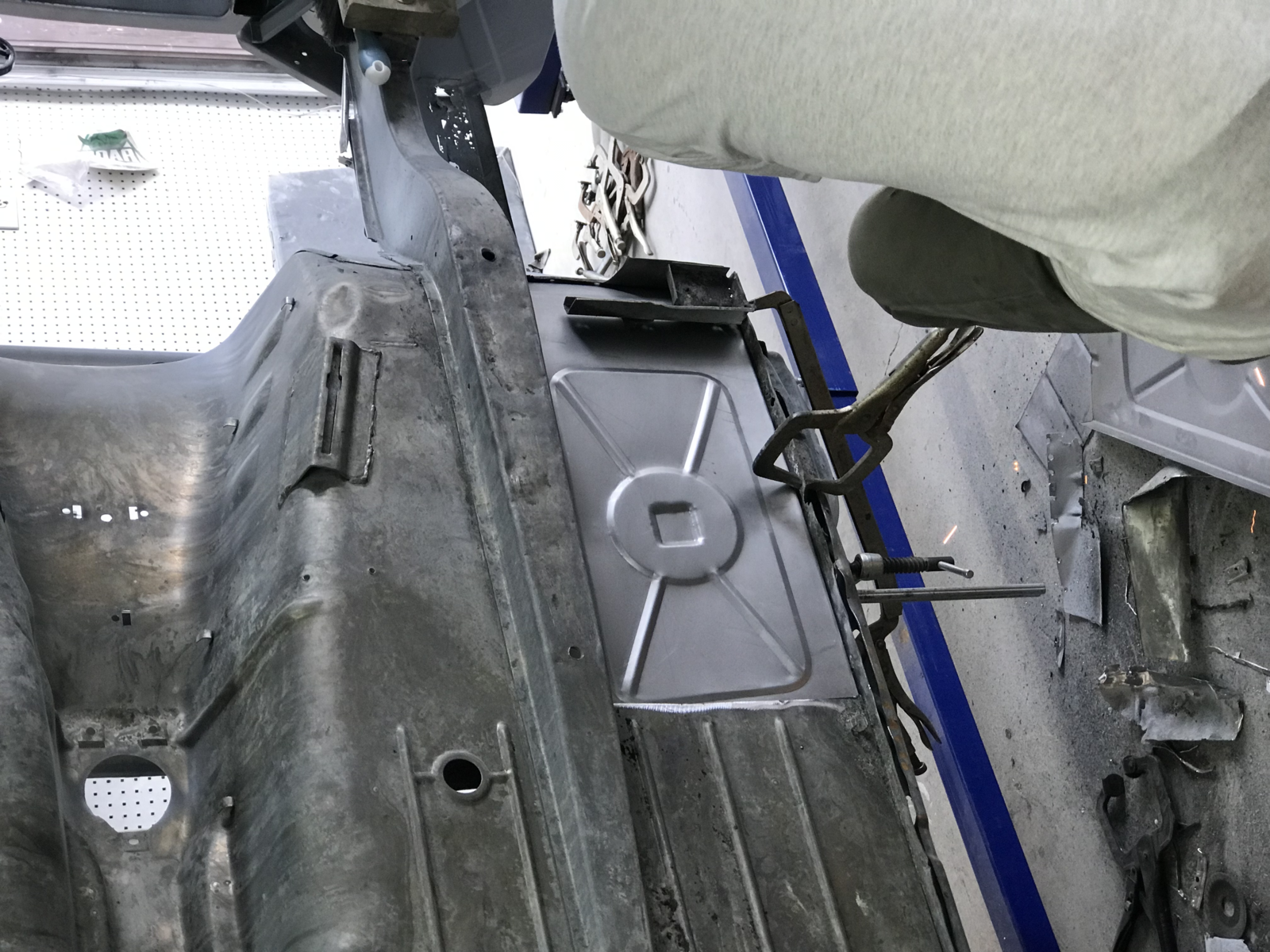

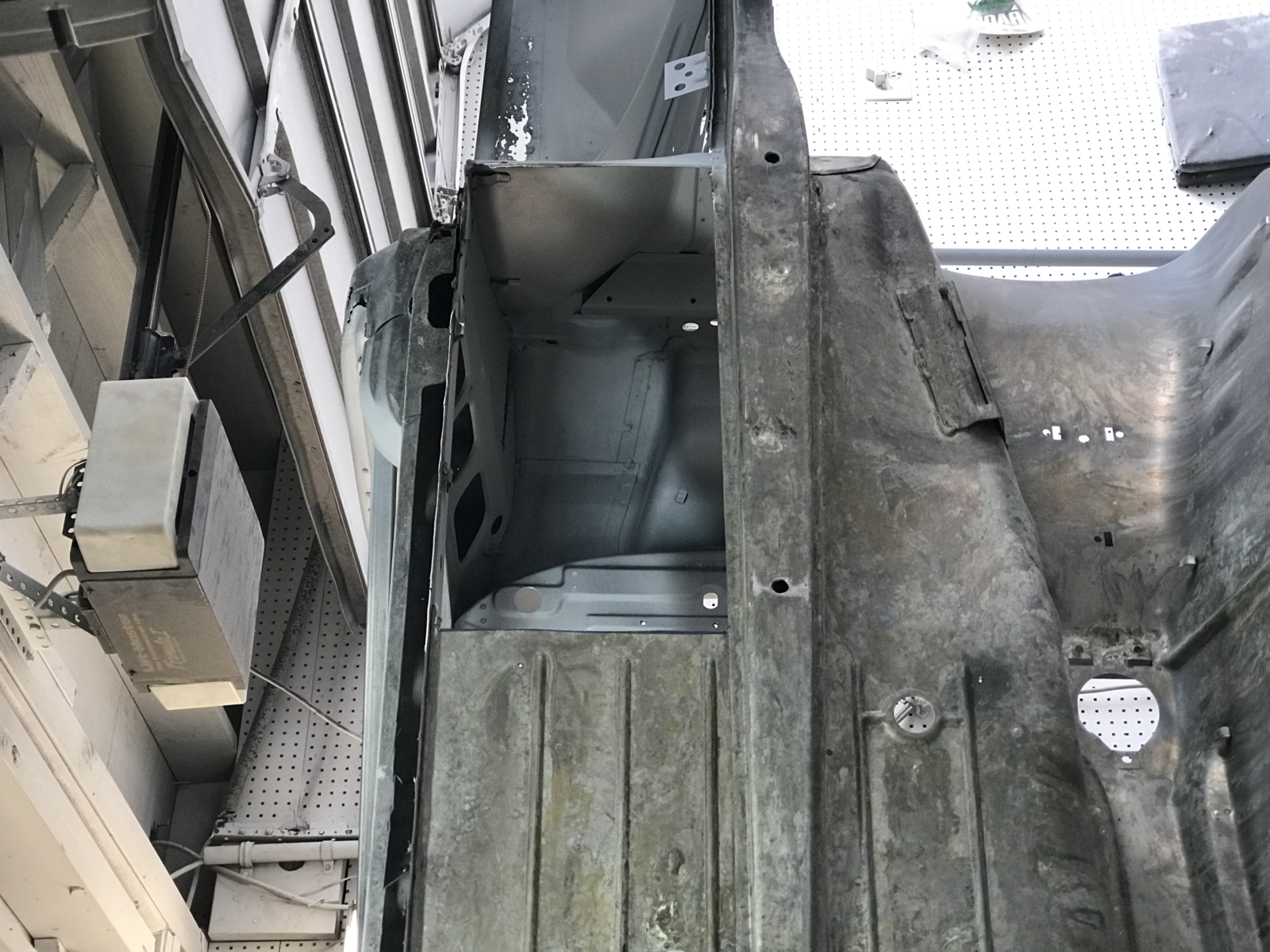

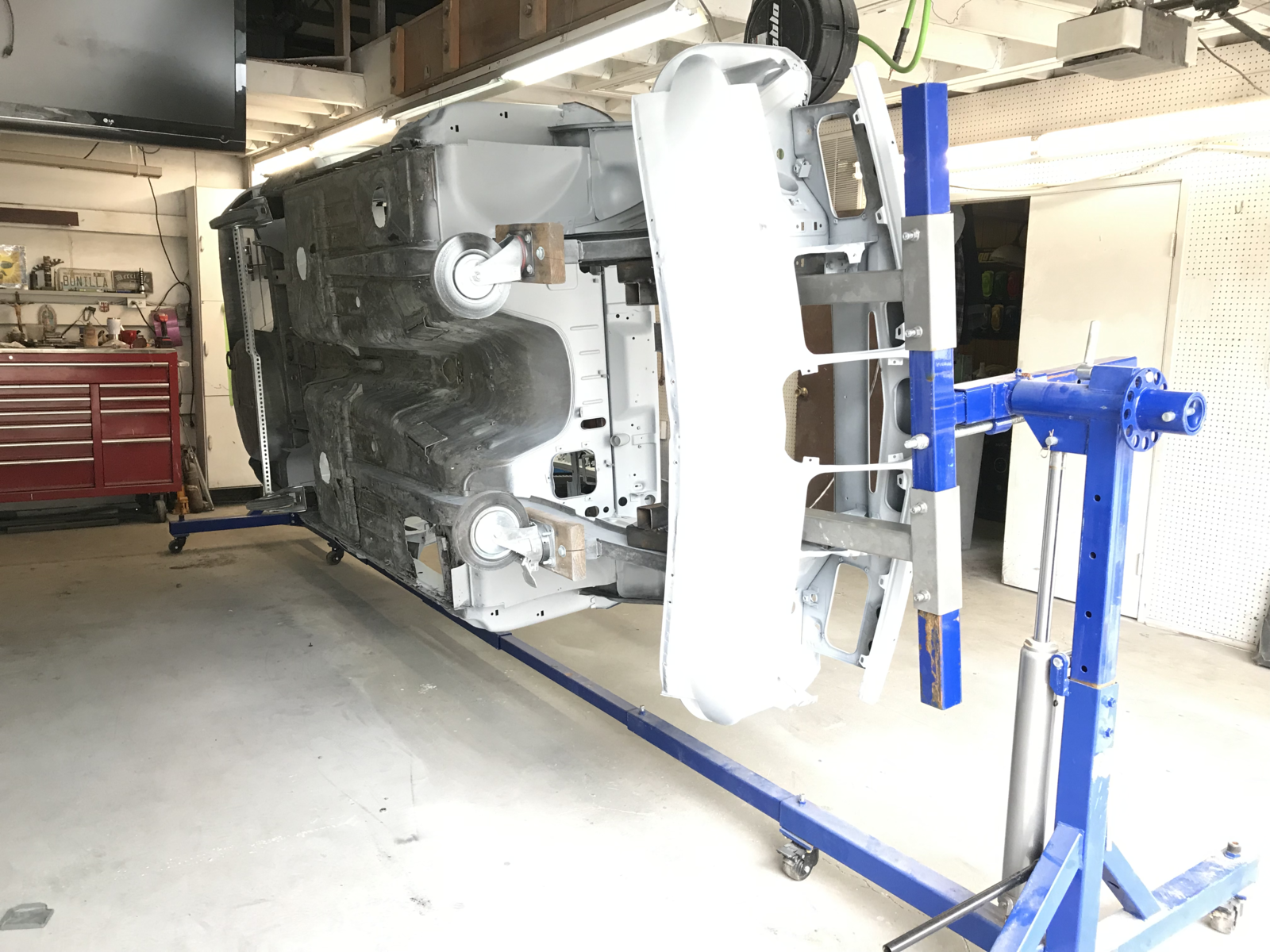

Guys have been working really hard on getting body ready for epoxy hopefully next couple of days and the metal work can begin. Not sure why these pics loaded sideways

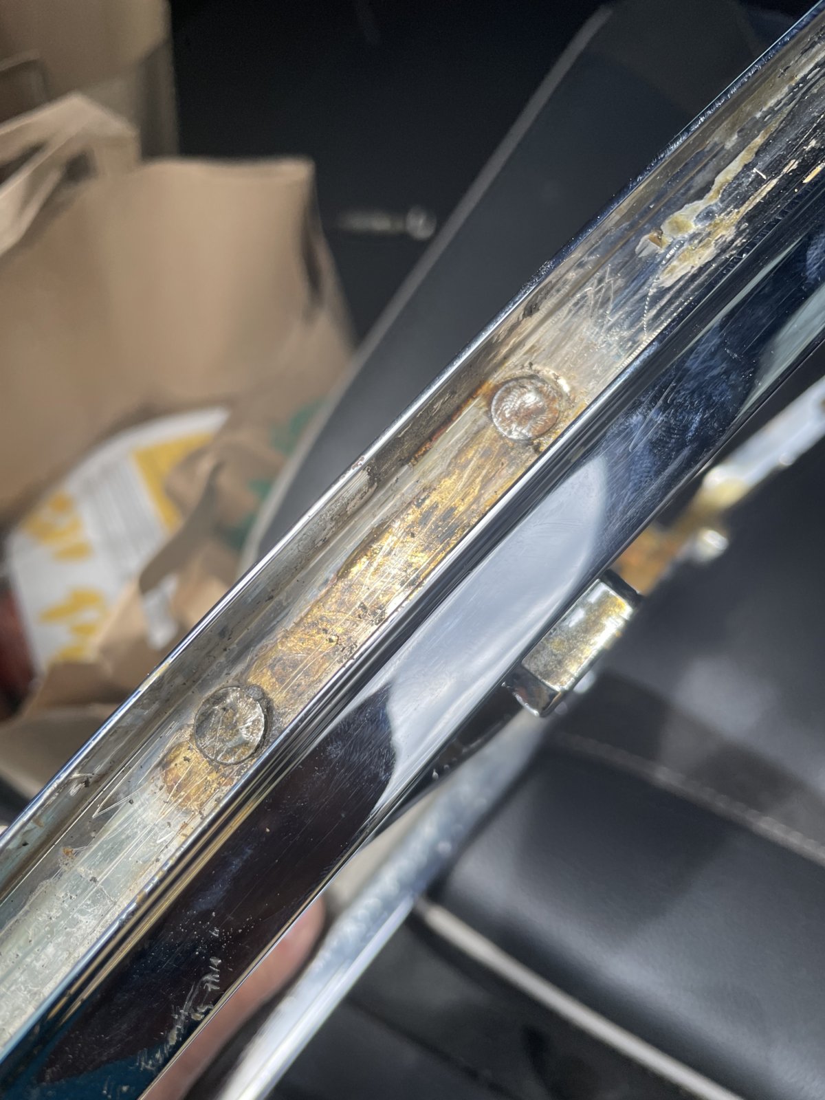

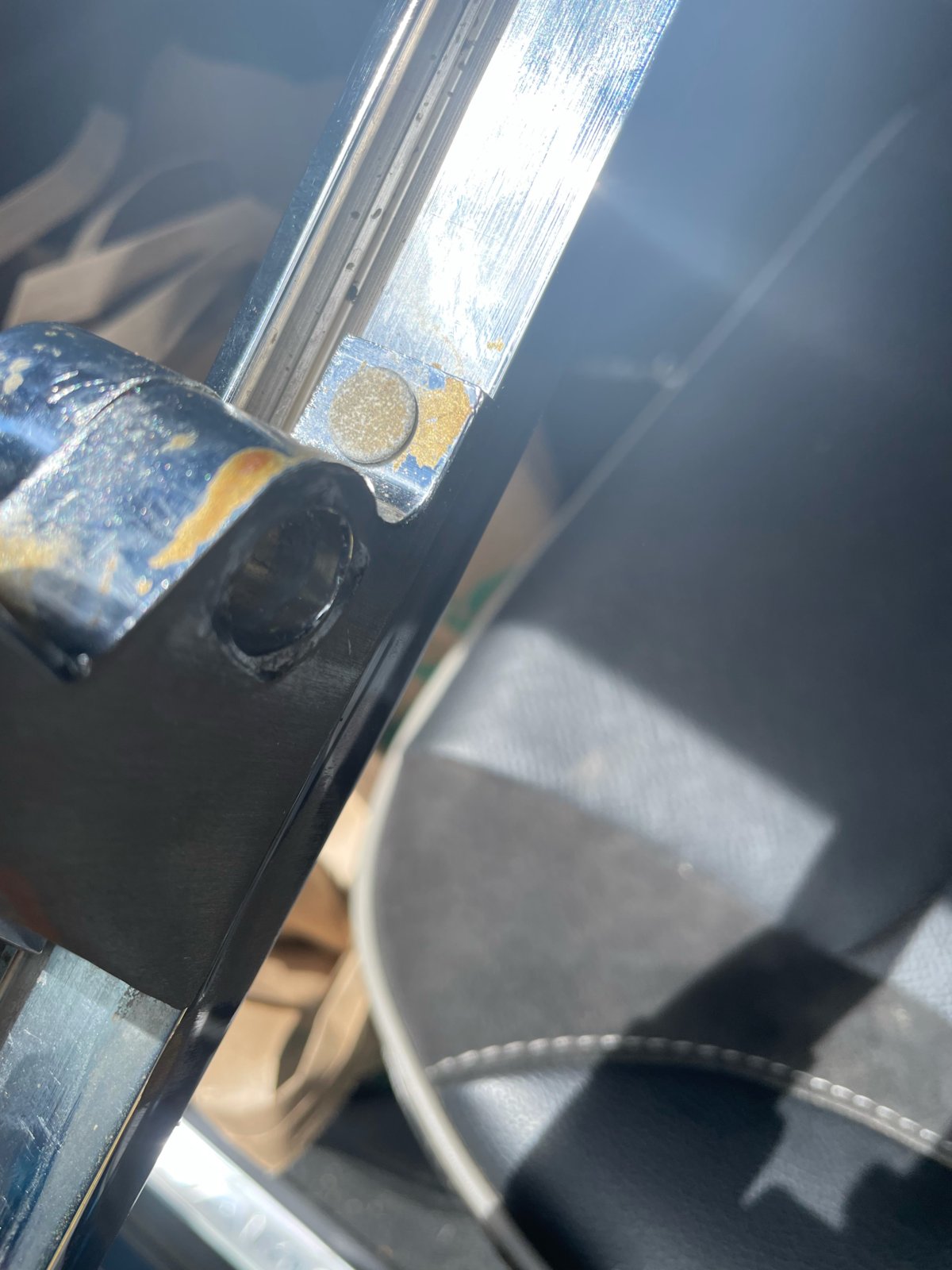

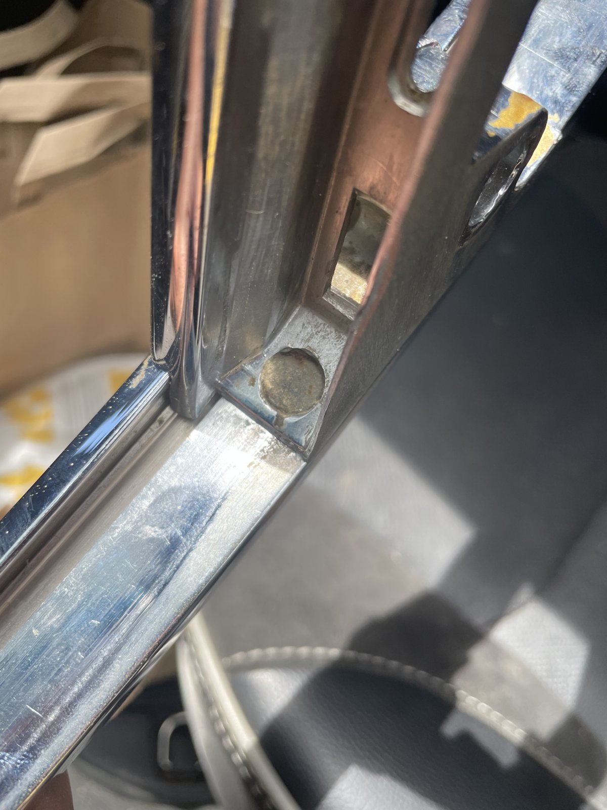

I just took the big triangle front window frames into the platers to be re-chromed and was told that the bottom pieces held in by two big screws and two large rivets are actually a different metal from the main frame section. Pot metal I think I was told.
Has anyone had any experience taking these apart and putting them back together, having them plated separately or together would also be interesting to know about too.

I took them apart and plated them separately from the frames. The metal is zinc as are the exterior door handles. My plater didn’t have any issues plating them. I’ve heard of people playing the whole assembly as one piece but I can’t imagine that it would be without issue.
I used some two piece fasteners that look like rivets but screw together to reinstall the triangular piece. It worked very well.

Agreed, my plater had no problems as separate pieces. Threaded rivets work great and are easy to use, brand name is Nutserts.

two piece fasteners as I think you aee talking about, are called Chicago screws

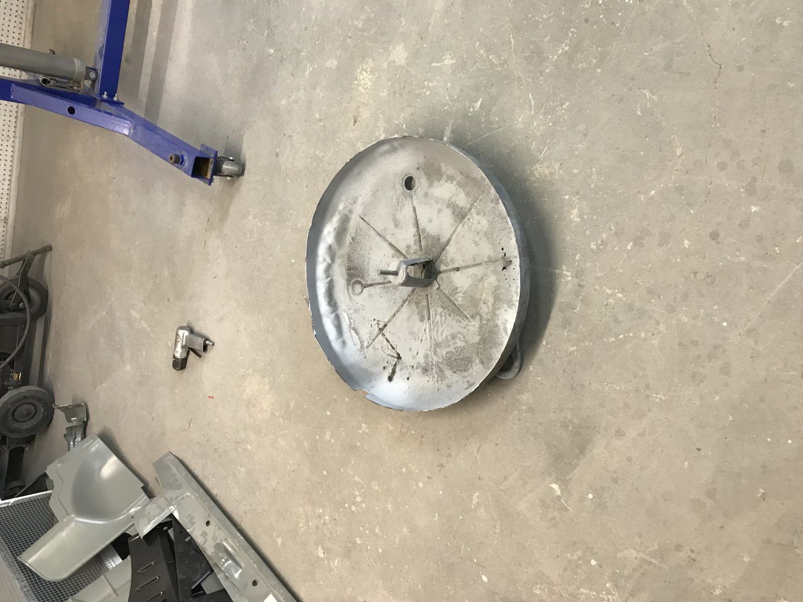

Was very lucky to find an amazing metal fabricator/welder who has been working on cars since he was 15. He's 17 now :) He a muscle car enthusiast mainly vintage mustangs which bodes well for the unibody and rust portions of this project, he likes to call them "Rustangs" and he's just an overall great guy that was super excited about the project and couldn't wait to get started. He also recently found himself between homes after his house sold too fast and staying with his mother in law apparently results in needing to spend vast amounts of hours working in the shop, how unfortunate. Sorry pics are rotated.
